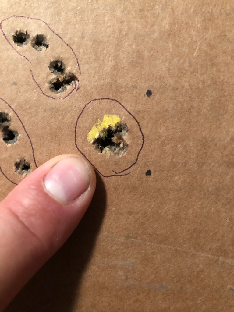

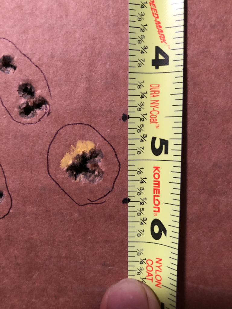

Here's mine. 3 pictures of the same group.

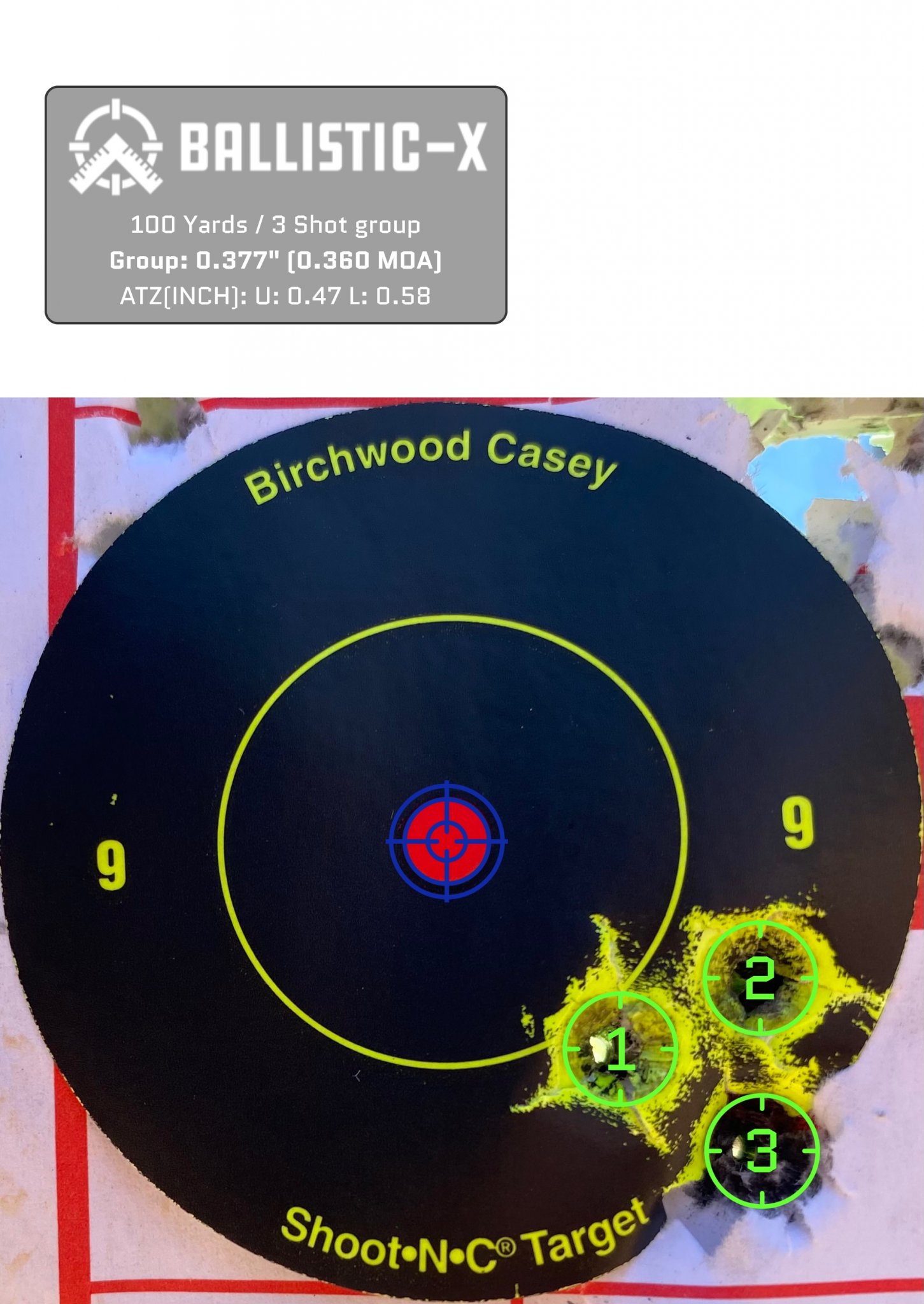

My Christensen Arms Ranger 22 loves the CCI SV ammo.
3 shot groups, but pretty damn good. 😏
100 yards

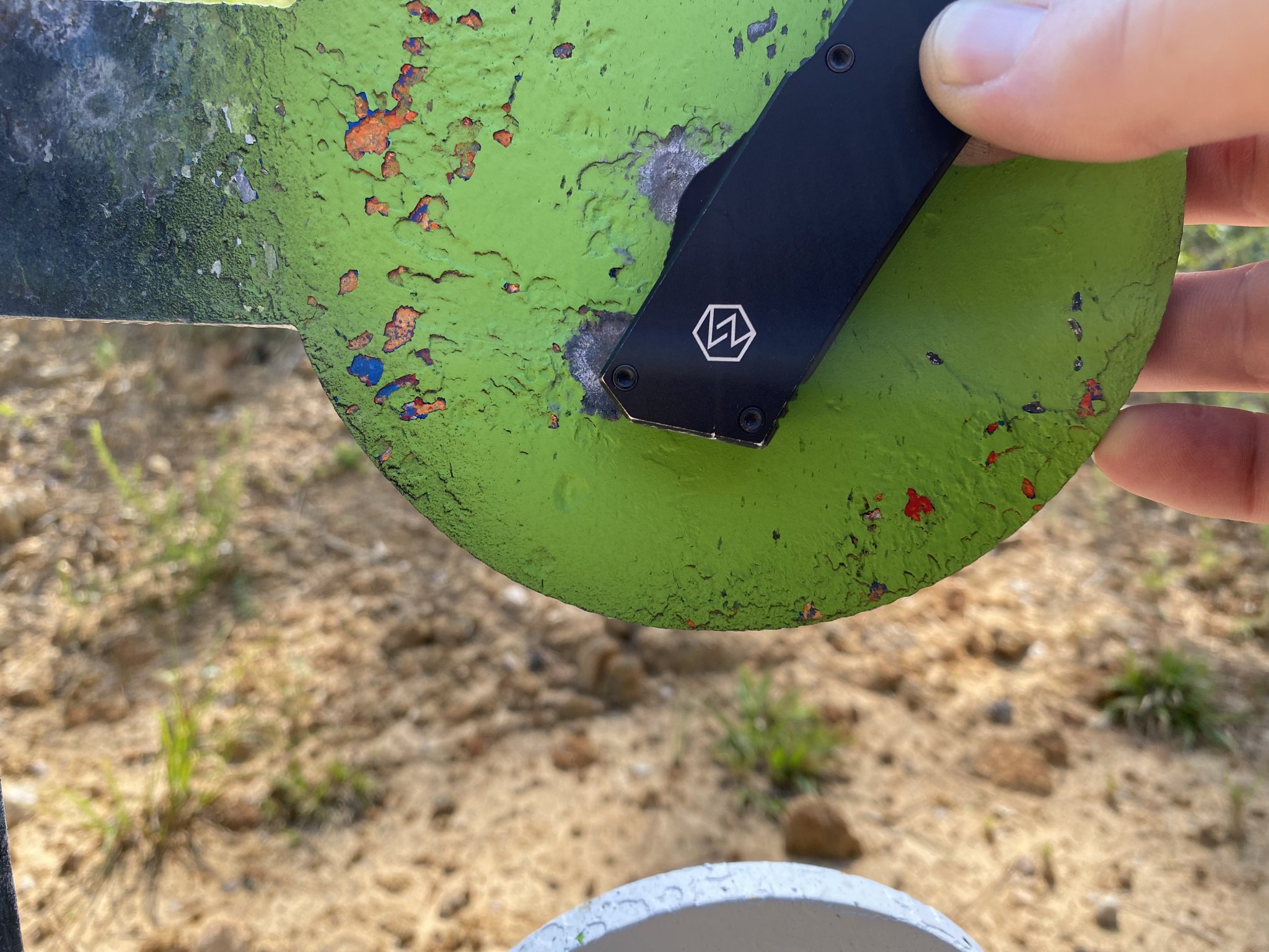

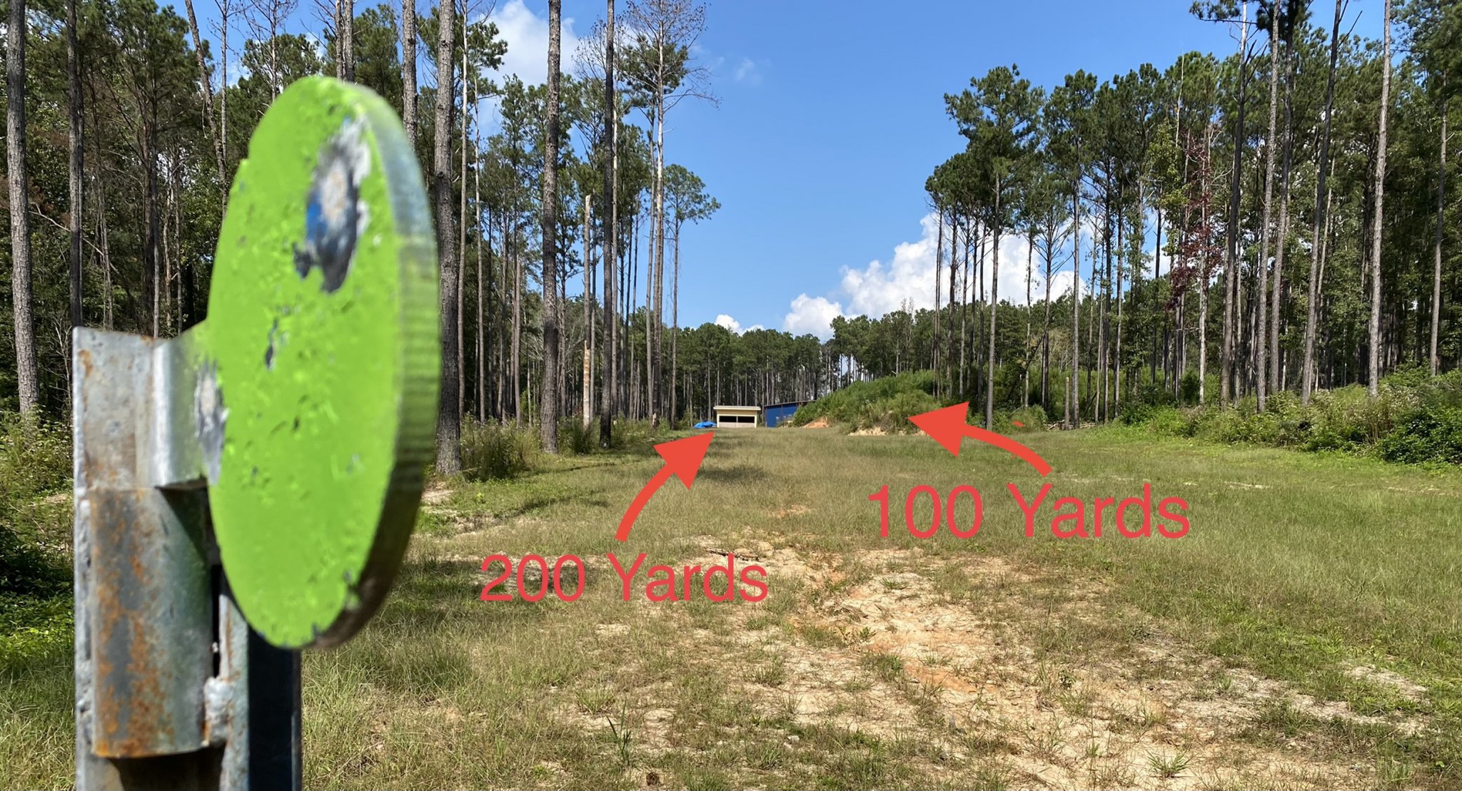

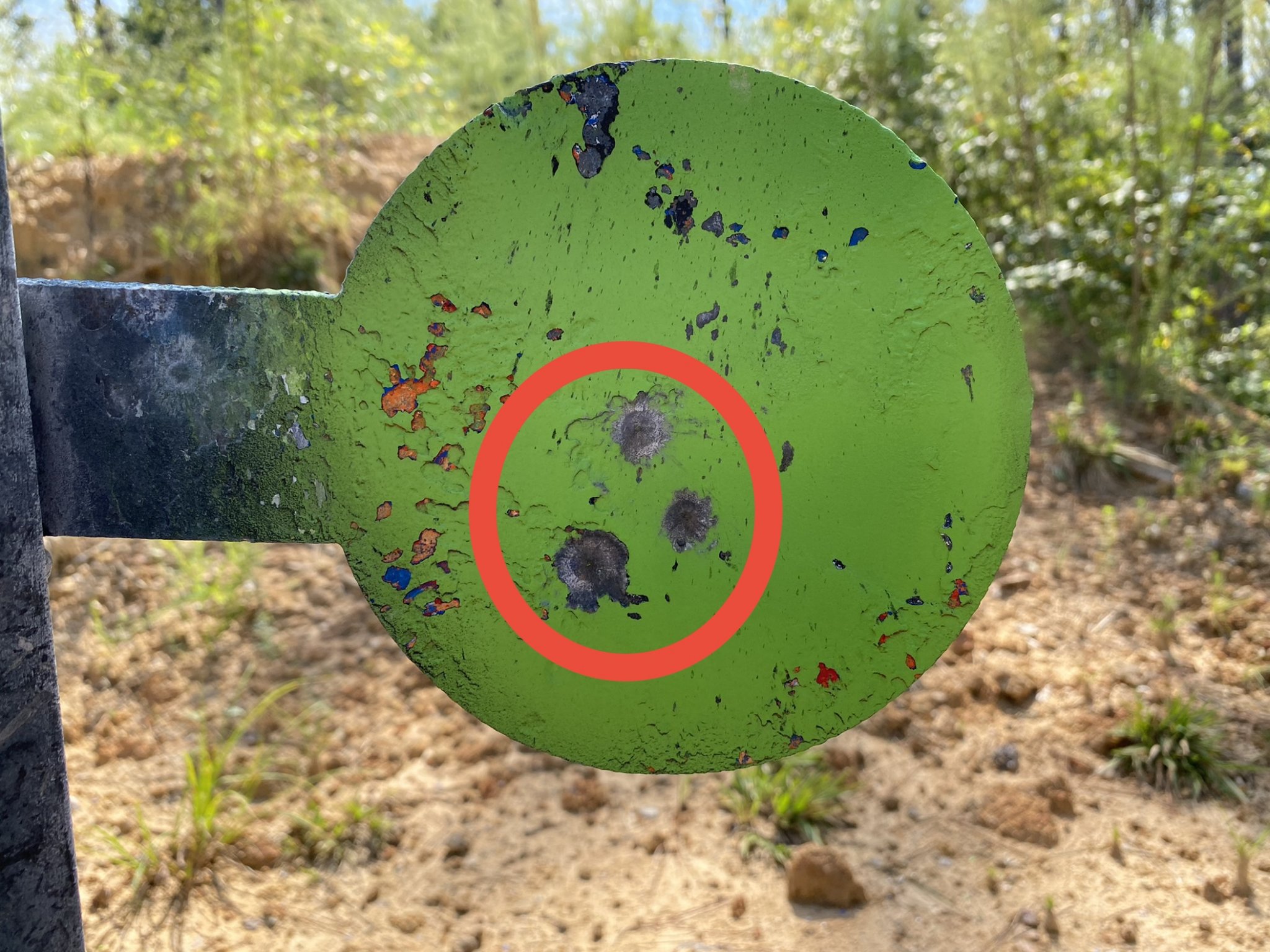

This was a group at 200 yards… I didn’t have a measuring device, so I scaled using my knife, then measured my knife at home.

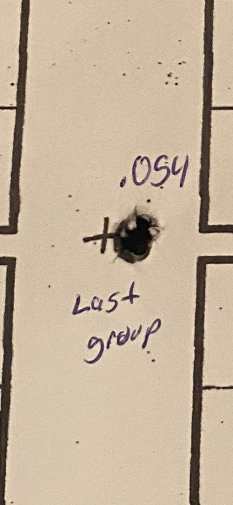

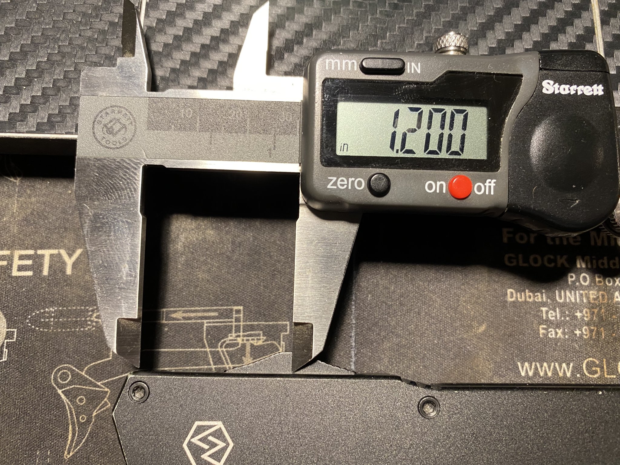

This is the best I ever managed with it in my 10/22 target model. 5 shots at 50 yards. The rifle is all Ruger parts, but worked on a bit. I cut the barrel down to 18.5" and recrowned it, squared up the bolt face and set headspace to I think around .043", bedded with aluminum tape, free floated the barrel, homebrew trigger job including adjustable sear engagement and disconnector reset, and ditched the trigger reset spring and plunger for a different style of spring inside the trigger housing that has way less friction than the plunger setup.

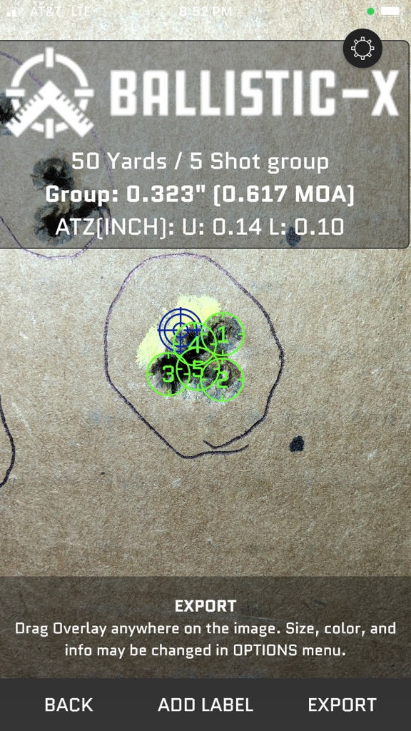

5 shots at 50 yards with CCI SV. If you shoot enough of it you should be able to get something worth bragging about.

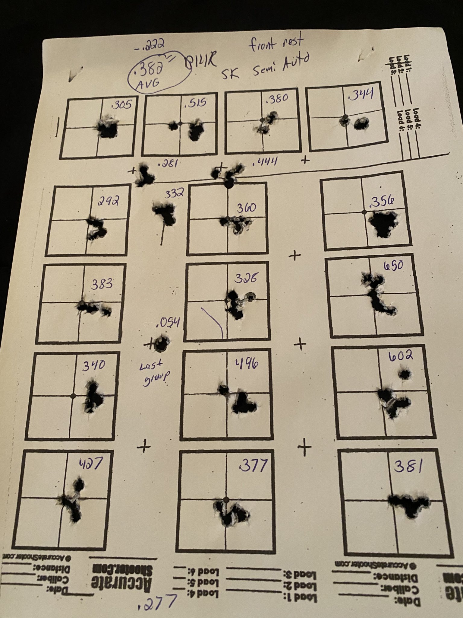

It shot ok through my bergara, but sk pistol shoots groups that are half the size. I get less flyers, (not zero, but less). I'm sure there are rifles out there that shoot it just fine, but the little group I've shot with was pretty good and the difference between middle of the pack and top of the pile is usually indistinguishable to the human eye and must be settled with calipers. It doesn't seem consistent enough to get you to the top.

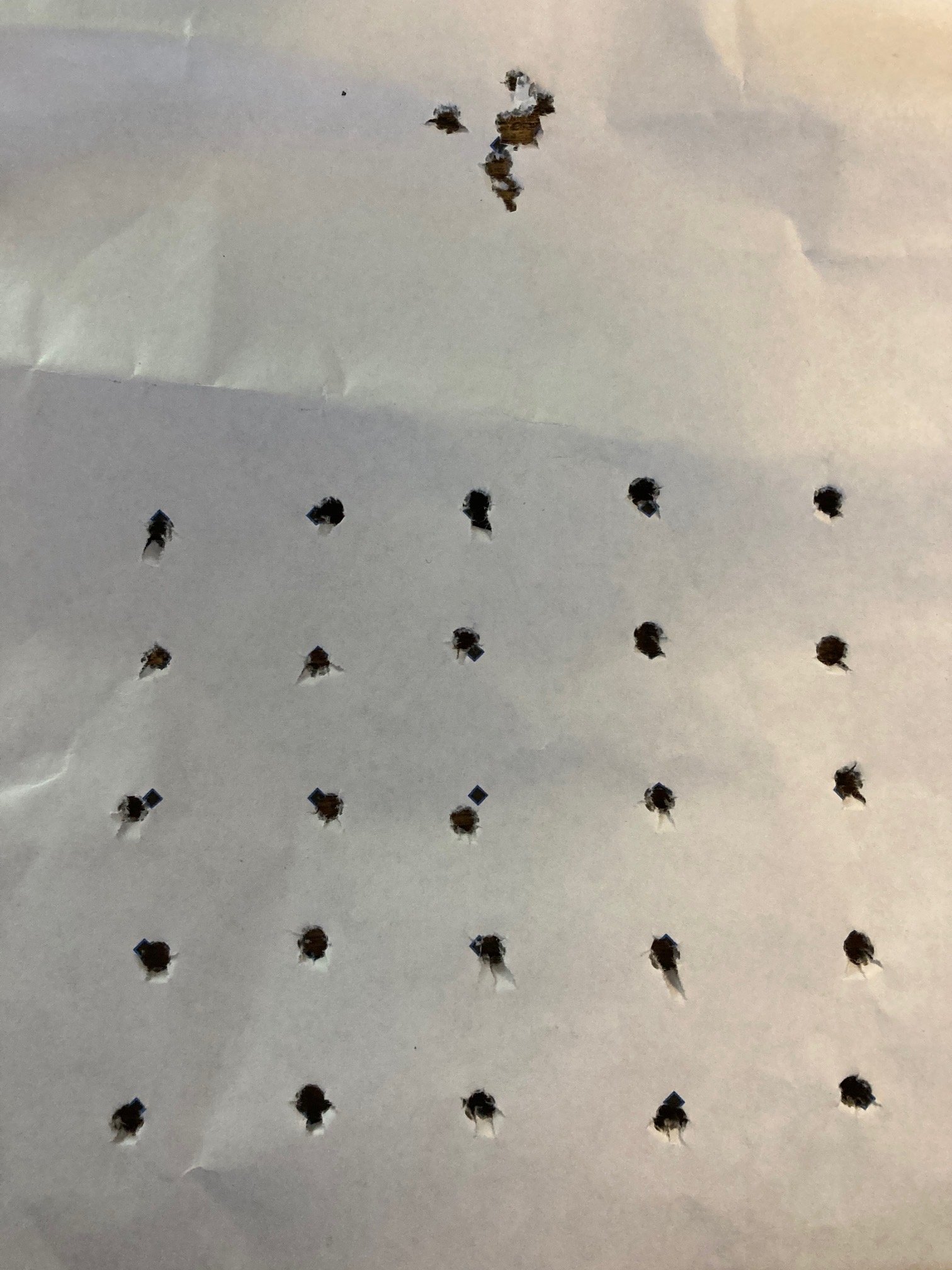

Its been a while since I last shot CCI for groups. Mainly just plinking.
But here is a one board for the council to wonder on.

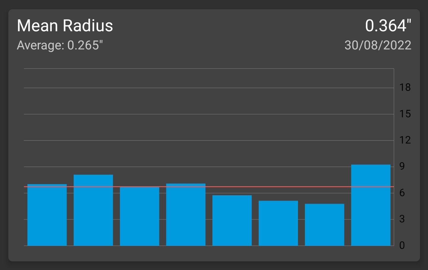

Here is the average mean radius for CCI SV at 50m for me, the last group was just 2 groups, so bad data.

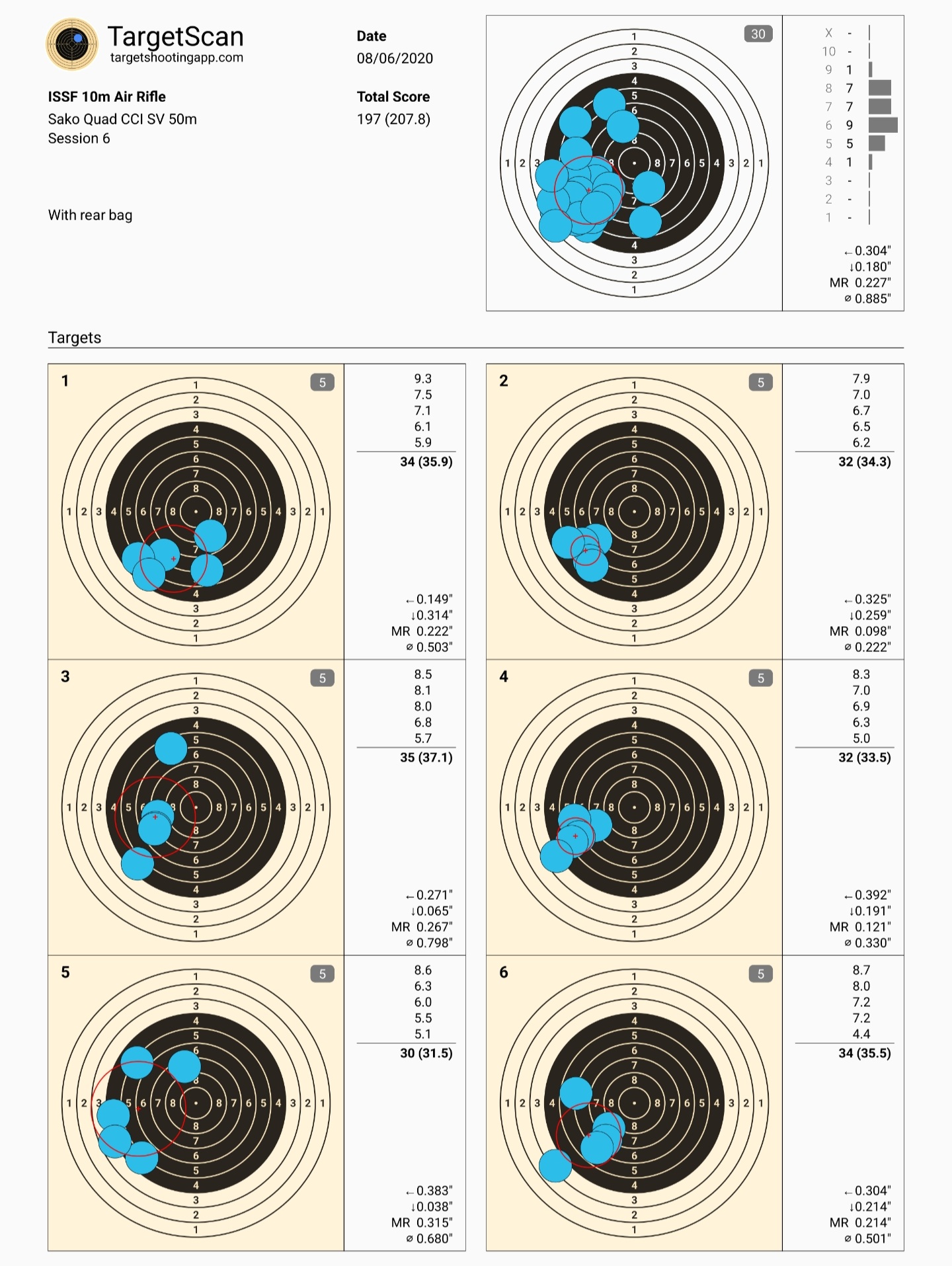

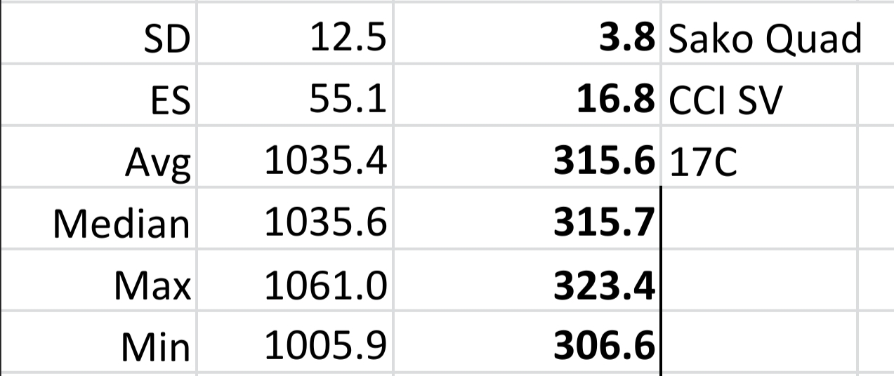

My CCI lot has been surprisingly good in terms of MV
Here is sample of 50 shots:

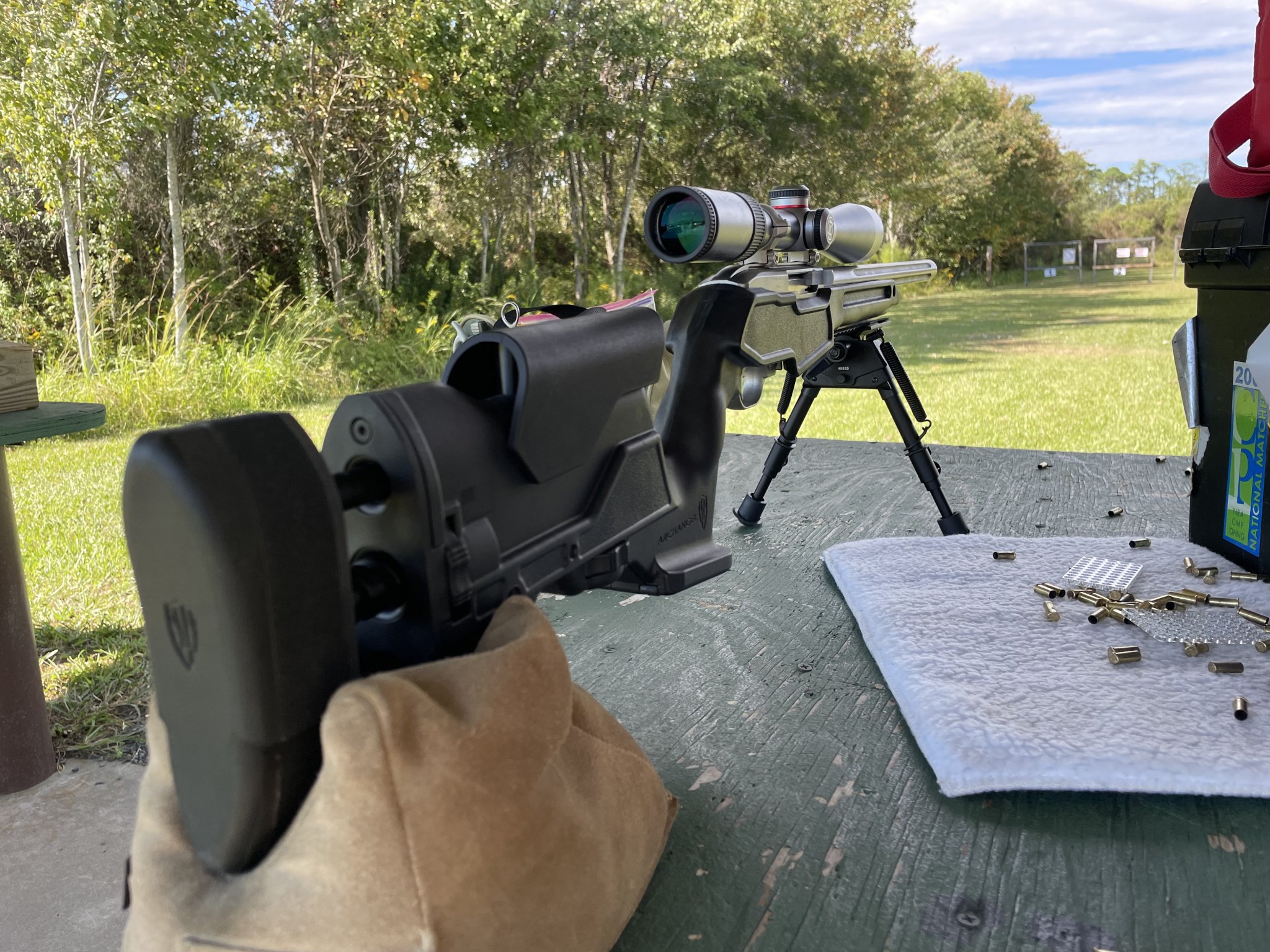

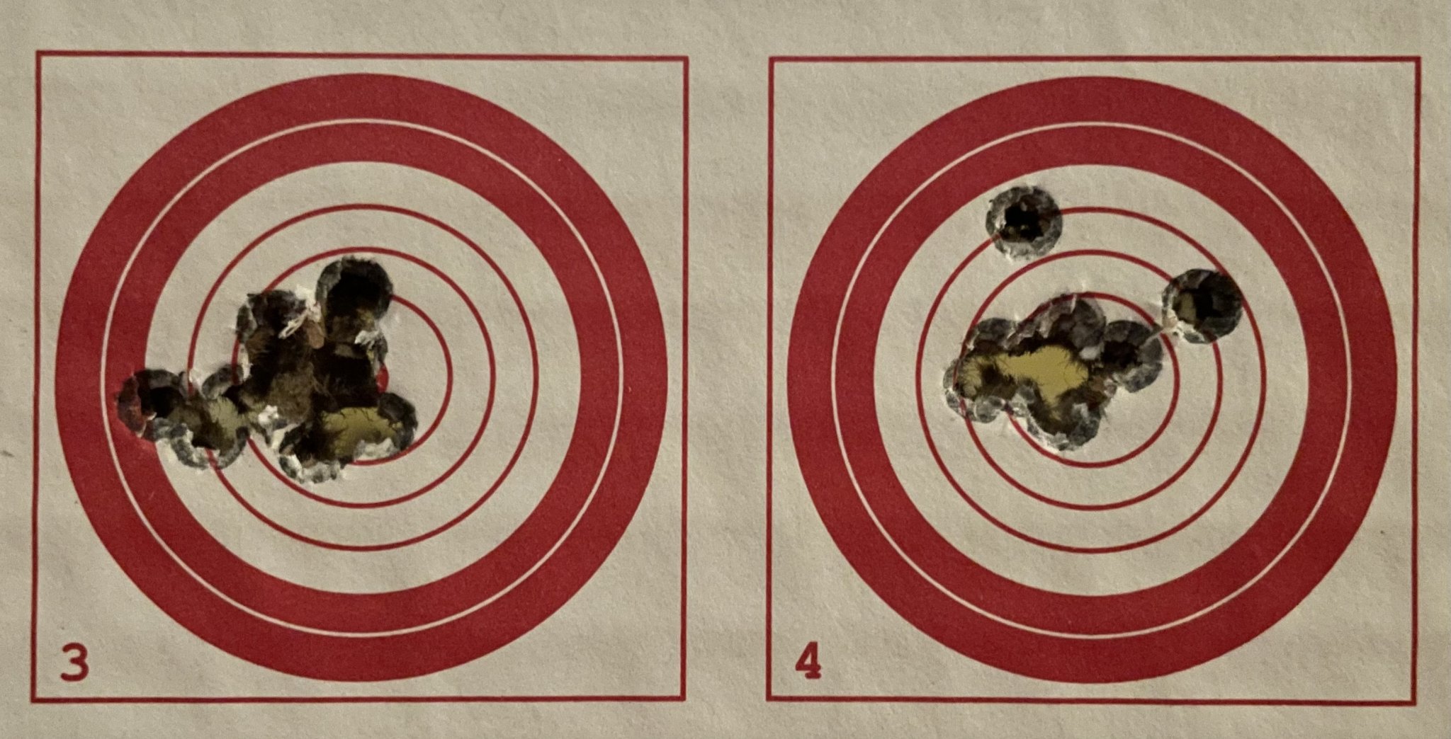

Shot these two 10 shot groups back to back a few weeks ago, bipod and rear bag. Rifle was my home built (hand fitted oversized parts) AMT wearing an 18” Green Mountain barrel, targets at 50m.

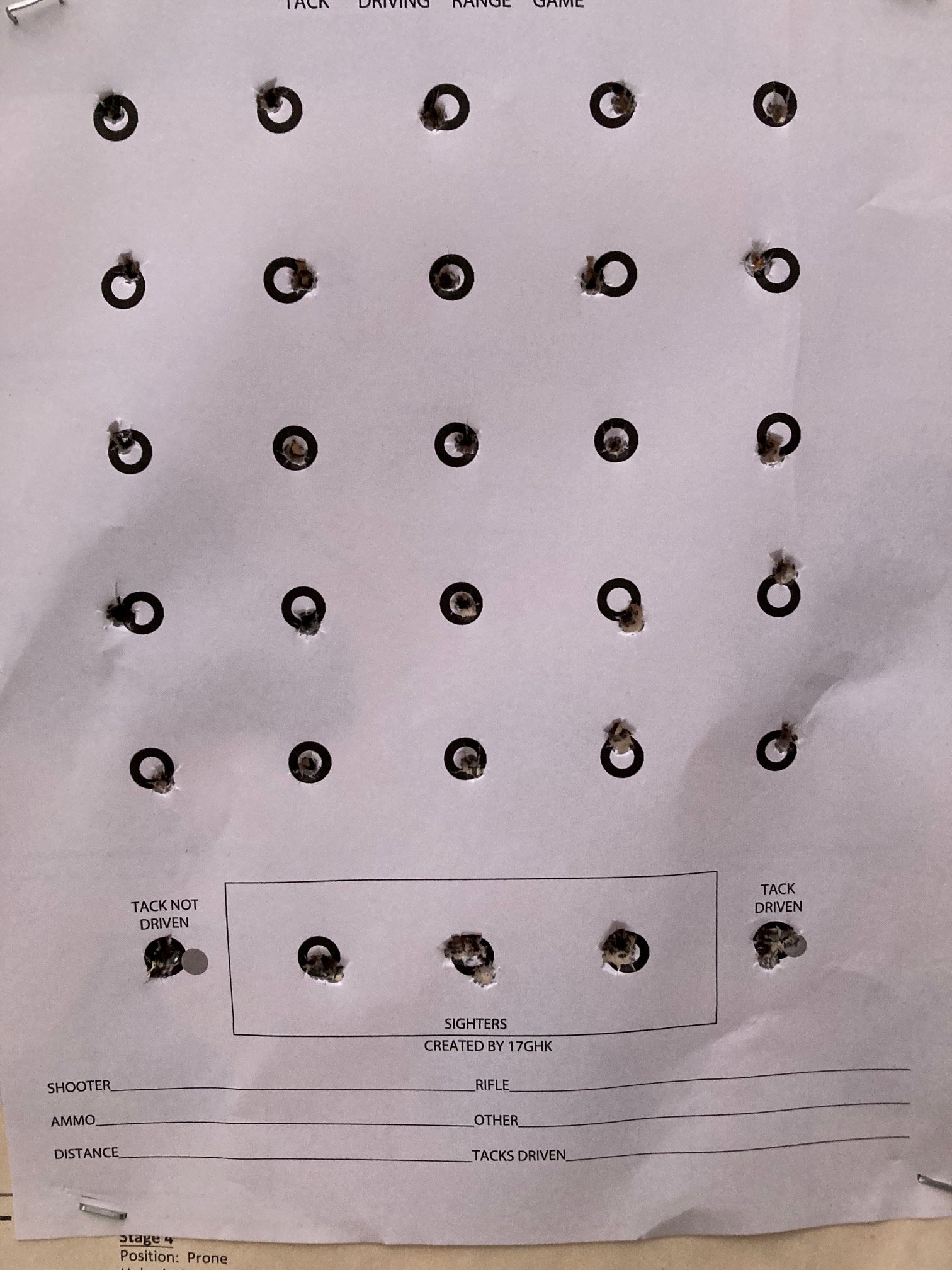

I have targets all set up and ready to shoot groups at 50yds with about 8 or so different flavors of ammo, just haven't had a chance to get that done yet. This is one pic I have , the plate is 6X6 and the distance is 185yds. I used both CCI sv and Norma Tac. If I remember correctly, I fired 8 rounds, missing one.185yds CCI sv and Norma Tac22.jpg
This was CCI SV at 25 yards out of my B14R. It's a clean 25/25 (and if we're counting 3x on each sighter at the bottom, it scores 39/25) The game is that if the bullet cuts the black into the center (.020") it's a 'tack driven'. I had a couple that barely made it.
Switched out to SK Standard + and started shooting at .15" diamonds--same 25 yards but even the one miss would have been easily inside the .20" 'tack'
Switched out to SK Standard + and started shooting at .15" diamonds--same 25 yards but even the one miss would have been easily inside the .20" 'tack'View attachment 7978221
Where can I get these targets? Nice shooting, BTW!
I downloaded the circle dots from Arfcom. I made the diamonds during a really boring work meeting. PM me your email and I'll send you the PDFs....but you have to understand that 25 yards isn't challenging to some of this group, and you have to shoot at 100+ to be taken seriously. :cool:

I found a lot of SK Semi-Auto that shoots great for the price point. I’m going back today to buy the remaining bricks. This is how it shot in my new Bergara B14R, Five shots at Fifty yards.

It has mv spread in excess of 120 fps per box, chipped, dented, scratched bullets,

I found a lot of SK Semi-Auto that shoots great for the price point. I’m going back today to buy the remaining bricks. This is how it shot in my new Bergara B14R, Five shots at Fifty yards.View attachment 7994100This is how it really shoots. These are rounds 6-106 through my new rifle.View attachment 7994101
