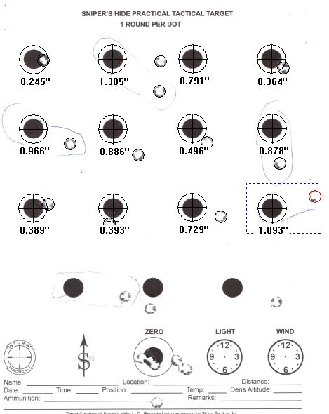

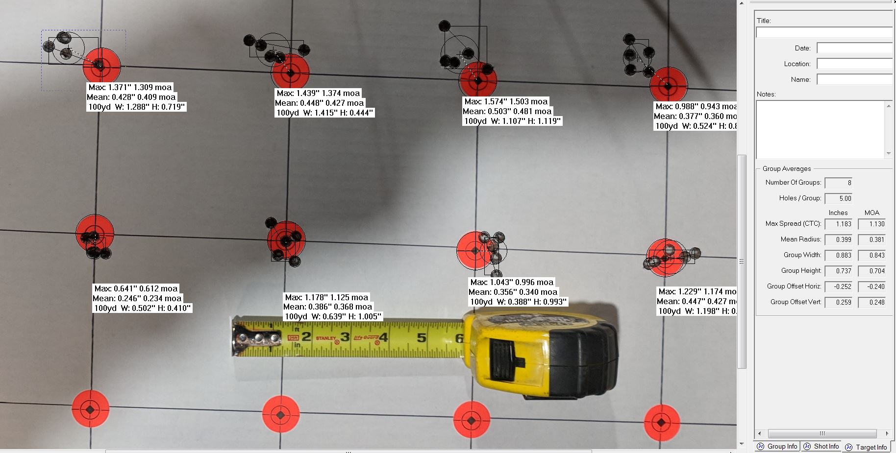

Made it to the range again this morning and noticed everytime I had a good start to a group I would tense up. 4 tight shots, slap trigger and threw the 5th shot. So I decided to try something different and printed out the snipers hide dot drill I had found in another thread. It is definitely harder than it looks. Below are the results. This was shot from bench with bipod and rear bag after tightening the rail the bipod is on. I did manage one group with a .4 MOA. I will call it more luck than skill but nice to see.
That is a pretty respectable shooting record there.
To be honest, to get much better you might need to first start checking out the exact limits of consistency on your ammunition and also on the rifle, as well as taking any wind changes into account. All you shots are within the realm that the spread in velocity on your ammo or slight wind gusts could be a big factor, as well as what the inherent maximum accuracy potential of the barrel is.

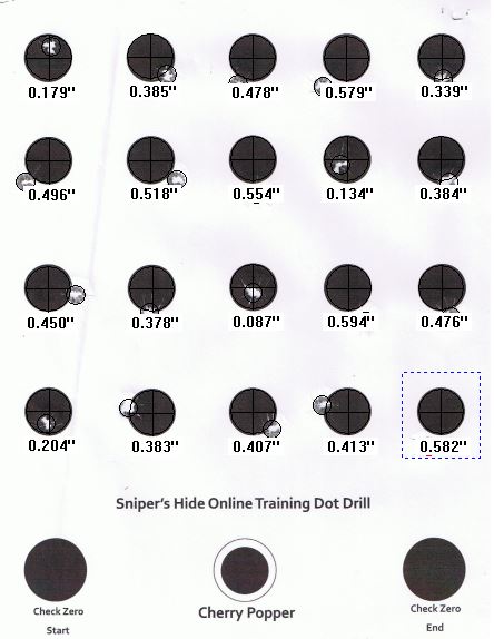

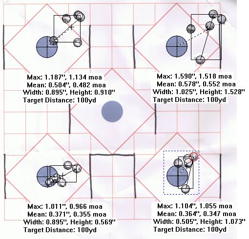

Thank You. Those targets were the exception. Below is the first dot drill I tried from prone. and then what I would call my average prone shooting. I did notice after these targets the rail section the bipod was on was loose and tightened it. I am not sure that would have tightened the groups much more.
The dot drill is not a group is it?
More a measurement of marksmanship than moa.
Think you are mixing apples and oranges.
Are you done testing ammo?
My logic for doing the dot drill was to see if it was me mentally throwing a group. I think what may be happening is after three or 4 good shots I am focusing on the group verse the reticle. I also noticed I will tense up and slap the trigger instead of settling in and focusing on the fundamentals. With the dot drill I was not seeing a group form and tensing up so each shot was focused on hitting the dot (not trying to create a small group). Not sure if I am explaining the thought process for all to understand. The composite was more of a check to see if there was consistency with the shot placement and the spread of the shots.

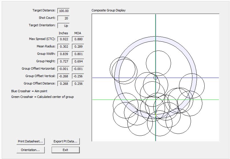

Since January of 2017 I've put 1960 rounds through the rifle and can do this from prone at 100 yards pretty much at will:
The above is 10 rounds (including a clean, cold bore shot in the upper left of the group). The grid is 0.1 mil so that group is pretty much 0.2 mils (0.68 MOA) center to center at its largest.

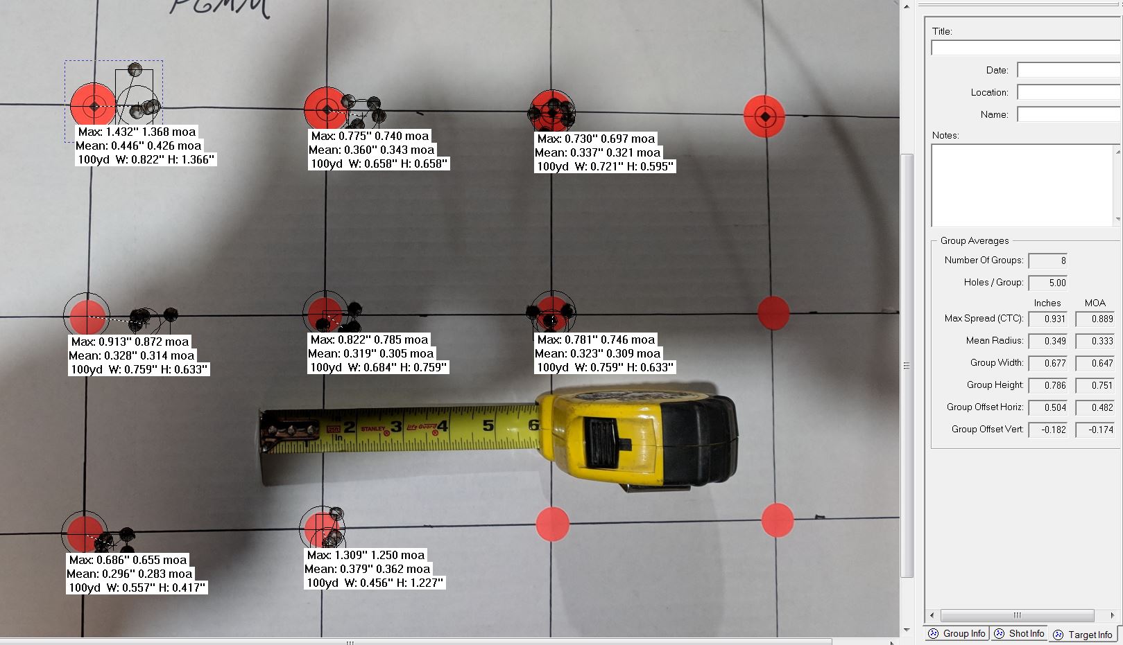

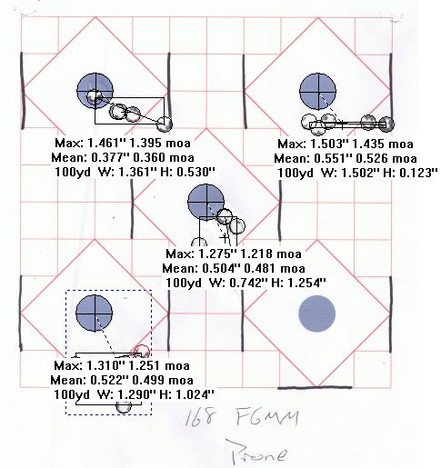

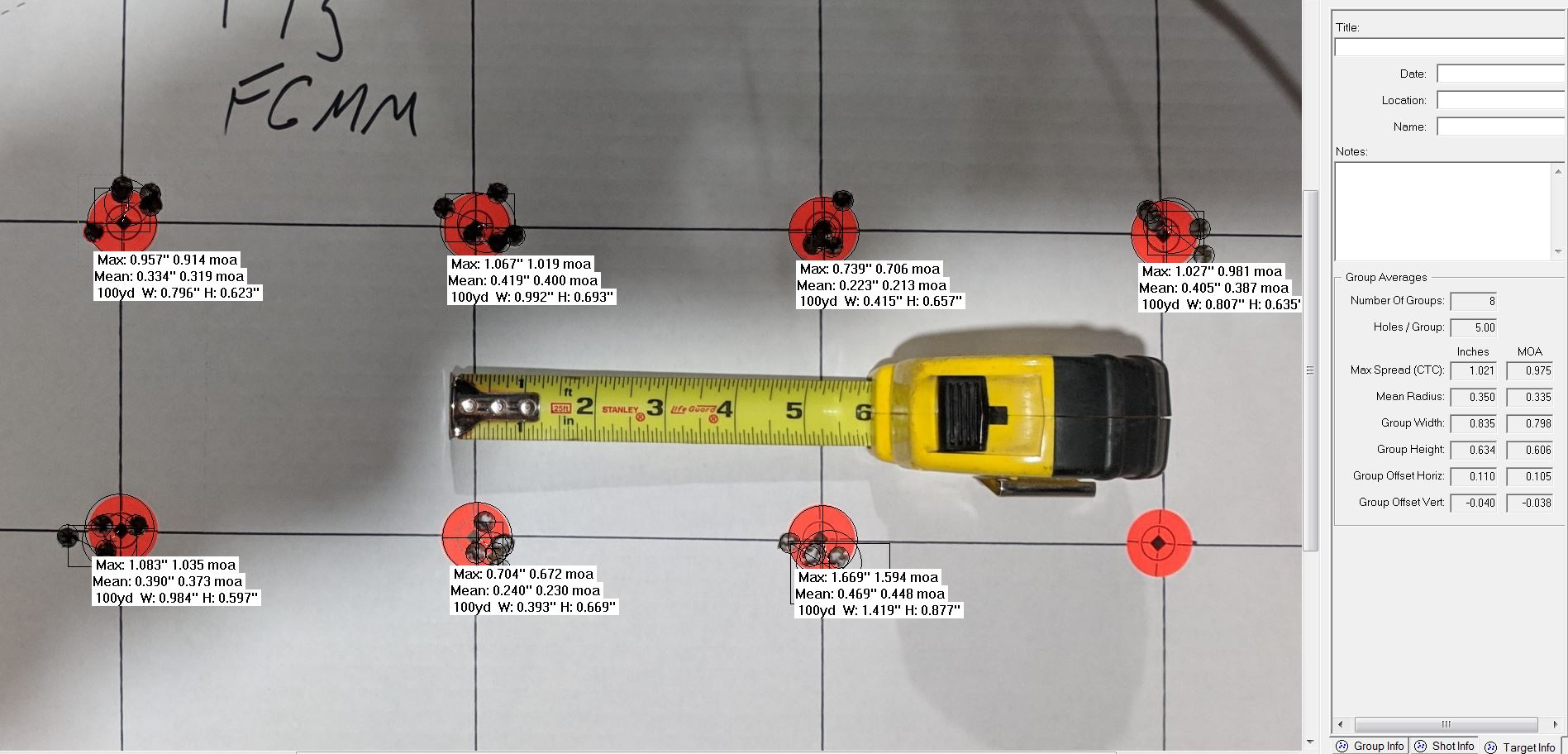

So since the last post I ordered a new rear bag. Ordered up some FGMM 168 gr, 175 gr, and 185 gr Bergers. I turned the shooting bench 90 degress so I had a straight flat side against me instead of the single protrusion off the table only supporting my right arm. This made for a more stable position. I also used my Caldwell tack driver bag as a seat to raise me up. Whoever built the seats must have been a giant as I am way to low compared to the bench. Just sitting on the seat I am not able to extend my bipod or use a good rear bag. I can say it made a difference in stability. I also went with no time limits today as I am on vacation and didn't have to hurry. I was sort of surprised by the results. In a previous post I stated my RPR shot the 168gr FGMM better than the 175gr. After looking at the targets I am pretty sure that would be splitting hairs between the three. Also, for the first time I knew where 90% of the shots were hitting after the shot before looking at the target. The amount of information I have gained form posts and member comments on this site is incredible.
Many people said, "find a guy to shoot your rifle to check if it's you or the rifle". So you found a guy who shot your rifle and ... sorry dude, it's you. That has been my story. It took me years to consistently shoot good groups because I didn't understand or focus on fundamentals. Maybe you're perfect and it's the gun, I don't know. I wasn't and I still struggle with natural point of aim, sight alignment, and shouldering.
