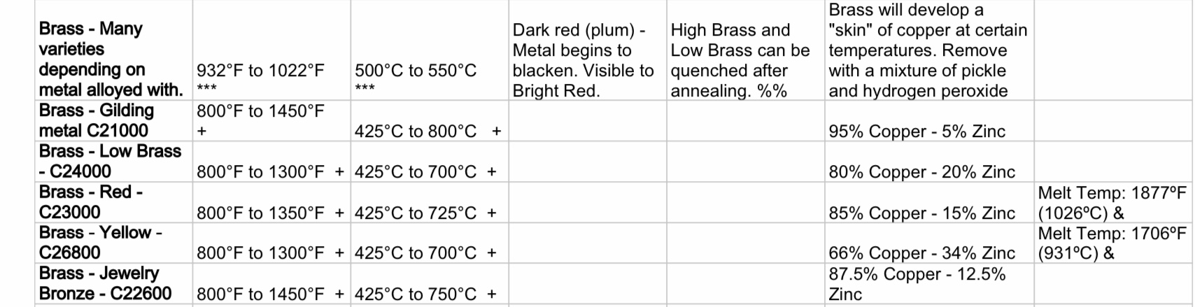

the above table is an annealing table. It lists 425-700c for the proper temp to anneal ammo brass. SBA is usually done at 500c for 5-8 seconds which is plenty to go thru .015” neck thickness, thus annealing it.
The AMP article has been debunked many times on other forums. Annealing is not that complex. Get it to a specific temp and it does the rest. Feel free to google the amp article dunked and see both sides.

That chart doesn't show the time vs temp relationship of annealing. Here let me help you out, so you can stop wasting your time. :LOL:
Brass will take 1 hour to anneal at 600F. Can you leave your brass in your salt bath for an hour?
I understood your opinion on salt bath the first time you stated it. My personal opinion is that salt bath annealers are probably wasting their time. I base that opinion on the research of a company that builds machines for annealing rifle brass. As well as research into the process of annealing brass, I.E the time temp relationship, and I don't think your salt gets hot enough.
I googled Amp salt bath annealing article debunked and nothing came up. Feel free to post a link to the research.

Been doing SBA for a while and while I am sure that it does not reduce the hardness of the brass to a fully annealed state it does reduce the harness. I am running it quite a bit higher than 500c and a little longer than 5 seconds.
With that being said Im currently building an induction annealer because SBA is like trimming cases, dreadful.
Oh and I have never had cases last 30+ reloads before using SBA.
I wanted to test higher temps, but the warning of 550c will boil the salt thus causing sarin gas in your shop...
Right off of the ballistic recreations website
"NOTE: If heated above 590°C this salt will begin to decompose, releasing hazardous nitrogen oxide fumes . At higher temperatures the salt becomes a powerful oxidizer that may cause spontaneous and violent ignition of flammable materials including wood, wax, oil, plastics, and light metals. I do not recommend using this salt without a temperature measurement device that is known to be accurate in the range of 300°-600°C."
There are various salt formulas, the working range can be from 300F to 1700F.
Here are some salts with their information sheets, look for yourself.

Which one? Neutral salt C is the only one I see in the higher temp range for non-ferous metals. But it specifies that getting nitrates, cyanides, cleaning compounds, or or oils in the salt will ruin it, and it will need to be dumped. Unburned powder is full of nitrates.
Any of the quick temper products can be used for non ferrous metals most all can run up to 1100F, you really should clean the brass before SBA.
