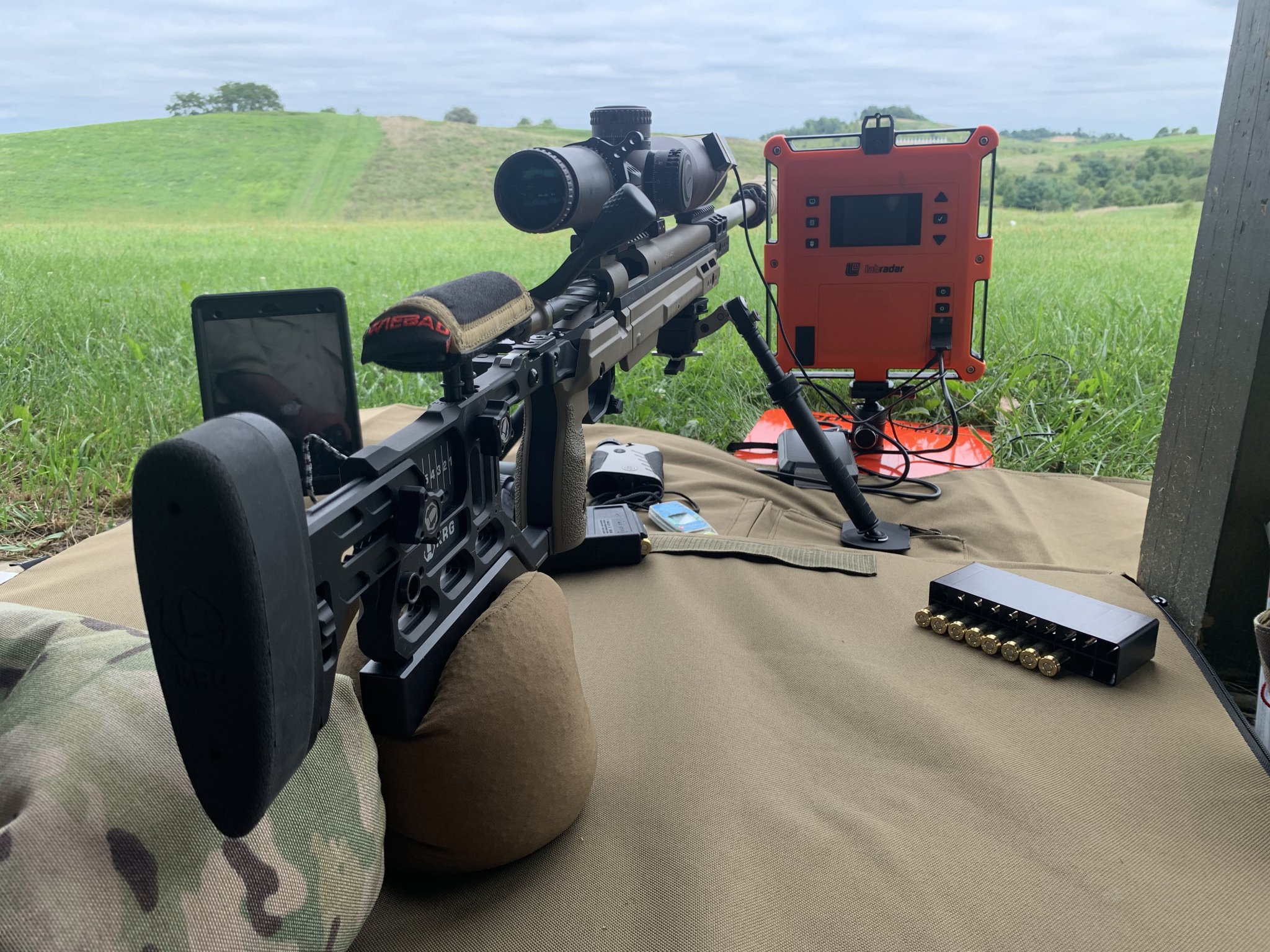

6.5 CM / 43.7 grain of N560 with Berger HTLR 153.5 grain on Lapua Small Rifle cases and CCI BR4.
Rifle is a Bergara with 24" barrel.
At 1000ft altitude and temperatures between 60 to 95 Farhrenheit Kestrel velocity around 2620 to 2720fps.
groups 1-1.5 moa at 1500 yards
Just found this thread, but jumping in.
Using the 153 a tip, I've pushed to a mile a few times, and at the KRG extreme the past two years, have pushed them past 1 mile(1800-1900 ish), as well as 220 and 2350.
Even using the 153 and having success with it, I'd say shots within 1500 are fair game, 1500-1800 is solid 2nd round impact territory, and 1800+ is really just for fun.

This is my 6.5 mm "artillery piece" at TV. BTW, the LabRadar is gone. I switched to the Garmin which is much better.

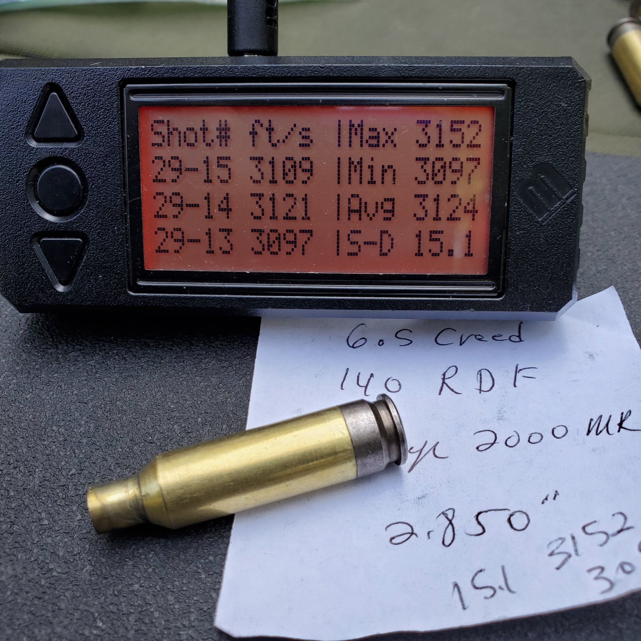

I run 150 SMK and 153 Atip at 3000 fps with RL 26 in the 6.5 CM, with hybrid cases in the 24" barrel. I have a 26" Bartlein to install after this one is done.
Photo of magnetospeed 140 gr bullet testing to well over 3100 fps in 6.5 CM with the hybrid cases...if ya want a little more performance.
Help getting to 2000 yds if interested, but not necessarily needed.
