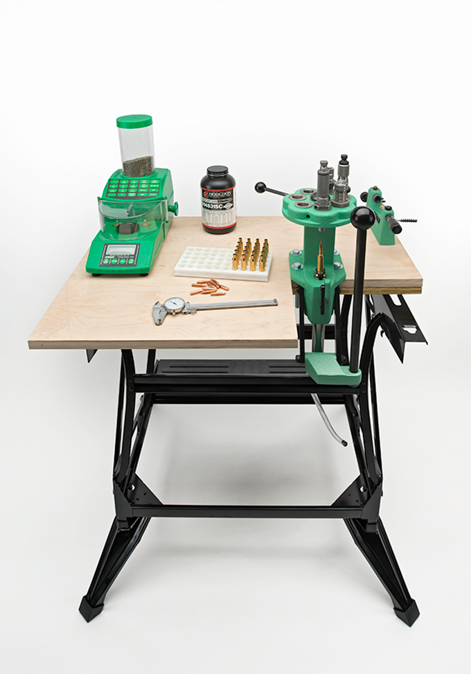

If you have storage elsewhere you can get away with a very small bench/press area .
