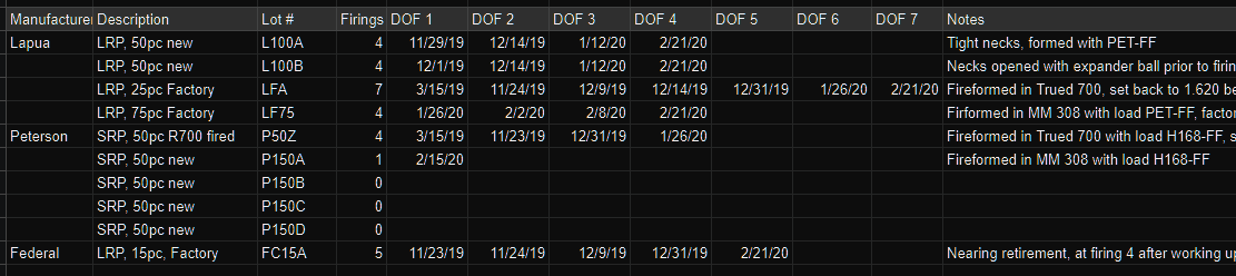

It all depends on your use case and how much you practice. No matter what, take lots of notes. I keep an extremely detailed spreadsheet of all of my brass for a particular barrel. Even if I buy a 500 piece lot, I separate it out into 100 or 50 piece sub lots for the sake of record keeping. Example:
If you are just hunting, I'd buy a 50 pc lot. That's plenty to work up a load and then practice & hunt for several years.
If you just plink around at the range, a 100 pc lot is probably fine. I rarely shoot more than 50 rounds of 308 in one practice session.
If you are competing in 1 day matches, 200 pieces is about right. 100 pieces are designated as match brass, 50 pieces as practice brass, and then 50 pieces of extra for load dev and replacing lost brass.
If you plan to run 2 day matches, 250 or 300 pieces would work with the same strategy as above.
