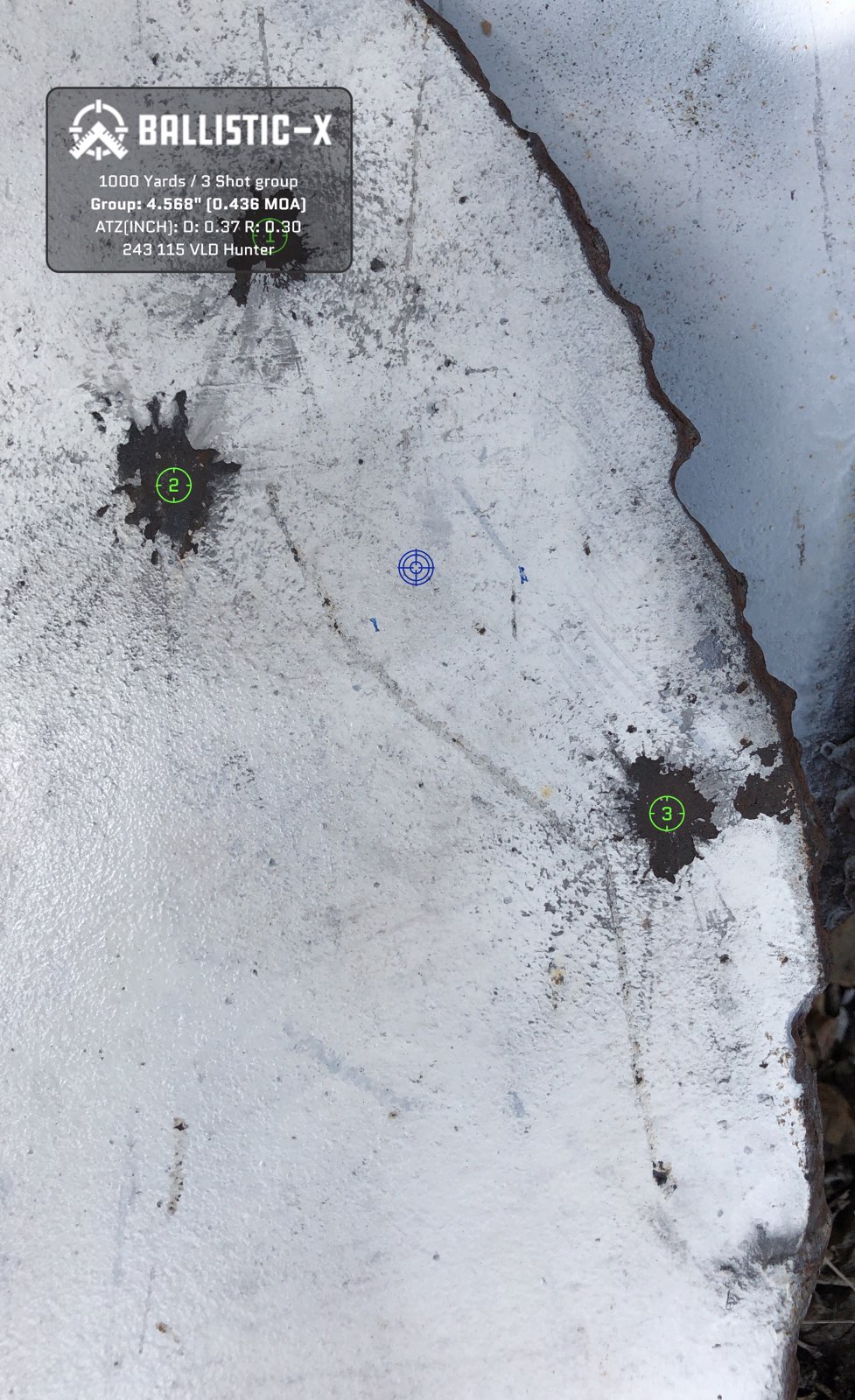

    Part of me wants to have some fancy dies. The other part of me says my Lee full length sizing die and dead length bullet seating die work fine.
    This is only 3 shots. I suppose if you were to shoot a 10 shot group it would open up a lot. I was pretty lucky, I loaded some up and they shot great, upped the powder charge a little and they are slightly faster and still shoot great.
    What kind of accuracy are you looking for? How much do you want to spend? Besides having fancy dies, what goes into your reloading process?

    Very nice, what’s the rifle combo?
    Remington Sportman 78. Cheap 700 made in the 80s. Criterion 1:7 26inch MTU 243 match chamber. 115 Berger VLD hunting bullets.
    Guys on here recommended the Criterion barrel. I am super happy with it. The cool part is if you like to do things yourself you can put the barrel on and headspace it yourself.
