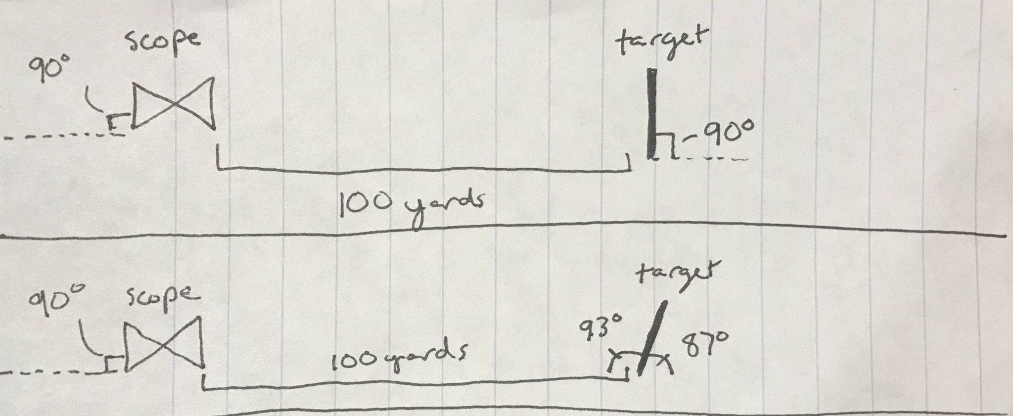

Sorry if I didn’t explain that well. Does this drawing help illustrate the point?
At the top where both are the scope and the target are 90 degrees, and assuming that they are directly parallel to each other if the scope dialed from 0MOA 30MOA, his scope should have dialed 31.41” (30MOA*1.047=31.41”) down on the target.
However, in the second case, the target is angled slightly back at a 3 degree angle. Using the numbers I gave (I will email to see if I can get the scope manufacturer’s exact numbers) will appear to cause a 1.8% error in scope tracking, but it’s really just because of the angle of the target. Instead of dialing 0 to 30MOA and coming 31.41” down, it will instead appear to have 1.8% error. 1.8% of 31.41” is 0.57”, so you would get 31.41”+error (0.57”)=31.98”. (You might subtract error in this case instead of add, but hopefully this helps explain my point).
