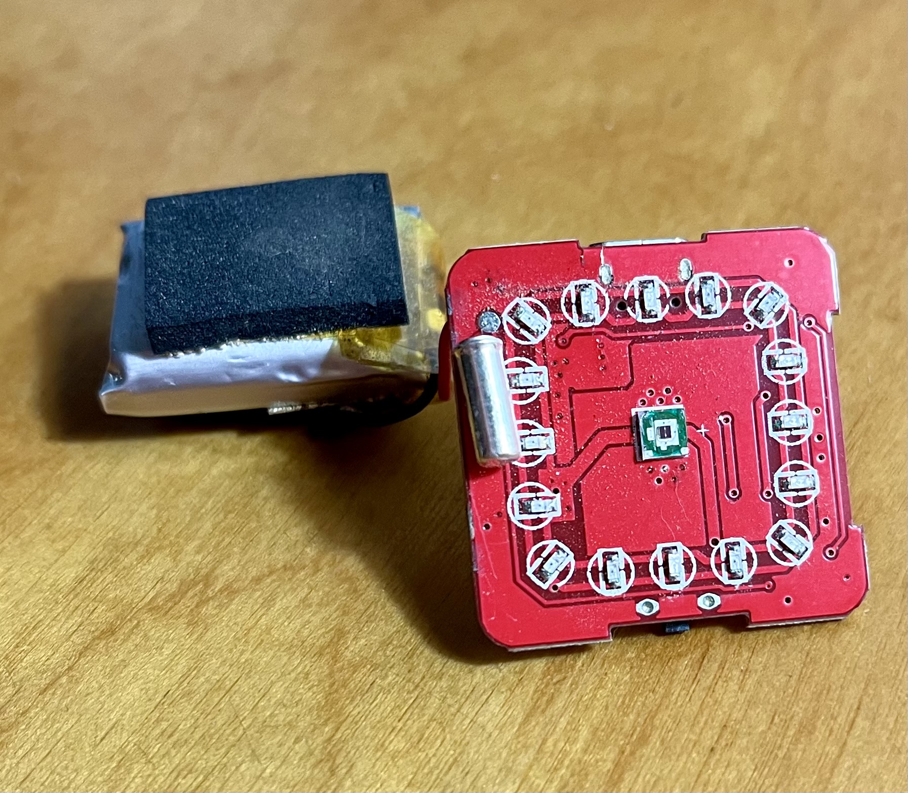

Do you still have that Hornady unit with the hole in it?
I don’t have that one handy at the moment, but this is one of 4 HIT indicators out of the five I had out for a match, lol.
😆 Or the guts of it anyway. The case was shot clean off.
Now I use two per target. Odds being what they are. Funny though that last match I had two on each target and not one was hit. 🤷🏻‍♂️

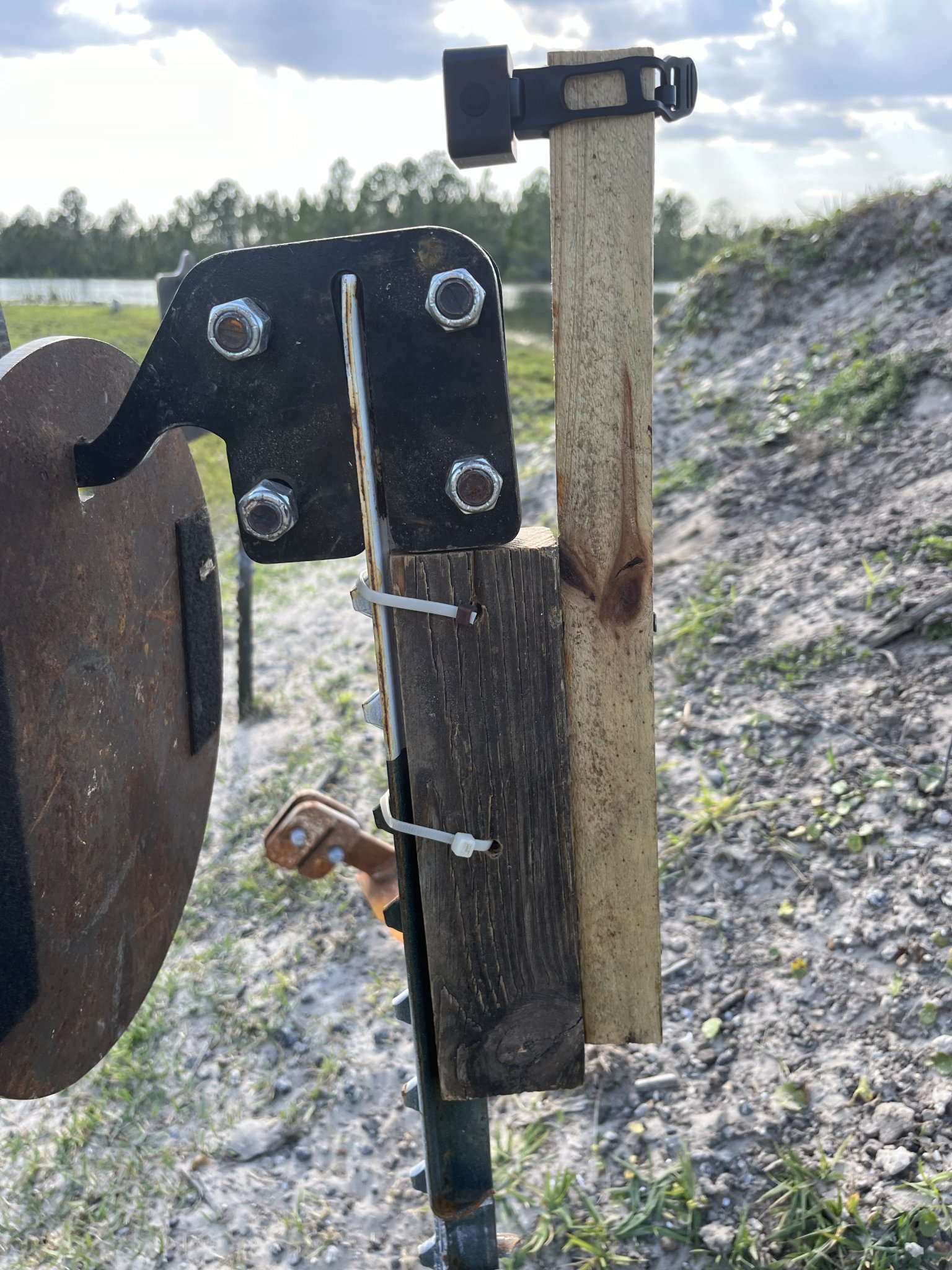

The HIT unit is the Hornady one. The problem I've encountered with them is depending how you attach them they sit proud of the target face and spall takes them out, they don't last long unless you space them back behind the target face.
The caldwell units attach to the back of the target and do not sit proud so spall wont take them out, there is still the chance of putting a bullet through it. I've seen a couple that got shot at a rimfire match and the LED's that were not directly hit still worked.

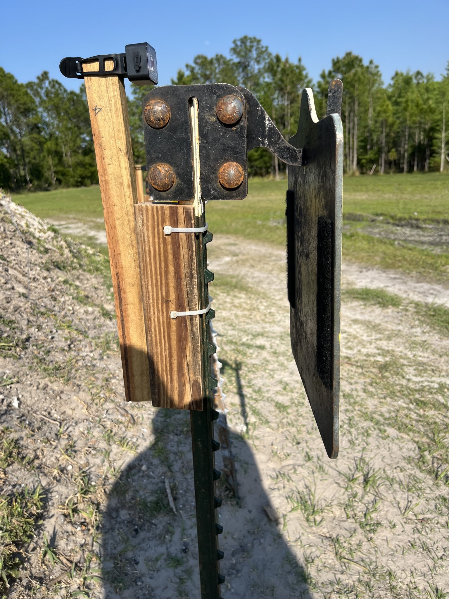

That is true about the differences, but for my matches here I whipped up a quick fix for that the night before the first time I used them. It looks like crap because I just used a skil saw and a couple old pieces of 1x2 and 2x3, but it works well to keep spall off the HIT indicators.
The ones I’ve lost have all been direct hits, odds being what they are.

I have a couple of the HIT indicators. Currently have only used them to 550 yards. The steel targets at this range are on hangers made of rebar (2 vertical, one horizontal). I took a couple of 3 ft pieces of EMT and used some hose clamps to attach those to the uprights, then put the HIT indicators on them, well above and to the side of the gong. This worked fine. The vibrations apparently easily transmit through all the steel.
