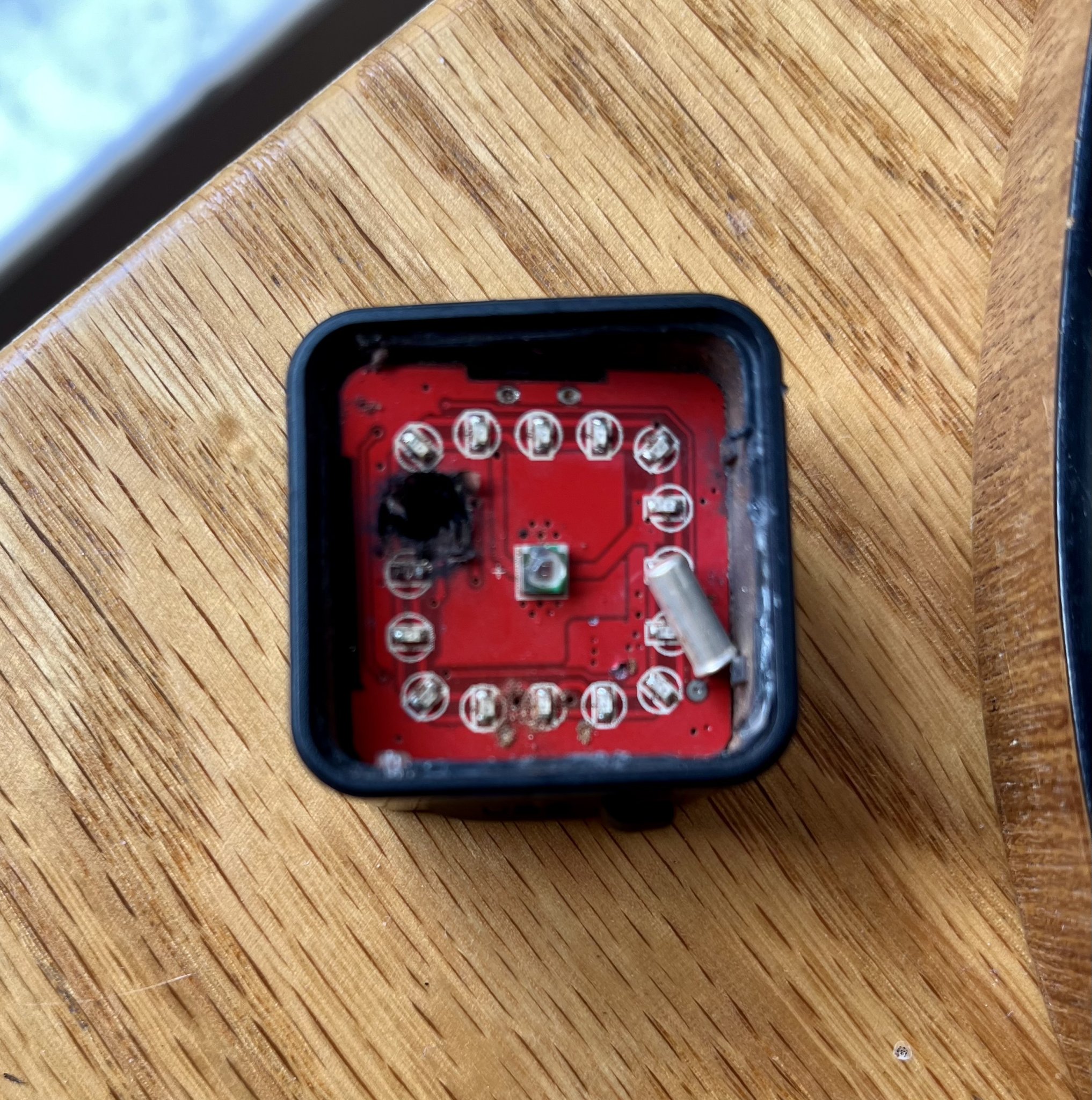

I don’t have that one handy at the moment, but this is one of 4 HIT indicators out of the five I had out for a match, lol.
😆 Or the guts of it anyway. The case was shot clean off.

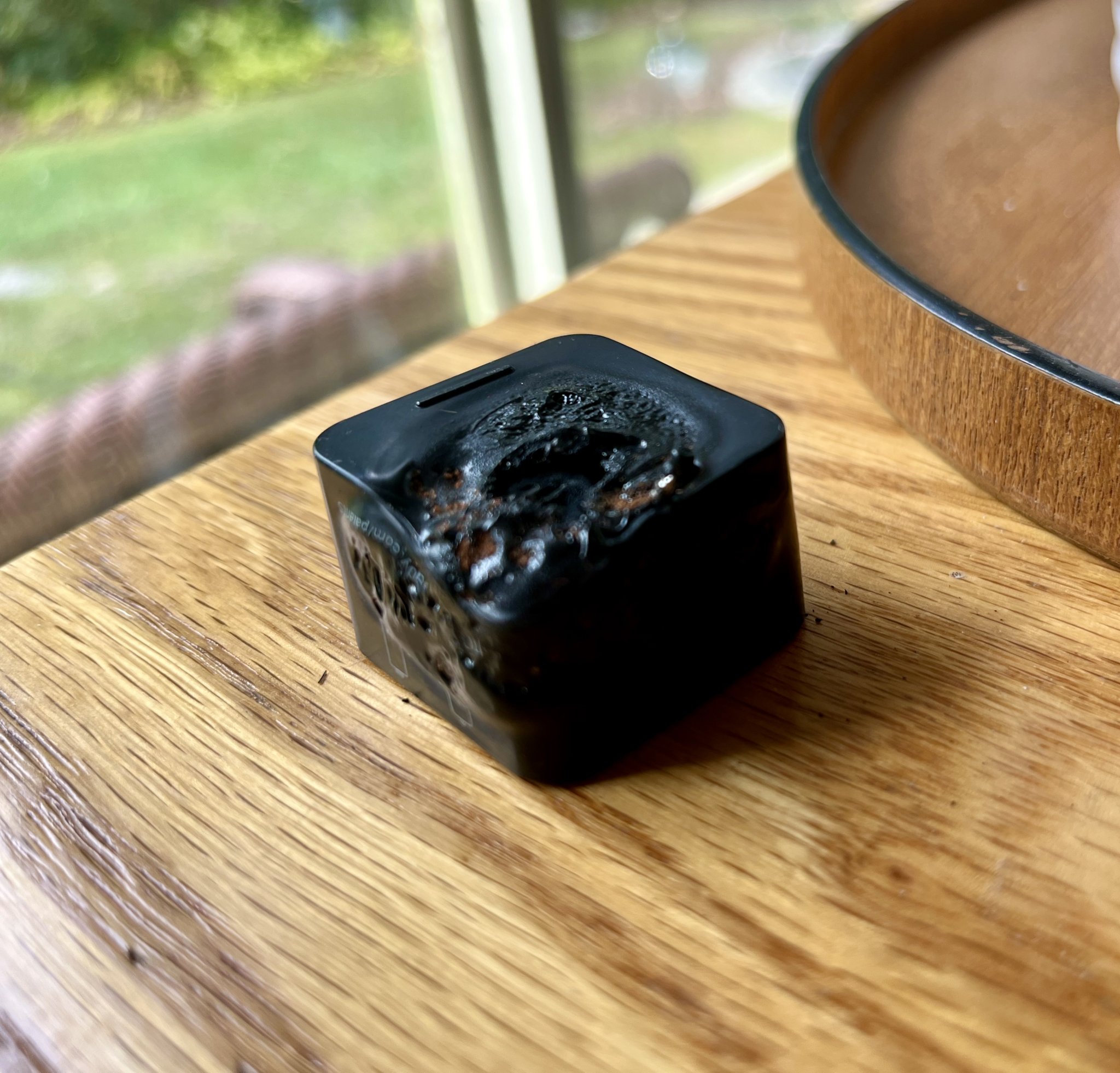

Here’s the HornyDaddy HiT indicator that @Mike Casselton was referring to above. This was one I lost at that same event. These were all attached well back from any spall but odds being what they are. This one was at 1220y.

Did ur Caldwell units that got hit stop working? the ones that got shot with 22LR still worked where the LED's weren't destroyed.
Center fire rounds might cause to much damage?

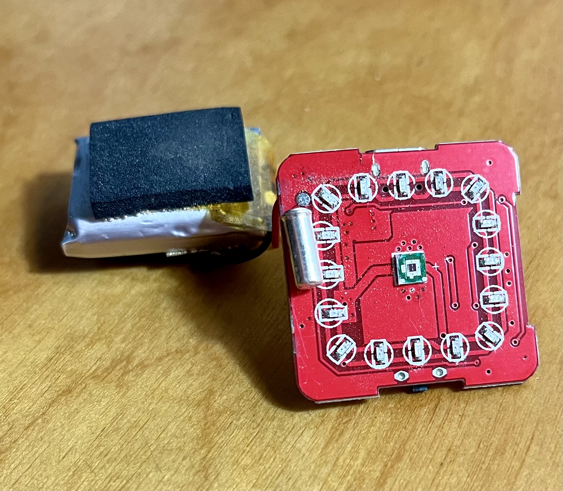

That Hornady unit looks like it had some sort of electrical fire also, LOL.
I think one was 300wm and one was 300 NM. Both using 215-220gr clad bullets. They stopped working. One was blown off and up. The other shattered.
The Hornady ‘fire’ was likely from the lithium rechargeable battery taking it on the chin. It definitely let the smoke out, as we used to say.

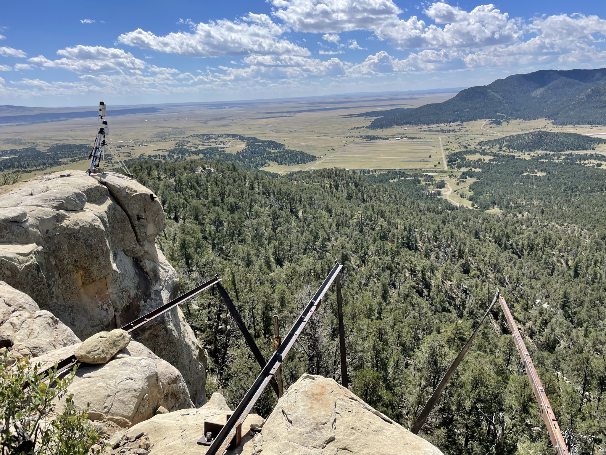

Cameras with network links over long ranges. This is only 2400ish yards but they should be fine out to 10 miles or so. You can't really just stick a long zoom on a camera and call it done because they are hit with the same mirage issues that anything else is subject to.

This is beautiful. Where is this at?
