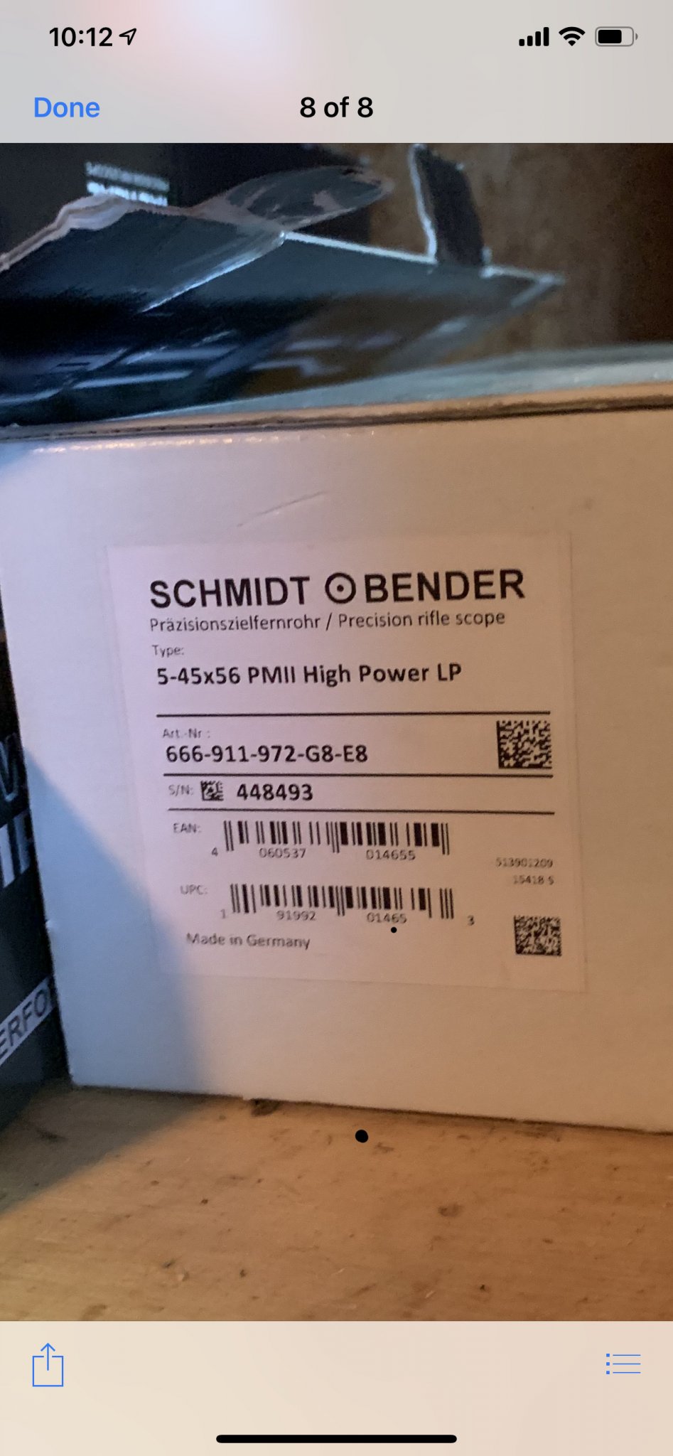

I have a new gun in the works, a 6XC being put together by Accurate Ordnance. I have a Nightforce 5-25X56 ATACR and a S&B PMII 5-45X56 on hand. I know both are great optics, but is 5-45 ridiculous for shooting club style matches? (PRS style) It’s on a 50 BMG that I am selling and thought breaking up the package may make it easier to move the rifle as well. I’m not a new shooter, but I’m new to the match scene. Thanks for your input!
Nah, that 5-45 is useless on anything, I’ll give you my ancient family secret chicken n dumplin recipe for it and take it off your hands.
On a serious note...
I don’t shoot matches, so can’t comment on that use, but I wouldn’t hesitate to use it. If I could afford them, I’d have one on my 308. Hell, I’d put one on my rimfire.
I think the ATACR might suit a PRS build better, but I also don’t have any experience in PRS so take that for what it’s worth.

So as much as I like S&B, I would never even consider a 5-45x. I have a 5-25x56 PM2 and sometimes it feels like a bit much.
I’d only save the SB for f-class if that’s a future possibility or you shoot a lot of paper at 200-300. If not I think selling it for back up funds or another back up 5-25 NF is what I would do if it were me. Having a 7-35 and it’s way more than enough for me.

i think im in the minority, i have a march 10-60 and the sb5-45 along with the other "regular" mag ranges
not speaking about prs but i find my self trying to use more mag when possible
when looking for little groups, above 35-40X feels like cheating
if i had a 5-25 id swap with you in a second

The 5-45 x56 is a great scope for going to the range and all kinds of things.
It is however rather large and heavy if weight is a big concern.
One other thing is that if you are only using it for matches and don't go high magnification much, you may find that you have to work at not dialing it too much during quick changes in distance.
I think however you'll find that 5x is way wide enough for just about any comps or standard shooting work outside of close up game hunting.

Is that Schmidt FFP? If so, how thick do those reticle lines get at higher magnification? If not too thick at high magnification, then how difficult is it to see the hash marks at lower magnification? What range of magnification is ideal for the reticle and is that a good range for match use?
A FFP scope is usually better for PRS style matches since there are targets at various distances and you’ll need to adjust the magnification rather than shoot at a magnification for which a SFP reticle is indexed.
