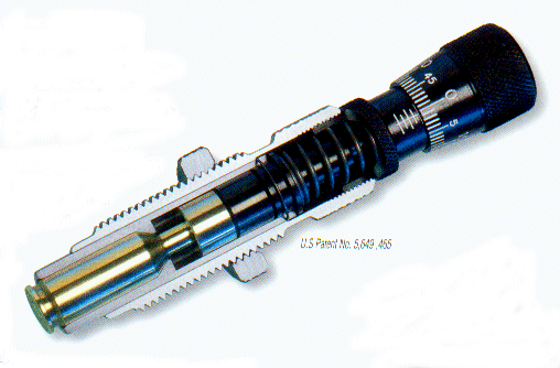

Are you using the Redding micrometer adjustable dies?

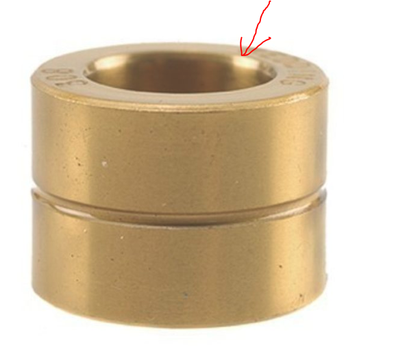

Its any bushing regardless of the neck/full length designation of the die. The micrometer just allows you to raise it higher up easier.
See how it has a chamfer/beveled edge? You wont ever get it to 100% of the neck.

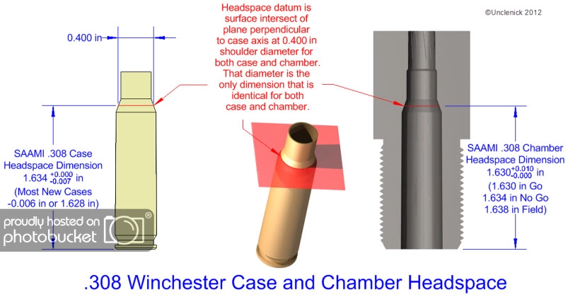

Generally the .002 is just the dimension from the case head to the shoulder datum. The rest of it is what it is. The base usually get sized .001-.003, the shoulder diameter is .004 or so as you said, the .007 isnt a great match for your chamber in that one scenario.
I understand I’m not necessarily worried about having the .002 all around more so I did not not what to look for before in terms of what is too much and what is not enough reduction I have been using the die I have that is better fitting but didn’t know if the .004-.005 was still too much and should I continue looking for a better fit or just call it good

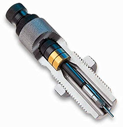

Put your expander mandrel ball back in the die and you should be fine.
Put your expander mandrel back in the die and you should be fine.
Thanks @spife7980. I see your username come up a lot here - thanks for the help you provide to the community.
I don't have a separately-sold mandrel (yet). All I have is the expander which came with the die (which I swapped out for the smaller decapping pin retainer). Will this suffice, at least to get started?
