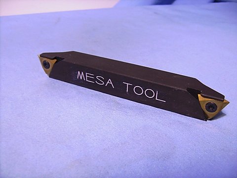

I like the insert tools that use TNMC inserts. They're strong and just seem to last forever.

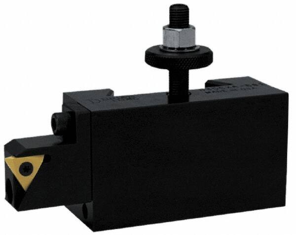

I have the Mesa Tools tnmc holder and a Dorian BXA tnmc holder. Both work well.
