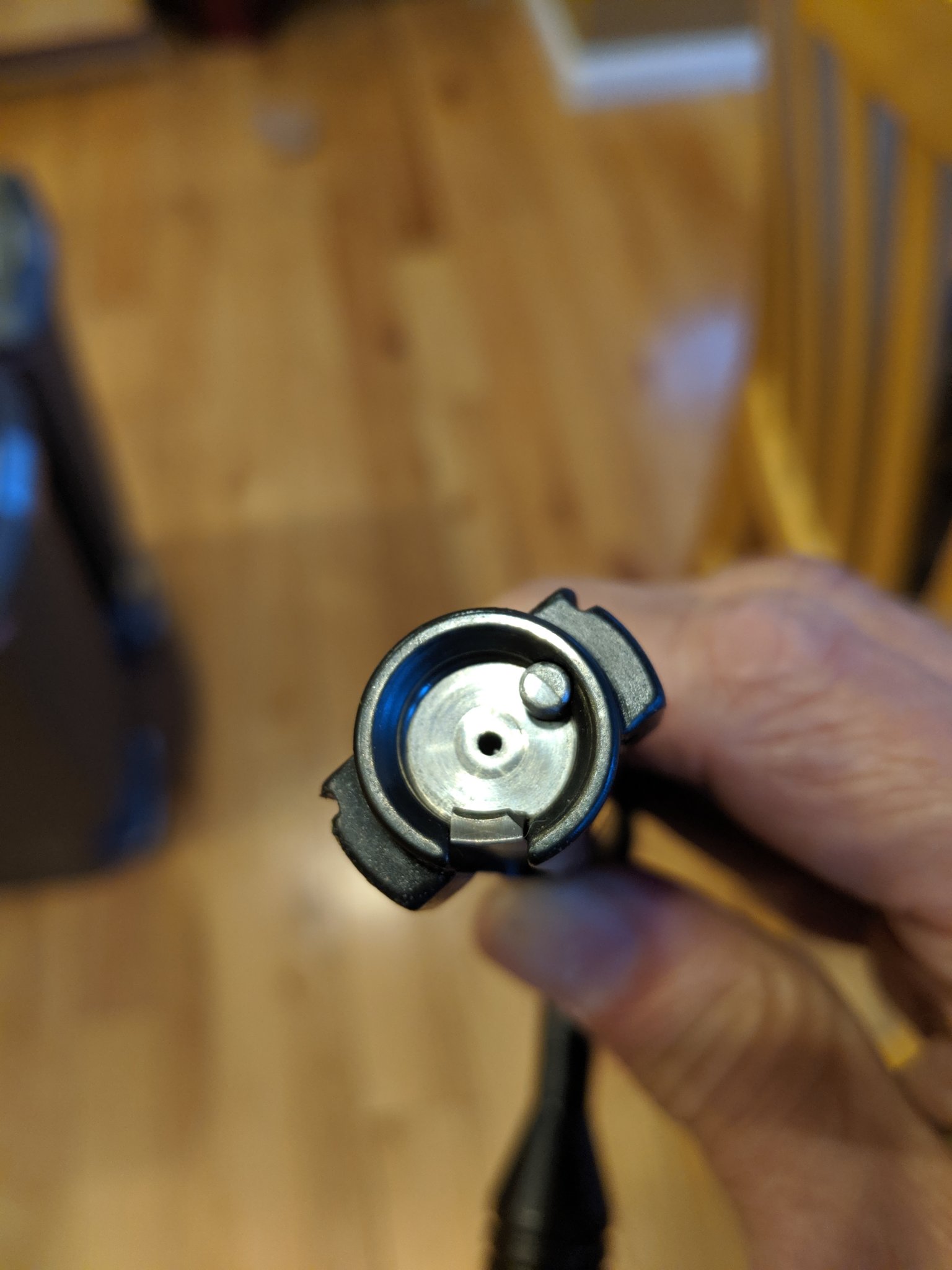

Pretty much sums it up. Wonder what his bolt face looks like

Here ya go Jimmy
