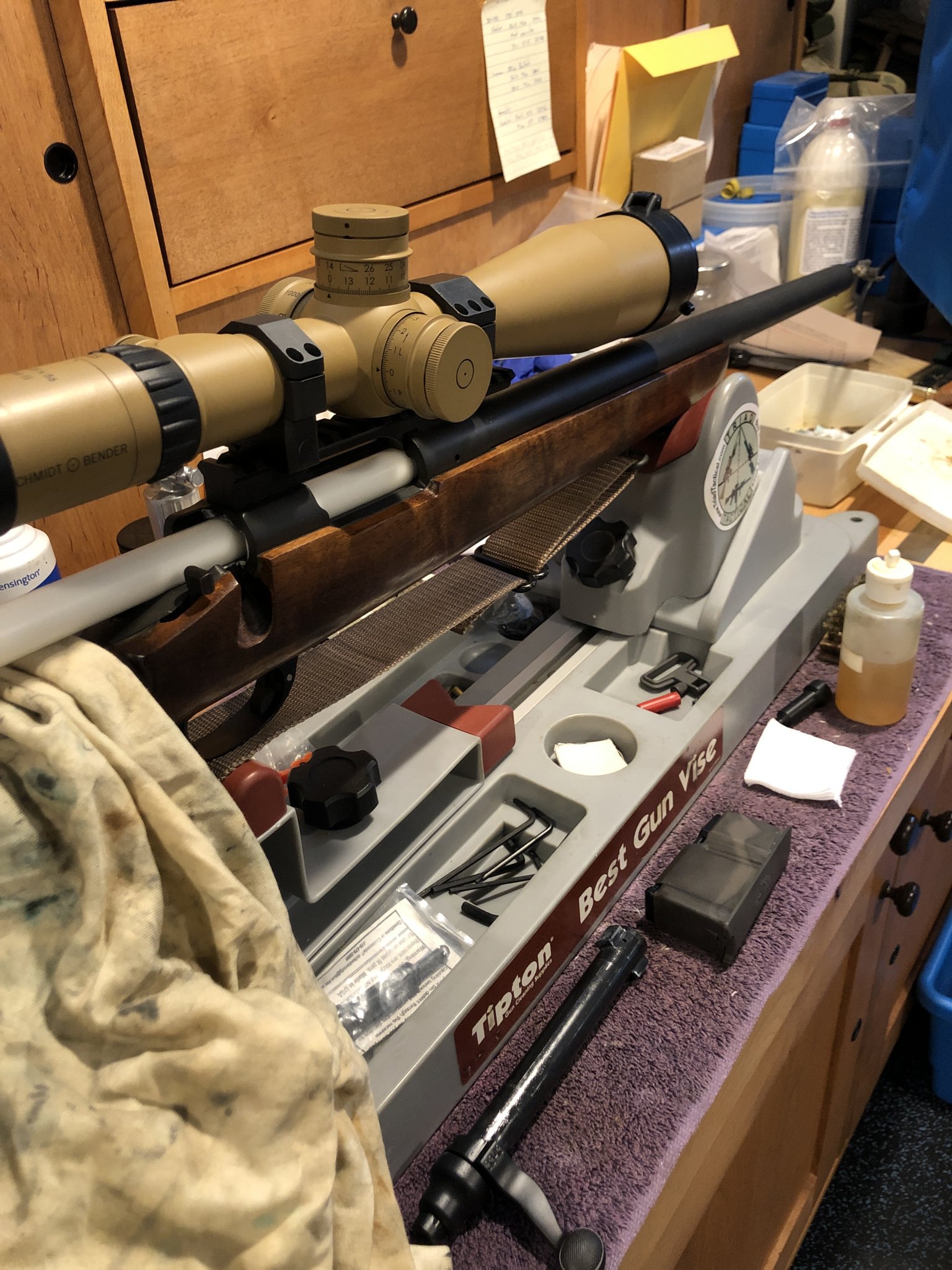

    I shoot infrequently now.
    Knowing they will be in the safe awhile they get about 8 hours of soaking with Hoppes and frequent patching before finishing with a light coat of kroil before going back to the safe muzzle down.

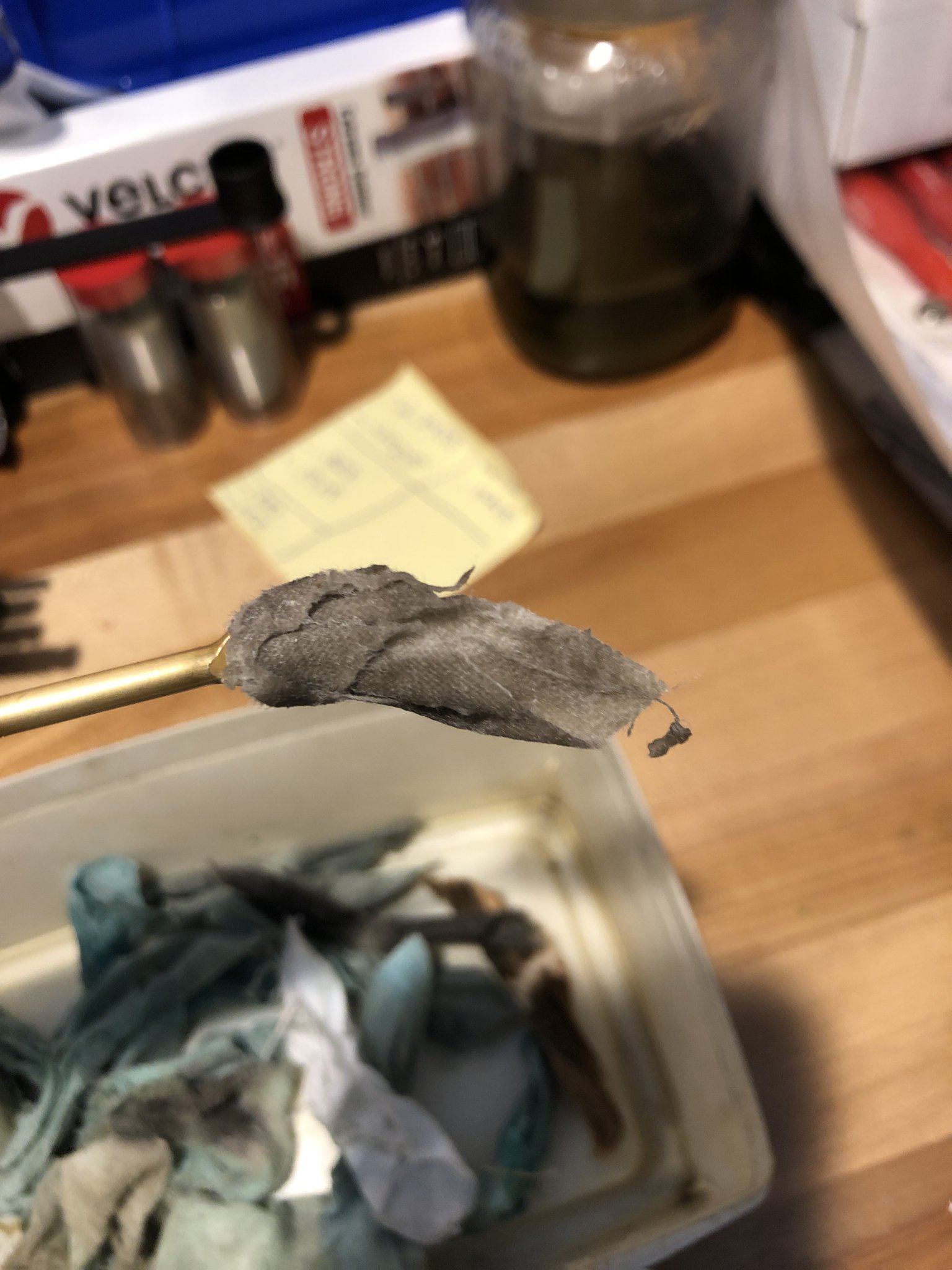

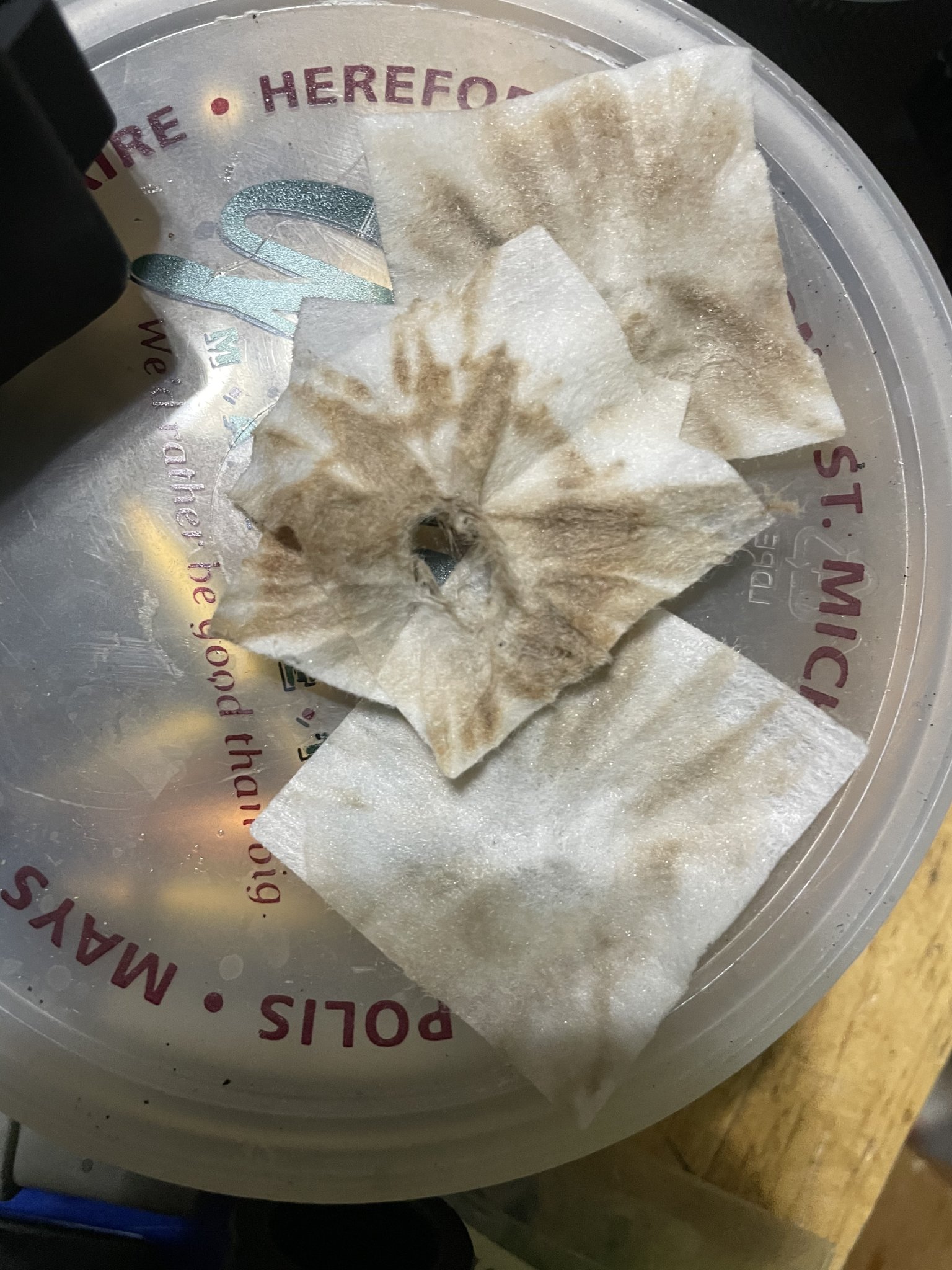

    Twenty rounds FGMM.
    First patch.
    It will get nothing but Hoppes and flannel.

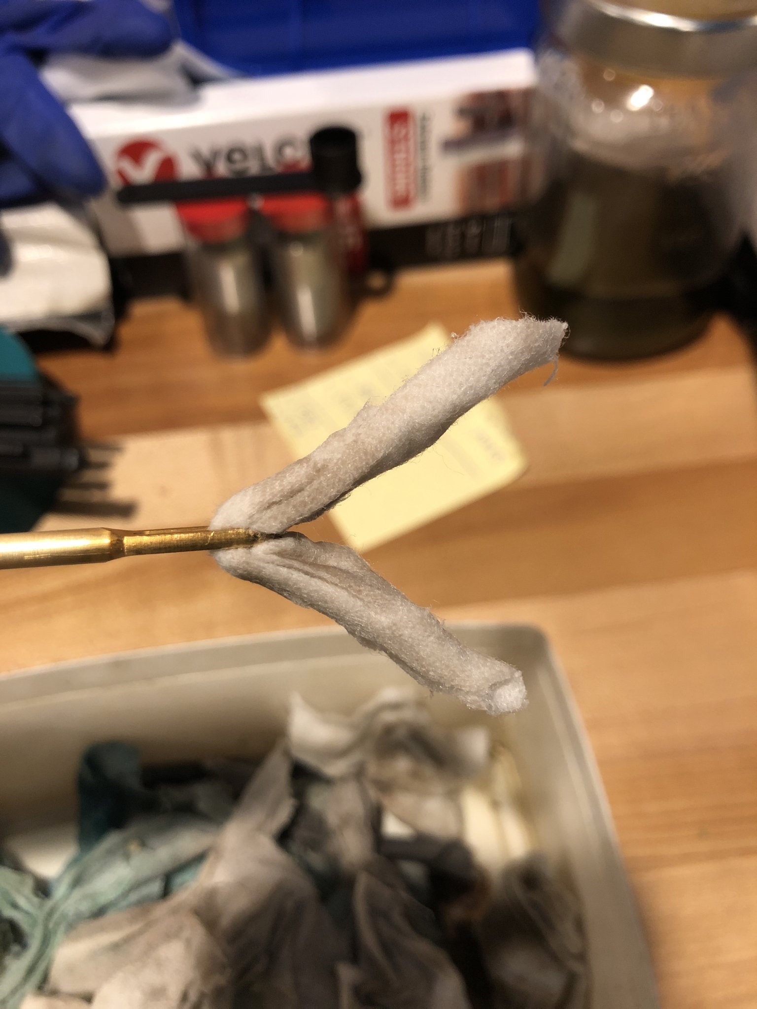

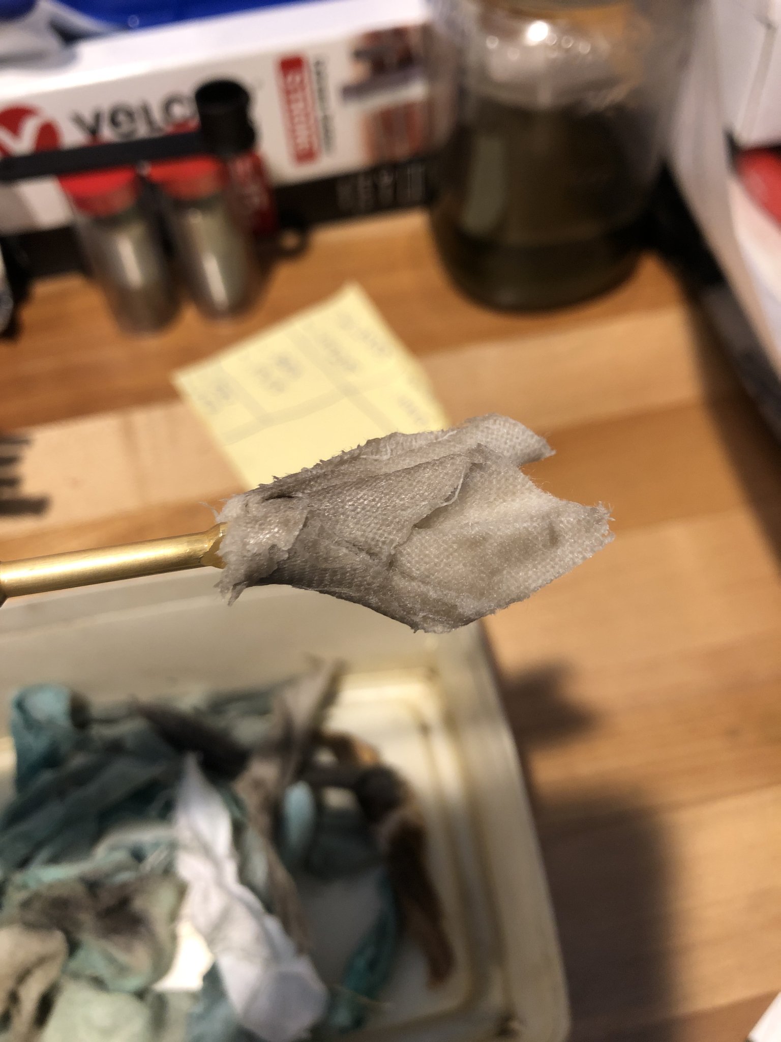

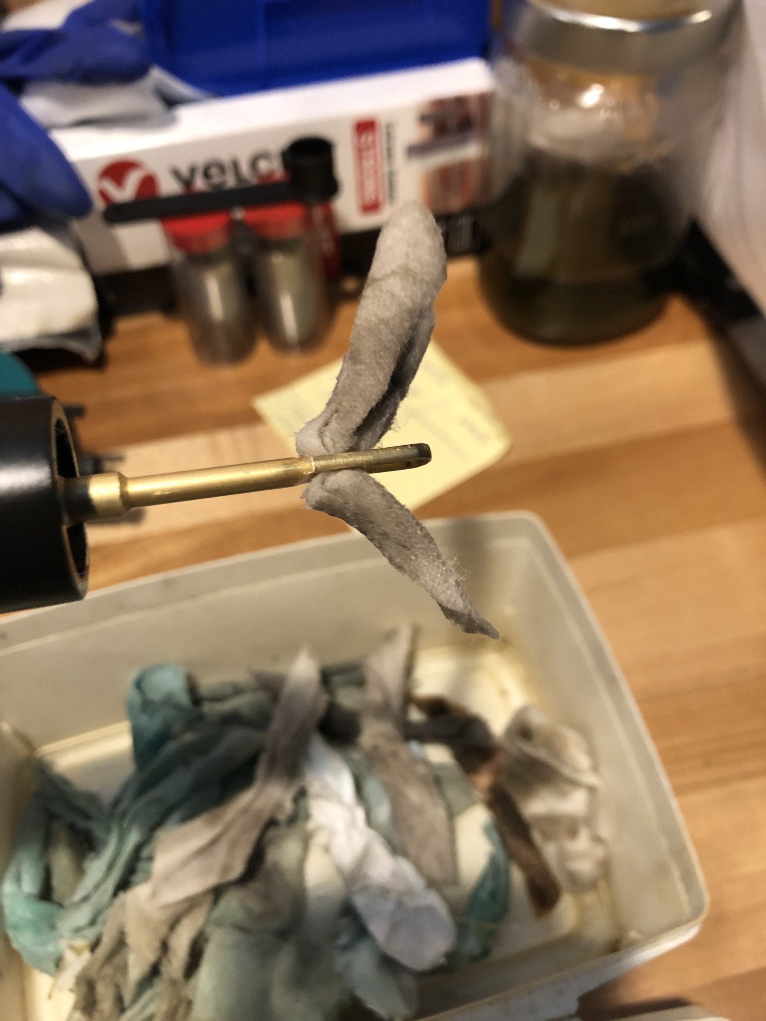

    Patch 2
    I’ll juice up a third patch and let it sit.
    Patch 3 and now I go away..
    Reactions: camocorvette

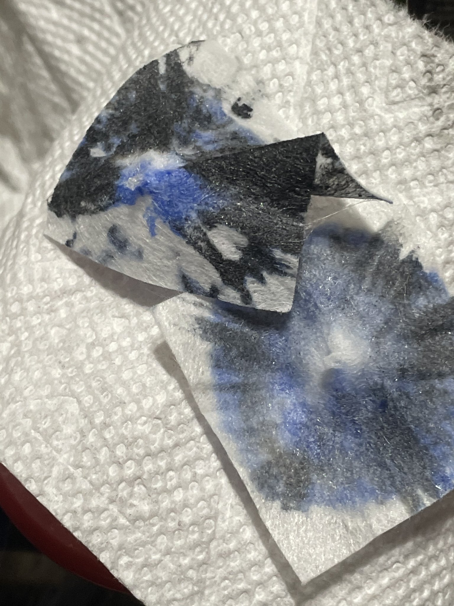

    what makes you say that? bartlein recommends it by name I believe, as have other shooters I know.
    wait you guys leave that shit in there? yeah probably don't do that.
    He means that Sweets is extremely aggressive, which it is. I used to use that a lot but since switched to BoreTech products. Works just as good and doesn’t require the setting of a timer.
    don't time it. apply to bore with patch, depending on condition of bore it may need a bit of scrubbing and a few more patches.
    dry patch thoroughly for use in a few days is my methods. gets it out pretty quick.

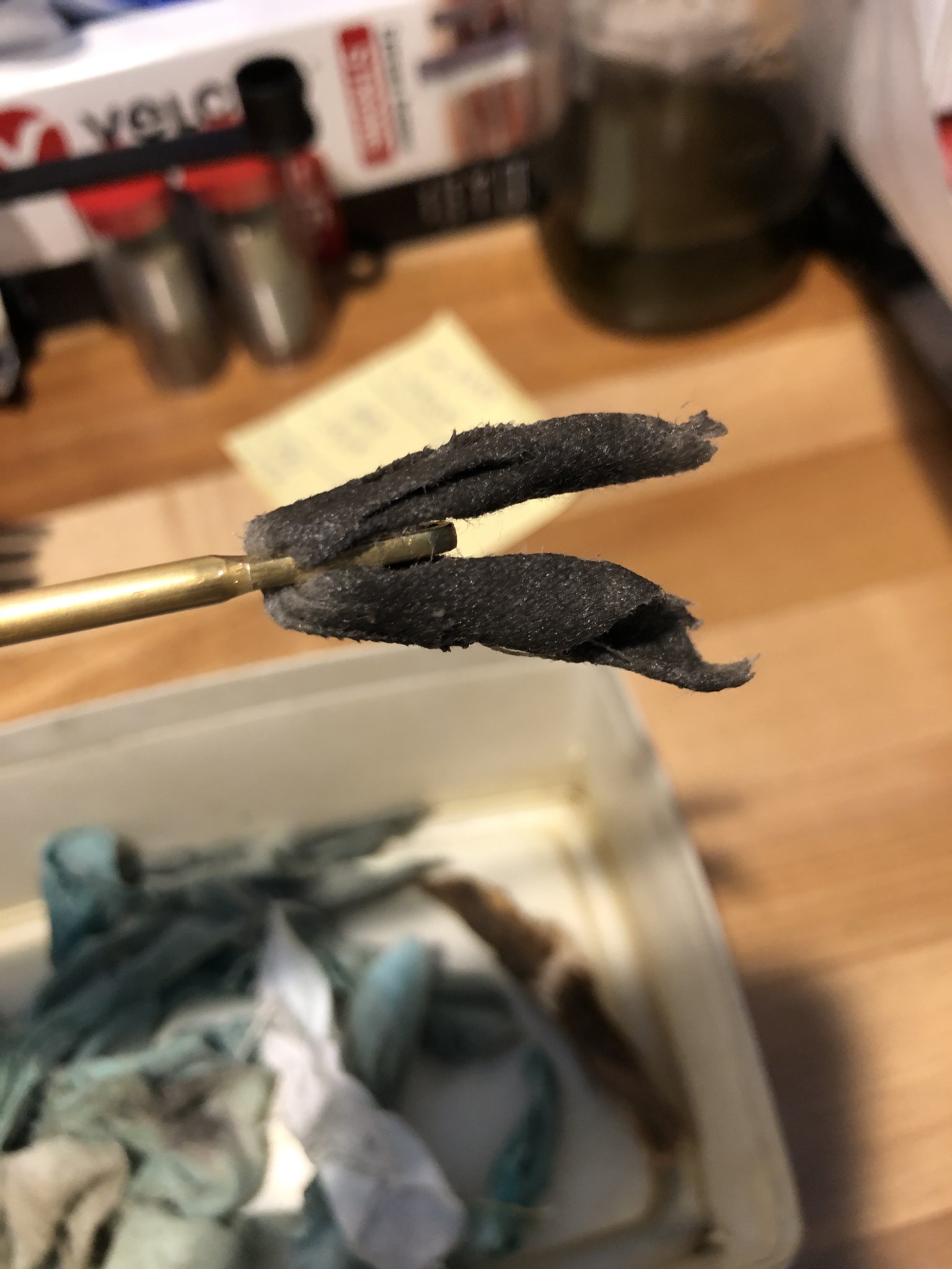

    First copper removal patch. @Frank Green builds a good barrel.

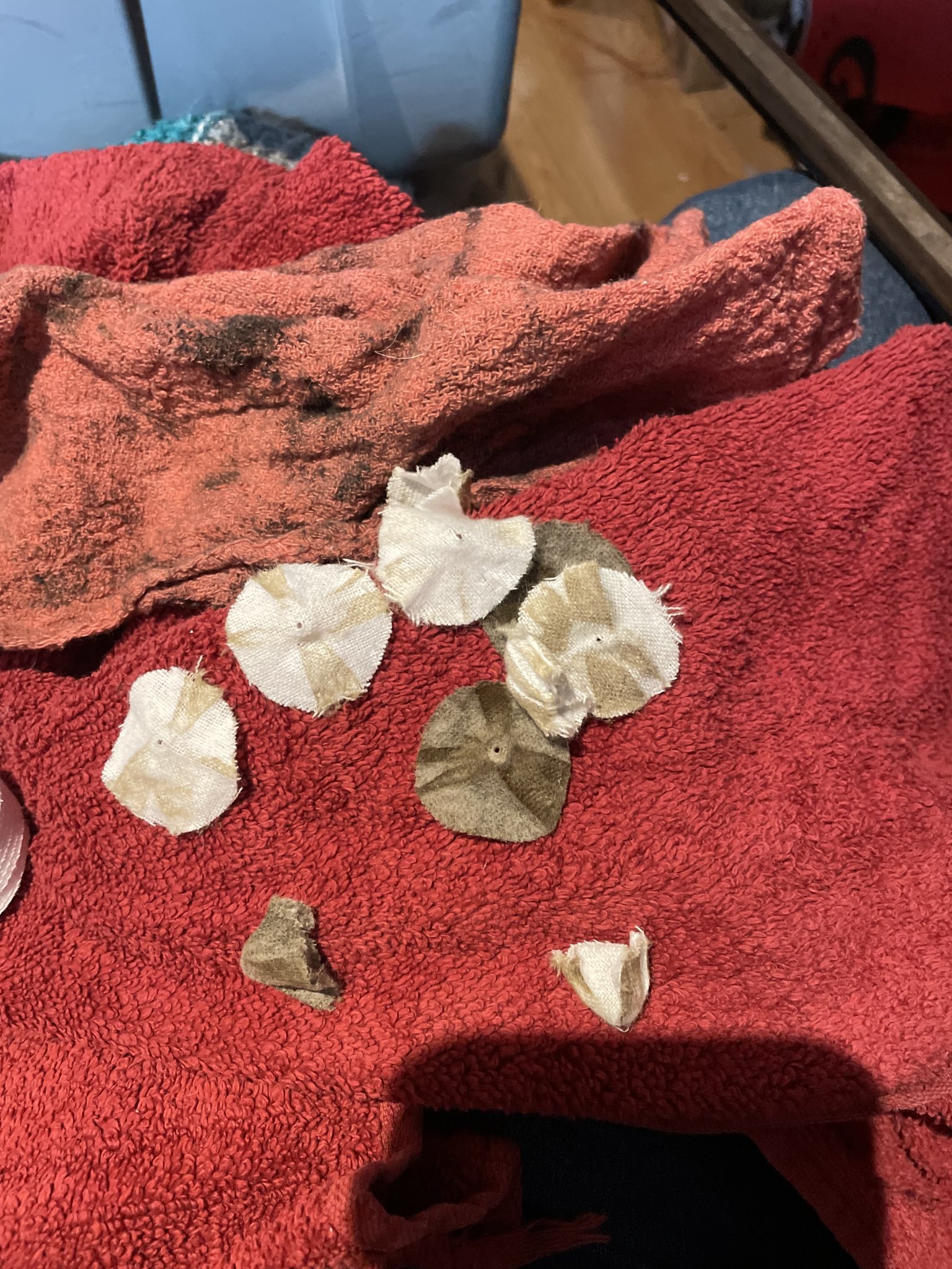

    Some of the old patches from cleaning my 1930s barreled 03 are still in the ass wipes box. Note the blue.

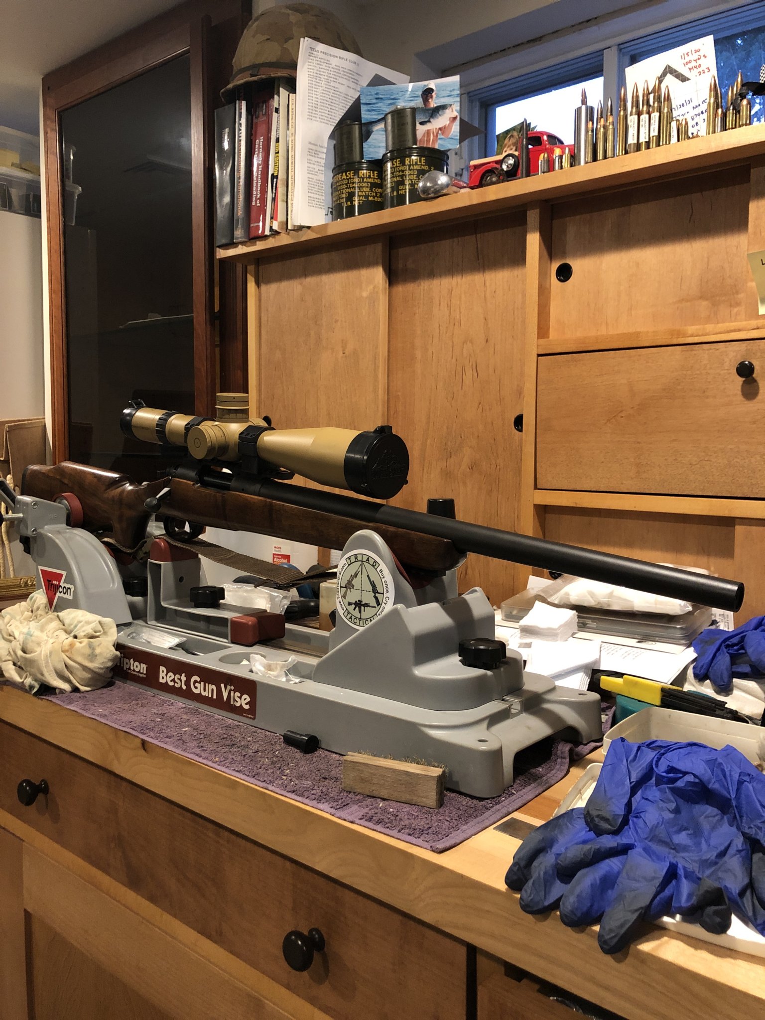

    Nother 5-6 hours of patching and letting the Hoppes work.
    I’m fucking around the house doing other stuff in the meantime.
    Time to wrap this shit up….
    Last wet one…
    Good enough for me.
    Next a dry patch.
    Than a patch of kroil
    Than grease on the bolt.
    Than in the safe muzzle down.
    Hours of elapsed time, very little actually on the rifle.
