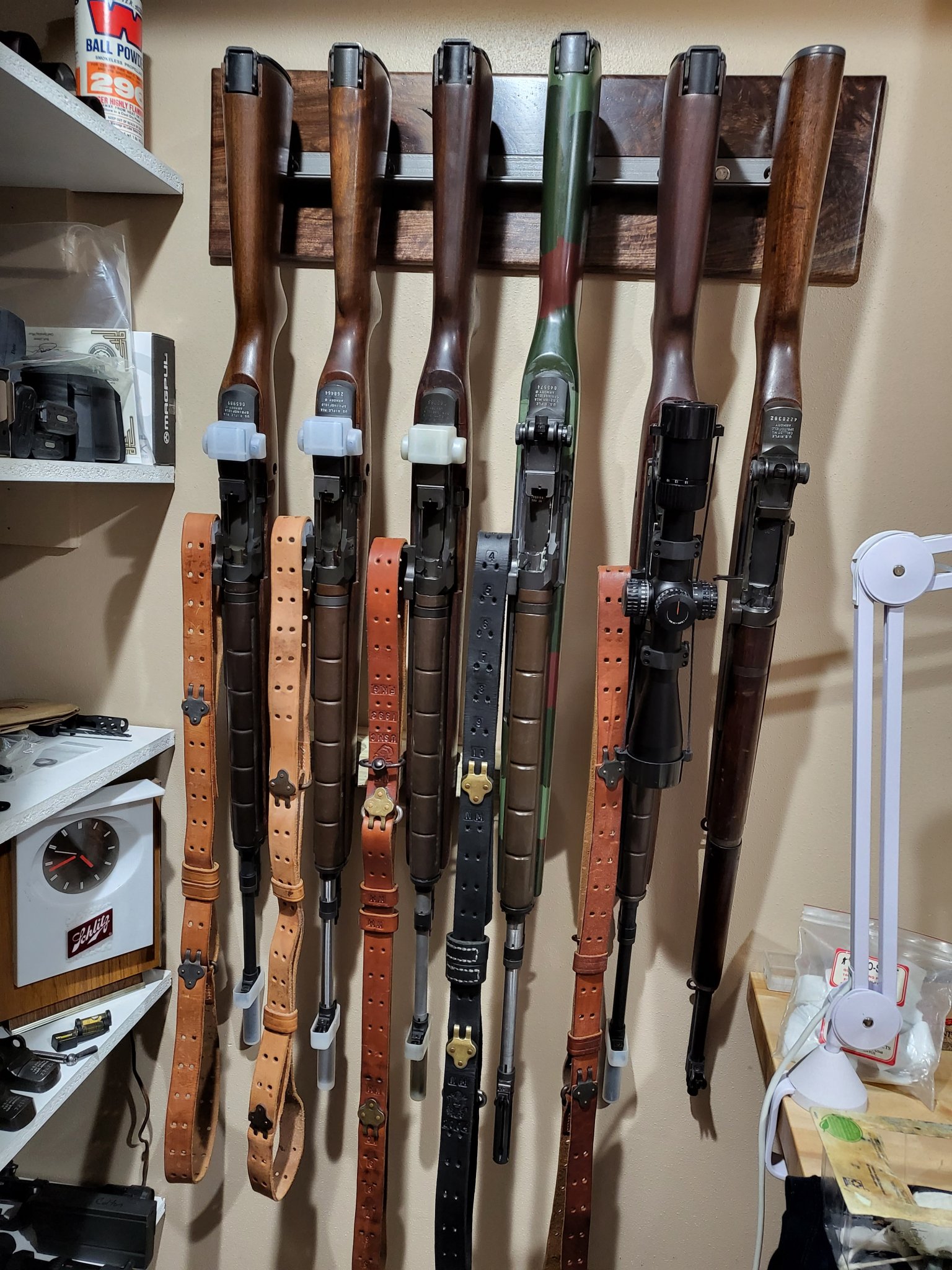

My M14/M1G rifle rack. I have to finish the lower support of the rack. Which all the wood work should be done this week. Then just hand rubbing the oil into it with several coats of Minwax Tung Oil. Also will have hangers for my slings etc... for the top rack I made a steel hanger that the rear sling swivel/loop hooks over... mounted that to a custom board made from fancy walunt. Rifles hang upside down.
That is a work of art.

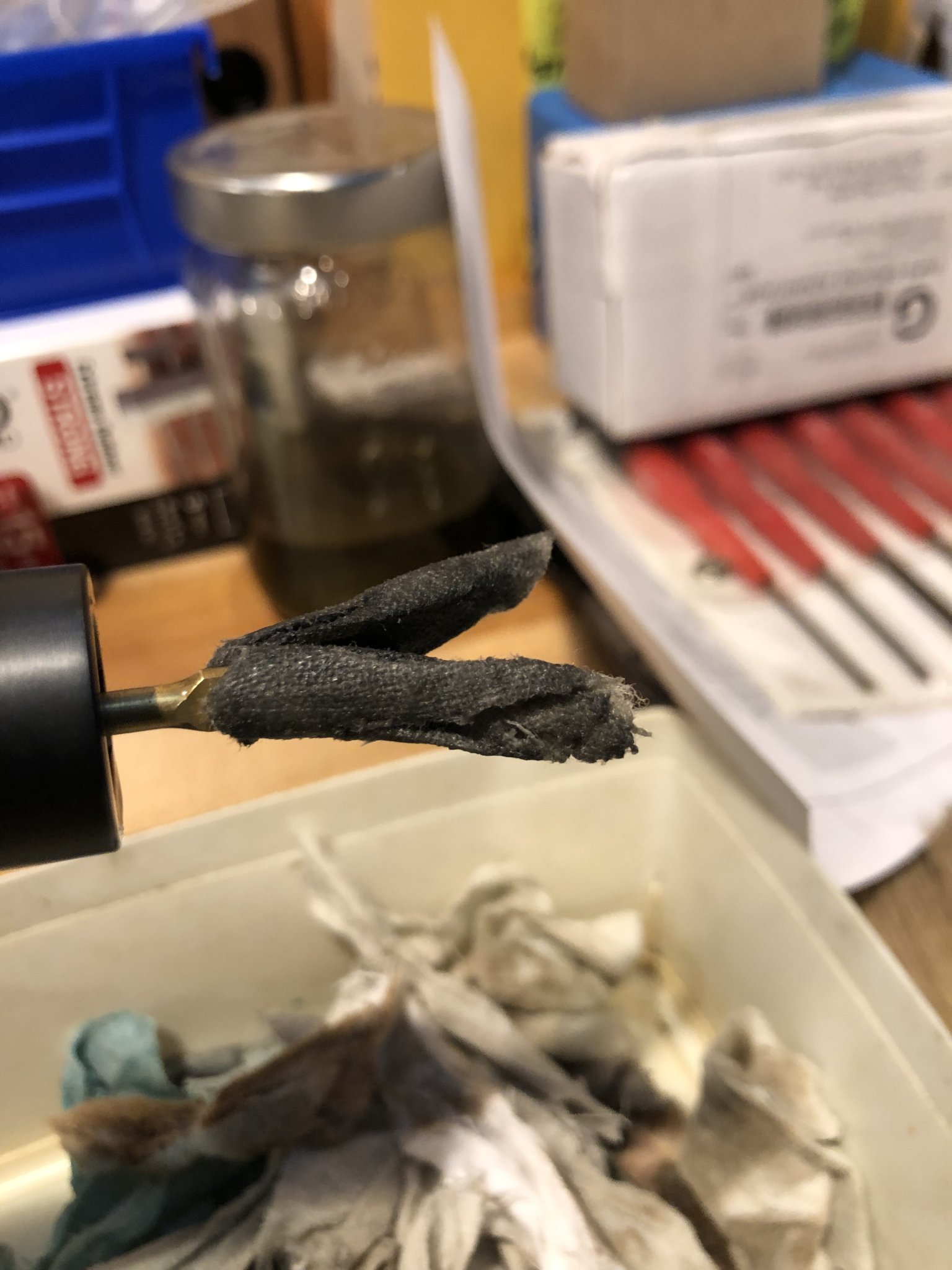

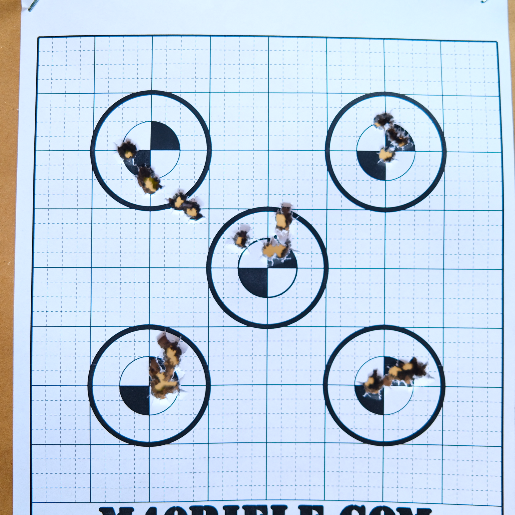

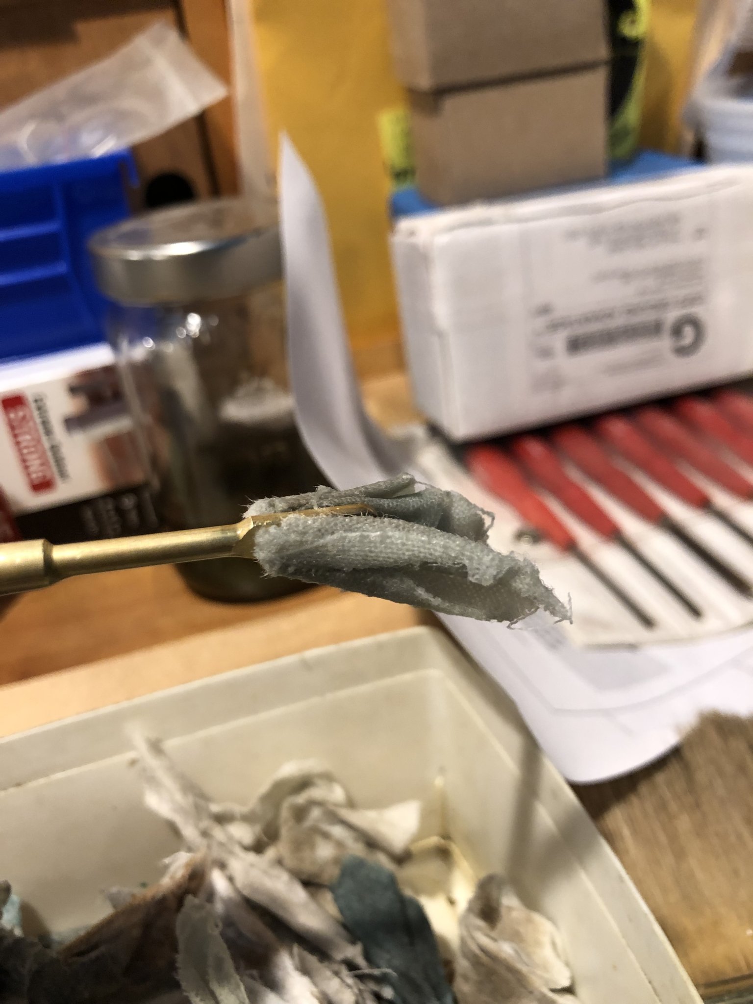

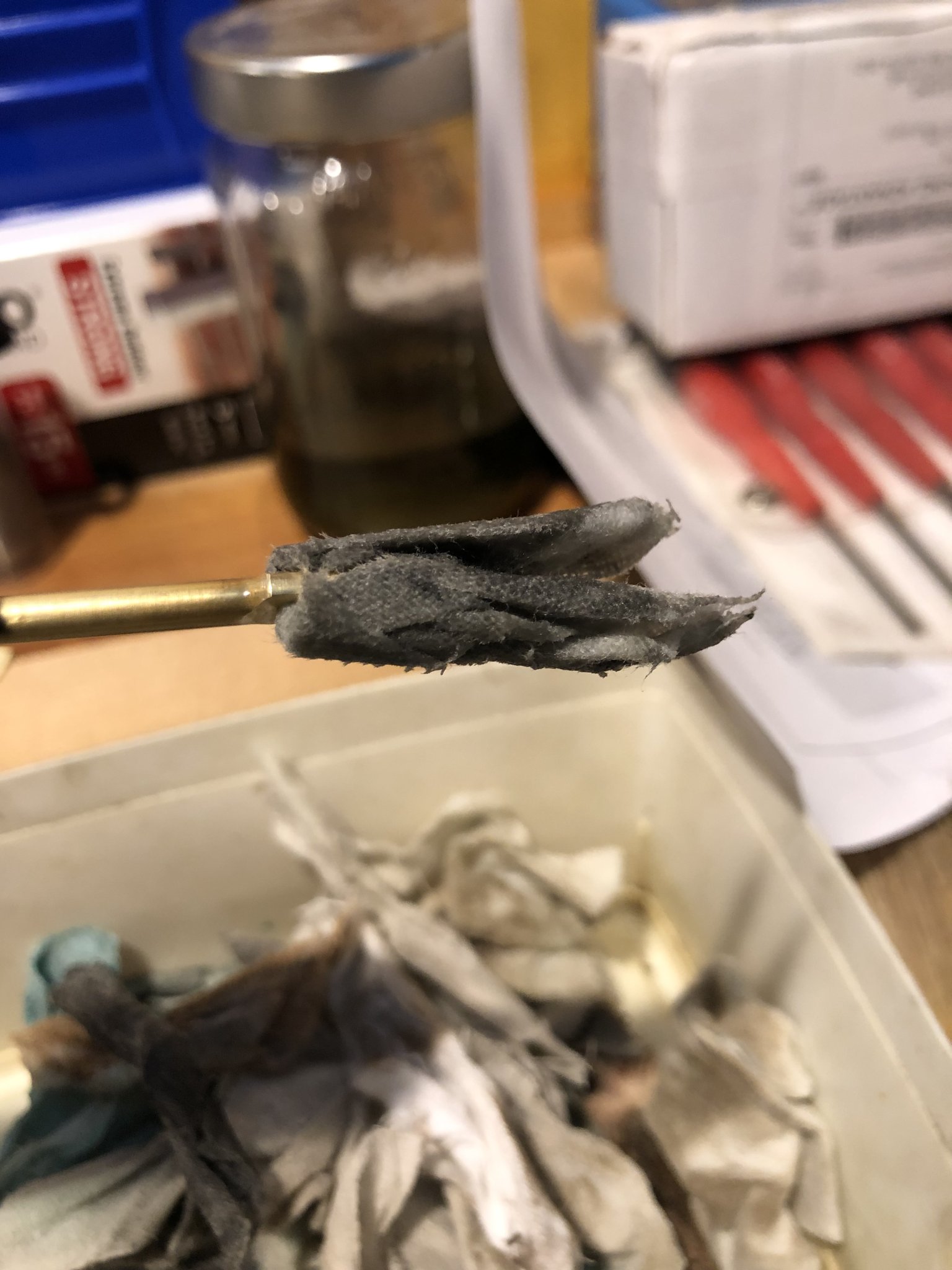

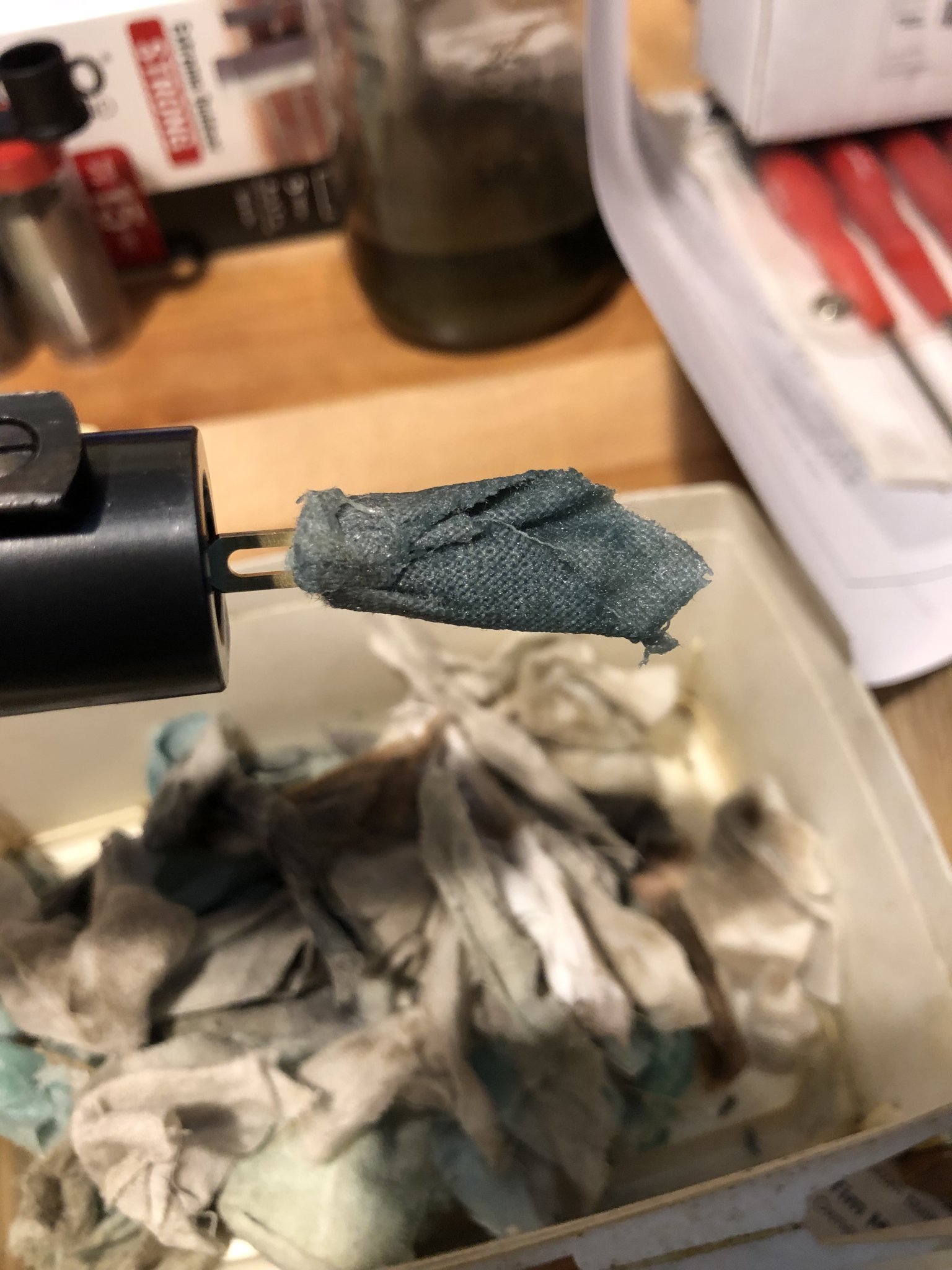

Seeing some copper after 2 hours.
Next one cleaned up a bit.
That being the case I’d like to note….same bullets fired - 175 SMK - this rifle and the earlier but this one is sitting on top of 10 grains more powder. Unsure if that is a factor seeing as my .308 and 30-06 are both running at +/- 2600 FPS.
Copper or no…….the rifle shoots.

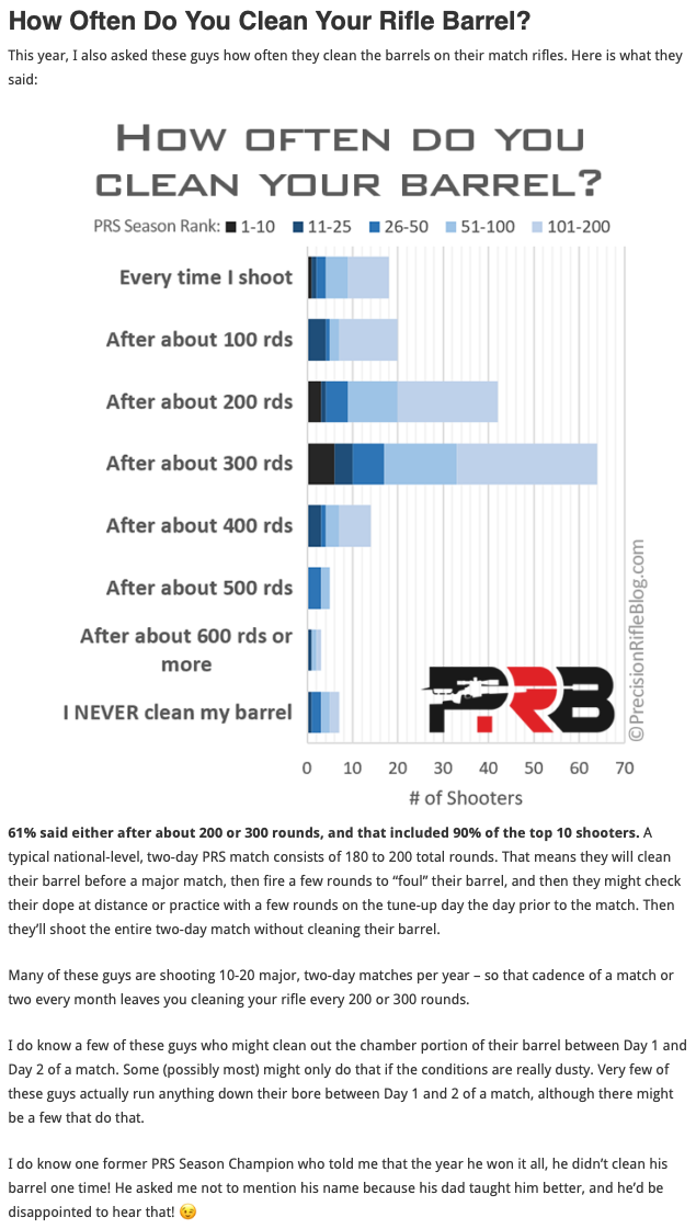

I can’t believe this thread has gone on this long and nobody has clarified carbon vs copper. Half are talking about cleaning carbon and the other half copper. I clean the carbon after 250ish rounds. I copper strip the barrel if/when the groups open up.
Reactions: sloporsche
Full bore rifles (non pistol calibre) are carbon and copper cleaned every time they are shot, Pistol calibre (.38/.357 and 44mag) are carbon cleaned every time they are shot, rimfire are carbon cleaned when felt necessary.

Just did 1000 yard FTR match this weekend. Barrel was squeaky clean prior.
After 75 rounds of 44.5g N150 was a filthy pig. I always get carbon out 1st, then copper. Lastly very slight amount of JB bore paste and then run patches until white.
A few years ago when I was shooting 6.5 CM (140's at 2880), In 2500 rounds I cleaned that barrel a grand total of 3 times, with maybe 28 patches in total. It shot .5-.8" groups and I was fine with it. Clean after fouling it would shoot .3-.5
Now I've upped my cleaning regimen and I clean about every 300-500 rounds, depending on what's going on. I am definitely not overly anal about cleaning. ;)
