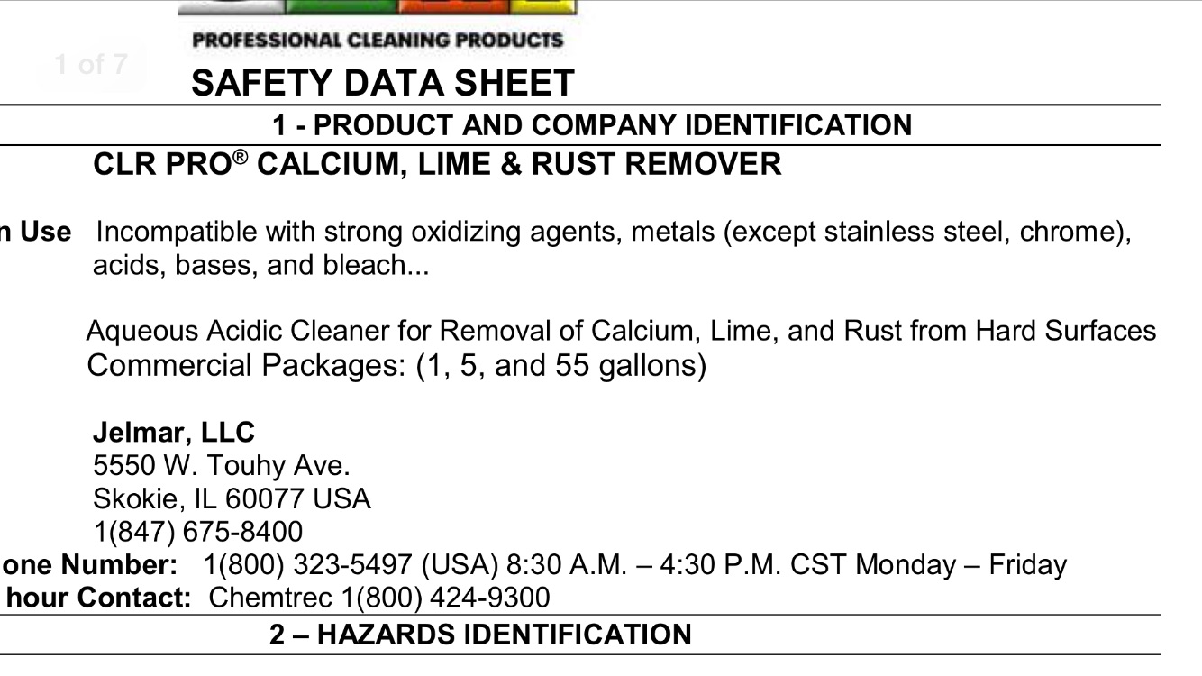

Anyone else use CLR to remove carbon? Cheap as $h!t and works awesome. I follow up with Wipe Out Patch Out but just a couple patches, I don't ever take all the copper out.

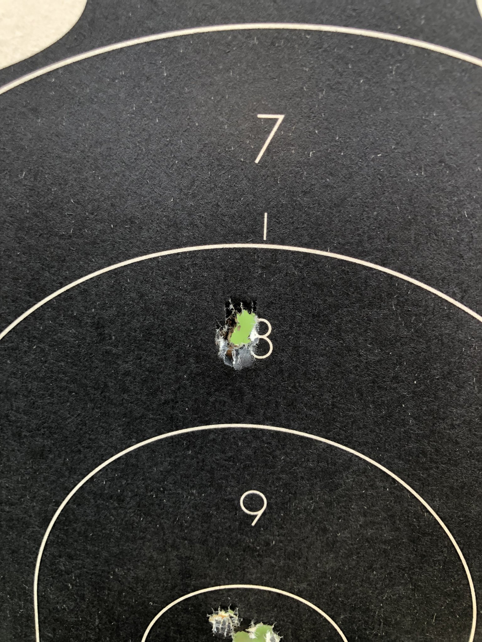

Last week I decided to do a thorough cleaning with JB. Next match I felt the effects. Took close to 30 rounds to get close to the accuracy I had. I want be doing much more than the occasional cleaning from now on.

Patched it out with CLR and a nylon brush, let sit for 30 min then cleaned it out...patches came out in pretty black.
