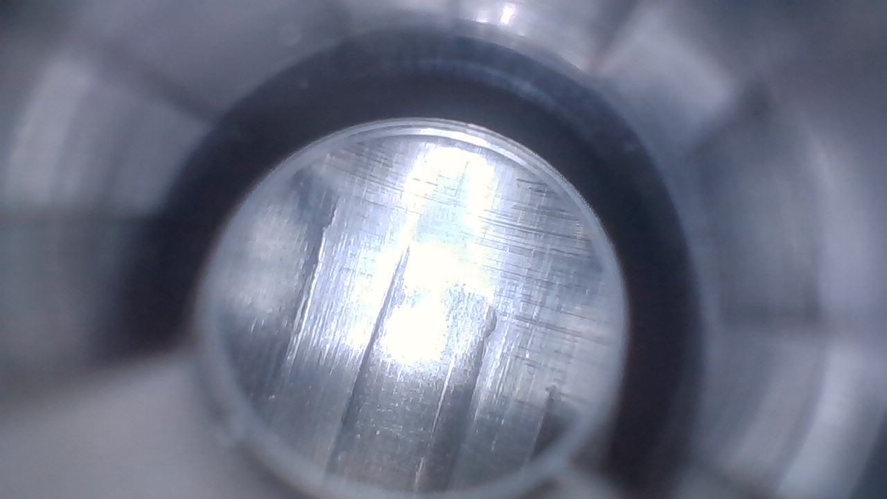

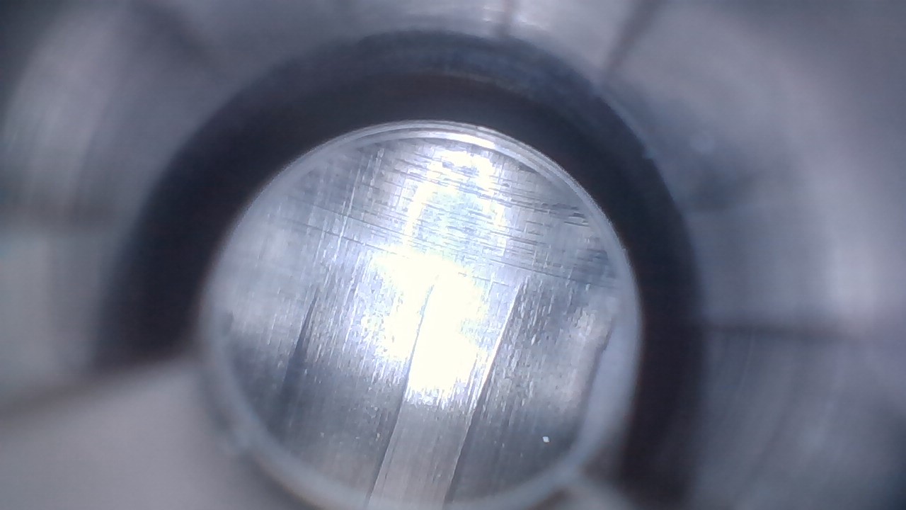

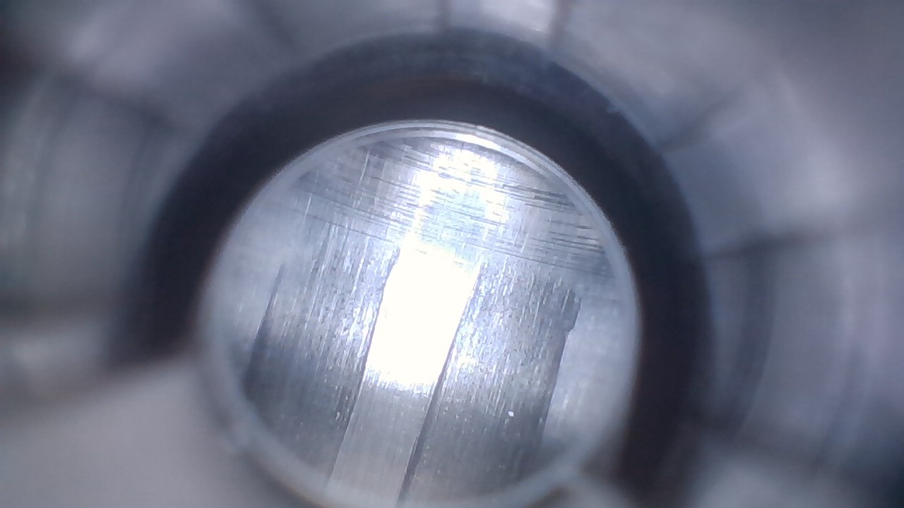

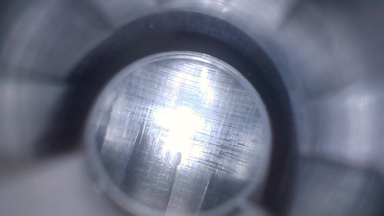

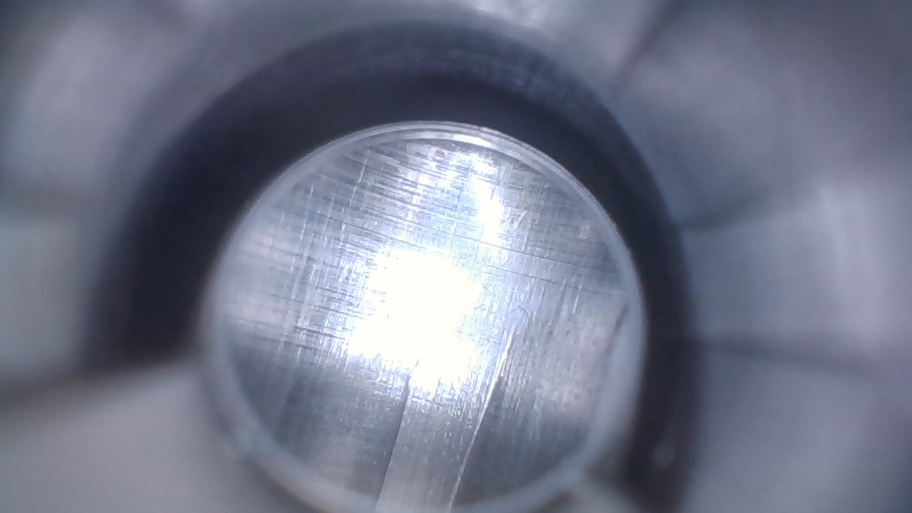

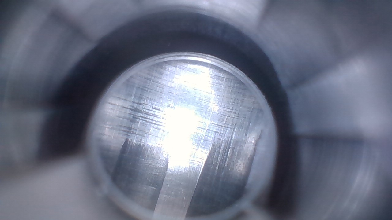

Hi all, been about a decade since my last post. A buddy has gotten me into rimfires, and i purchased a RPR to see how much id enjoy it. My friend is an Anschutz benchrest kinda guy, which doesnt really interest me much.
Ive been working with the RPR for a couple months now, ive shot a bunch of ammo types thru it. CenterX is the only ammo that will consistently net me 1moa at 50yd. Ive tried most of the match brands, and a few budget ammo types. CCI Std averages 1.2 MOA, after i bedded with foil tape and reduced the mag spring tension. Nothing else i try matters, ive had 3 scopes on it, an Athon, 12x Supersniper, and 24X Sightron SII. I cn shoot here at the farm any time i like, so all my testing is in light wind conditions. I feel im an honest 1/2 moa shooter off my bipod and sandsock, so i believe most of the accuracy problem is in the rifle or the ammo.
kinda gettin fed up i decided to drop my borescope down the barrel nd see how it looks...
doesnt look to precise to me lol! I have chambered a couple CF barrels at another friends machine shop, and we managed to cut them straight.
now i guess i need to decide if i want to deal with Ruger, install a custom barrel, or simply save this rifle for the grandkids, who love it, and dive in the deep end and buy a Vudoo or Kidd...
decisions decisions...

First those pics don't look that bad for a factory barrel, second take a borescope with a HUGE bowl of salt. I could show you pictures of a Clark S&W41 barrel that would make a billy goat puke, and then the Eley Match target they shot with it at 50 yards indoors are multiple 10 shot groups are in the 5/8" range.
You really need to shoot it at 100 if you haven't already, with the SD variation in rimfire ammo, even higher dollar stuff, groups can open up a lot from 50 to 100 yards, more than just doubling your groups at 50, and you may find the ammo that gives the best groups at 50 isn't the best shooting at 100 either, I've seen that many times. That said, if you are getting 1 MOA groups at 100 yards from a $350 factory gun, even with spendy Center-x consider your money very well spent. Also some of the rougher factory rimfire barrels don't "settle down" and shoot their best groups for a few hundred even 1000 rounds.
Look over the Vudoo thread that has targets posted, most 100 yard groups are not better than 0.75 MOA, most of the 50 yard targets I see are 0.35-0.5. Not saying the vudoo won't do better, and certainly it's a much much better gun, but for $350 I'd be pretty damn pleased with 1" groups at 100. Guys spending $6000 on vudoo rigs are not shooting that much better.
View attachment 7257690View attachment 7257691View attachment 7257692View attachment 7257693View attachment 7257694View attachment 7257695
from reading here it sounds like all the mass produced rifles are a crap shoot, u pay less and take your chances.

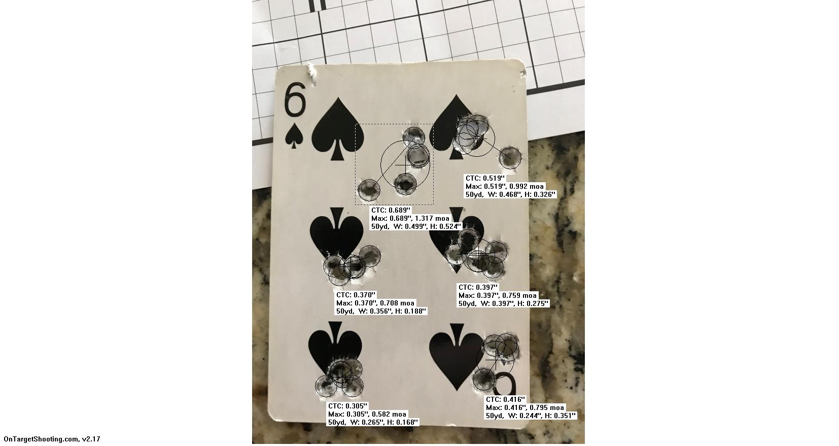

I’ve got a Kidd and it’s a 1moa gun at 50y with centerX. That’s good enough to clean all the stages at the local prs style rimfire match (even the 50y Kyle with the 1/4” spinner). I haven’t put all of the stages together yet, but it’s not because of the rifle.

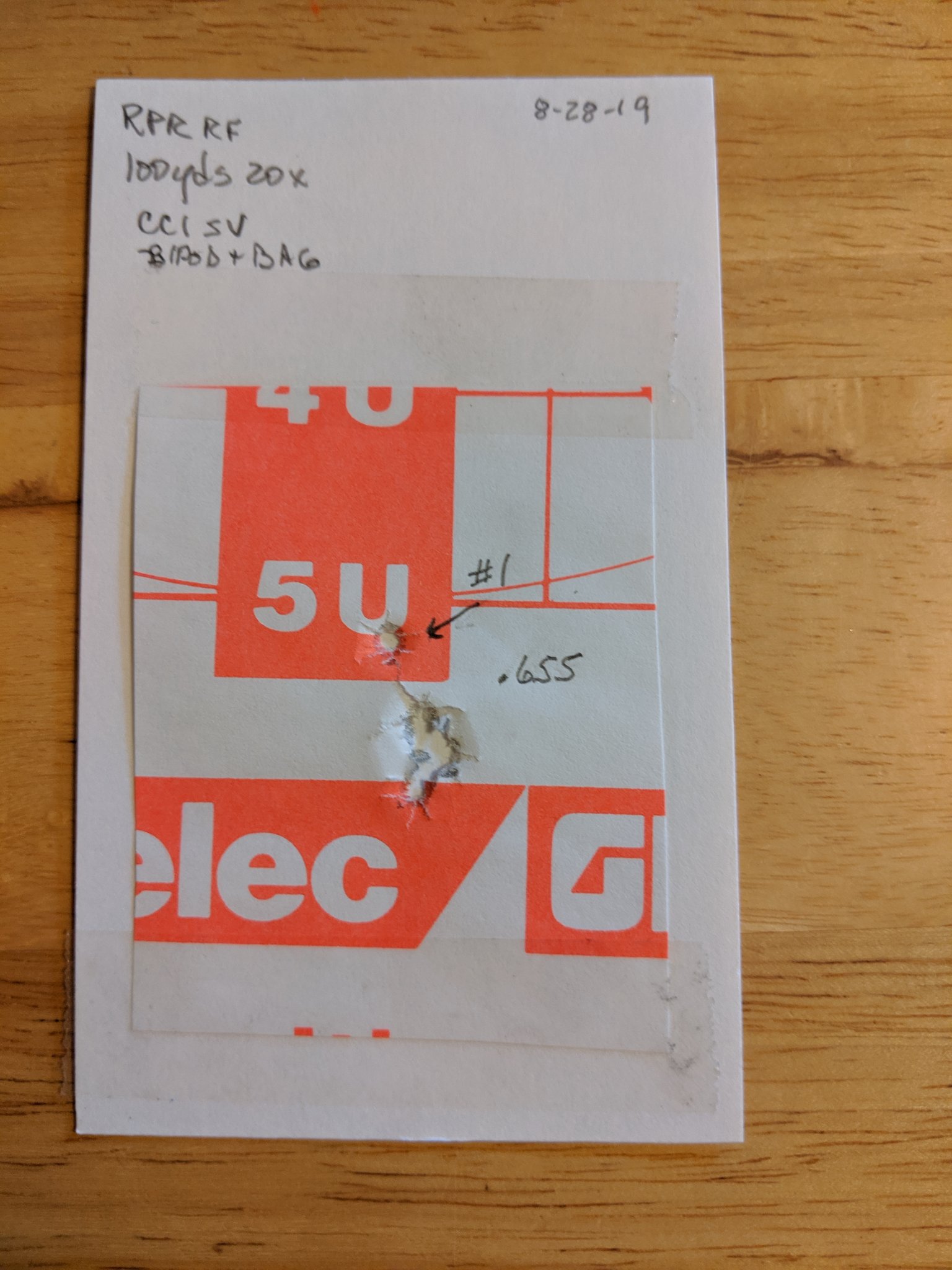

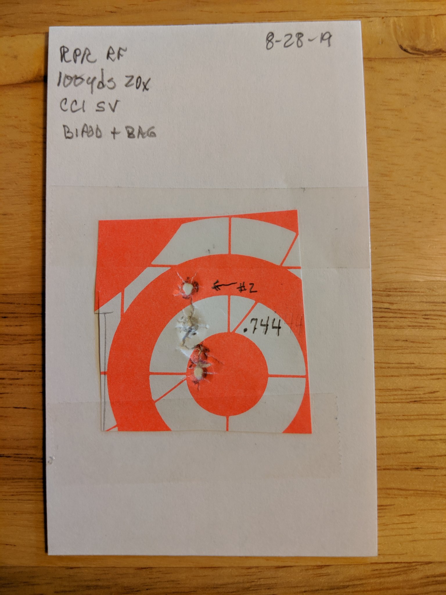

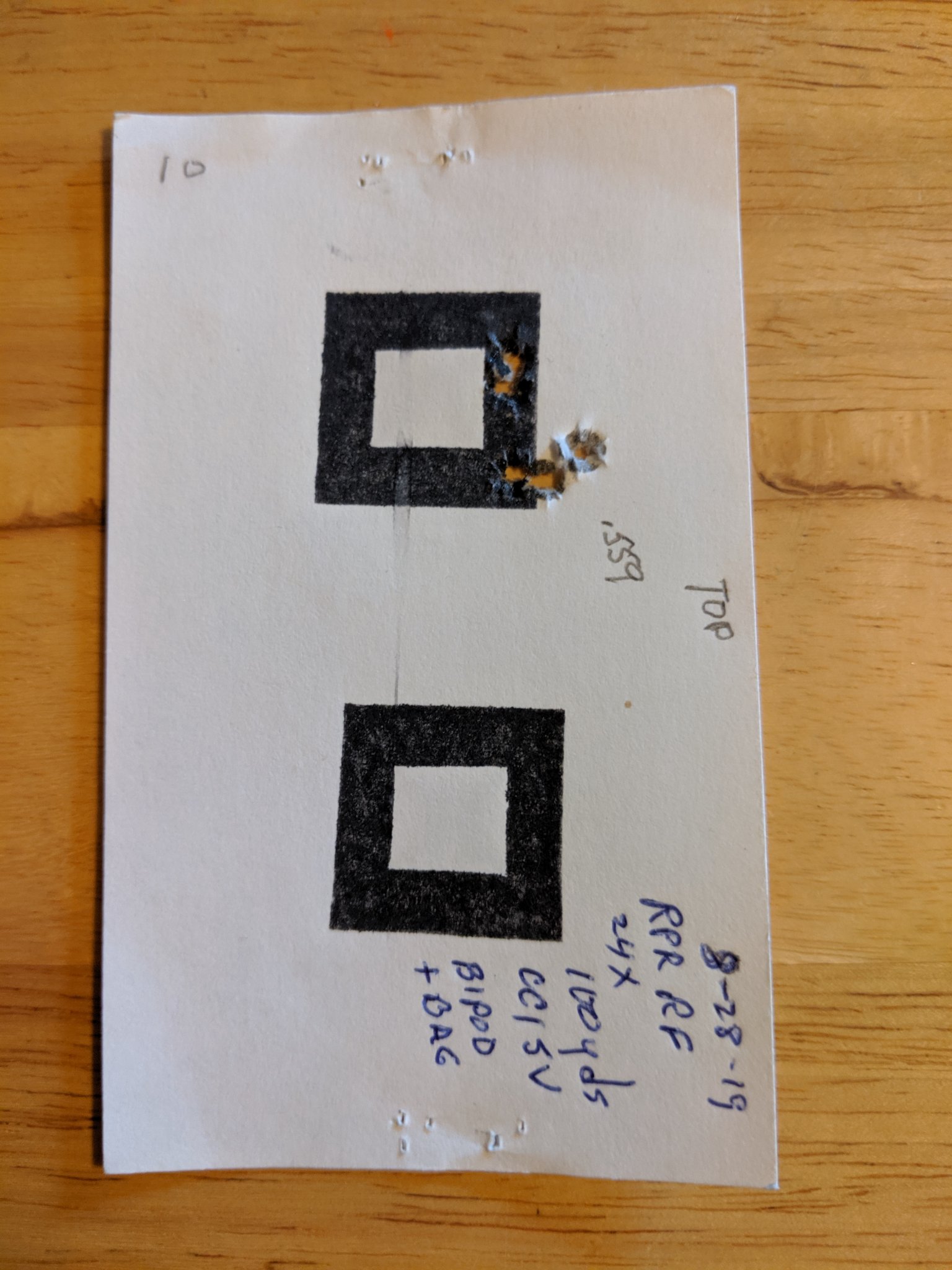

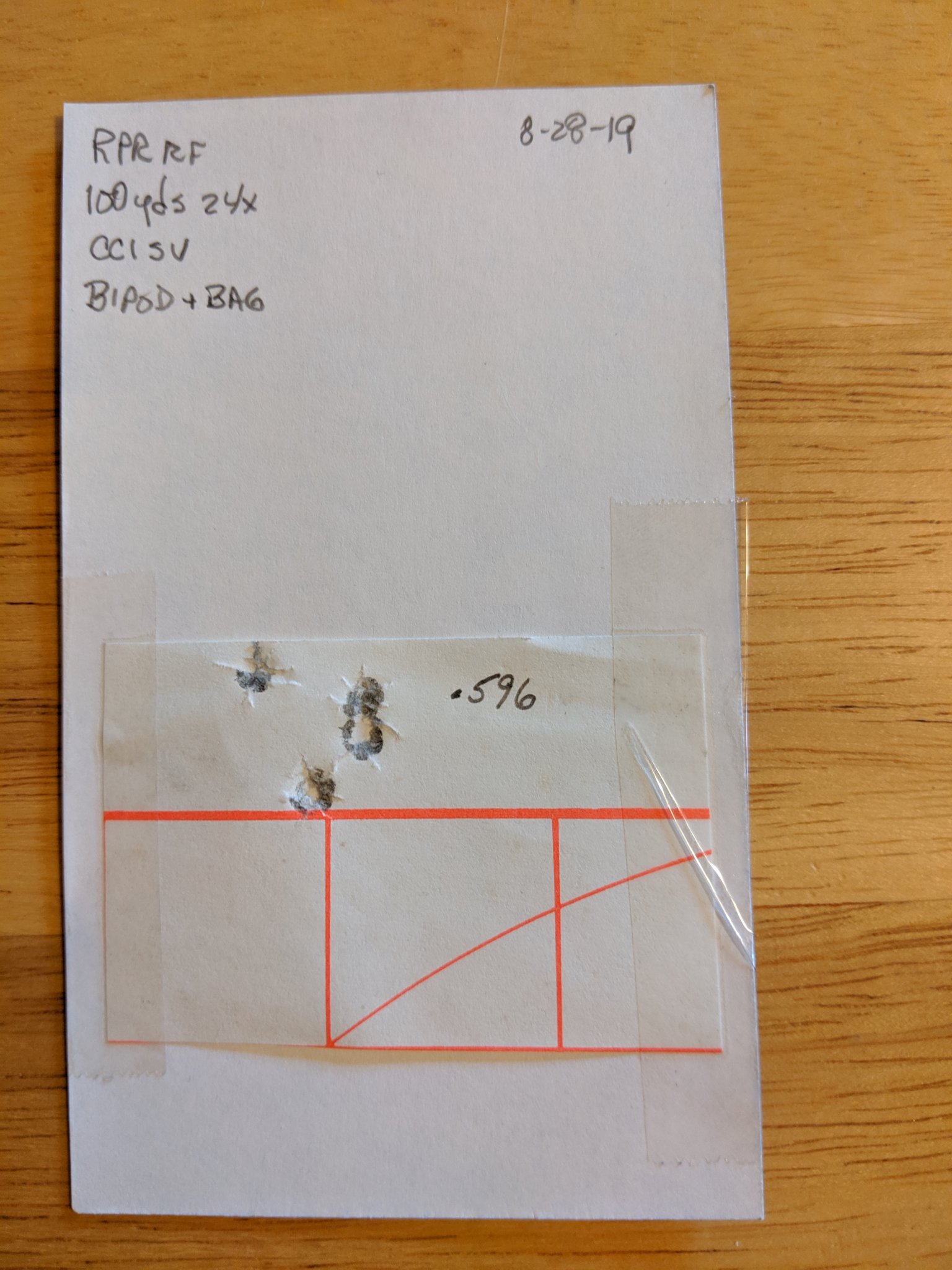

I guess I have the exception. My RPR will average .6385" for 4 consecutive 5 shot groups at 100 yds. Pics attached. Also attached is its best 50 yd group. The "normal" 50 yd group runs right around .275" for 5 shot groups. This with CCI SV, apparently an exceptional lot. Chrono results are 1108fps with 18fps ES. These were shot under very good conditions, very light breeze with readable mirage.
View attachment 7258156View attachment 7258157View attachment 7258158View attachment 7258159View attachment 7258160
I would definitely can consider that an exception. It seems like the RPR's suffer from bore bit sharpness. Some barrels are cut using a clean, sharp bit and some are cut with a dull bit. Those at the front find great accuracy, while those at the latter suffer with terrible consistency.
