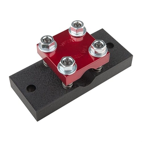

Thank you sir. What sort of barrel vice would I need?
Can’t really recommend on over the other but this one is the type that would work, there are quite a few others that also work. As long as they clamp only the steel portion of the barrel.
https://www.aeroprecisionusa.com/solus-barrel-vise-kit.
We own a Viper barrel vice. Works great on steel barrels. I highly recommend it but NOT for carbon barrels. Frankly, for your first build, I would recommend an all steel barrel anyway. Eliminates a pitfall. At the cost, you don’t want to mess up a carbon fiber barrel.
There are many makers of barrel vises, this is the one that I have, the Short Action Customs (SAC) modular barrel vise:
It's on the upper end of the price range, but the less expensive SAC Bravo barrel vise is also excellent.
If you're installing a shouldered prefit barrel and you don't intend to torque it up to 100 ft. lbs. or more, you can use a less robust barrel vise, like the Viper which you would clamp the barrel using something like leather between the metal surfaces of the vise and the barrel.
