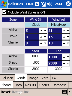

Personally I would use Patagonia Software Loadbase 3.0 (soon to be ColdBore) He has that feature in both the desktop and mobile versions. He also have a very good loophole dialog in the same software. His is pretty robust and includes all of these features. FFS might include it too, I don't recall. <span style="font-style: italic">(I don't' have the screen shot of the Max Ord Feature but it is in there) </span>
Example of Loophole section to give you an idea of the feature set.
You can make a basic card at JBM using the round you figure you'll use then look at the drop, that column is in inches, so then it becomes pretty simple.
Since the software is running the numbers, it has to be using a formula so technically if you had access to the developer you can get the actual formula, run it long hand from there. But since 99% of the software will give you a range card with columns, you can just pull it from the inches in drop column. Beats running multiple step formulas on the fly.
I like using the multiple wind feature to account for Max Ord differences in wind drift myself. I give the mid range wind more value and let it do the work.
In this day and age, the long hand math is really outdated, and is a slow error prone way of doing business. Most of the software is accurate and robust enough to give you more detail then you'll ever need at your finger tips.
