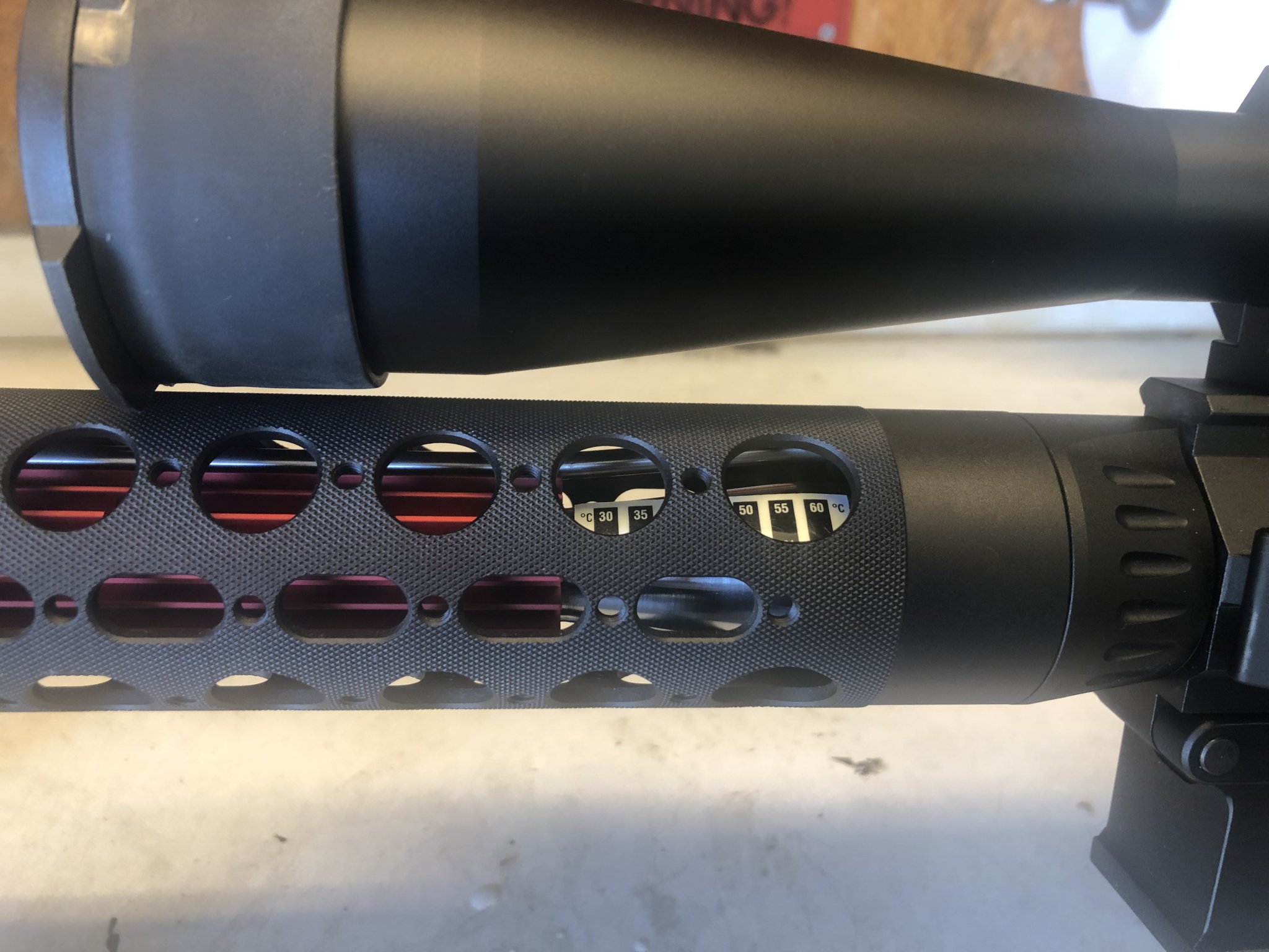

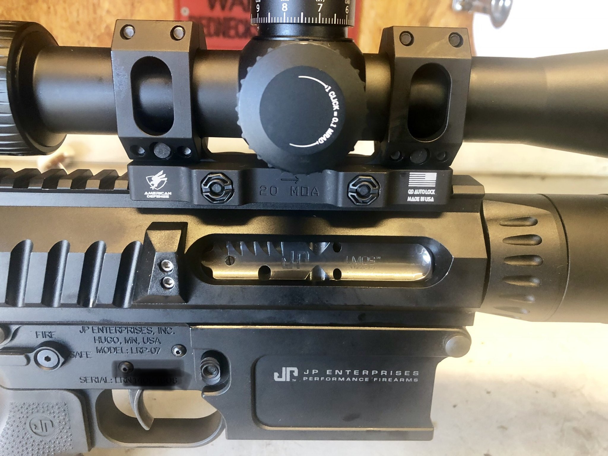

I recently purchased a Bobro 20MOA 34mm QD Mount for my large frame...It’s cantilevered, has a sweet, fast QD mechanism and looks great on the rifle.
I’ve used several top tier mounts over the years and this one is rapidly becoming my favorite. Would be a solid choice for your ATACR, IMO.
