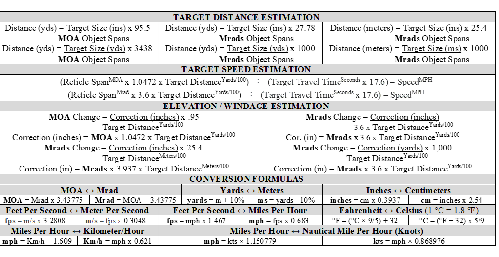

The "real math" isn't hard but its cumbersome to spit out in one sentence.
Quick 2-step overview:
step 1 trig for any 3 sides of a triangle = 3 known sides
step 2 more trig to get three angles (from 3 known sides)
More specifically, step 2 unfolds as follows ...
2.1 Trig function (cosine) using ratios of sides (soh-cah-toa) from 1.
2.2 Inverse-trig function (arc-cosine) to get angles in radians from 2.1.
2.3 Mil-radians conversion from 2.2
For some reason it's always been easier to remember by splitting it up into two thought processes for me...
I always remember the 1.047 and 3.6 numbers
Take which ever I'm using, and look at distance first.
Unit of measure x number of hundred yards gives me how many inches at that distance
3.6x10=36
Then take the inches and divide by that number
228/36=6.33333
For some reason that keeps it straight in my head and can be easier done off the cuff
Hope you've been doing well

In my head I just use 1" per 100y but it's probably slightly more than that. If I was wrong, thanks you convinced me to never shoot MOA again because I couldn't get a simple 1000y conversion done in my head!!!
Yea "shooters" moa or inches per hundred is a common short hand.
About like using 3.5" instead of 3.6 for MIL conversion
Not trying to talk you our of anything, but if you are trying to convert numbers to true all your data then the 1 vs 1.047 or 3.6 vs 3.5 start to matter depending on how close you are trying to get your data
Reactions: rlsmith1

I put this cheat sheet together in case my ballistic calculator has a dead battery or dies. If there is an error, or simplification of the formula, please let me know so I can correct.
Reactions: wvfarrier and Ichi
I am now a MIL fanatic, thank you!!
