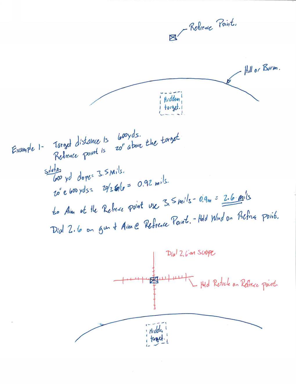

Every match I have shot that had a hidden target w a give distance, but they give you a sighting target to aim at, I have missed. is there an
easy math formula for this? Or, am I over thinking this and the answer is in front of my face?
Here is an example of what I have seen and how we solved the problem. The hardest part for these stages is if the wind is wicked and you cannot see where you miss.
You'll have to excuse my awesome drawings skills but its the best way to get the idea accross
I shot one of those stages at Battle of Breakneck a few years ago. The hard part was accounting for the wind, as you couldn't see your impacts or misses.
The stage was shot with 10-rounds fired at one target under a certain time, and your squad could offer you input on those shots while you were shooting.
Unfortunately, I had three guys yelling corrections to me all at the same time, and it turned into a clusterfuck, as I couldn't keep track of what they were yelling.
That stage sucked because of my stupid squad mates.
You'll have to excuse my awesome drawings skills but its the best way to get the idea across
