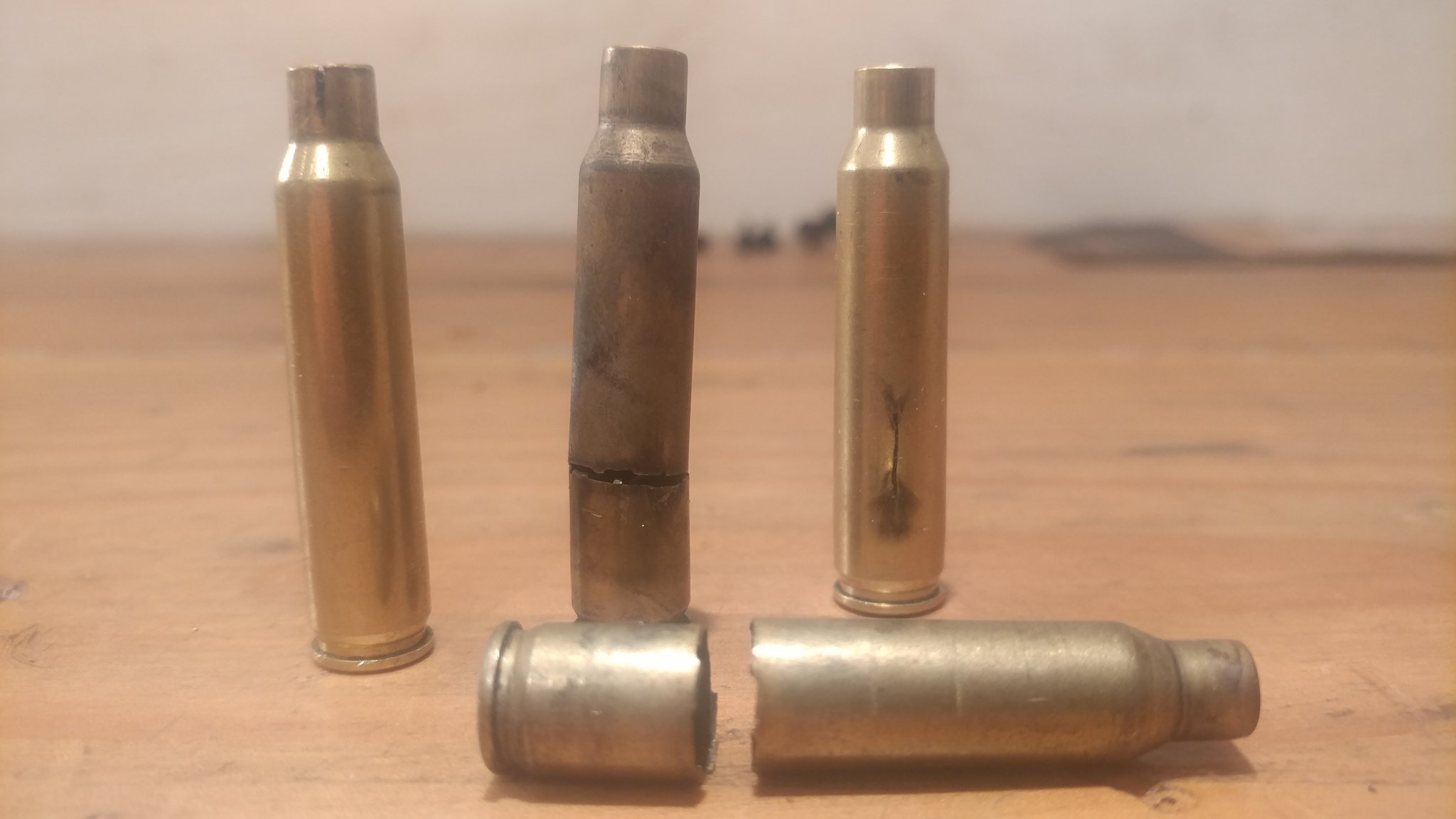

For me, my primer pockets go before I get close to case head separation, but I do have my “case head separation gauge” to check. Just take a paper clip, straighten out on side, and bend it at the end to form a little L. It’ll slide into the case mouth and you can feel the case wall for a little “notch” where the wall is starting to weaken

You can usually see a light ring of death the firing before a case head separation. You can also feel the thinning out of brass on the inside with a picking device paper clip dental tool etc to confirm the ring. Once I see both I toss it but my primer pockets usually fail first.
