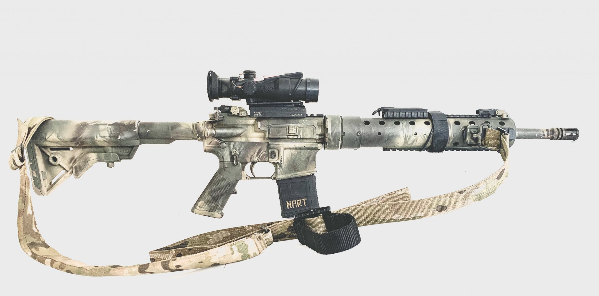

With this rifle, using a leather sling and removing the BUIS, pressure pad, and PEQ, I was able to shoot a 479-12X. The rifle weighs about 8.5 lbs.
I know that doesn’t help but I just wanted to point it out that it’s possible to get better scores. The next time I shot service rifle was with the Marine Team, scoring a 488 and then a 495 with their rifles, but mostly I think that was a lot of me improving and working on my mental game.

With this rifle, using a leather sling and removing the BUIS, pressure pad, and PEQ, I was able to shoot a 479-12X. The rifle weighs about 8.5 lbs.View attachment 7699684

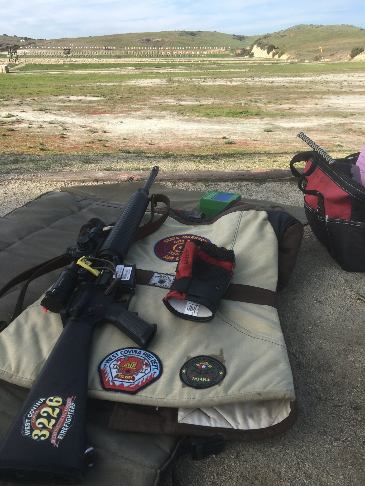

Fair enough. If you do buy an upper, White Oak and Rock River are two very popular choices. RRA is a little cheaper. Used is a good choice. I started with that and worked up to WOA stuff.
For scopes, Vortex PST gen1 has a great track record. Vortex has a Ranger line that is almost as good. You want moa target turrets to match scoring rings on target.
coats aren’t needed but help. Even a motorcycle jacket can be used.
sling: get a gi canvas one to start. You can use a welding glove or kitchen mitt to start.
It’s all about having fun and learning.
