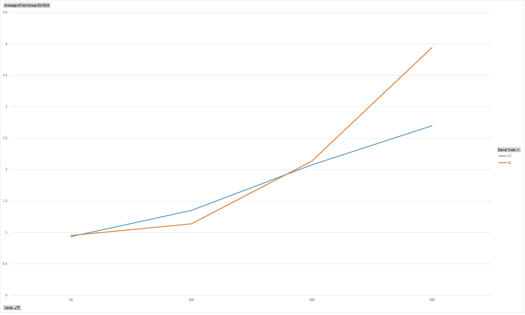

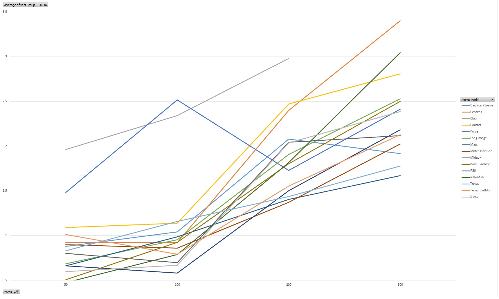

I went out on a real nice day and tested ammo at 50, 100 and 300 yards. Doing this eliminated 80% of my sample ammo. High dollar ammo, Ely Match, Tenex, and Lapua Midas shot great at 50yards, but sucked big time at 300. Ely Club, a 6 buck ammo shot equally as well.
Being I am running scopes on rifles with 30mils internal adj I am going to shoot 300+ yards every outing, I saw no need for 50 yard specific ammo.
My Bergara shoots CCI SV and SK Started Plus almost exactly the same until some wind comes up and I have to put the SV away and continue with SK Plus.
In my Rim X, I really never needed to test any ammo other than Center X, I tried some but it seemed futile, and I can't see paying any more for ammo when wind is the biggest deciding factor in getting hits past 200 yards.

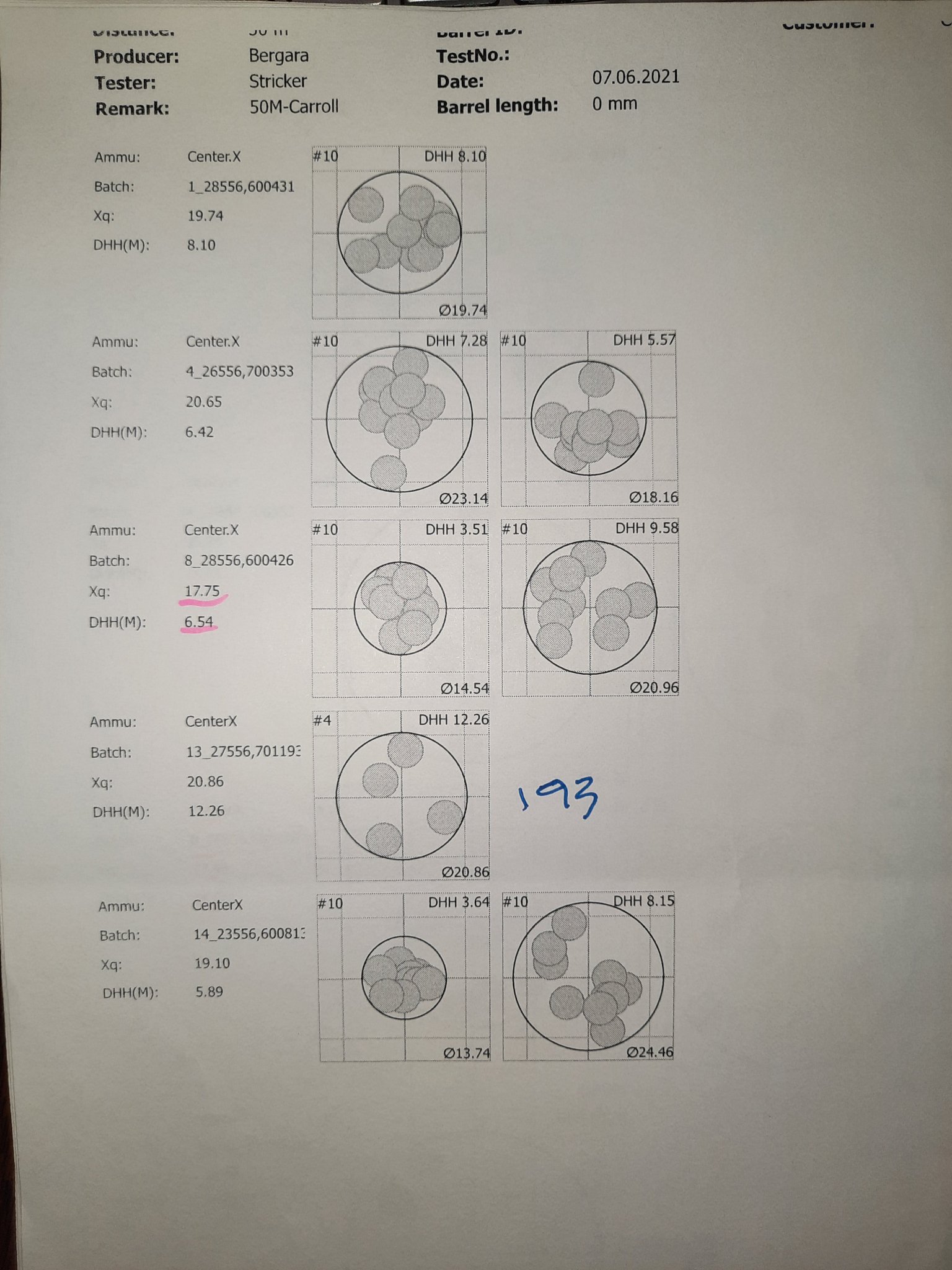

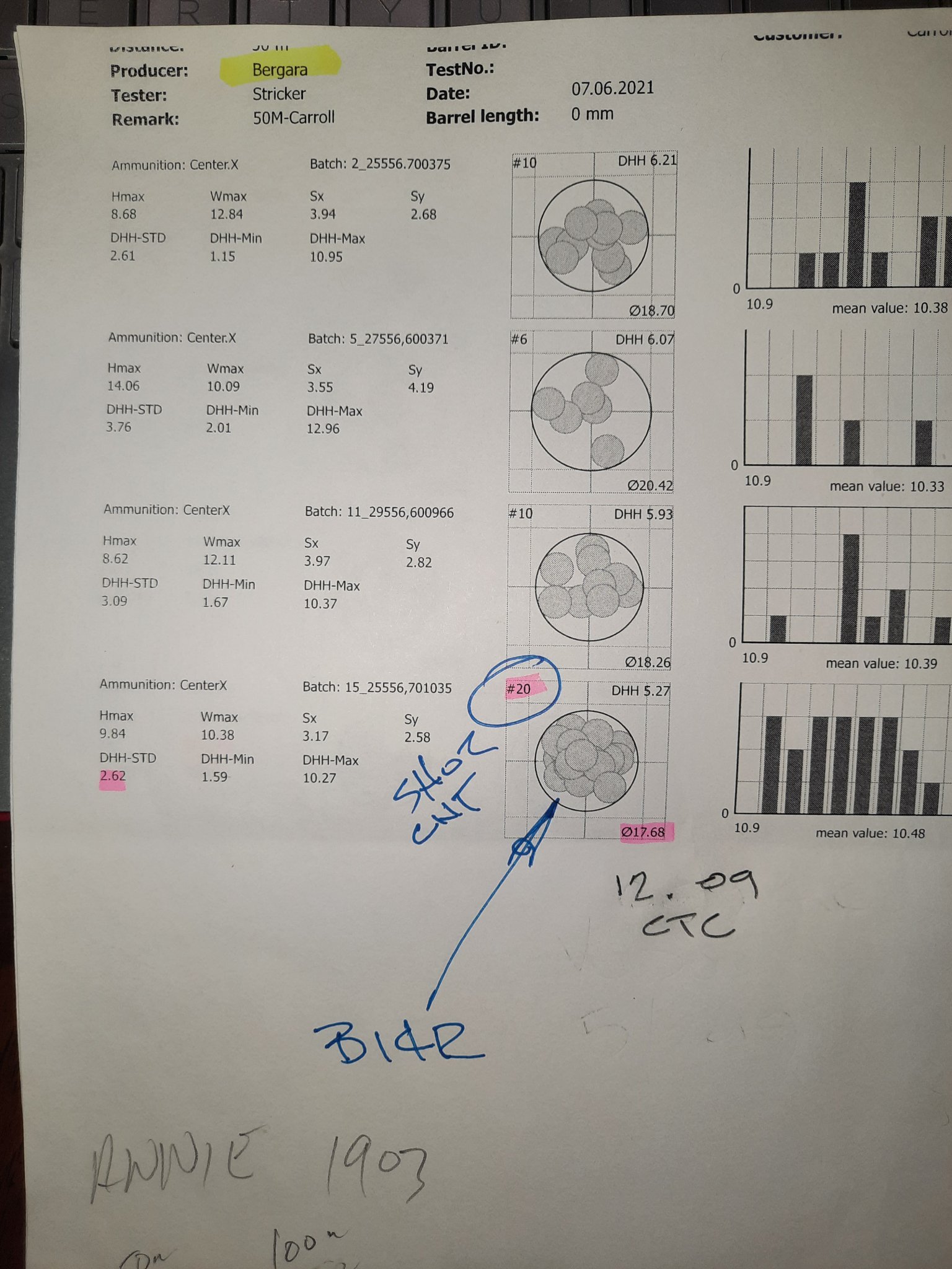

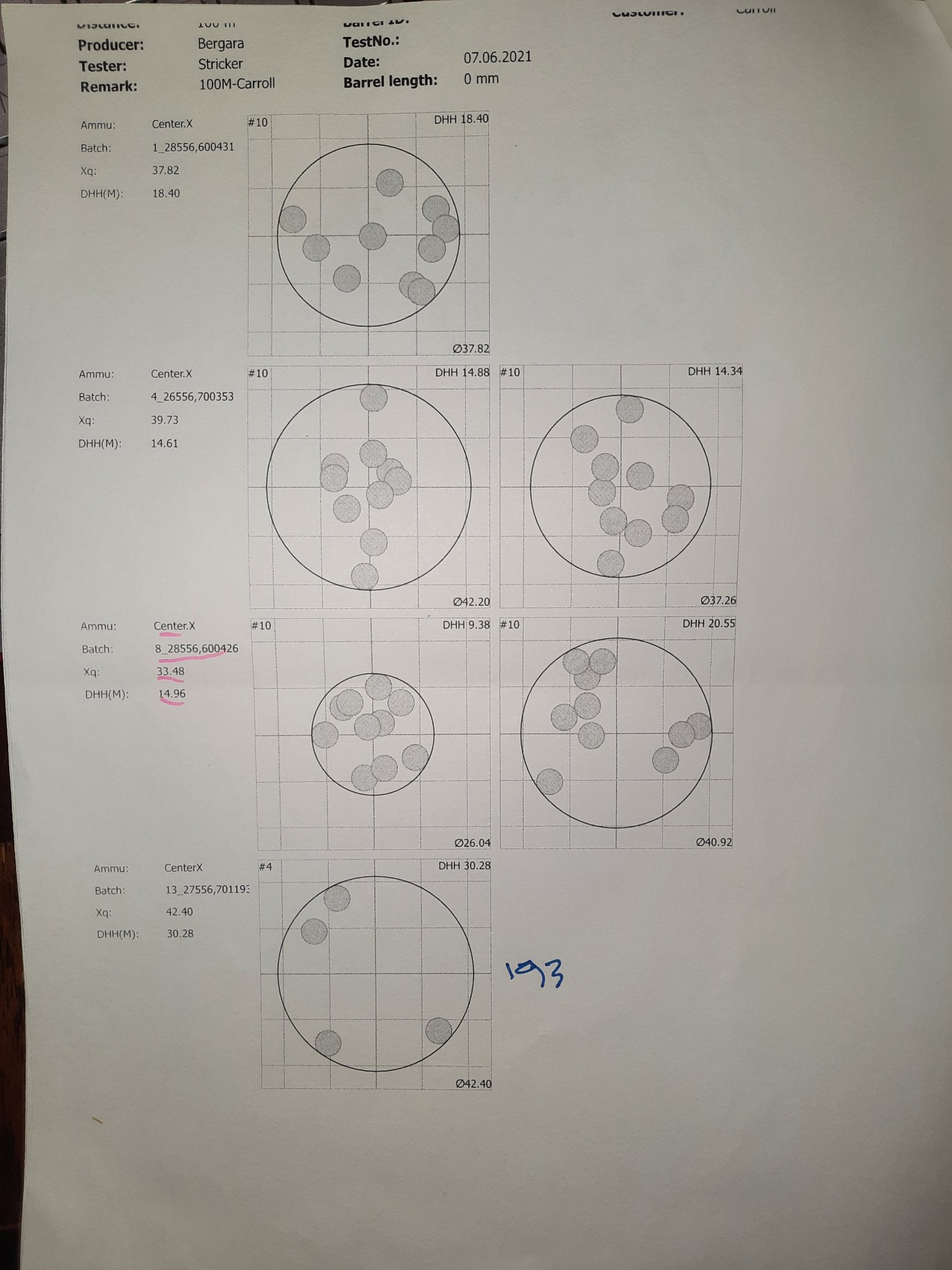

Well, as I look at my lot testing from Lapua, there doesn't seem to be any hard and fast rules they adhere to. Some ammunition is
discarded after only four shots at 50 meters. Labeled as 193 in the photo. Lapua does the 50 and 100 meter testing simultaneously.
It strikes me as a little odd that the bullet just right of center near the 12 o'clock position has crossed over to the left side. In any case, the bullets don't follow a strict mathematical pattern from 50 out to 100 meters. And they test inside from a fixture of some type. From the group labeled B14R it is clear that they were fairly happy with the initial results and ended up shooting 20 shots to come up with a 12.09mm ctc group for their recommendation.
I don't seem to have a clear point today other than to show you what Lapua does as an example. I was really surprised to see that from my V22,
the smallest groups were about .31" ctc but the larger ones opened up to over .81" ctc. ( no tuner ) and that was between lots and not different types. Initially I was not sure about my shooting skills so it made sense to me to send some guns in for lot testing. I'm not a big fan of chasing my tail nor blaming the equipment. But after I felt the various guns and myself were pretty much in sink I felt more comfortable believing my results and therefore felt able to pick ammo myself to a large degree. Now I have guns that I trust and can be fairly confident about my ammo choices.
Until you have your gun lot tested or it is shooting near perfectly and you have an established baseline, how do you know if that gun will even shoot well ? I used to shoot aspirin at 50 yards with my pellet gun so that is my personal baseline. It wasn't a Daisy Red Rider. LoL

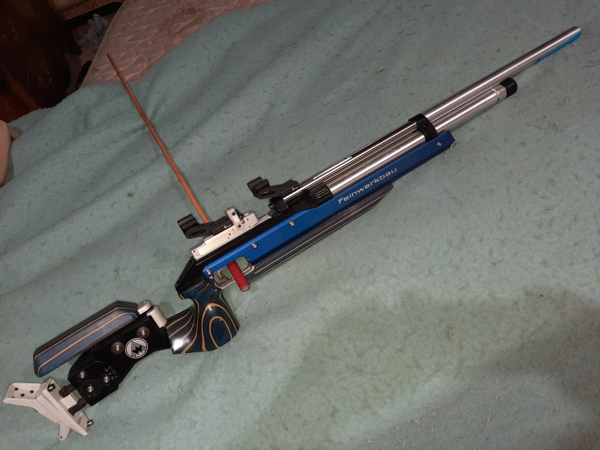

Sidebar.... with a few bucks and a little time, my B14R trigger is breaking at 11 oz. and I didn't need to remove the side plate to do it nor is it a set screw keeping the sear on the hairy edge of disaster.

Looking back we waisted a lot of time trying to sort out the ammo that would work best for us. ( we have 3x Tikka T1x’s ). Many range trips started to indicate that our 3 guns were going to favor 3 different lots of ammo. In the end we had them lot tested at Lapua. Watching as Luke worked thru the lots in the test tunnel confirmed that there was no way we could have gotten as good of a results doing our own testing. We walked away with 3 lots that each have our guns shooting great. My advice would be to just save the time and headache and get your gun lot tested. That way you’ll have confidence that when you are shooting your not fighting the ammo.

The Lapua test centers do have general rules that they use, one of which was pointed out after only 4 shots. Why keep testing a lot that at 50 meters does not have the first 4 touching? Waste of time and money, so they move on to the next one.
As for significant difference between lots, that occurs w/ all brands of match grade ammunition, be it Lapua, Eley or RWS. I have had lots of Tenex that exceeded 1.3" at 50 meters - again, that is a large - but not uncommon - difference and why it is important to test for the best possible matching of specific lots to your rifle.
Utilizing a test center - either Eley or Lapua - will certainly provide insight on how well your rifle will generally perform. Tunnels do some masking on outdoor performance in wind, however to provide a reasonable expectation of test results the elimination of wind as a factor is critical.
The test fixture used at both Lapua test centers (Mesa, AZ or Marengo, OH) allows you action to be clamped into a specific-made aluminum test block or you can also request to have your rifle tested in the stock as a "complete system". The Meyton electronic target system is used to record simultaneous results at both 50 and 100m. Testing is done w/ Lapua XAct, Midas+ or Center-X ammunition.
The Eley test center is located in Winters, TX and is run by Killough Shooting Sports. They also use a similar test fixture in a tunnel utilizing custom made blocks for actions. I believe that they can also barrel clamp or test the complete rifle, however I have not personally been at their facility yet. All testing is done at 50m with only Tenex grade ammunition.

Ken,
I'm afraid I didn't make myself clear. I send most of my guns to Lapua because they can do a much better job than I can do.
From prior testing, I feel I have the equipment and the ability to pick out some decent lots when the guns cant be sent in.
I sent three guns into Lapua a few months ago and was told that I could not send any more in until now, November
because they need to have ammunition for other people. Three more will go in in the next 30 days. They have been limiting
ammo sales to one case per gun as of late.
As far as guidelines, I meant that they don't have rigid guidelines like fire ten shots of each lot regardless of outcome.
You can see from the image that I posted that all they needed to see that lot was crap was four shots. Why would anybody
continue beyond that.
The OP indicated that he wants to do his own lot testing so I was offering the print outs to give him a visual guide. The print
outs also show that Lapua will put 20 shots in a group when they get close to a good lot. Furthermore they give the OP an idea of
what a good lot may look like in terms of size. I wanted to give him information rather than try and convince him he should do it
a different way. Had Franko asked my opinion on what to do, I would have strongly recommended that he not waste his time
or money looking for the best lot. It is very possible that the best lot may not even be available to him but he would have no
way of knowing that. Even if he finds a great lot, he then needs to find a case or two of it. Lapua takes care of that for you.

I have NEVER said that some lots of 22lr will shoot a better MOA group at 200 then 100. It will NEVER happen. Well ok it can but if you do the math on it both groups would land between the statistical range of expected group size at their respective distance and it will be a one off occurrence at the extremes of the expected range giving likely the worst at 50 and best at 100. But back on topic....
There is a rate of MOA increase both with RF and CF even in CF best load at 100 is not necessarily the best at 300 or 1000.
Its this rate of increase that get people hung up. Some ammo have a smaller rate of increase then others that is why the best at 100 is NOT always the best at 200 or 300. The 200 yard group MOA will NEVER be better then as 100.
All of the testing you refer to repeatedly is 50 to 100 or in this case 25 to 50. My results absolutely agree with their results 50 to 100. BUT 100 to 200 is different. Dont believe me? I challenge you to test it for yourself. Take a number of different ammo types. (Eley, Lapua, RWS, SK etc.) same day test 50,100,200 add 300 too if you have the range. Redo this test with the same ammo and lot# multiple days from below freezing to hot summer. Put all of the data into a spreadsheet so you can easy reference.
This is why 12 twist barrels are great for long range 22lr. The rate of MOA increase is less then with a 1-16. At 100 yards there is no difference and 200 its very slight and 300 its very noticeable. I realize this is off topic but It ties in that rate of increase is still there just the rate is less.
I never said anything about what you said or say above. My reply was an elaboration of the observation made by justin amateur.
The following should not be mistaken for argument. The intention is to raise a significant question.
The suggestion that the rate of MOA increase with rimfire ammo that is the best at 100 but not the best further out is interesting and raises a question or two.
On average, a ten-shot group size increases by a factor of 2.8 between 50 and 100 meters, with some better or worse. Clearly, the factor doesn't improve with the same rifle/ammo as distance doubles or doubles again. In fact, it probably gets worse. In any event, it goes without saying that the best ammo at 100 would at least be in a better position than ammo that performs less well as it passes the 100 mark. The ammo that does better at 100 has, in effect, a head start over the ammo that doesn't do as well.
If the contention is that a lot of ammo that does worse than another at 100 can do better than that other ammo at 200, it raises an important question.
Is there a mechanism or physical force that exerts itself only in mid-flight -- somewhere beyond 100 but not before -- that will enable the ammo that performs less well at 100 to do better than the other ammo by the time it gets to 200?
To put it another way, what causes the better performing ammo to experience a performance deterioration more rapidly than the other ammo that didn't perform as well at the half-way point of 100?
I don't know of a force that acts on some ammos but not on others and only after certain distances have been exceeded.
Please note that this is not a request for anyone in particular to identify the cause of the change in performance once an ammo passes 100. It's an open question for which any thoughtful information would be appreciated.

This is a relevant observation and leads to a few questions.
What causes a lot of ammo to produce better results at 100 than another that performs better at 50?
Is it related solely to the ammo, for example a center of gravity offset that occurs in only some or in all the bullets?
Is it related instead to a combination of a particular rifle with it's unique barrel and with a particular lot of ammo -- perhaps something that happens with that lot of ammo as its bullets pass through that rifle's unique bore?
Does this relationship hold and continue over a larger sample size of data -- that is, over more target results than developed at testing facilities?
I have tested this in my limited way by taking SV and HV of the same ammo type. In all cases going from a 1100 fps to a 1250 fps wind drift increased with the 1250 fps ammo. But groups remained very simular at 200 yards. I dont see SV vs HV as a factor other then ES under 300 yards.
Even ammo in the 1040s has performed simular.
I see more differences in groups if I categorize ammo by Ogive to base length then by velocity. I still need to do more on that though.

1-12, 1-16 rate of vertical group ES MOA growth is 12 twist first / 16 twist
50-100 1.27/ 1.31
100-200 1.77/ 1.80
200-300 1.23/ 1.76
Here is a Graph of 1-12 vs 1-16 numbers wont match above as this is lots of ammo that have only been shoot in both and have simular vertical ES at 200. More apples to apples.
Here is a bunch of ammo charting. This is average vertical group ES in MOA somewhere over 200 groups here.
50 and 100 yard are 10 shot groups and 200, 300 are 20 shot. This is all from the same rifle to show how it looks if your testing looking for the best at long range in a rifle. You will notice there are a few that shot a better vertical at 100 then at 50.
You will also note that the best at 200, 300 in this rifle is some of the worst at 100. This is not unusual and have seen this in more rifles.
This is something I noticed awhile ago in the days of recording everything on paper. I finally woke up to the fact I'm loosing a lot of information by not using excel. Worked on developing a testing procedure that gives me repeatable results with the same lot of ammo. Reliable procedure so when I buy a case of ammo its for real. Built a spreadsheet and have been saving in excel now.
Couple general observations relating to long range. Lot to lot variations do exist but ammo types in general shoot simular. (With in statistical expected group ES variation.) E.g. lapua will be simular, SK, Eley match/ Tenex. I will have the odd hummer lot in a rifle and the very odd bummer with in types. An no this is not always visually or velocity predictable with high end ammo.
Reactions: Franko and Quickoz
