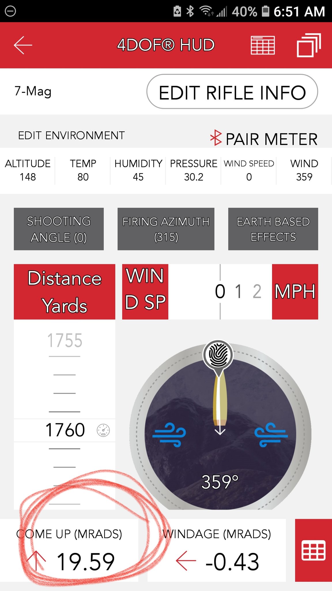

Get the mil reticle scope, get a ballistic solver (ie strelok app), plug in the data:
Ammo / MV
Scope / reticle
Bore height
Zero distance
And play. Shoot. And adjust accordingly. Shoot more.
Get a ballistic app for your phone and learn how to use it with your scope. Here’s a quick screenshot from my .22 using SK Std+. Note how once I know the yardage I need to shoot, it gives me my drop in mils. No conversion, no math, no thinking about it. Just dial and go. Oh, and learn your windage.
ETA: mrad is mils (milradians)

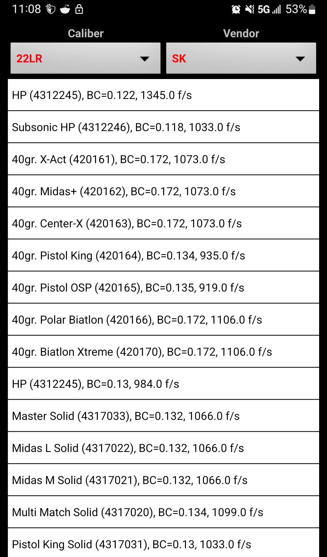

How did you find the bullet used in you ammos BC? Was it listed at SK's website? Been looking at Eley's WS and can't find anywhere they list the BC's of the bullets they use. Both my B14R and T1X love Eley Team.

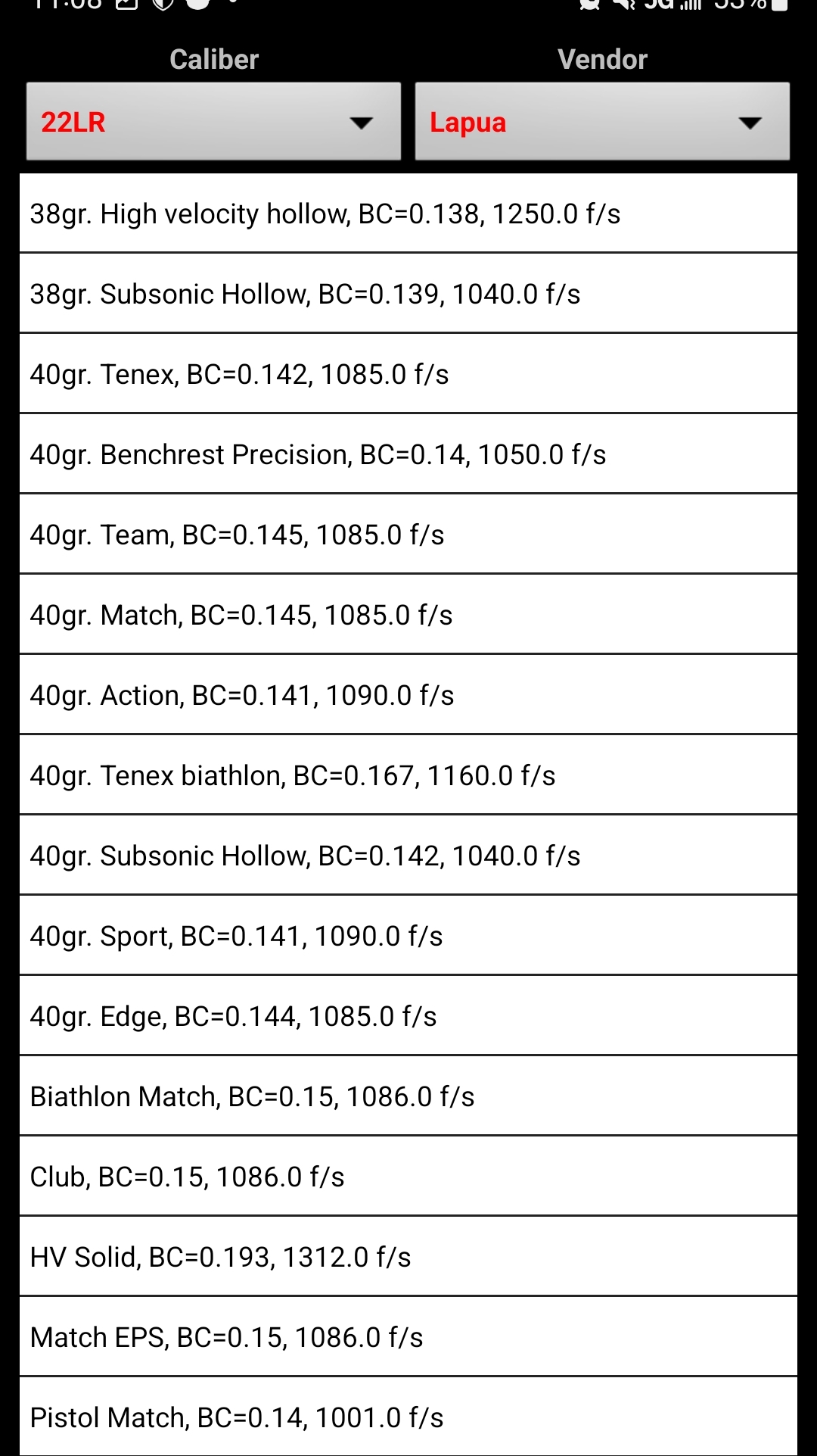

Strlok has database of 22LR same with Kestrel and i imagine other ballistic solvers.
Here is the example from strlok

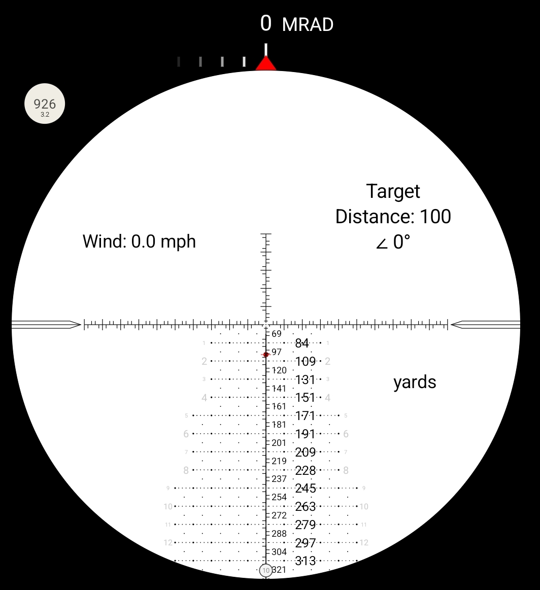

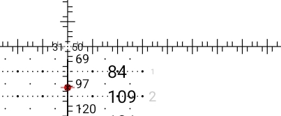

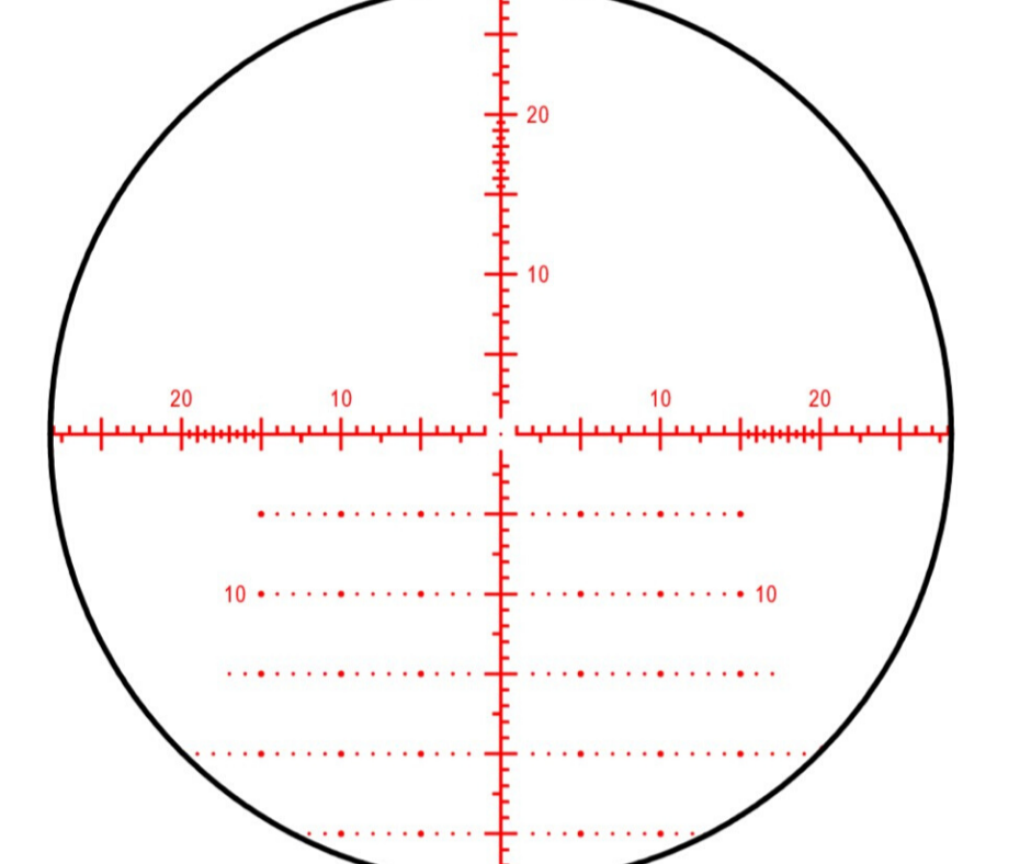

Yeah, don't think about inches etc.
For example - if I dial up to hit 100 yard target and the red dot represent my actual impact, which is low, I measure how much up i have to go with my reticle - in this case i still have to come up 1.7 mils and i adjust accordingly without converting anything to inches
Same is done with MOA reticle
View attachment 7993534View attachment 7993535

Your reticle is a ruler. Use it.
When I have a tape measure, if I need to read it in inches, i read the inches side--if I need to read cm, i read the cm side. Nothing changes.
Put this over the target. Measure where you hit to where you aim. Adjust. Profit.

Stop thinking of converting things.
7 Mag, 162 ELDM at 2980.
In MILs it's 19.6 (rounded up)
If I wanted to switch to a MOA optic, then I'd just touch the Dope and it brings up in MOA and IPHY.
All three are the same amount with different units of measurement.
The unit could be bananas, axe handles or Skittles. None of that matters.

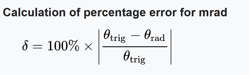

Both MOA and MRAD systems use approximations. Let's take an inch at 100 yards. These approximations get larger as the angle, and consequently, the distance increases (you did mention that). That is why above I mentioned that three clicks on a .1 MIL scope are 1.08 inches whereas in MOA that approximation (4-clicks) is 1.047. taking that into account, the approximation error is now down to .033. That is three one hundreds of an inch!
And it gets worse for MOA. MRAD although interchangeable within numerical systems really shines when using the metric system where it was designed to be used. And there the approximation error in .1 MIL using 1 centimeter at 100 meters is 3.3×10−7%. That's .00000033 for a .1 MIL angle approximation error! The formulas for approximation errors are complex, but available on the internet.
These are very good reasons why the US military adopted both the Metric and MRAD systems. The system is more precise. ;)
