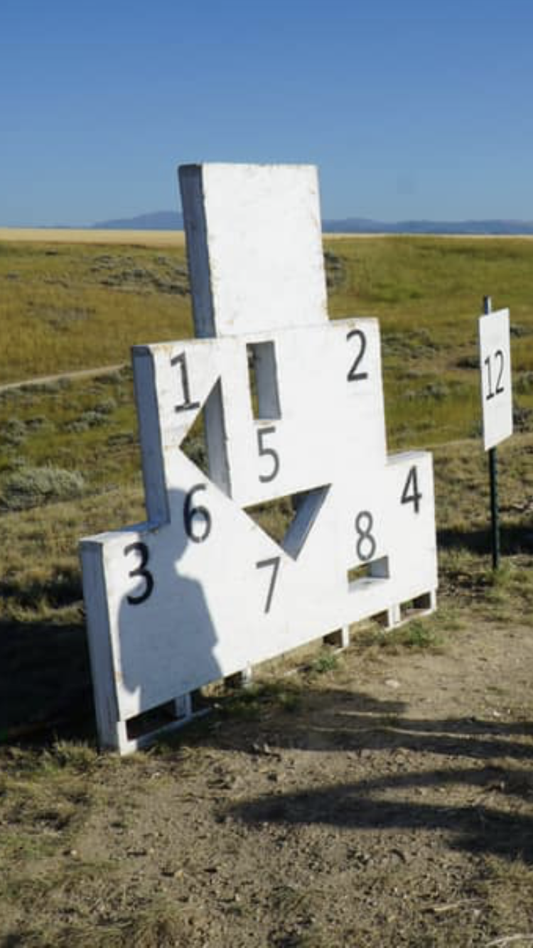

School me...
How would your shoot position #8?
Assuming you can’t use a bipod or another support for the forearm of the rifle. I.E. the rifle has to be resting on the barricade:
If the rifle forearm and barrel will fit in the port, then use that as front support and pump pillow as rear bag. Shoot it prone.
If it won’t fit, lay the gun on its side at a 90 deg and use one of the calculators that will solve for canted rifle. If the intent is to lay the rifle on the side, the targets will probably be generous, so using a different calculator than you have your data trued in will probably work.

Just don’t rest your barrel itself on the barricade
Meh, if the target is big enough, you might have to and it will be fine.
Rifles only used to have stages where your barrel was required to rest on something. It doesn’t make as big a deal as people think if the target is close/big enough.
Original intent of matches were to mimic real life. You don’t always get to choose your rest and if you have to rest the barrel on something, while not ideal, so be it.
Then he better practice that way, otherwise he’ll find his shots hitting over the target more than likely.

Ja had it right, though you had to be careful not to rest your barrel or muzzle device on the barricade. I shot it the same way.
You would have liked it this year Sheldon, they definitely took a step forward with the match.
I'd shoot it like Ja did in this video. @Birddog6424

Yes, I can honestly say that's exactly how I would shoot that stage :)
