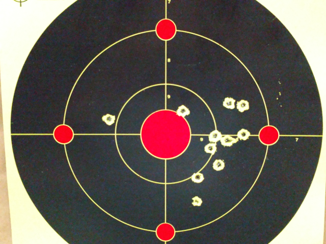

Finally got to the range to start breaking the new rig in. I had an original Howa DBM setup, the factory Hogue stock, and a Valdada IOR 2-Piece rail to mount the SWFA SS 10x42.
I read up on Mike Rock's barrel burnishing technique for new barrels. He would use a moly/alcohol solution to saturate the bore. When the alcohol dried, he would then burnish the barrel with moly powder saturated patches for 100 strokes, rest and repeat. After, a couple of dry patches ensure that loose powder is removed.
I figured since hBN (hexagonal boron nitride) is slicker and has smaller particles than moly and gasses off at 2500c vs 400c for moly, it might be worth a try. So, I mixed up a hBN & alcohol solution and got to work. I imagine that the theory is, the nano particles penetrate and lubricate the bore to reduce friction during breakin. After the "burnishing" the bore shined like a diamond when illuminated with a bore light.
At the range, I slowly fired a 20 round box of cheap ammo - Federal NonTypical Whitetail 140gr SP. After sight-in at 100yd, the following target is from the rest of the box at 200yd.
Wind was variable 3-10, left to right, unadjusted. The grouping amuses me. The cheap Federal is typical of the SP ammo that's been bounced for miles on a delivery truck then manhandled in the warehouse and store. The points all looked like either chisels or mushrooms. The flyer at 0930 really makes me chuckle. That must have been a chisel tip.
I'm about to clean, which should give an idea how much the hBN burnishing reduced fouling.
At the very least, it's an interesting experiment.
