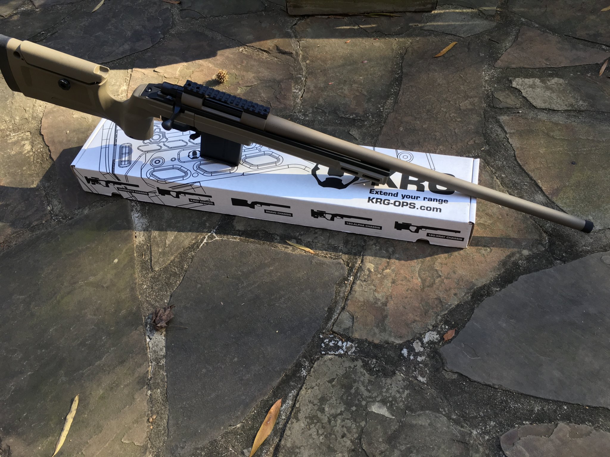

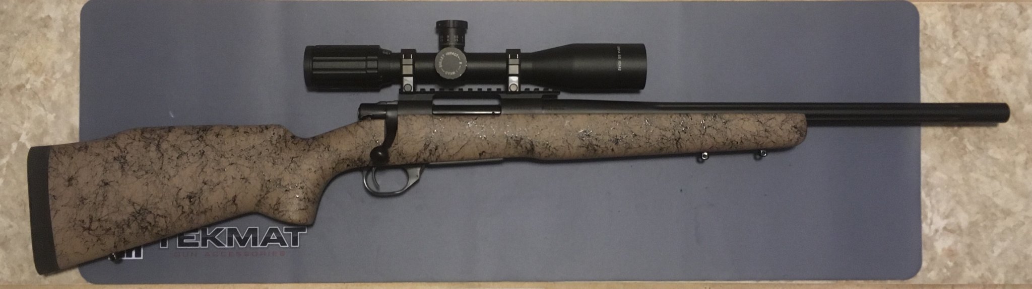

just got all the parts in for this. 20" barrel 308.
b&c m40 stock, timney trigger, NF rail and rings.
took it back apart tonight to bed, devcon drying now.
was able to snag a bunch of 175 gr prime when it was 165, anxious to see how it shoots.
What scope is that?
It's a Leupold 3.5-10 mark 4

I like the choate but man is it heavy. Seems to be a solid stock for a budget gun. Eventually will get changed out to a krg bravo.
Really like how heavy? Mine is in the B&C target comp, I thought about thebchoate but wanted adjustable comb. My gun seems almost light. 20" 308 thumps, more of a push but still.

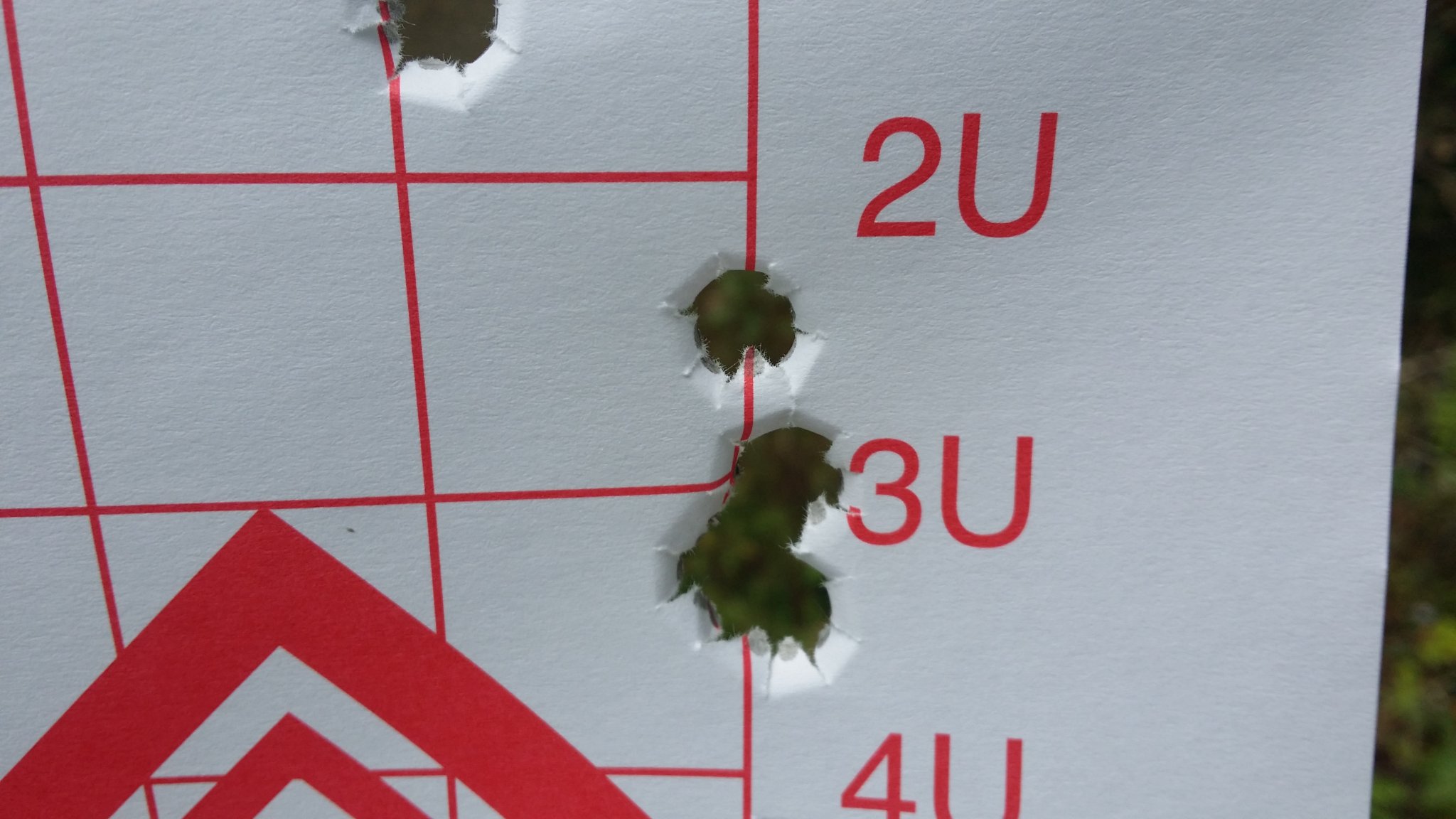

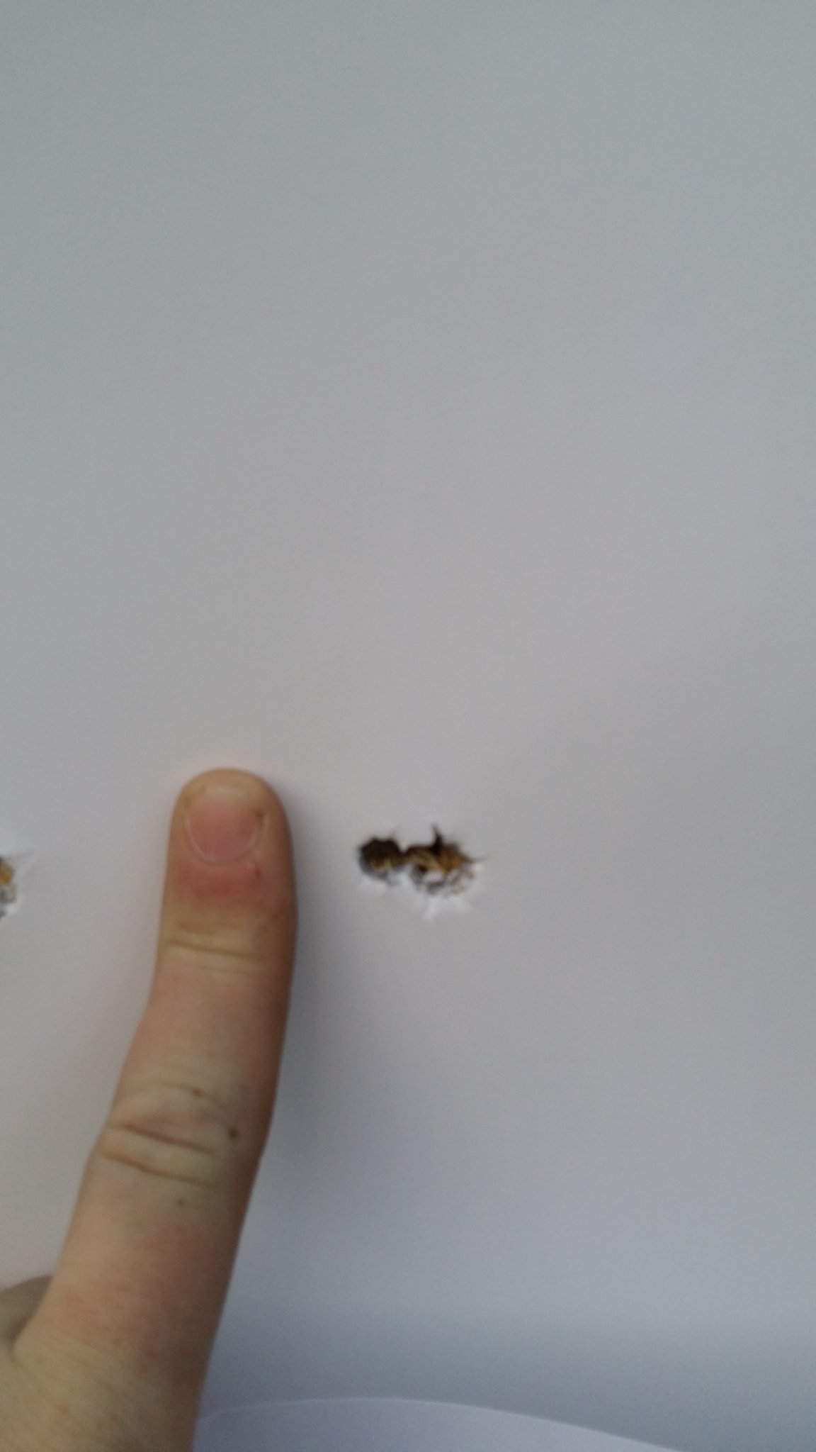

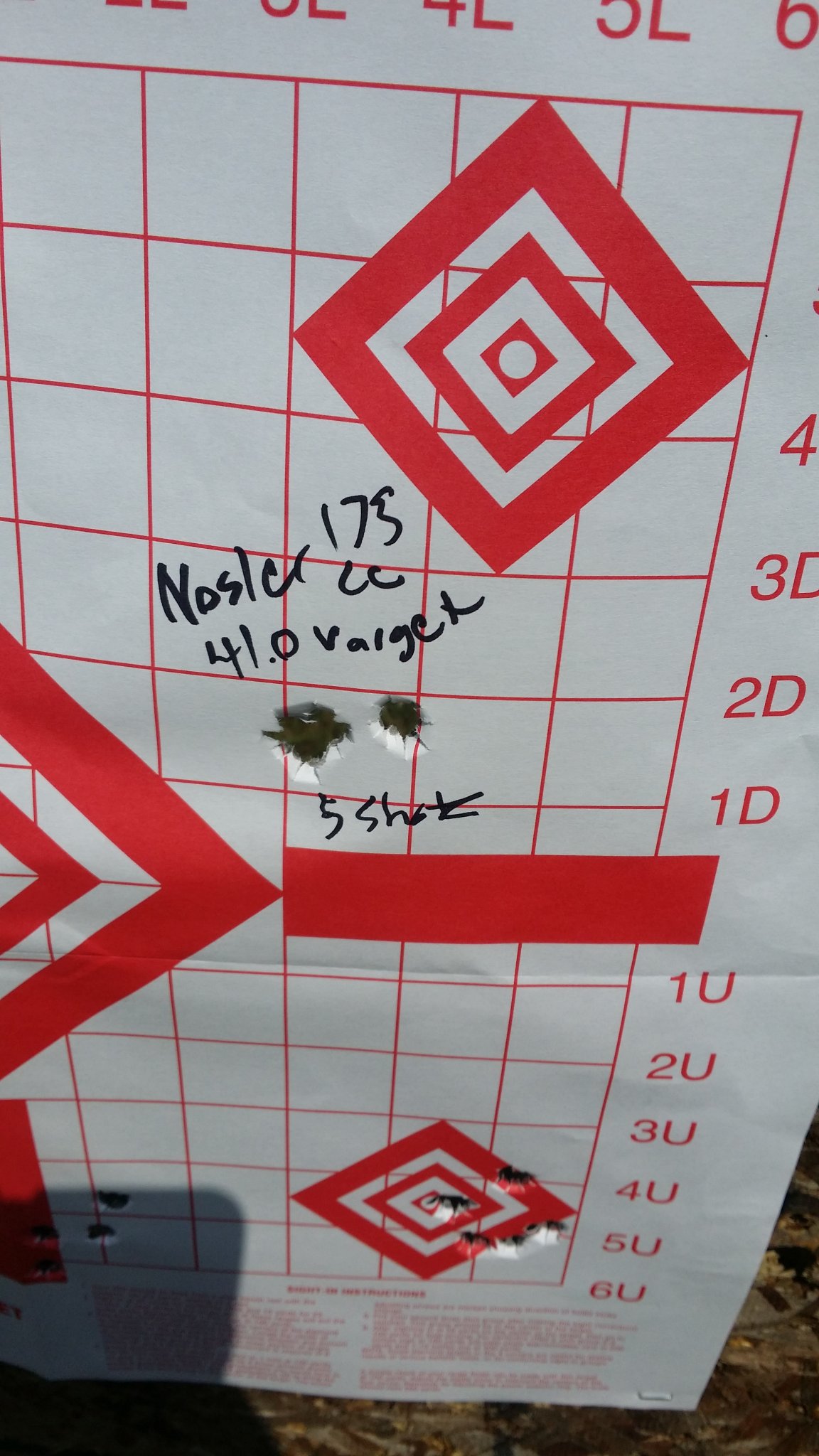

First try at handloads, Nosler 175 CC over 41.0 gr Varget, Federal brass, CCI BR primers. Totally threw the one shot. Not bad for a 230$ barrelled action. Looks like I got lucky on my first handloads ever. Now gotta roll up 60r for a match.
It’s 4.6 pounds!
The gun all set up is 12.6 pounds. Pretty stout for a 20 inch gun.
I looked long and hard at the B&C with adjustable comb. The choate is fine with the triad cheek rest for now.

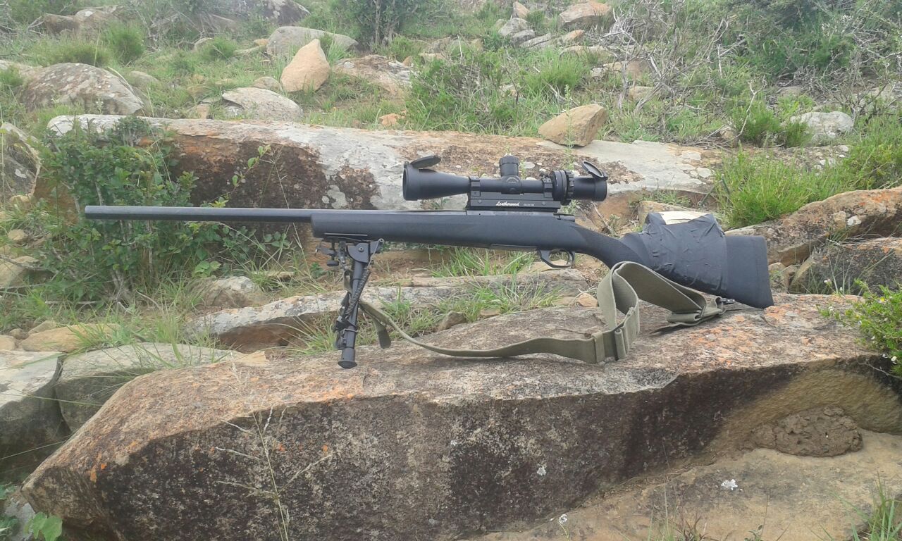

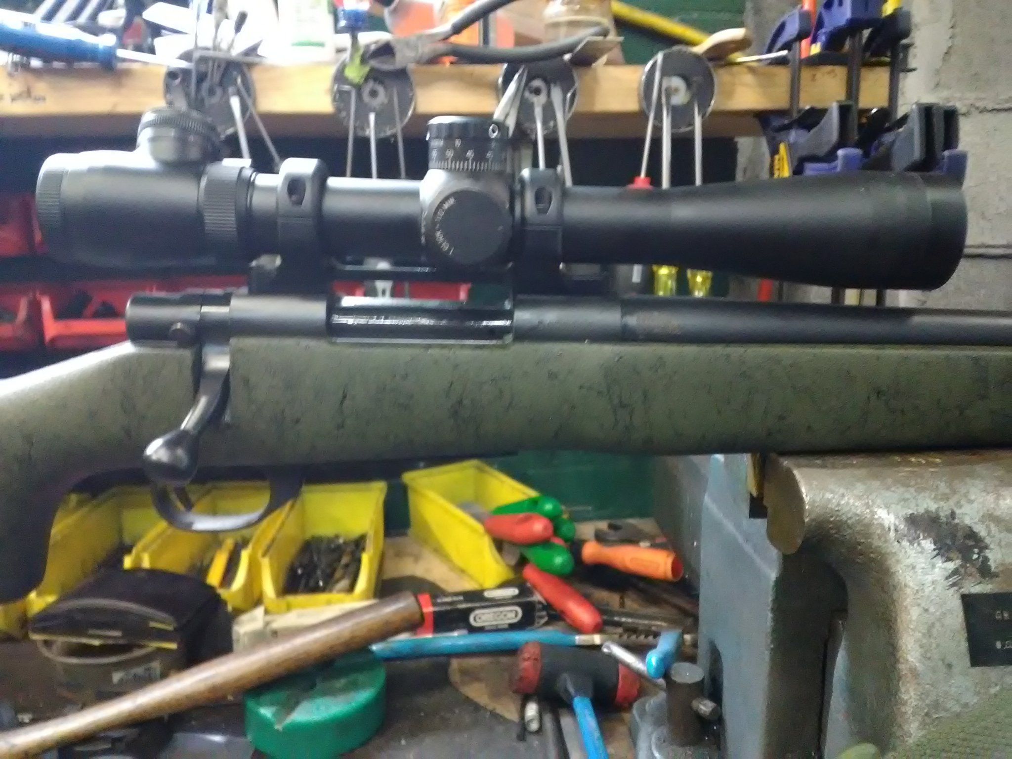

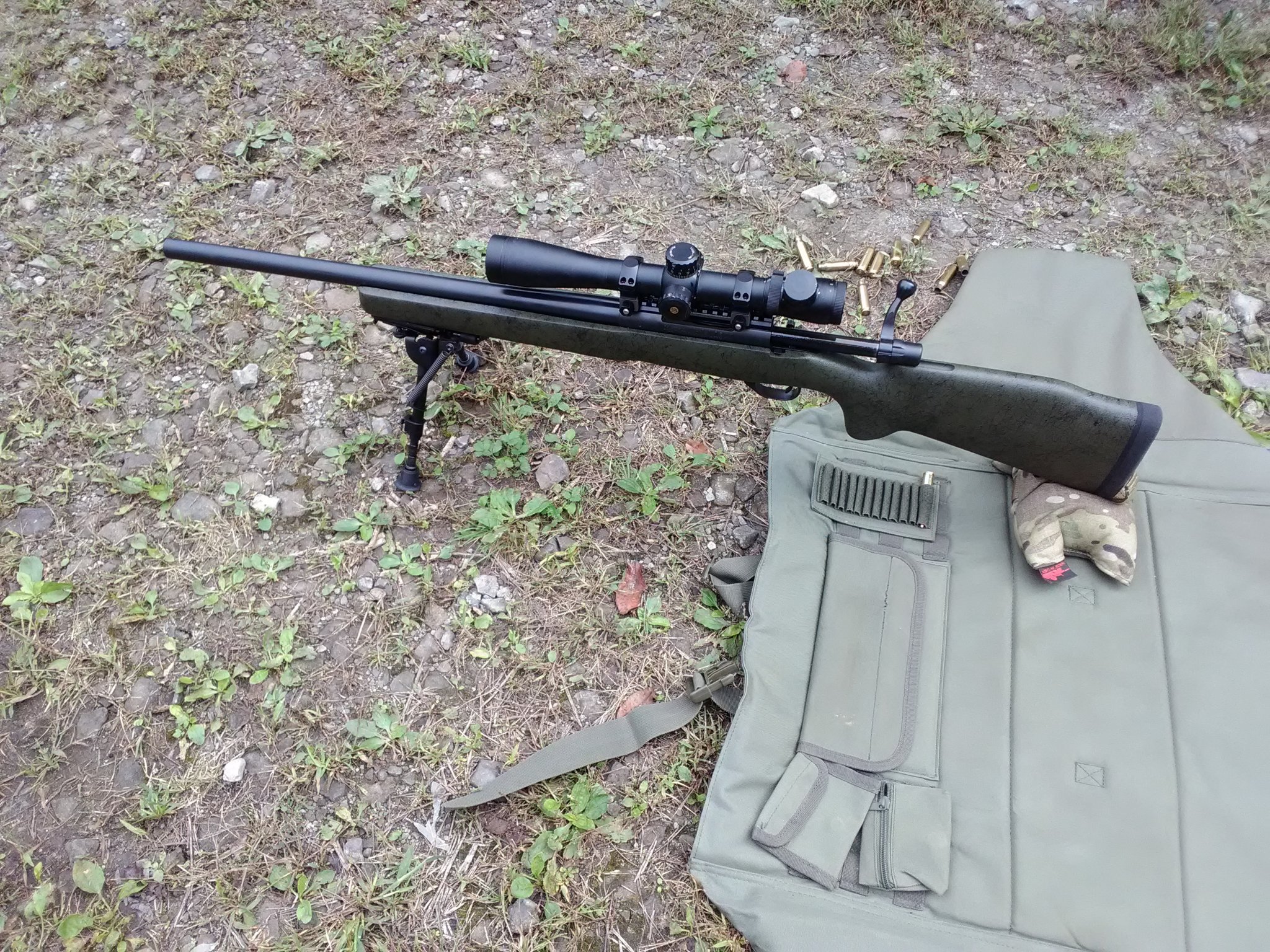

Still very much a work in progress and most parts get extremely pricy in South Africa but here's my current setup
Forgive that cheek riser, took the rifle hunting 2 days after picking it up and needed something in a hurry:LOL:

Still want to build myself a new stock and possibly put in a DBM conversion
Might replace the optics as well sometime soon

Two groups on the left 11$ 150 soft point on wally rollback. Needless to say went back and bought the rest. I like federal brass anyways which is why I bought it not expecting any kind of accuracey.
One thing ive noticed with my howa it cloverleafs 4 then throws the 5th with several different loads. Its in a B&C torqued to 55 "lbs. Gonna bed it and hopefully that will fix it. Gets pretty good barrel mirage going after 20 rounds shot fairly quick.
Interesting you should say that, I had something similar when I was testing new powder. Haven't gotten a chance to test it out further but ill keep my eyes peeled for that
Let me know if the bedding works if you don't mind
Will do. I only "broke it in" with their method for 10 shots then just shot. I think the bedding will help over all anyways. Usually does.

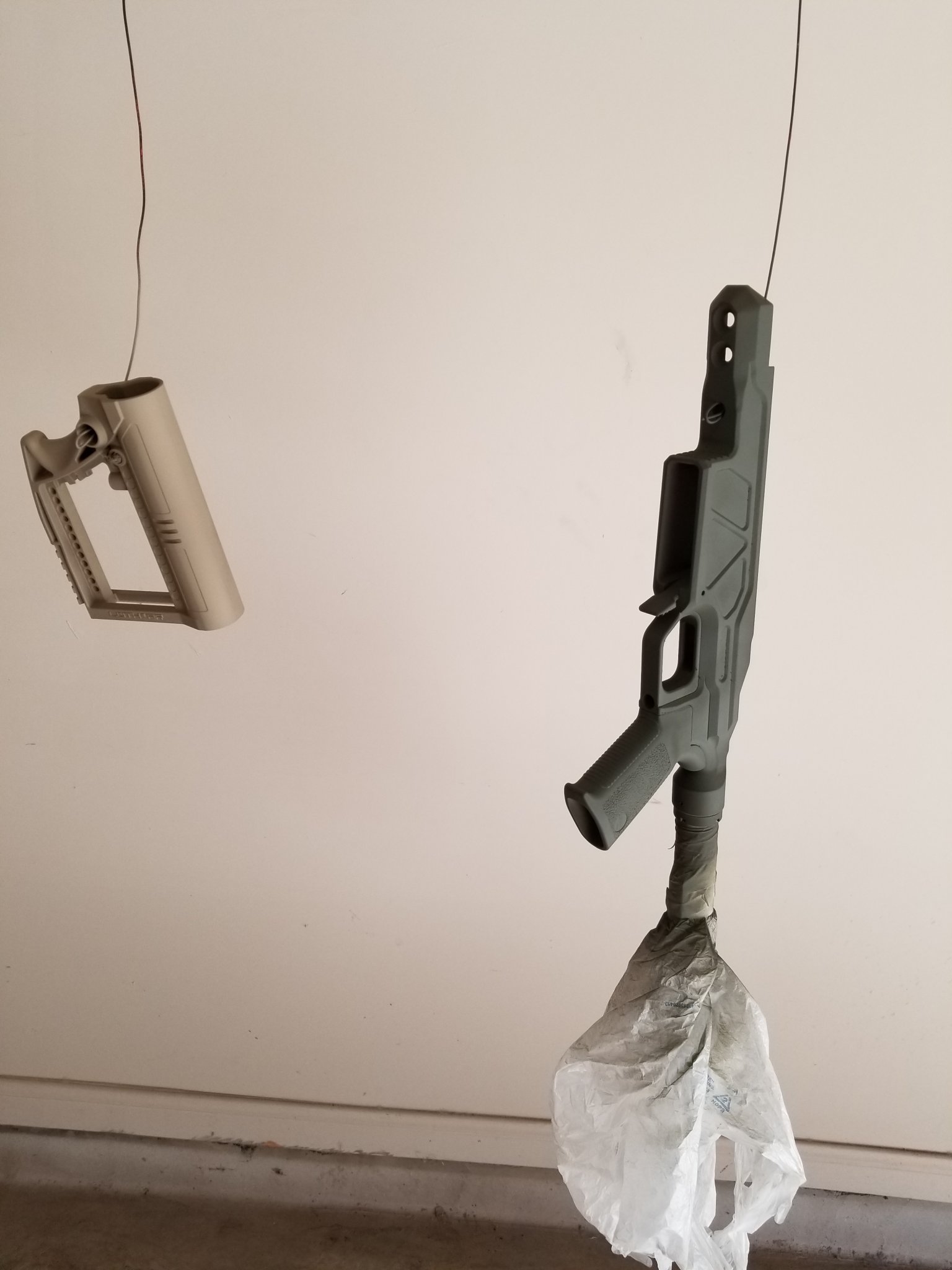

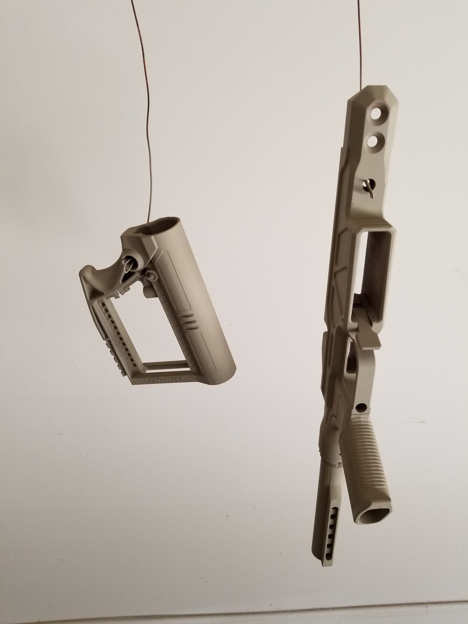

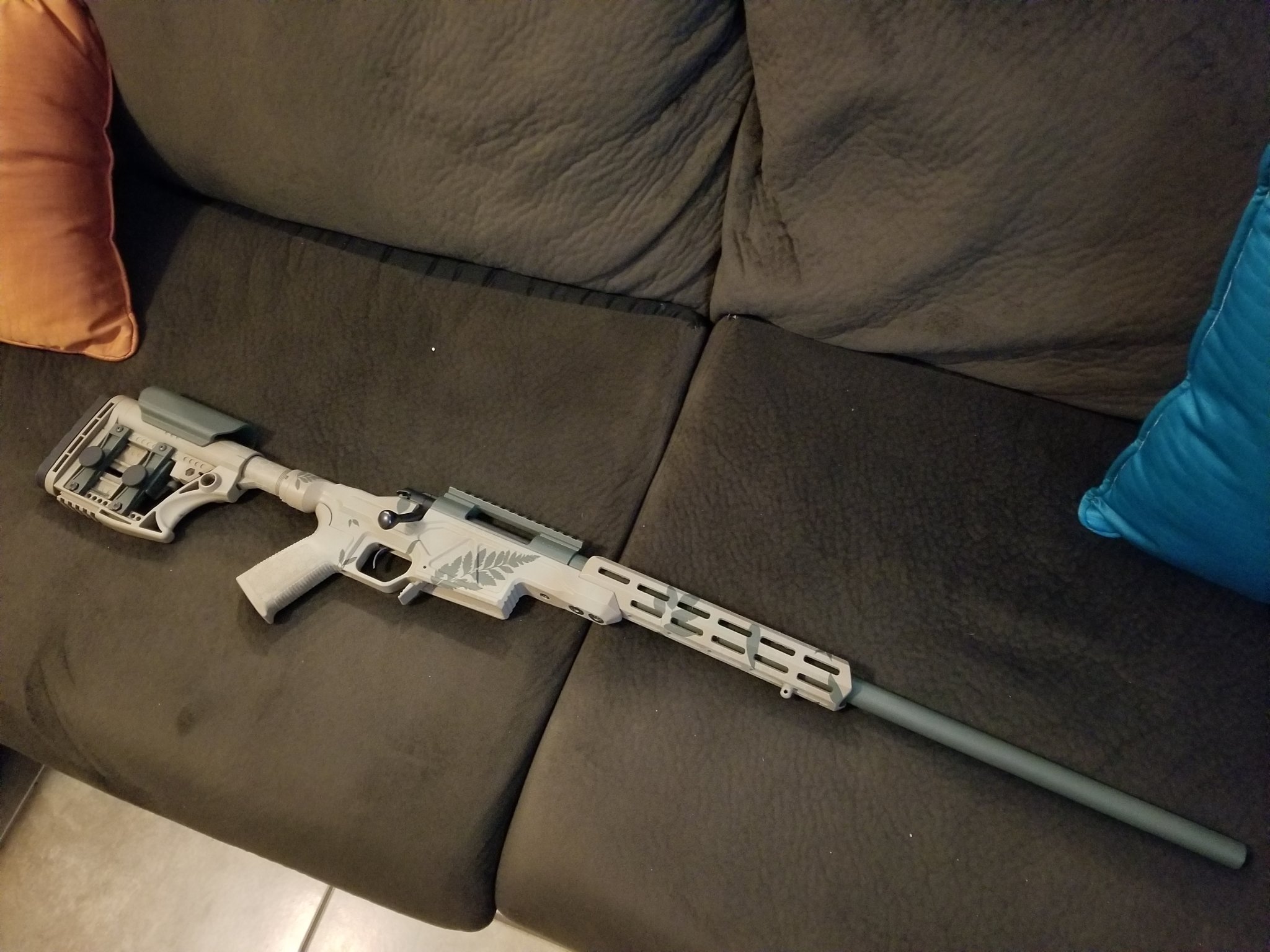

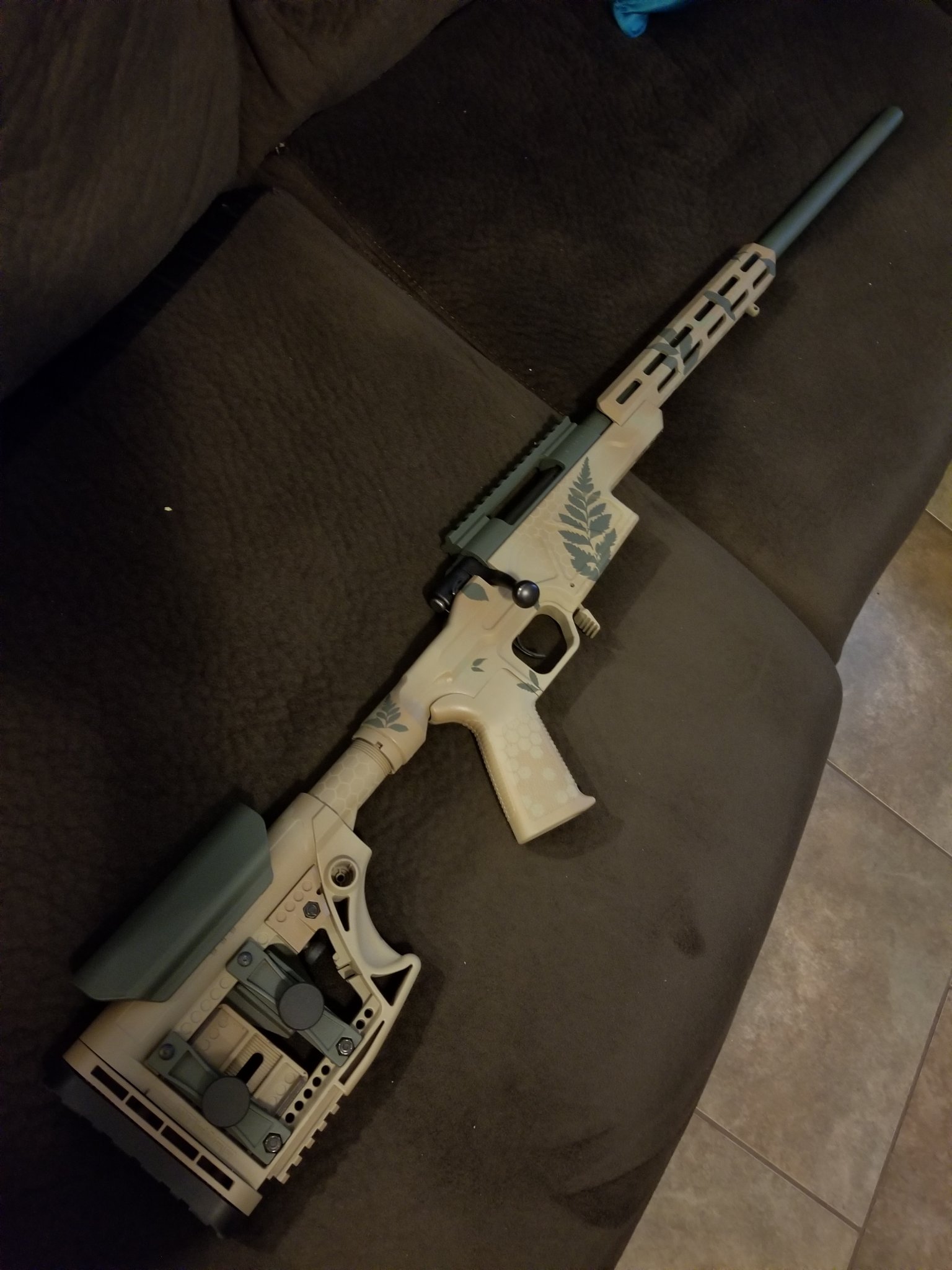

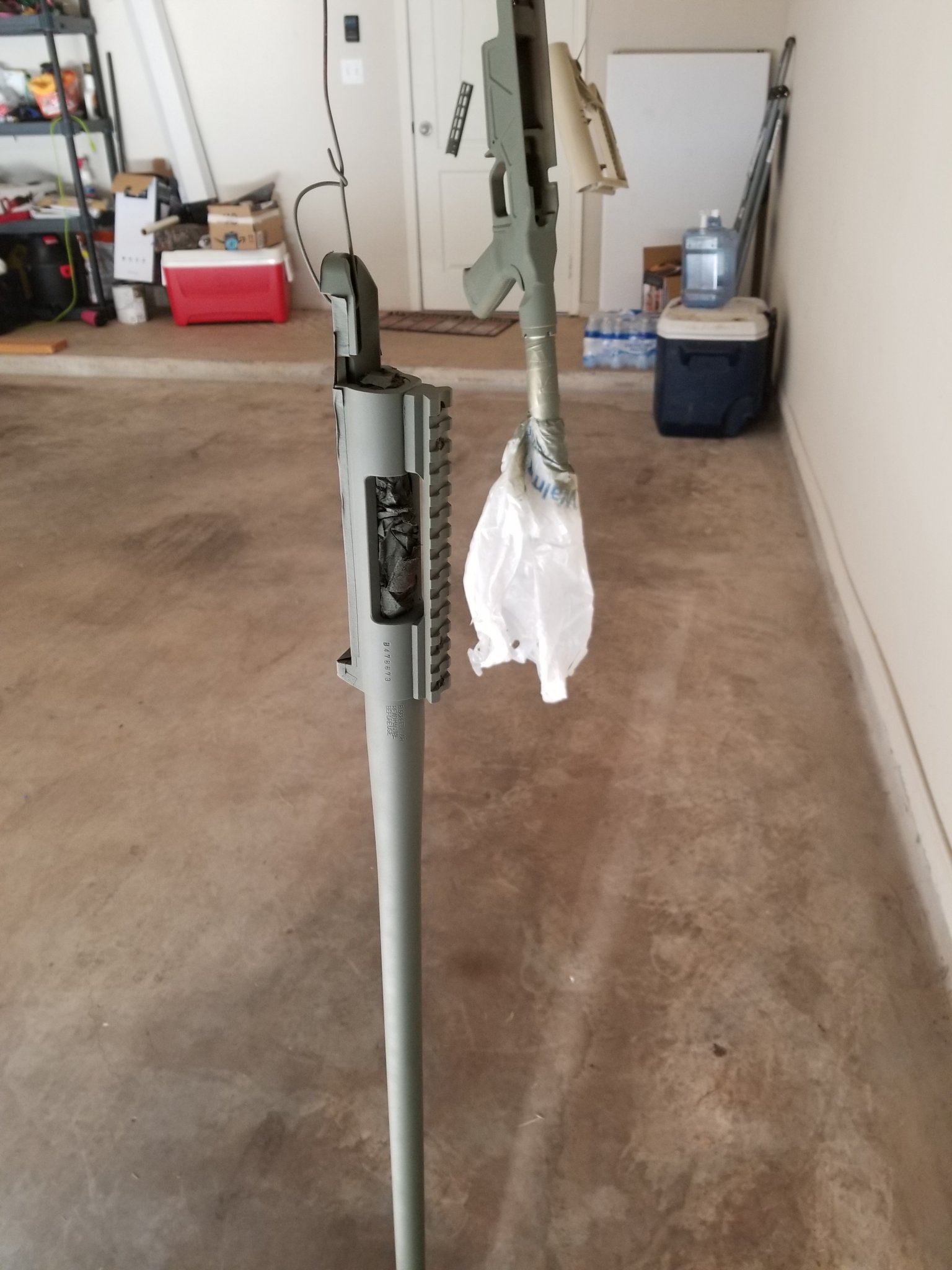

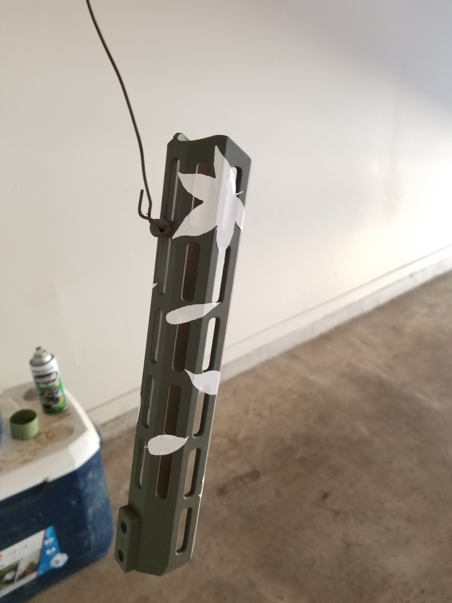

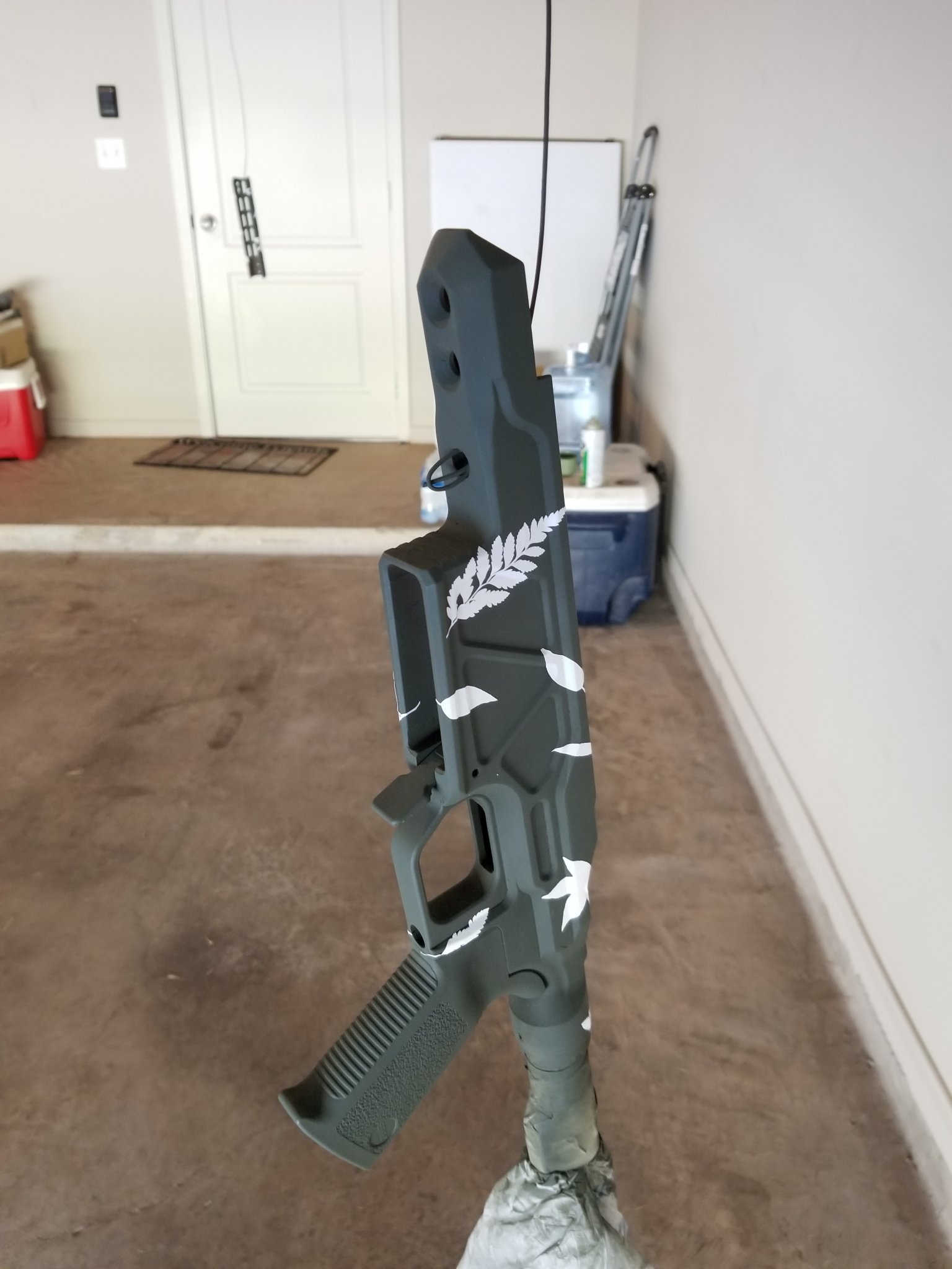

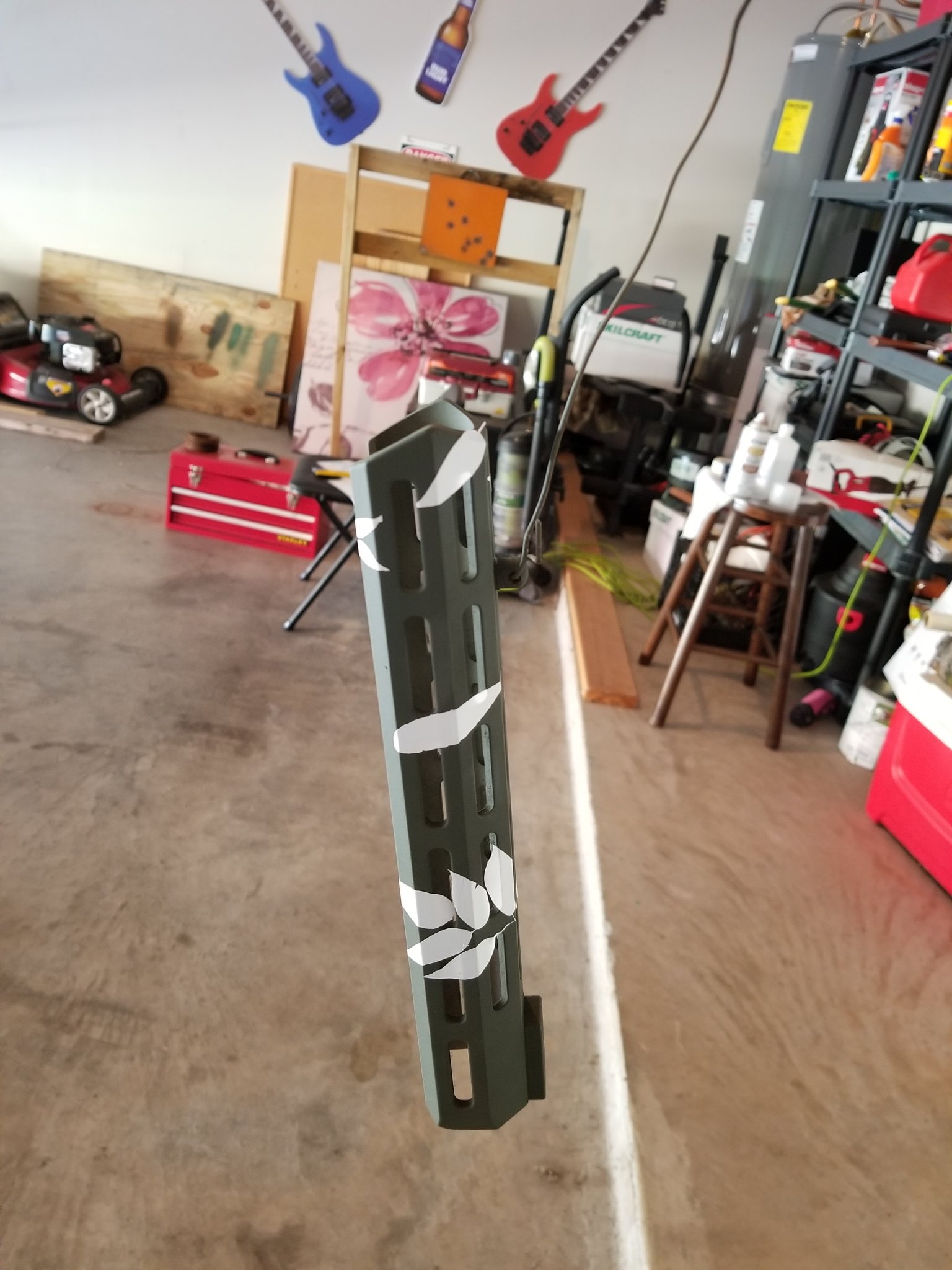

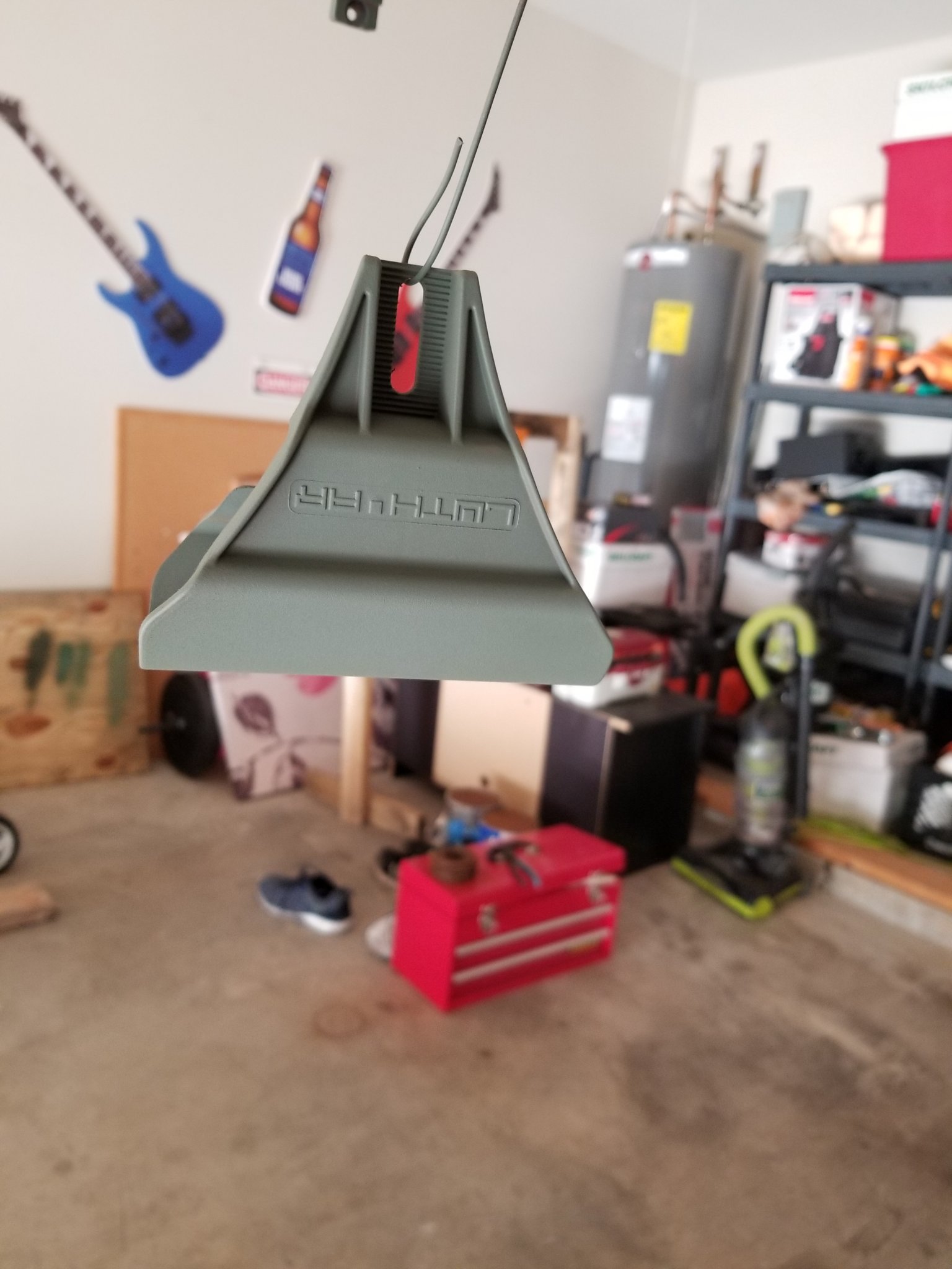

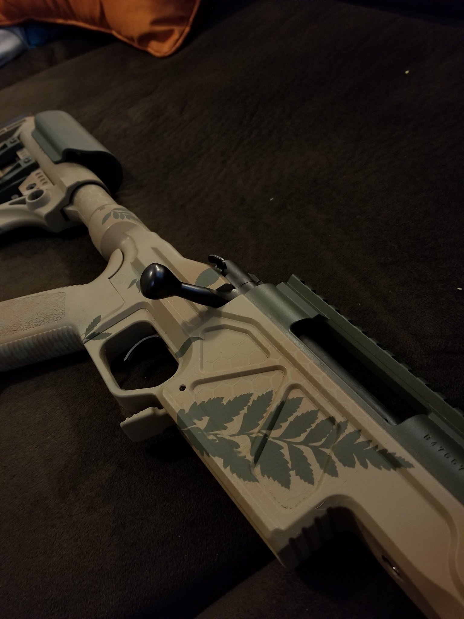

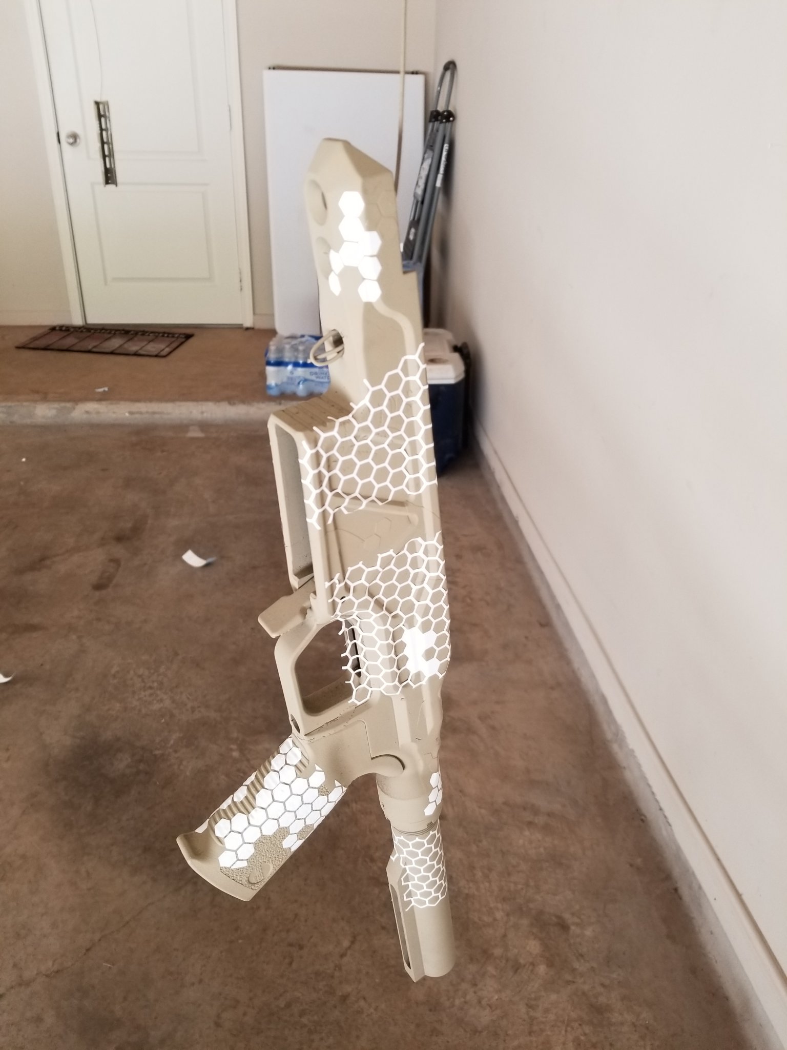

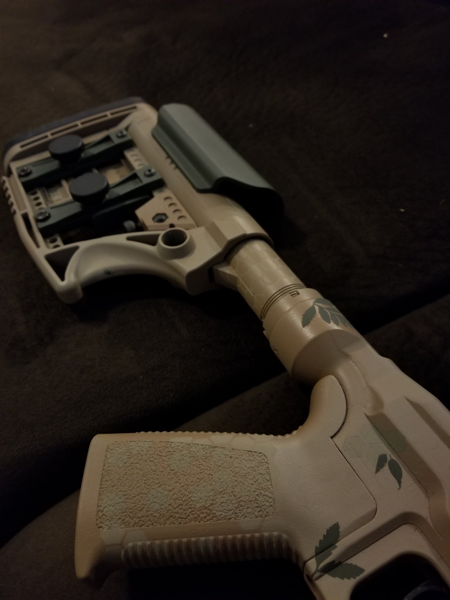

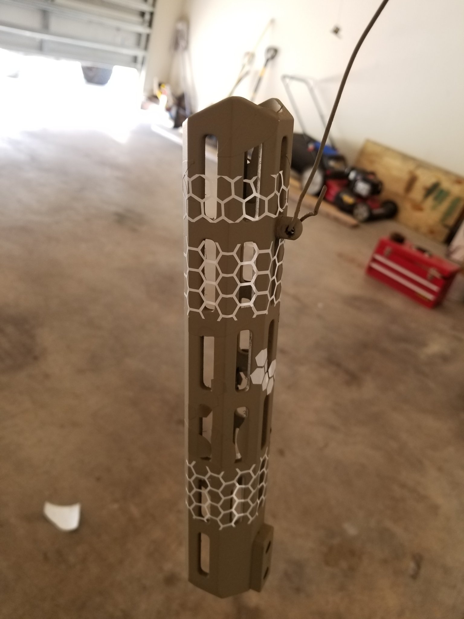

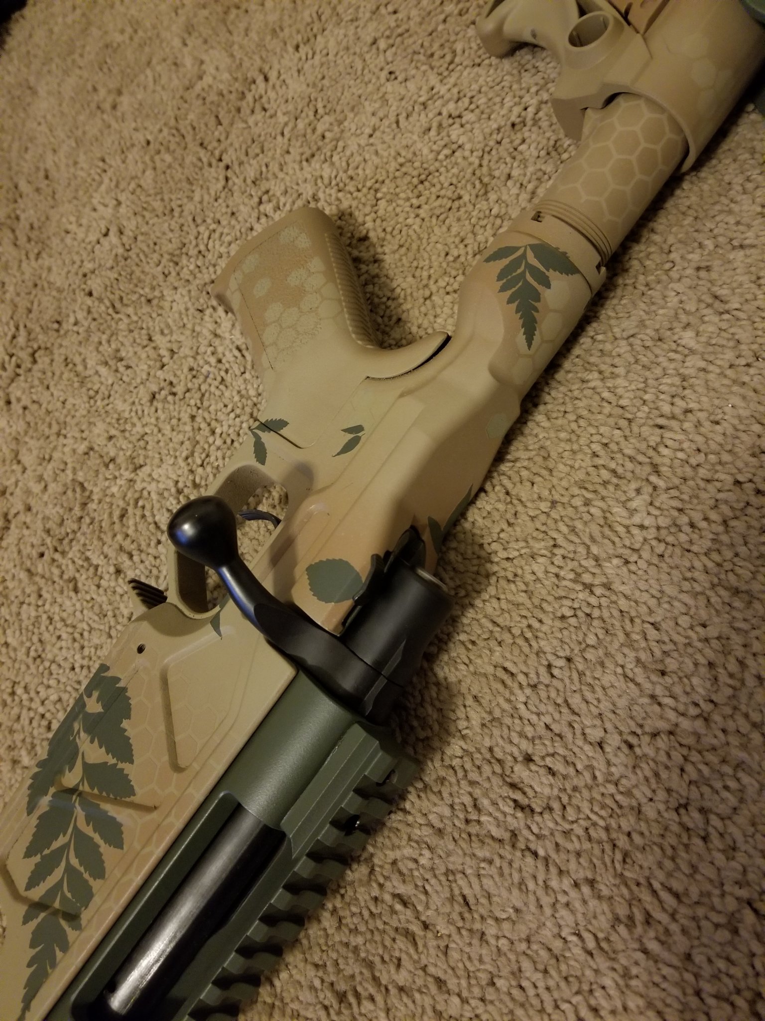

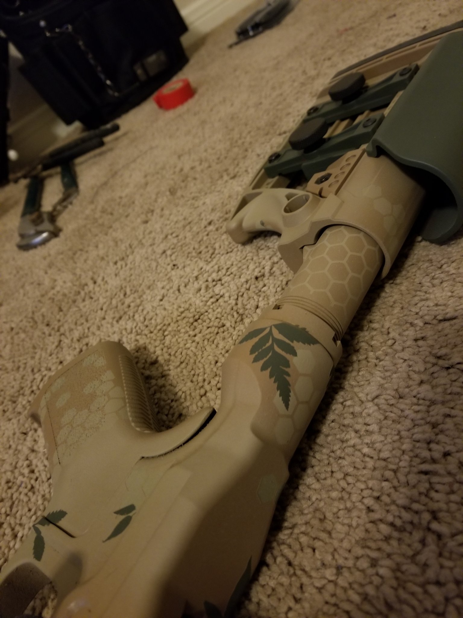

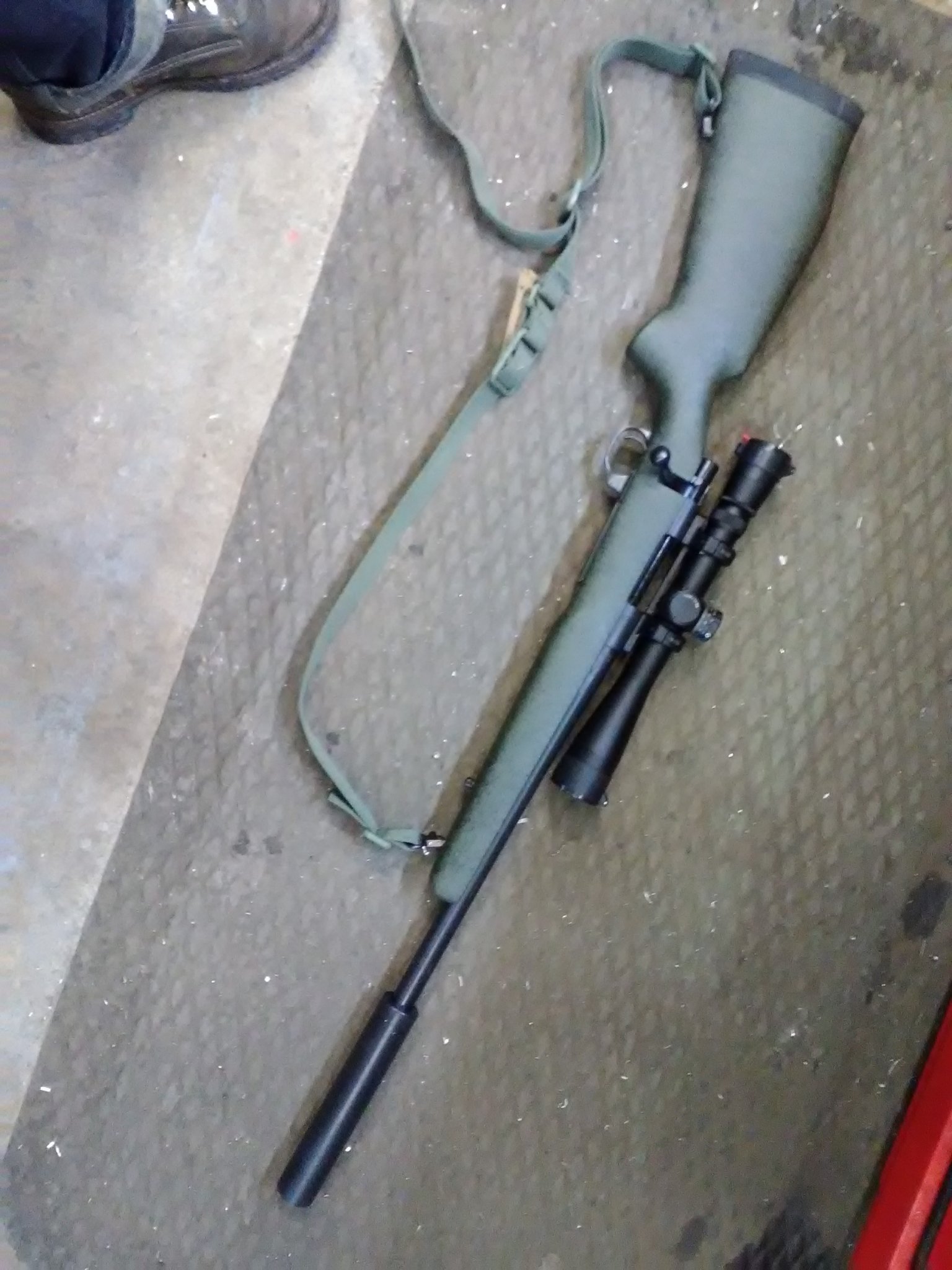

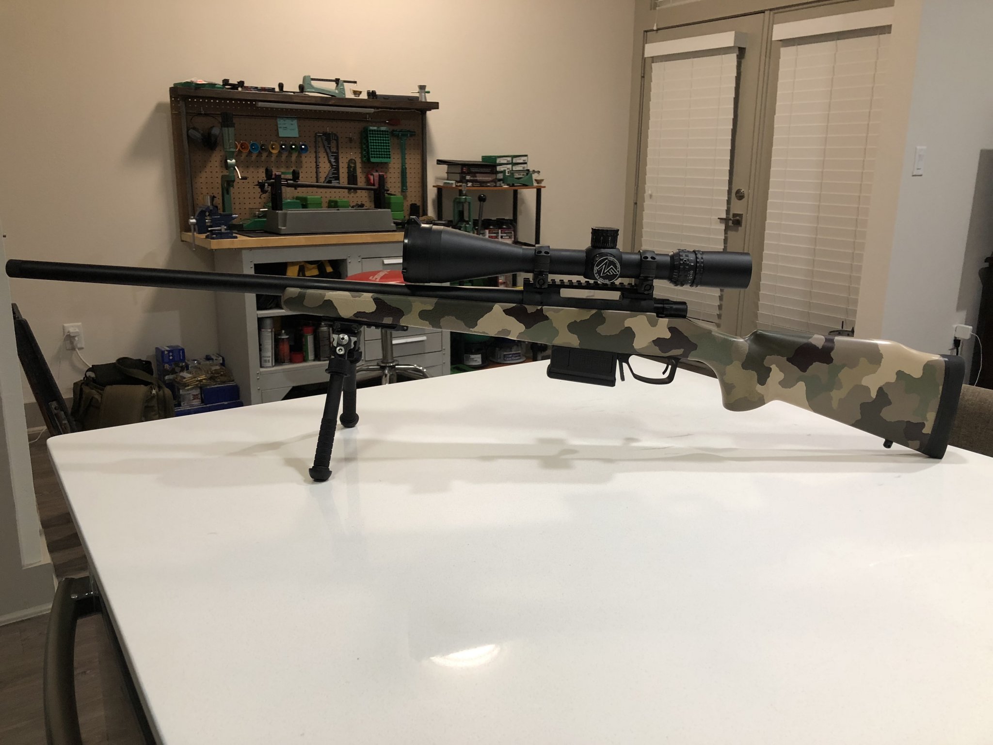

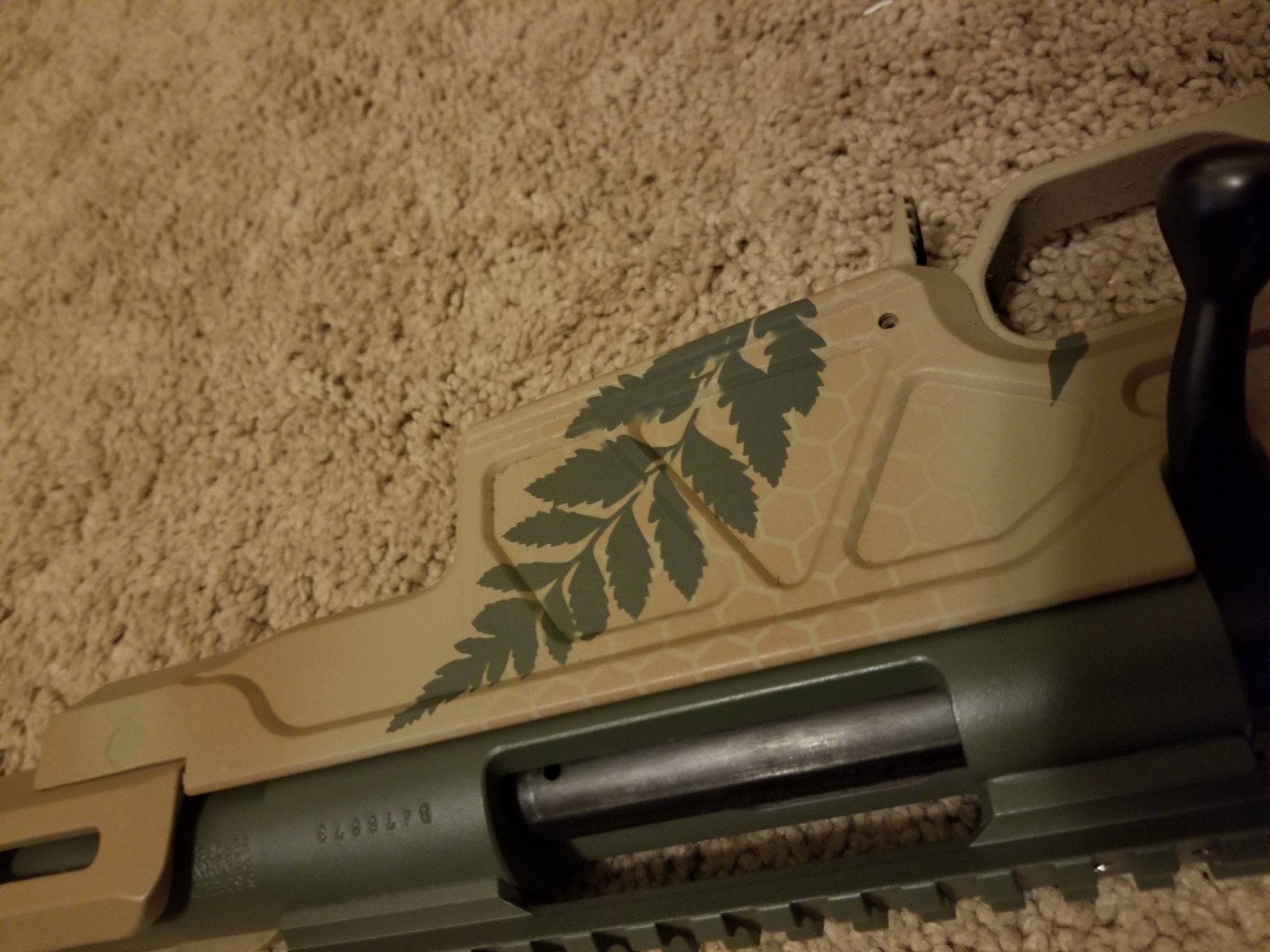

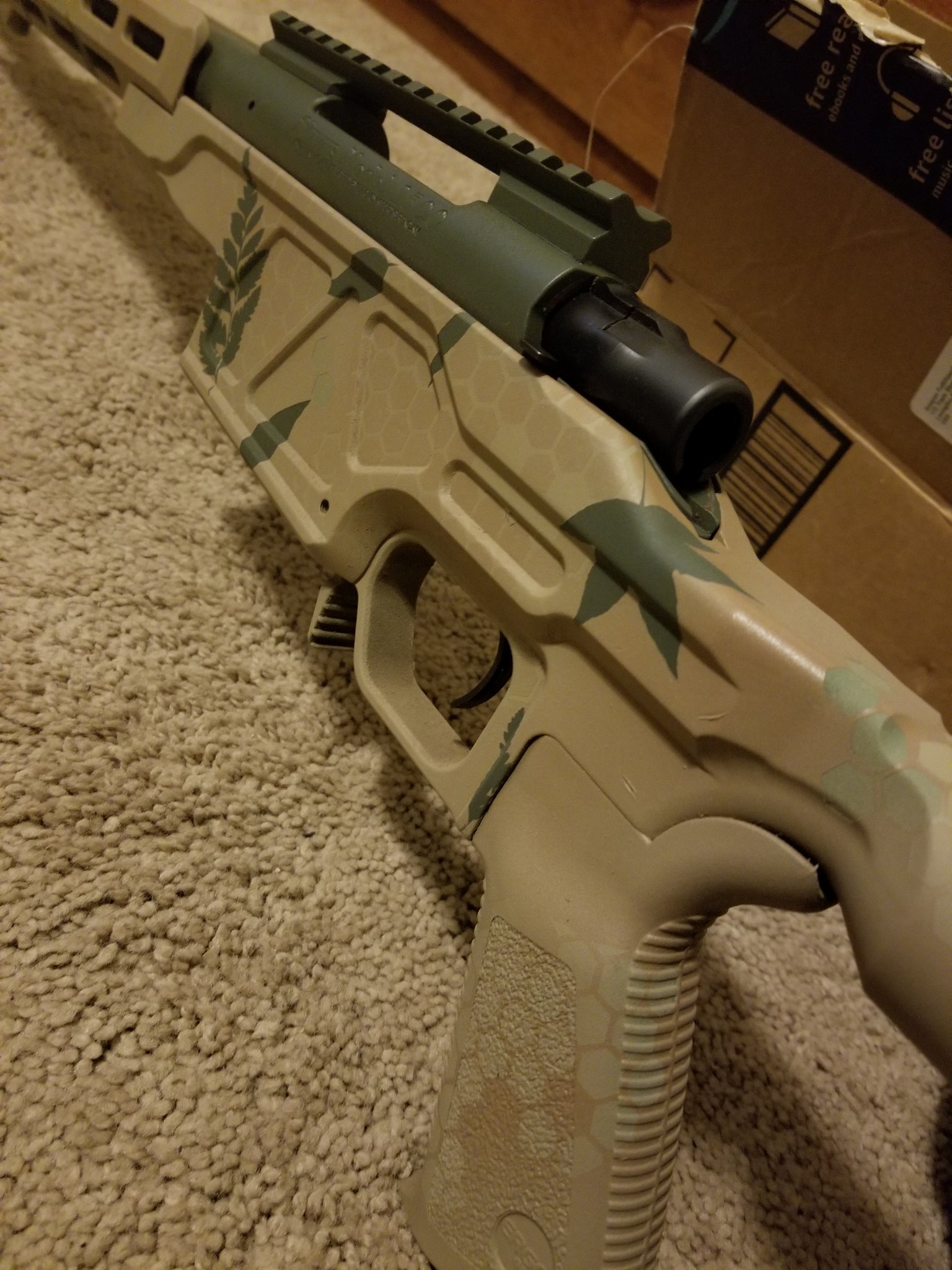

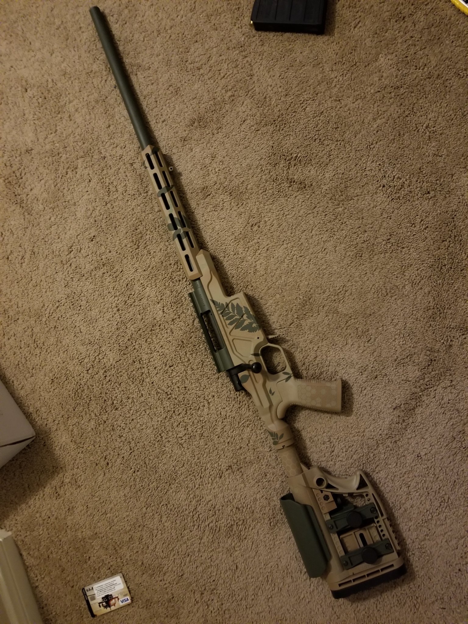

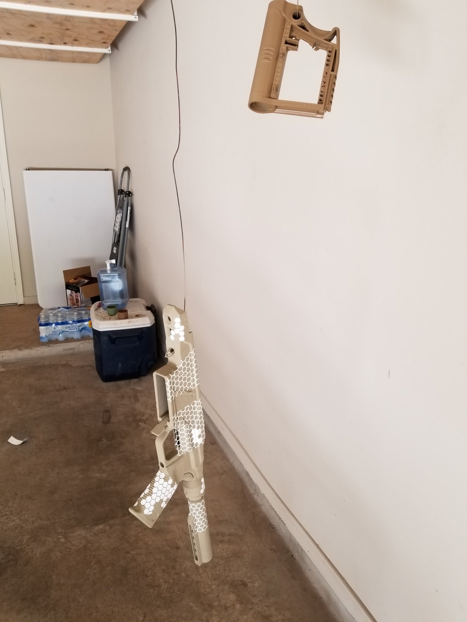

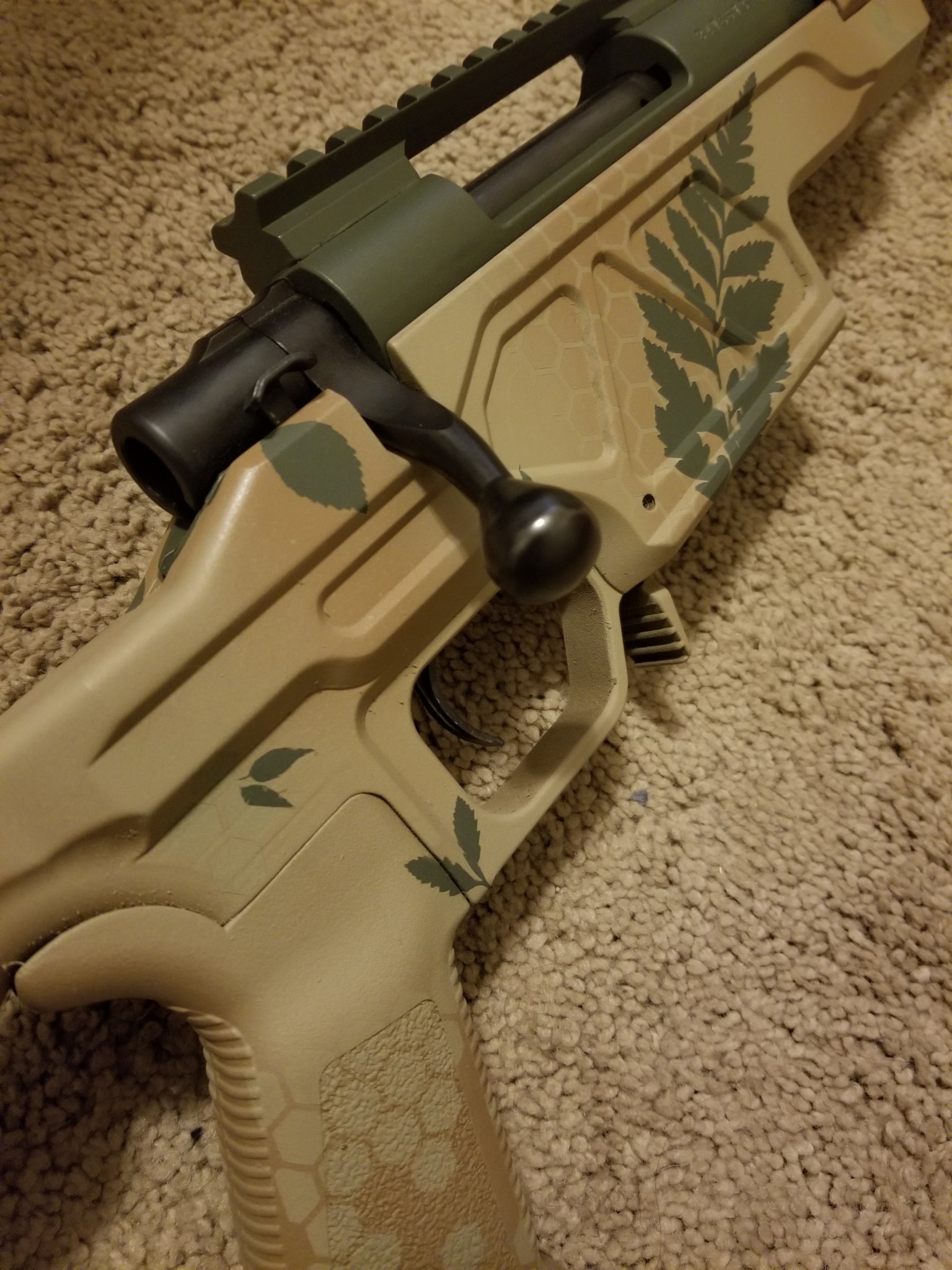

I am extremely proud of my rattle can job.
Obviously, there's parts or areas that did not come out perfect. But for a 25dlr paint job, I am very proud of having it turn out as it did lol!
I have the buttstock painted as well but will assemble and post pics of that tomorrow!

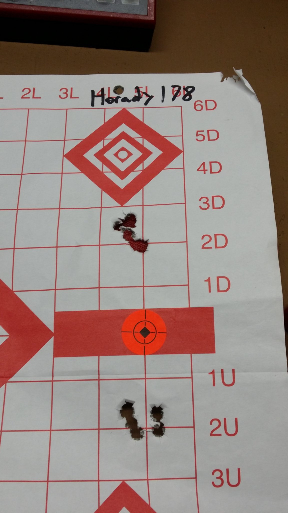

Bedding is drying tonight. We shall see in the next couple days. Shot this with 168 gmm today. Thats 5 the shot high left is another group different ammo. I was shooting all kinds of stuff today for practice and to get some brass.

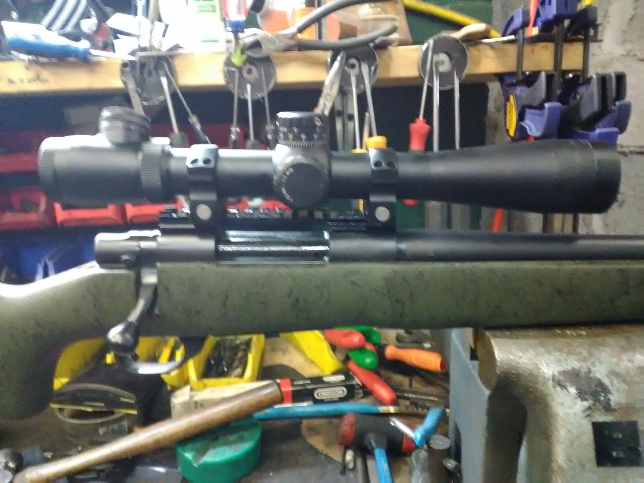

I just got everything together on Friday and havent been able to shoot it yet but the SWFA is a great budget scope with clear glass and good clicks. This is the mil-mil model and I got it used with a set of SWFA rings for $240 shipped so I am pretty happy.
Its the pro varmint. The cheek piece is just a piece of aluminum that I bent to fit. I'm getting ready to do some load development and I'll post some pics

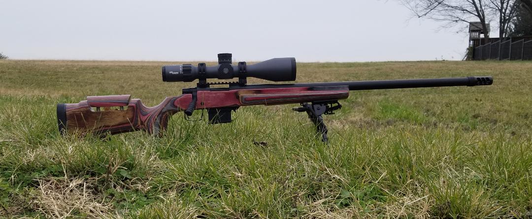

Dunno if this one really counts since it's a mini action, but here it is, anyhow:
Howa mini action chambered in .223 AI
7-twist, 26" K&P heavy palma barrel recontoured at breach to match action (5/8-24 muzzle threads)
barreled action cerakoted in graphite black
bolt handle threading by local 'smith (Penty Wheeler in Royse City, TX)
Glades Armory bolt knob
Boyd's pro varmint stock in royal jacaranda w/ adjustable comb and Limbsaver buttpad (to tame the massive recoil ;-) )
DIP bottom metal
Rifle Basix WTHBY-V trigger
Warne 0 MOA rail
Area 419 30-caliber Hellfire brake
ARC medium height 34mm rings
Sig Tango6 5-30 x 56 w/ DEV-L MRAD
Barreled action work performed by LRI
Primary use will be as a bench-rested prairie dog rig shooting 50-60 grain projectiles, but I also plan to load up some heavier (80+ gr) projectiles (which I fully expect will need to be single-fed) for long range plinking.
