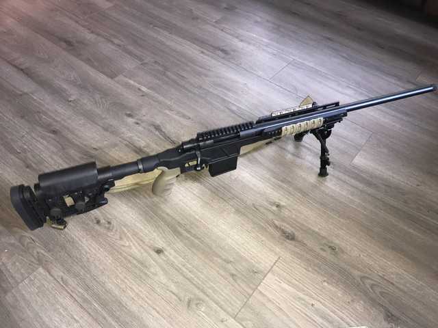

    I just bought a Howa HCR for $867 at Bud's guns. I just picked it up Friday, and am really impressed with it so far. I really like the chassis and the 2 stage trigger.

    The Howa HCR chassis is a pretty good design. It has a useful barricade stop built in to the front of the mag well. Frank is finishing up his review of the Howaz HCR, so maybe wait until that comes out to make you're decision.

    I had my Howa HCR out today breaking in the barrel. Only ran 20 rounds thru it, but I think it’s going to be a shooter. I plan I running mine in local and regional PRS type comps next year. FYI Hornady factory 140 ELD-M was running 2660 FPS with only 20rds thru it.
    oh I forgot to add we borescoped it last night and the barrel looked really good. The gunsmith was pretty impressed.

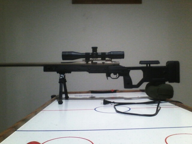

    I bought a howa HCR few months back as an upgrade from my savage. I haven't shot it yet but as far as quality goes it's amazing. Bolt manipulation is spot on and smooth. No complaints minus the buttstock has no recoil pad. I remedied that with a large limbsaver pad, drilled one hole so they would line up with the luth ar buttstock. The HCR is a Big Bang for your buck, I purchased my .308 for $1050. The features this rifle has for the money is amazing. Accurate chassis and mag, adjustable length of pull and cheek comb height. Few more days and mine will be wearing a vortex razor gen 2.
