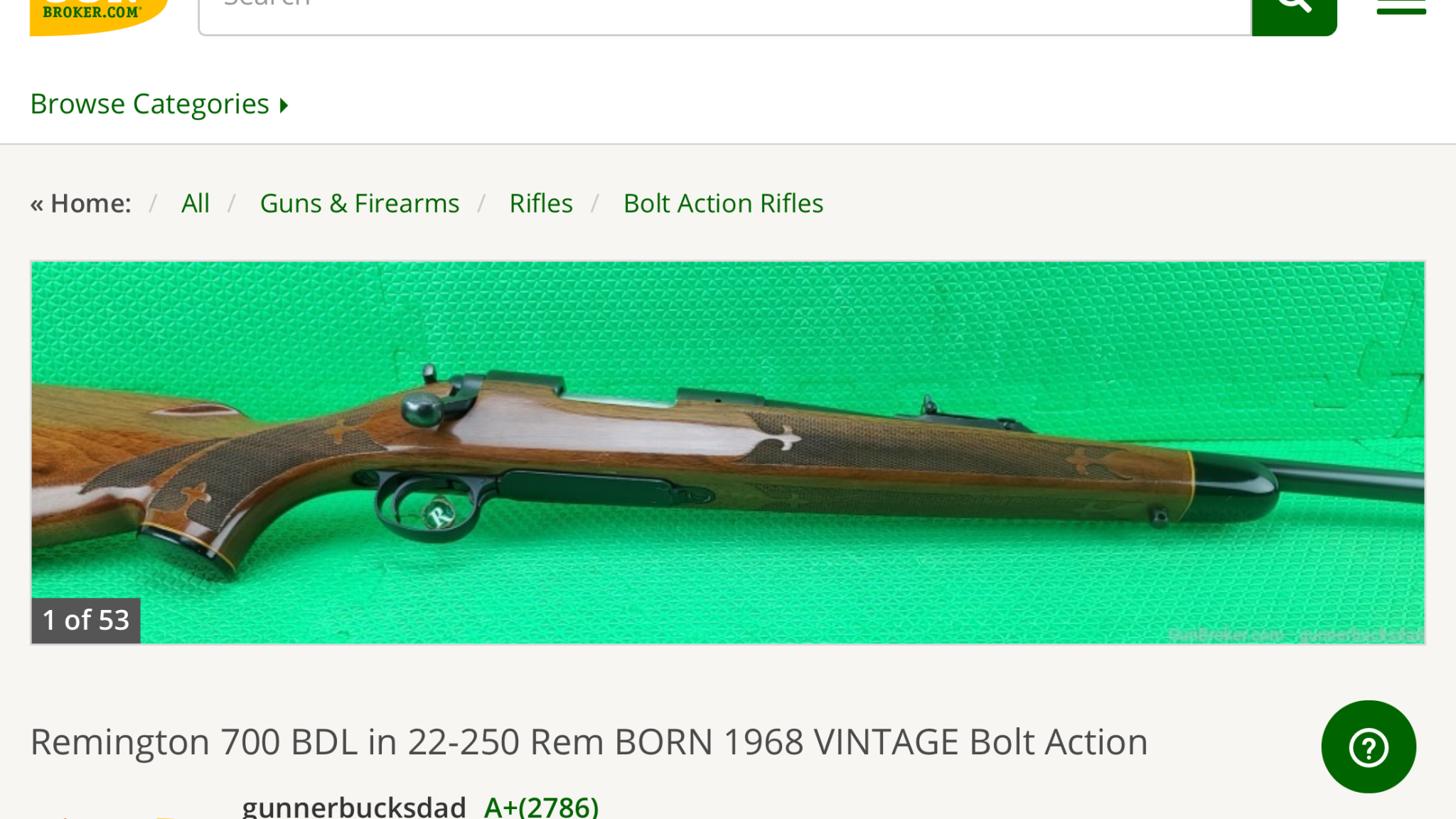

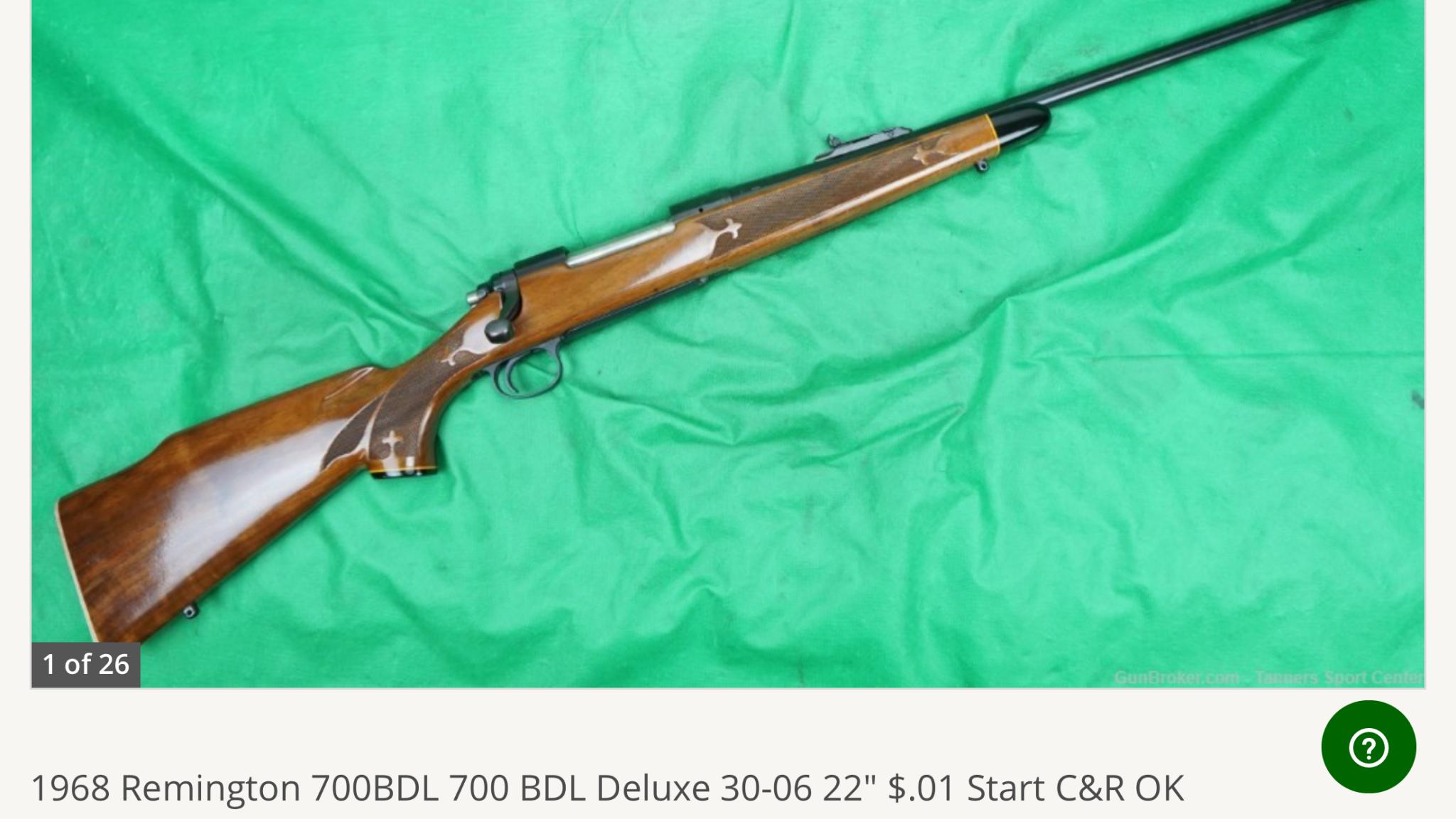

Here’s pics of a couple of examples I just grabbed off gunbroker of the sort of guns that come to mind when I think about Remington 700s. Both rifles are over 50 years old. Man if those aren’t beautiful rifles I don’t know what is. Remington was a giant and made some the nicest firearms ever made. Remington is the reason shooting was so inexpensive and now that they’re gone the others don’t have to compete against their low prices. The days of cheap ammo and cheap equipment are gone and will probably never return. Before these shortages are over we’re all gonna miss Remington.
Go pick up a 60 year old Model 70, hell or even one ten years old........
