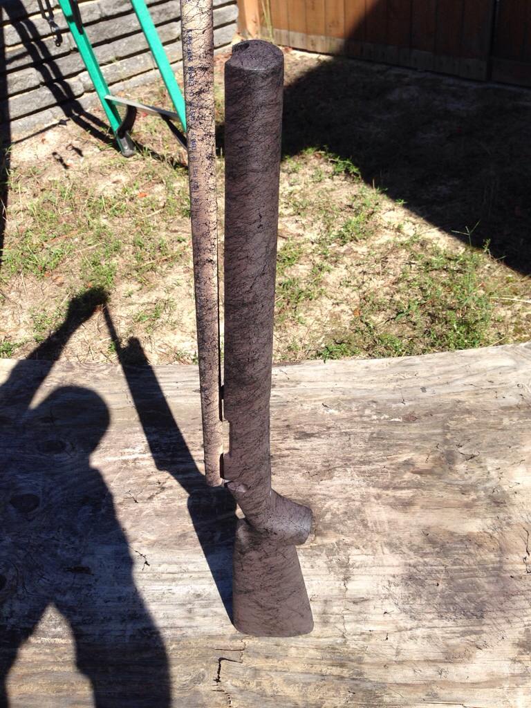

Just an update. I was able to open the barrel channel up for the MTU barrel with no problem after chipping out the bedding someone prior to me had done down the entire length of the stock. The lug cavity was also large enough to hold the oversized lug after digging the bedding compound out. I filled in a couple chips with JB Weld. I added some grip with some paint on bedliner at the grip and front hand position. This stuff gives it enough texture so that it isnt smooth, but you can only see it in the finish if you are looking for it. Then I duracoated the entire thing Woodlands Tac brown(OAF baby!) and sprayed it with black webbing. After that cured for a day I clear coated it with duracoat. A word of warning, If you put too much clear duracoat on it will make the webbing run a bit. This happened in two small spots.
Over all I am tickled with how it turned out.
Ryan
This the stock in progress. I will post pics of the finished gun when the front rail gets here.
