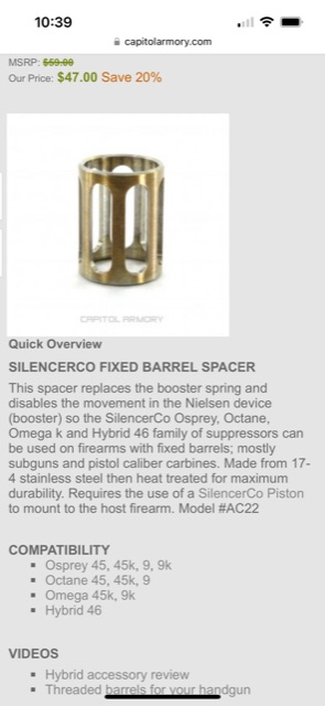

You need a lockout spacer. You'll never buy one in the F4 world, because "you can't add material".
But the solution that's out there, is a spacer that replaces the booster. In the F1 world, we have "ASR tubes", where the first 1", 1.5", or 2", is a built in spacer of sorts. Just unthread the booster, and replace with a DT mount. The shelf keeps the guts in the tube. I'm unaware of F4 manufacturers that make tubes this way.
Putting a booster equipped can on a fixed barrel weapon, is begging to hurt someone or something.
Can you define this “lockout spacer” a bit more? Mounts and adapters (including Nielsen devices) are not restricted and you can buy them and change them around at will. A fixed barrel adapter replaces the spring in the booster and makes the suppressor able to be fired on a fixed barrel gun. I pulled this off the web as an example of a commercial option.
The downside is that it doesn’t make use across multiple platforms easier than changing out the HUB adapter, as you must remove the booster to replace the spring. In the OP’s use case, he might as well just replace the booster with a more appropriate adapter.
For my part, I do not thread lock adapters to cans. I apply a light coat of lube so that they, eventually, can be “easily” disassembled. I’ve never had a can try to disassemble itself while in use doing this.

Obligatory IANAL: it would appear to me that replacing the booster spring would be ok.
Taking out the booster/LID/Neilson, and replacing it with a standard blast chamber spacer, and regular DT type end cap, would more than likely be a no-go; due to having the blast chamber spacer loose/extra when the booster is in use.
Easy button appears to be the product you linked
