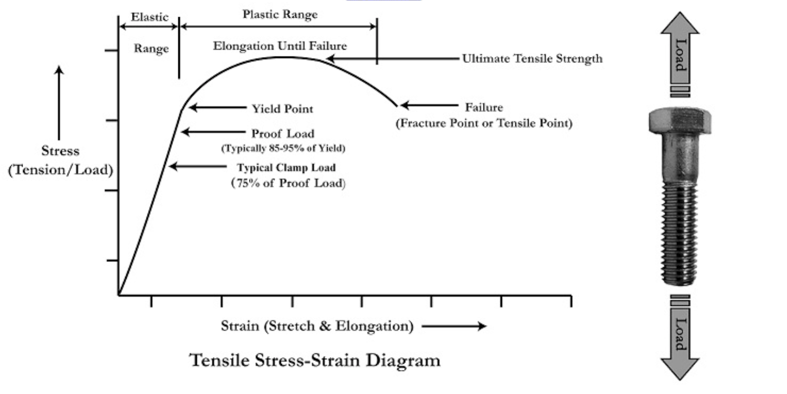

Muzzle device torque on the barrel threads can constrict the bore at the muzzle. How much constriction would depend on the torque value and the size of the threads in relation to the bore.
That posted video goes a long way to validating @msgriff statement. He called it "trumpeting" (@ 4:40).
I don't know how much torque was being applied to the muzzle device while he was using the crescent wrench. I'm guessing 20 ftlbs thereabouts as he finished his last go? Not alot anyway, thats my point.
He described the amount of loctite he used as "generous". His use describes his view of a "generous" amount.

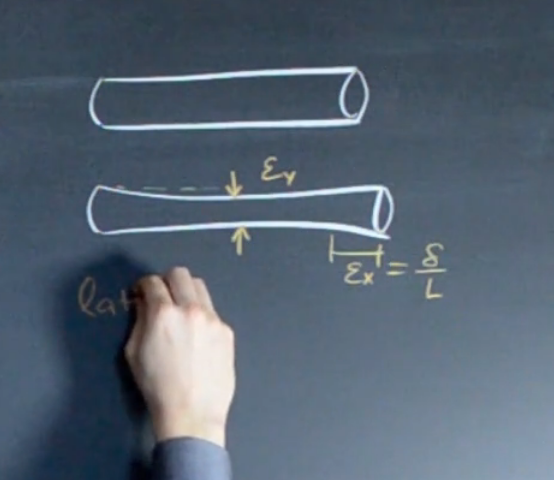

Note that elongation typically results in 'transverse compression', which is a reduction in diameter.
See, eg diagram below...
source, is circa 22 min>
Look at the diagrams above and see where the “tightening” or “trumpeting” is in relation to the muzzle.
You want the muzzle to be perfect on caliber with the preceding bore, or tighter. If it trumpets, the muzzle is looser, relatively. Not good.
But you do you
