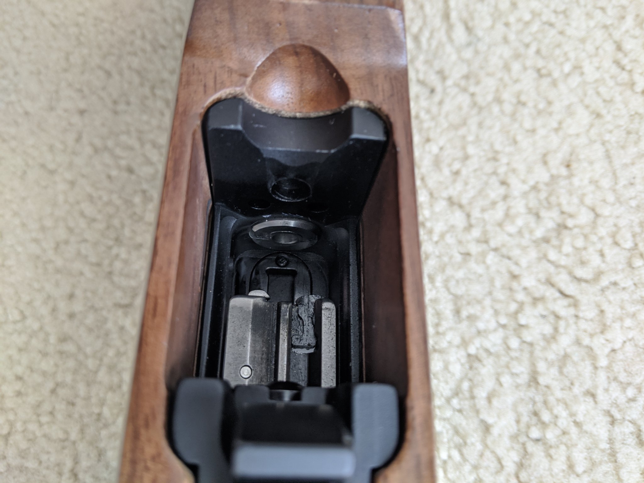

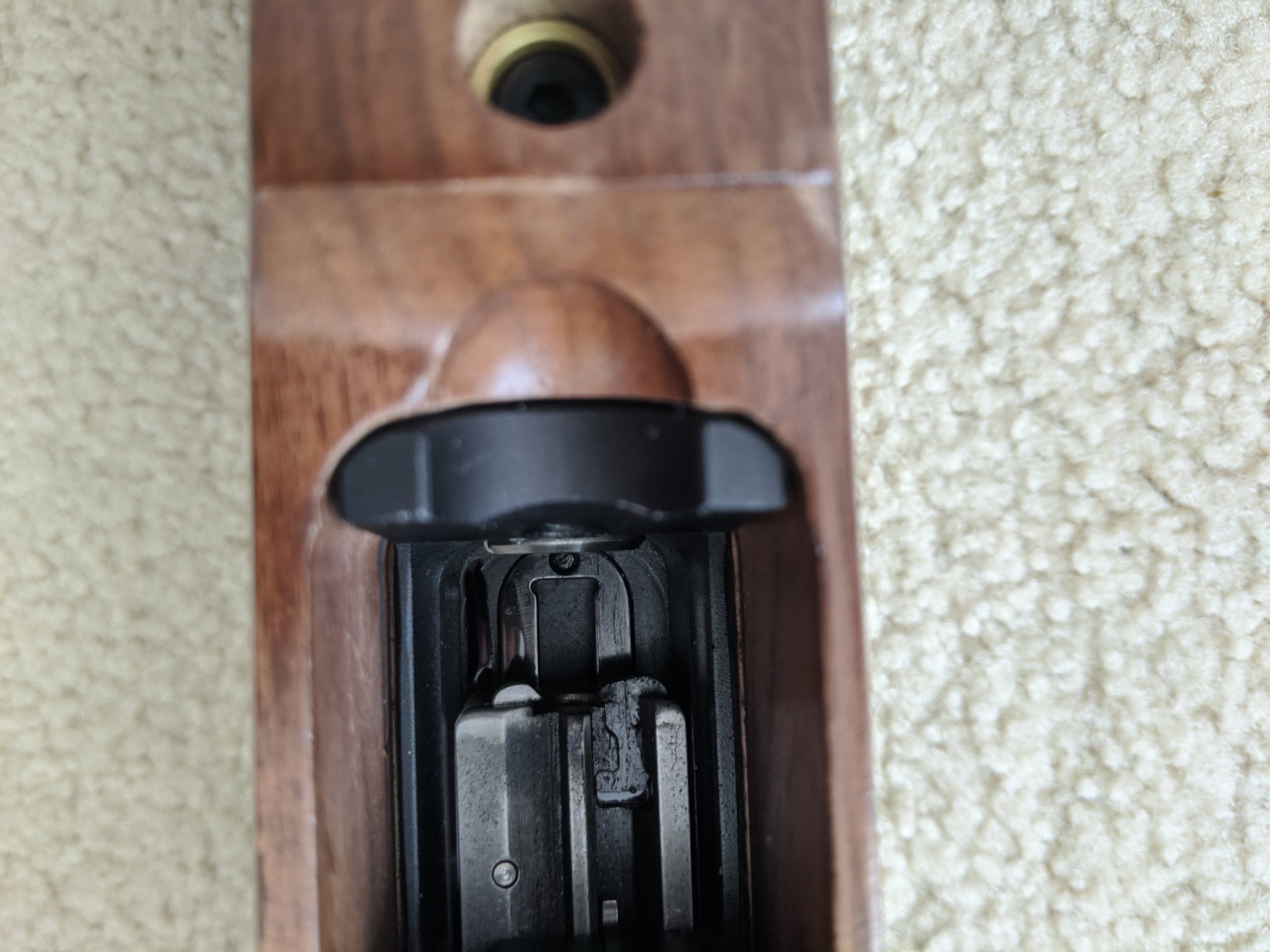

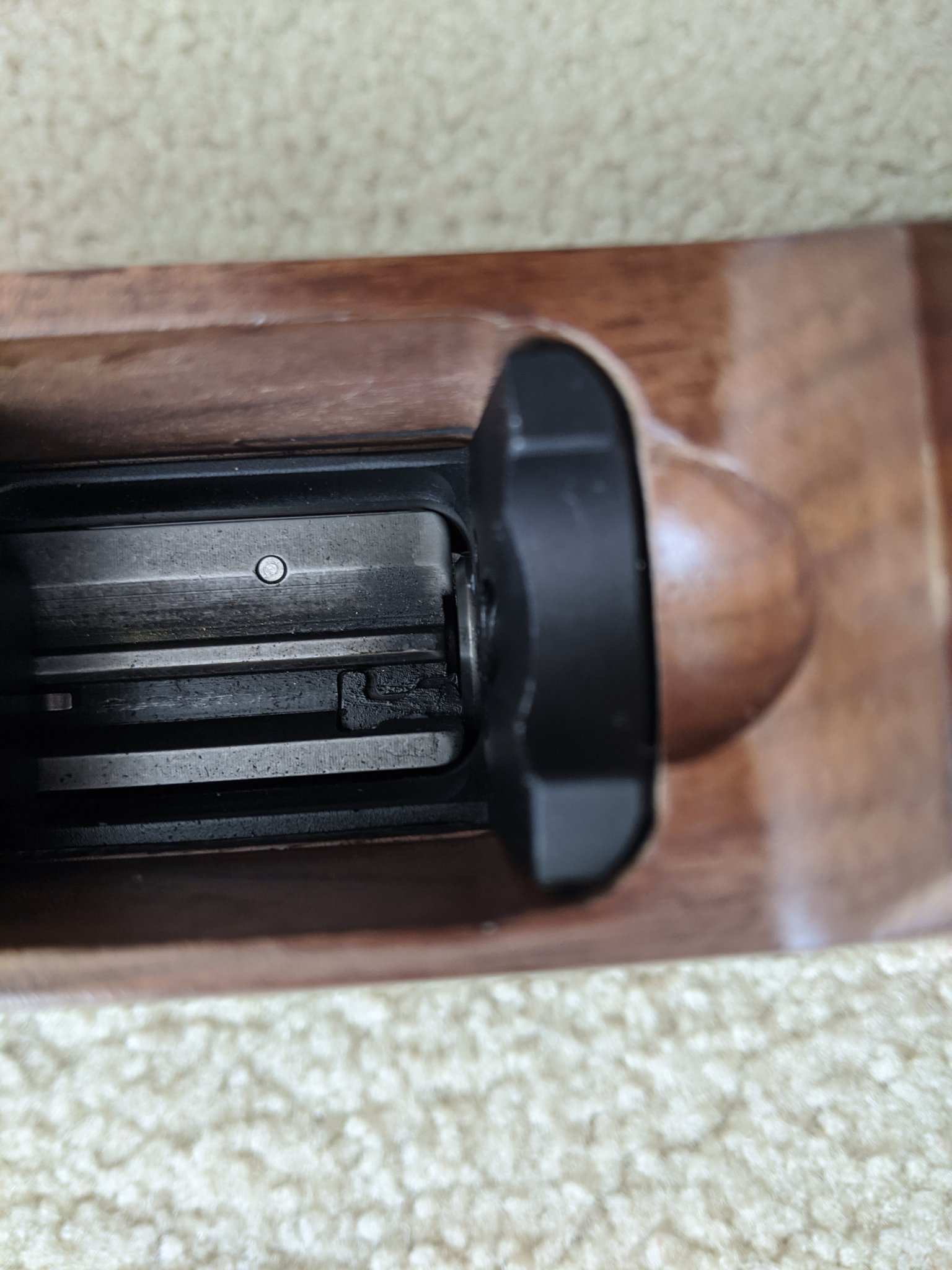

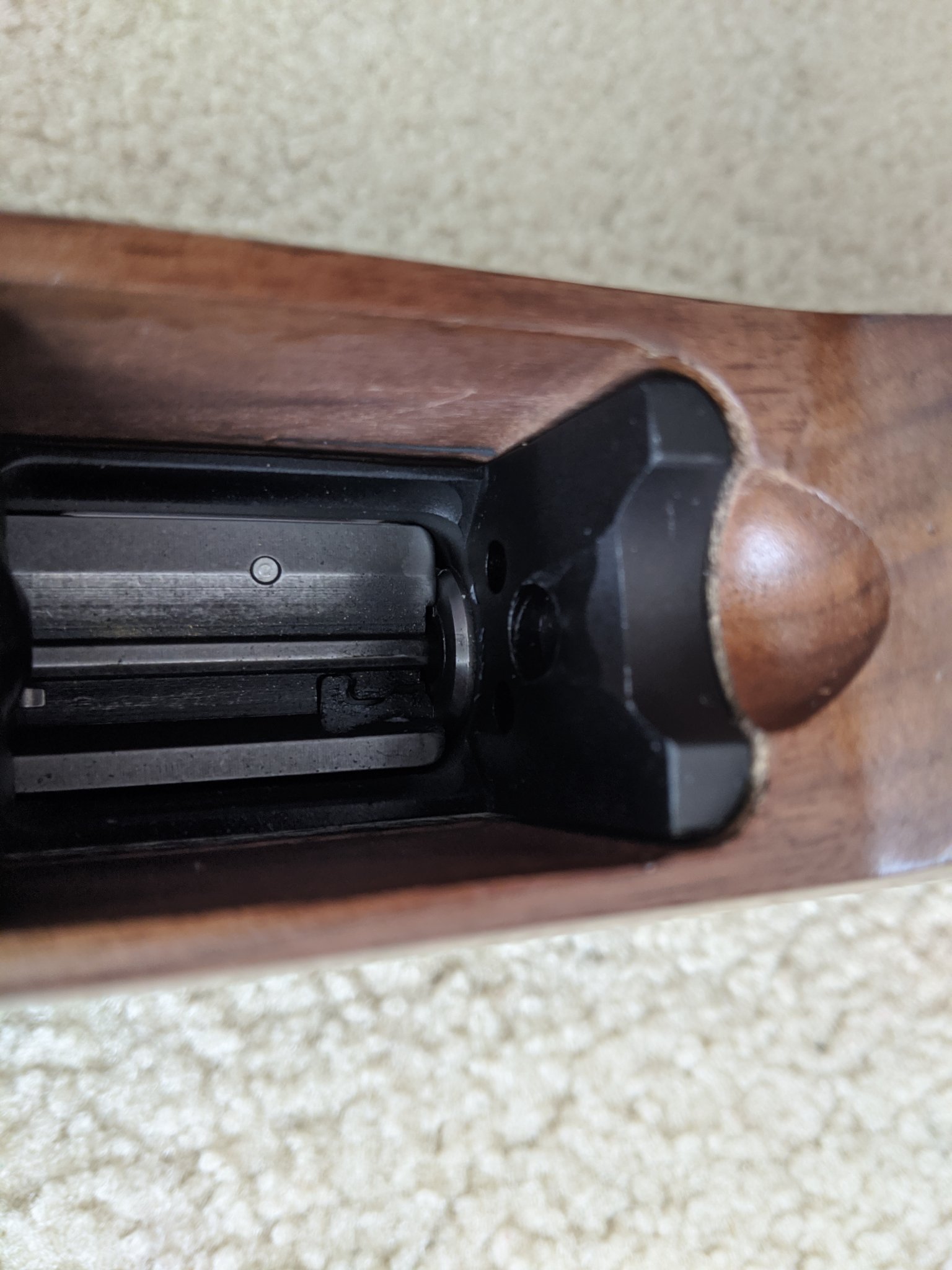

Might the headspace be off? Here are several pictures looking up the magwell. I took the picture from an angle so you could see the barrel sticking into the receiver and another dead on from the top to see the protrusion. It's with and without the bolt closed. Not sure if any of that looks off to you.
I have go and no go gauges. I'm familiar with how to use them on an AR, but not with this. Any tips there would be appreciated too.

Have you contacted Volquartsen ? If everything checks out on your end I would give them a call. P S I had a pic base come loose one time opened the groups up to 2 inches at 50 yards, but not keyholing, the point is I believe your barrel is probably the culprit.The key holing is a by product of stability, if your bullet is not being stabilized by the barrel it will do funny things.Hope this helps where are you located and do you have a borescope?
