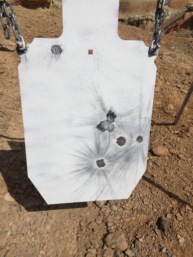

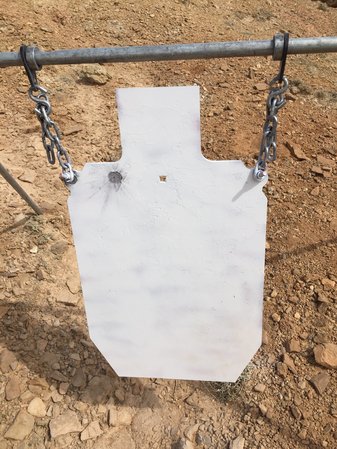

    We have enjoyed 20-30mph wind for almost 2 weeks. I did shoot a bit in it out to 1100 and did well. Today the winds were much more moderate 5-10mph, but squirrelly from all directions.
    So, I took my AXMC in 300N out (230 OTM @ 2905) and setup my full size IPSC silhouette @ 1930 and sent one. Hmm, impact a bit to the right, elevation looked good. Wind picks up a bit, sent another...left splash in the dirt. Ok, come on bud, really concentrating on all my basics, prone rear bag shooting position. Sent another in what appeared to be similar wind...didn't see dirt splash, so am hopeful. Tripped a couple more. Anyhow, 1 for 8...I could really see the difference between almost 2k and 1k.
    Wind and fundamentals, both of which I need work.
    Second picture 4 /6 when I moved up 1188. I needed a little hope!
