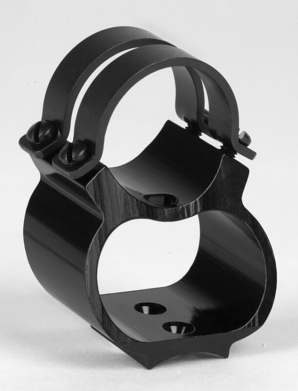

Go Talley direct mounts for the rings. Absolutely do NOT go for rings that let you see your irons through the bottom of the rings. You’re compromising the ability to see through the scope with a good cheek weld, and gaining nothing.

I would argue the rings will matter most in this situation, so go Talley Direct like @gnochi recommended.

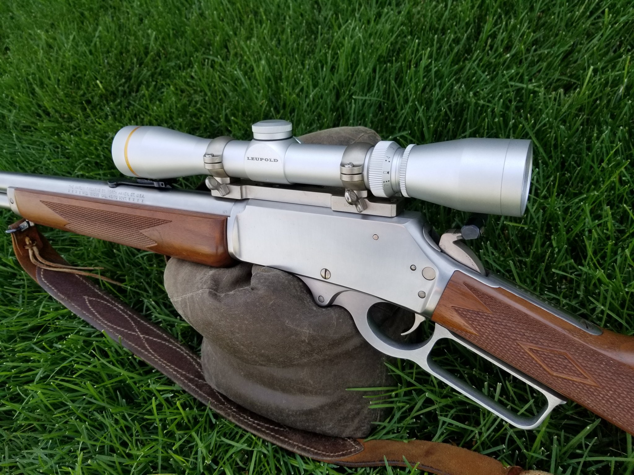

Best of both worlds.. Leupold QD mount if you want to run open sights.
Leupold 2-7x33 is a nice fit for this rifle.
I went with the Leupold VX-1 2-7x 33. Compact, super lightweight and easy on the pocket. I used the XS Rail Ghost Ring Sight Set as the base, which also gave me better sights.
After doing all of that, I'm thinking of pulling it all out and returning to the original, clean classic look. And I'm happy for it to just be a 100 yard gun. As it stands now, the charm and nostalgia of the compact lever action are just not there with all the modern stuff on it.
Not trying to give you a hard time on this, but I just want to make sure no one runs out there to buy one based on the wrong impression. The QD part of this Leupold mount is the scope, not the base. So when you remove it, your iron sights are still blocked. Leupold touts it as a way to quickly swap scopes or remove one to clean the gun.
I can still see/ use the sight when scope is removed.
