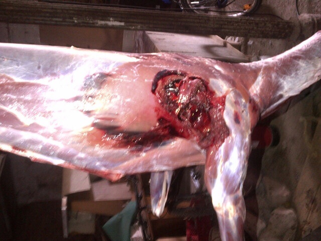

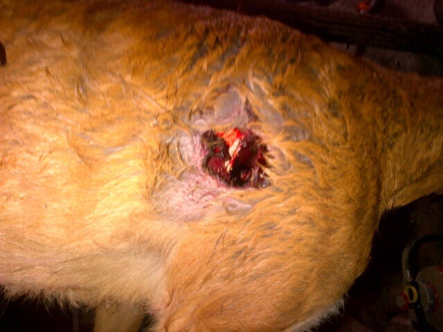

This week shot 2 roe bucks with the 208 amax out of the 308w, one broadside shot and one neckshot. Although still heavy exitwounds, and destroying some of the meat, at least both bucks dropped dead in their tracks, did not even get a chance to move one step further, both died where they stood on the spot.

Amax's are great for hunting, they do upset quite a bit. Which is why, when I have an option, I put it in the neck, or other nerve target. When shooting at heart and lungs, I try and miss the shoulder itself for the very reason you describe. But this meat damage is not caused by the amax alone.
It looks like you have a good thing going, keep it that way.
