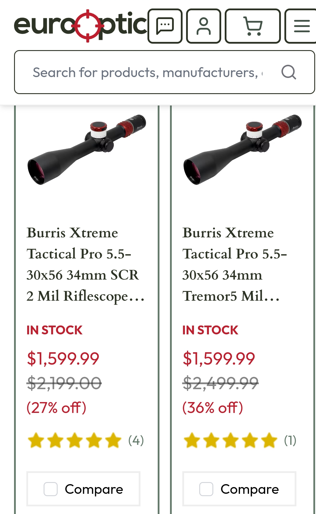

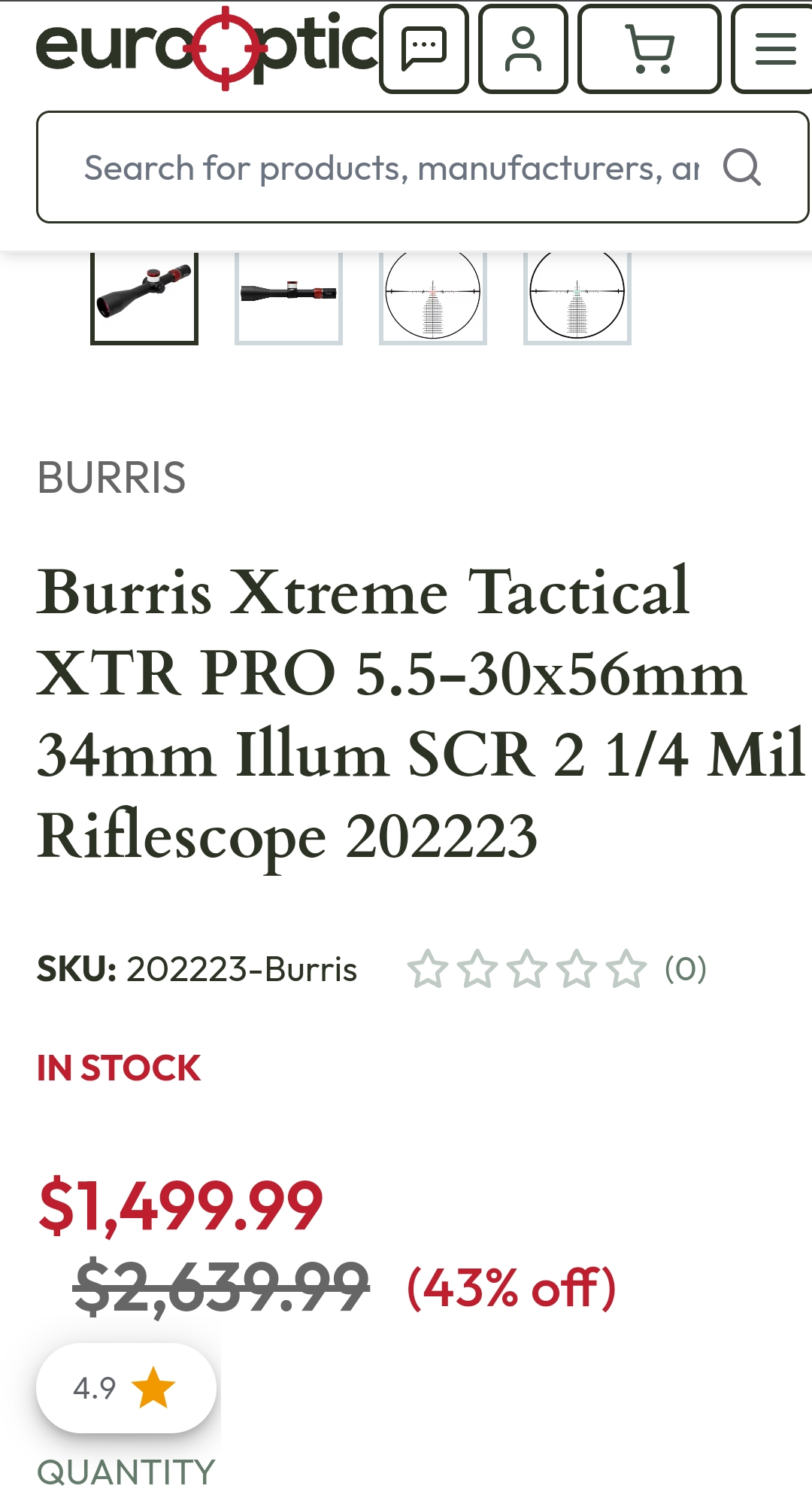

Easy button and hard to beat price-wise would be a Burris XTR Pro FFP 5.5-30x56 from Eurooptic or eBay at around $1500:

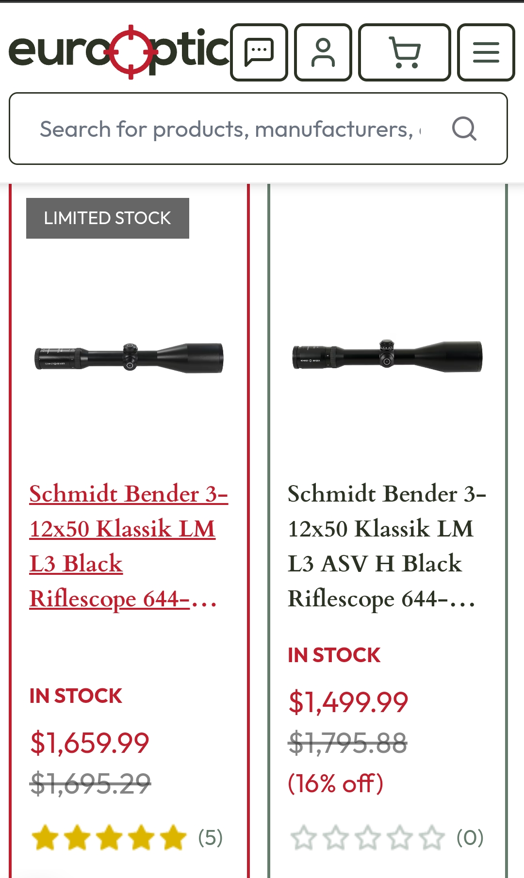

However, you said you want less than 5 on the low end, preferably. So, I use a Schmidt & Bender 3-12×50 FFP Klassik series. You can get them for a grand on sale or used from Eurooptic/Scopelist or people selling them here or on eBay from Europe. Has capped turrets but you can buy a dialable elevation turret direct from S&B and have Jerry Ricker at S&B USA in Virginia put it on for you like I did. Comes with an illuminated L3 reticle that works great for MPBR in wooded areas but you can upgrade to a P4FL reticle if you do not like simple dot reticles. Comes with a 30mm tube with easy to use rings you probably already have laying around.
See this SH post thread for more info and proof they sell for under a $1000 used and read the Eurooptic link review, which is a bit dated for a similar discontinued model, to give you an idea on elevation turret range spreads. Hard to beat for the money.

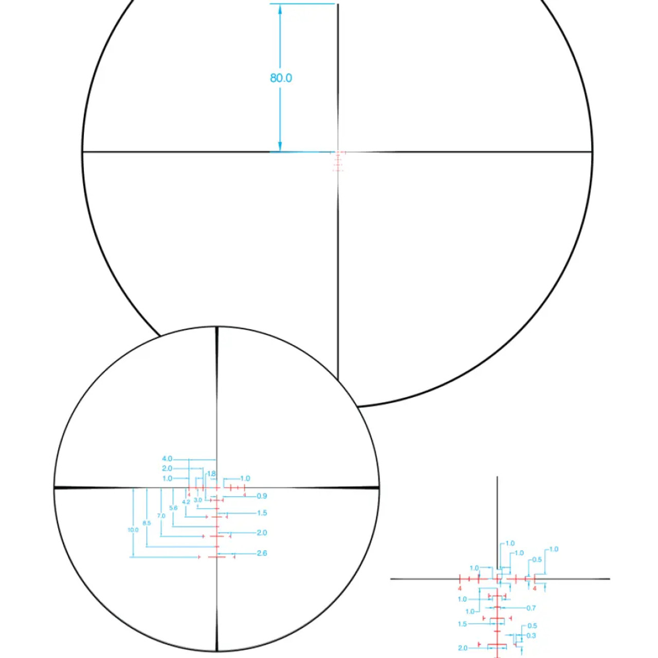

Downsides: no locking elevation, but the turret is low profile. The more usable reticle across the mag range is the MOA/BDC one. But if you’re okay with MOA, it’s a nice reticle.
They also offer a 3-18 version, and with that one, the mil reticle MAY be usable at 3 or 4x, but I’m not sure.
MOA/hunting reticle:

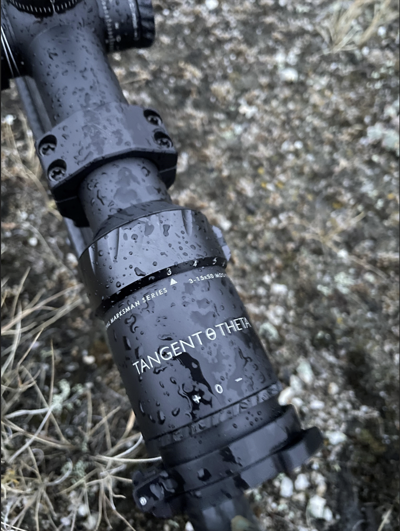

I currently have the TT315M, ZCO420, and ATACR 4-16x42. I agree that the ATACR, particularly on the used market, is a good option, but I would disagree with the notion that the ATACR is more durable than the Tangent and/or ZCO (maybe that's not what you were implying?).
Anecdotally from my small sample size, I'd say that I consistently shoot smaller groups with the Tangent (which has a thicker reticle), POA/POI for 10-shot groups seems more consistent than the ATACR (same rifle, same ammo), and the Tangent has held zero for hundreds/thousands of miles riding on the floorboard of my truck on two-tracks & washboard roads as well as typical small falls that happen during hunting as well as the bumps & knocks that happen during a match. Also, tracking has been more precise in my Tangent and the reticle is closer in line with the tracking path compared to the ATACR. My ATACRs have all been useable, and I'm not saying they are bad, just trying to clarify.
The ATACR has a lot of things to like, but for me, the Tangent is better is every category - particularly for a hunting specific scope. For a general use scope, I'd take the ZCO over the Tangent & the ATACR.
