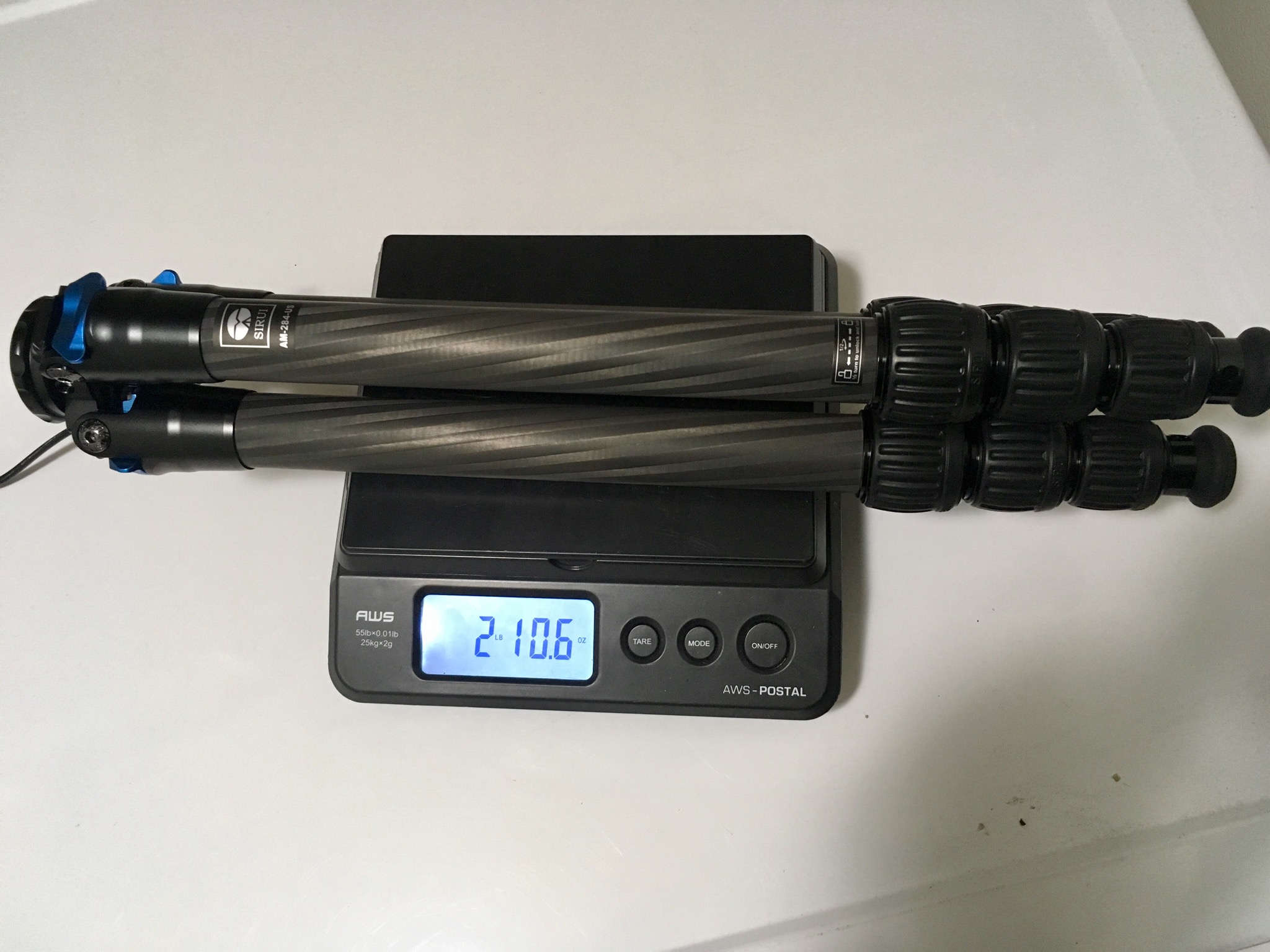

I had previously used an 0311 with TA-U-LC
It was heavy at 6.8# and I wasnt real comfortable making standing shots on game with it.

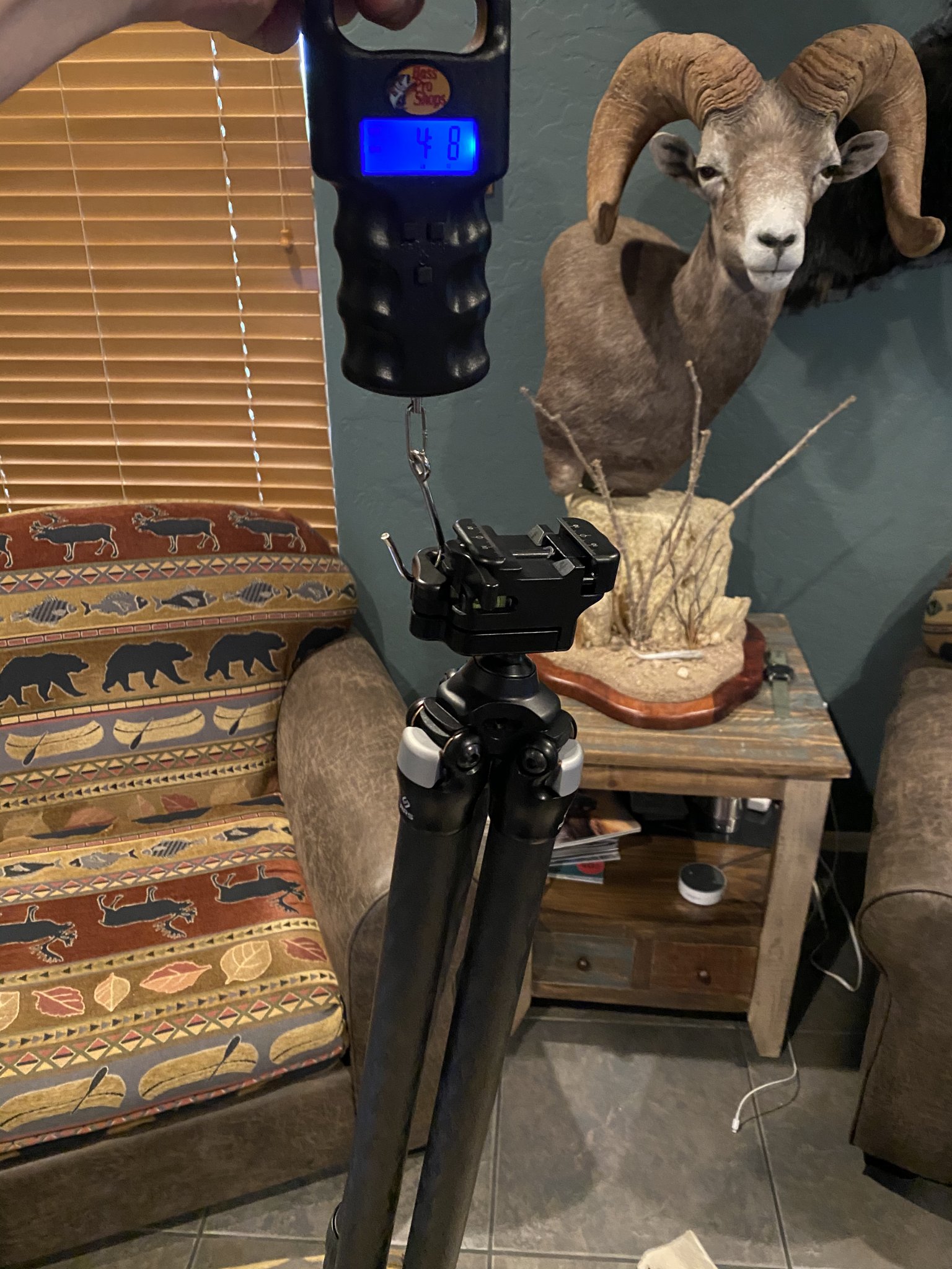

I recently upgraded to a TFCT-34L and it comes in at 5.25# on my luggage scale and 5.15# on my kitchen scale.
I am a hiker. I dont have a quad and hunt public land. This generally means my elk hunts are 4-8 days and have me moving several miles a day trying to get away from bubba and friends that spend elk camp getting turnt till the wee hours then waiting till daybreak to go 30mph on their UTV... I digress.
I am looking forward to the new setup this year. Night and day difference in stability. Plenty of height for higher angle shots (I was limited with the leveling base and had to do a bit more thinking and spend some more time for building positions).
10/10 I would go with the 34L again.

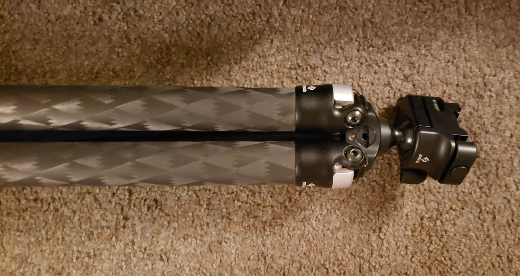

The twist locks on the legs are just a smidge larger than the TFCT apex.
This was one of the things that factored into my pack ability decisions. The stability gained and height advantage for standing and spotting/high angle capability vs the half pound or so saved with the 24L factored for me.

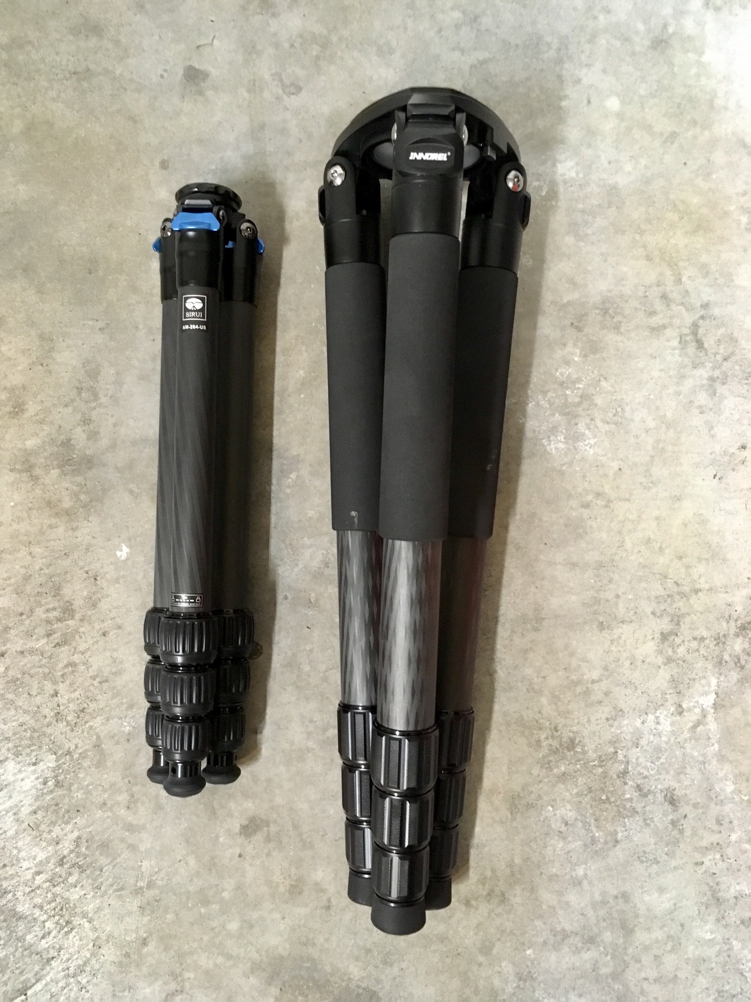

So I grabbed a Sirui AM-284 to try out and it’s much lighter but less robust than the -90. 30 lb rating and my heaviest rifle my SRS is 16.6 lbs Next time I go shoot I’ll bring it along to see how it is.

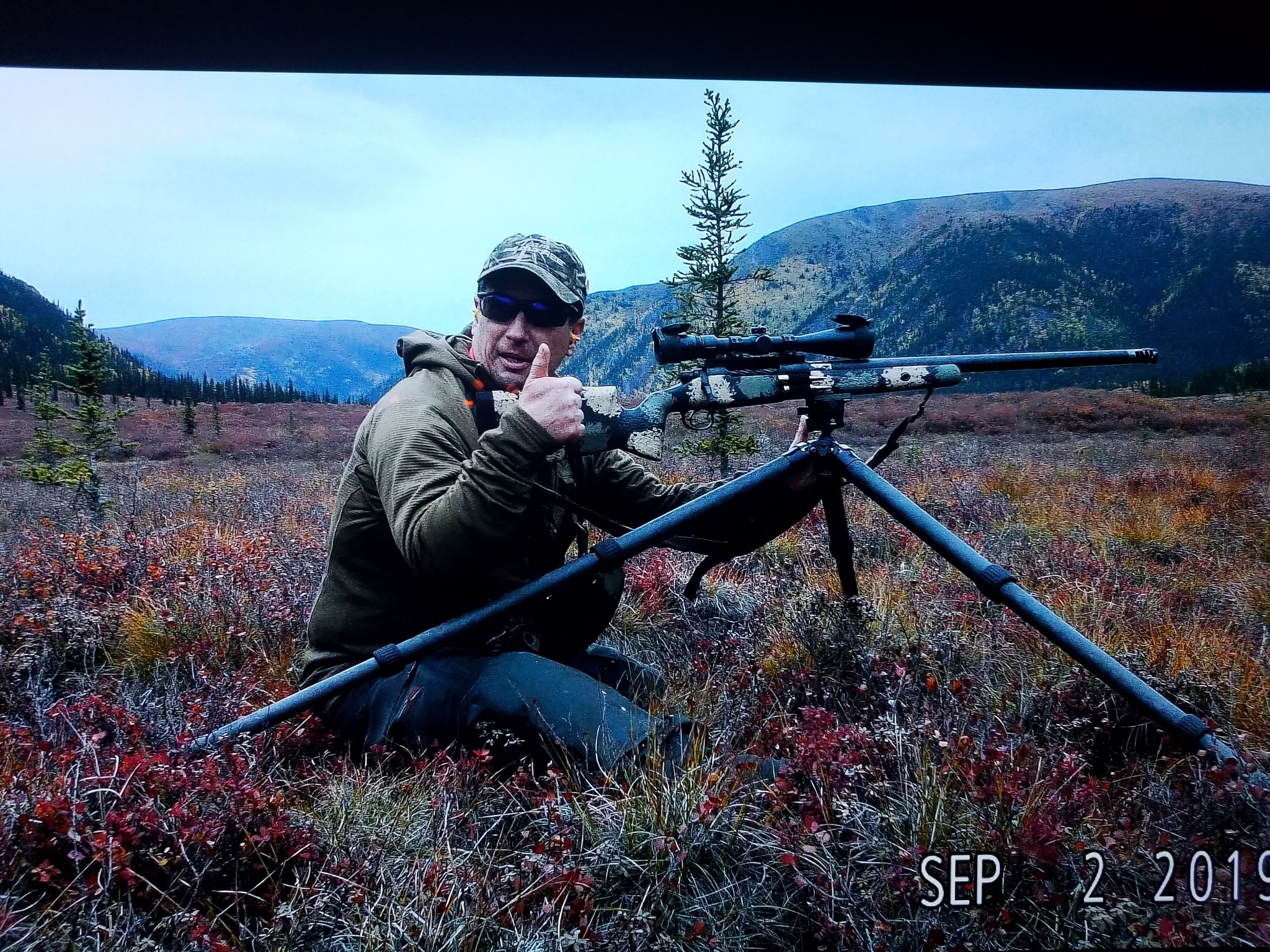

We hunt in the mountains for goats on the island every year. Got tired of using a sirui tripod for standing shots on inclines like this. Aftwr hiking for 2hrs in 85 degree weather with no shade, i was willing to invest in something that would be rock solid. Legit with my TL3 at 9lbs on this TL24 RRS with anvil 30 head, my zco reticle looks like im shooting off a bench at 200-300 yards while standing. Havent found a better investment IMHO.

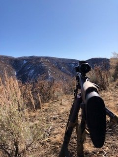

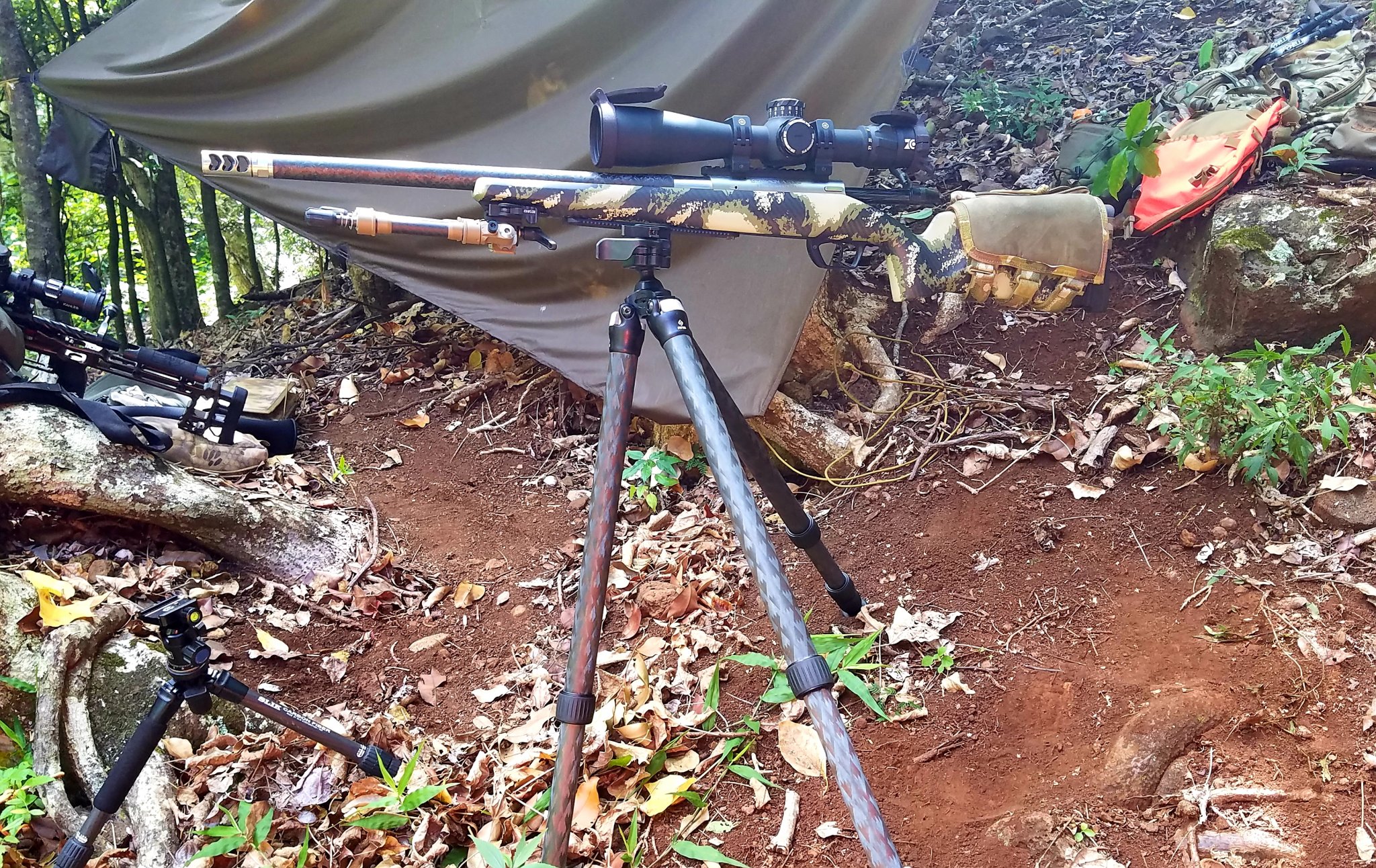

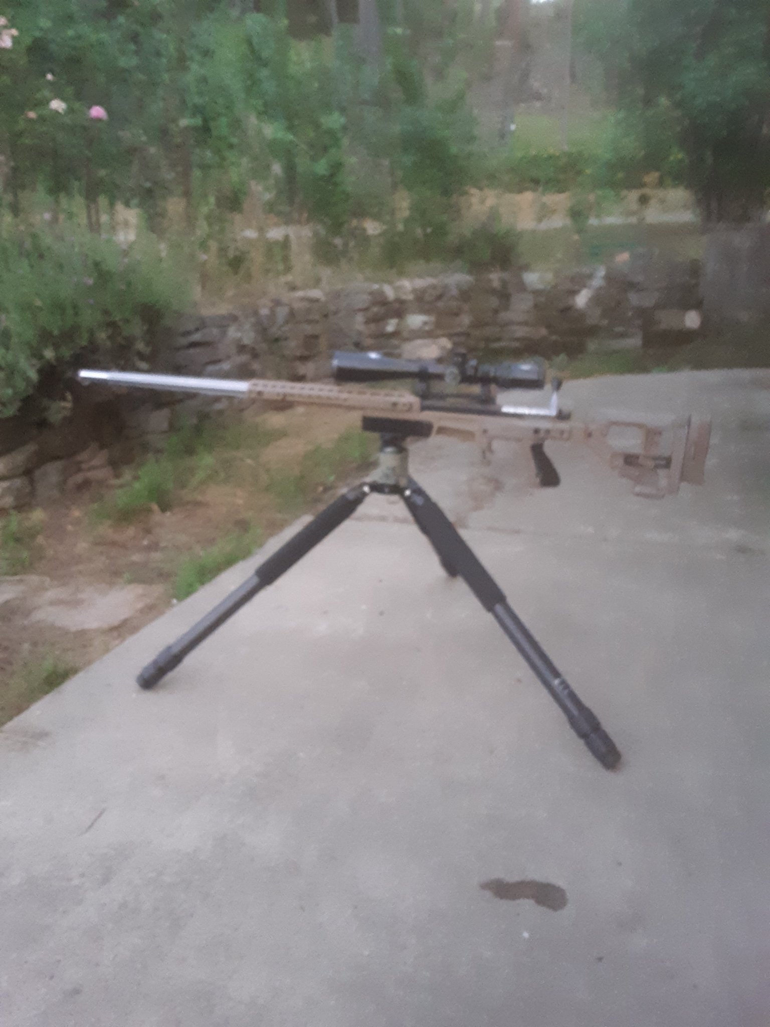

Feisol ct-3372 with the rrs ta3
I packed up at 10,000 elevation on my pack.not to bad to carry,really stable .pic is my match rifle, but you get the idea.
Reactions: Diver160651

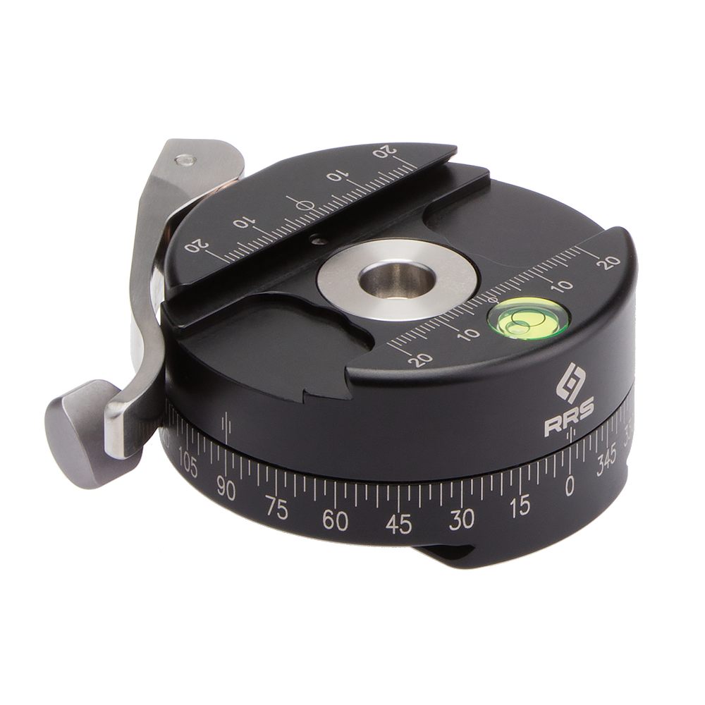

Right now I have a lephoto 284C with RRS universal leveling base I use and have absolutely no complaints. It’s plenty light and comfortable to jump around on my pack. We’re in the middle of moving right now so I can’t weight it but I honestly can’t imagine justifying spending the extra mountain of money to have the RRS tripod. They make the finest products for this use but I have plenty of things I could spend the left over money on
Has anyone had a chance to compare the RRS Anvil-30 ballhead to the RRS TA-2U levling base? I have looked at both and the leveling base seems like it would lock up stronger but was wondering if anyone had real world experience.
Reactions: JAA485

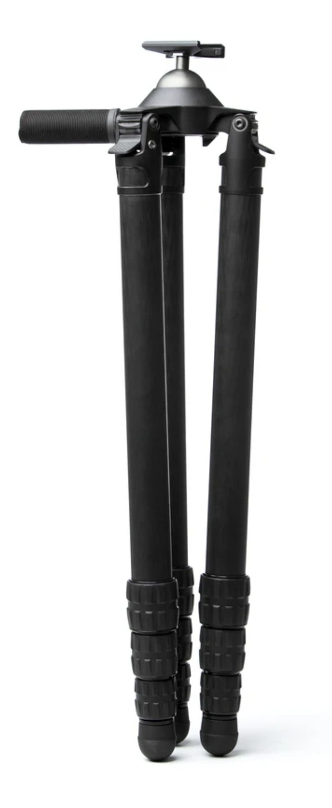

There is also the rocky mountain tactical support tripod that's coming out right around the corner. From what I can tell, they're trying to be a direct competitor with RRS. There's a few threads here on it.
The design of their Brace Lock (tm) and apex will make it less packable than an equivalent RRS tripod.
The top leg diameter is within .02" diameter of the RRS Series 3 legs according to their spec sheet.
Final dimensions when collapsed and weight are both TBD on the Vector Tripod according to their website.

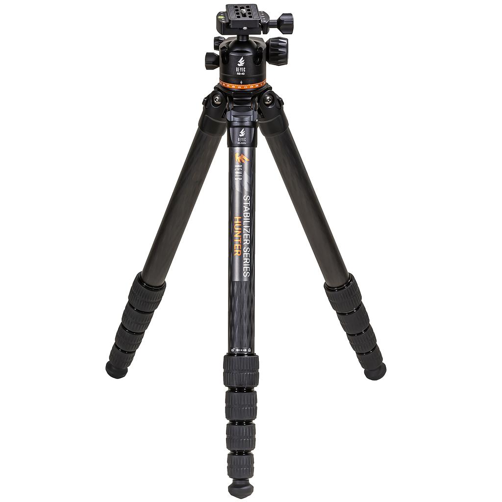

I think they are actually targeting the more robust sized Chinese tripods like Leofoto 404C $650, 40 Mike $515, and Feisols CT-3472 $599. By offering a US made product very unique design if you get the integrated head. Legs are $599
Here is a link I think you hunters might like, especially when using a light weight Magnum with a tripod. Try NOT shooting like the images you see with all legs at the same height. The link is inside our Field Match Tips and Tricks (an ongoing segment over the next few months)
Edited to add: The ultra light Feisol 3342 (after my old 055) was my go to for hunting, the bigger TVC-33 for matches. But after the addition of the anvil the size difference and tiny bit of extra weight, I just stuck with the RRS for both. For longer shots like we see in the West, hands down you can not beat the weight/size to stability ratio.
MY 2 cents, while you want small and light to pack for hunting, you also want a solid standing height. Hunting takes a ton of time and expense, skimping on a tripod seems like a bad idea. I no longer go on Western hunts without my RRS, it is the best $$ I have spent on any gear I own; it has changed the game.

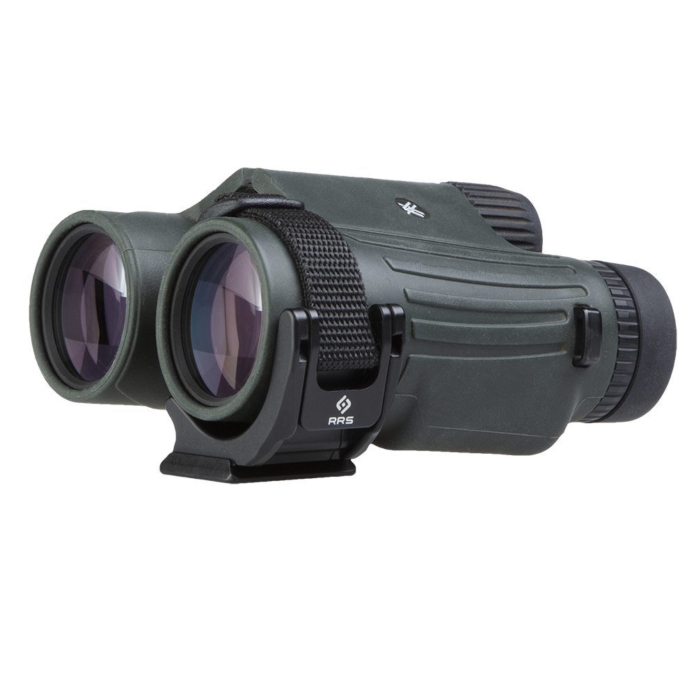

I am also interested in this as well, I have a few tripods for camera work as well as hunting (for bino's/spotter, not gun).
Good posts so far in this thread, but so far I am seeing one issue: OP is looking for a tripod for backpack hunts. On a hunt like that you really need to cut weight where possible so this tripod would have to be dual purpose for glassing all day and then setting up the spotter on, as well as taking long range shots from. Swapping tripod heads to a separate pan head I bring along is fine, I could deal with that weight, but I cant bring two tripods. S far these setups seem to have different attachment points than a pan head you use for your bino's and spotter.
Is there some attachment or the like I am missing? The thread from Diver shows what I mean, when comparing the ball head attachments of the two tripods:
Diver160651
U can get an acra mount for your binos . The outdoorsman "I think "sales one .someone else on here probably knows of more places. I took my ziess mount and modified it with a grinder to fit in arca clamp
The outdoorsman is great, but I think they are overpriced because "hunting". But ignoring that, since they sell adapters for their pan heads... it would be:
pan head > acra mount adapter > RRS Anvil > tripod
In other words i'm doubling up on tripod heads? Not the best solution, but I could live with it if its the only way.
I see, my mount attaches straight to binos right to ballhead it wieghts like 2oz .I no there r other options out there to eliminate so much crap, @seansmd maybe he can respond hes great at gear stuff like this

That being said - I still dont follow how the setup works. What am I missing? These heads wont work for glassing... how do you configure an all-in-one setup?
U can pan ,it may not lock 100 % with the ta3 but if keep some tension on ball head it will travel horizontally, not lock out but u can do it
What you can do, and what is the correct tool for the job are two different things. When your sitting on mountains panning valleys for 5 or 6 days, you're not trying to deal with the deficiencies of a ball head.
I'll speak for myself, but I'm not giving up the ease of adjustment and precision of a pan head. Plus I'd go nuts using a ball head. YMMV.
Still would love to figure out a system so I can swap them back and forth. I'll carry two tripod heads.

The RRS TA3 or any leveling head is specifically designed to go under a tripod head to speed the leg leveling process. These happen to be the most stable of all systems to shoot from. To answer your question, if you can not give up your pan/tilt head and want the lightest solution possible, you can mount a 1.5" dovetail to the bottom of your pan/tilt and use a more robust tripod for both.

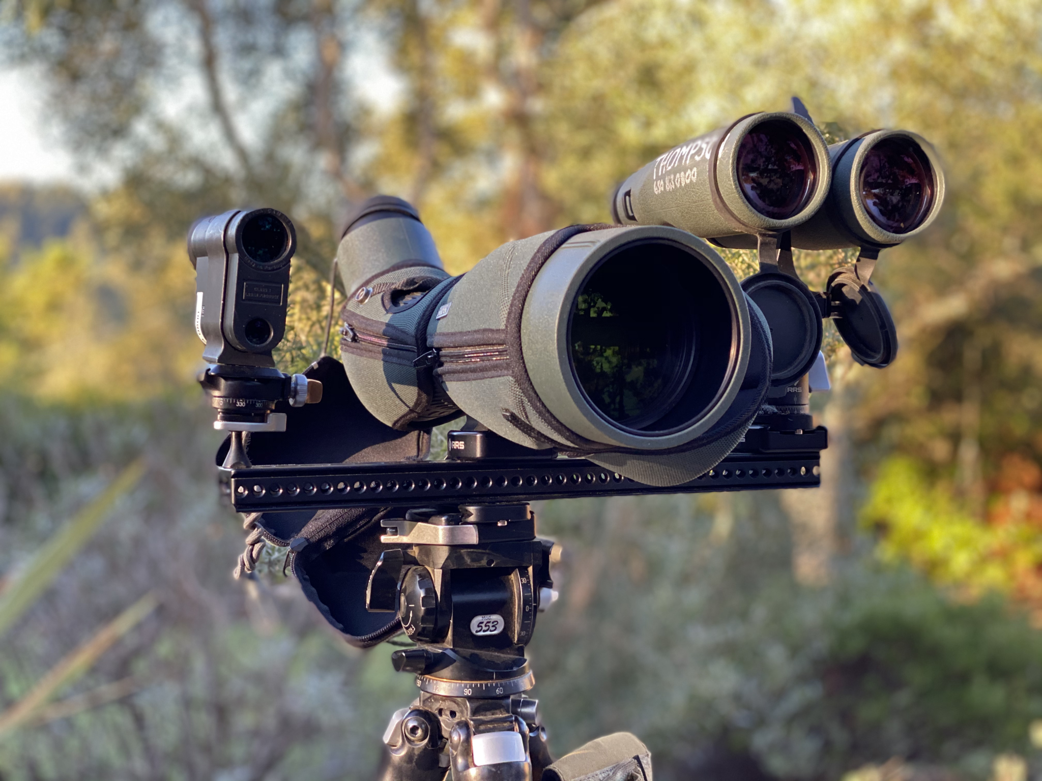

Here is the basic concept showing my barrel vice that uses an RRS 1.5" dovetail (the same as on my hunting guns) and a ball head (inset your pan/tilt) as a bench gun vice. The rifle shown is not one of my hunting guns- lol
This big heavy Geared Pan Tilt head is many times more stable than the typical friction pan/tilt found on most people spotters; yet even this is shaken around in the wind with big glass. But you can mount a smaller (but high quality) pan tilt the same way on top of your TA3, or heck even an Anvil 30 and have better performance than using a small tripod with the extended center column. The point really is you can do the same with any pan tilt that isn't the cheap styles permanently attached to a center column. Think of my Barrel vice mount as the top of your high quality tripod.
Imagine the little pan/tilt below like so many people use, if the big way more expensive head wiggles as shown.

BTW there are some good pan-tilt heads that are fairly light. My Berlebach Model 553 is about 20oz once I replaced the original QR assembly. Outdoorsman sells one too.
That's what i have a swaro post that clamps in the arca clamp, same for my lrf clamps on the arca clamp. One tripod, gun, bino, lrf all clamp into the same anvil30.
R_Swanson is not worried about how to attach his Bino as much as he is concerned about grid control.. He wants smooth control of the panning and have to imaging the vertical as well. Ball heads we use for shooting have a pan feature.
Here is the mount Sean is talking about. The Swaro ATX fits in the same dovetail.
Yes i am from RRS, so I use our gear, but I'll show/tell you what is used/purchased alot.
-Whatever tripod you want for your needs. Our 1 series or 2 series tripods are most popular for the back country, save every ounce possible guys.
-Anvil-30 is our most popular ballhead.
-PC-LR is a panning clamp you can put on top of the Anvil and it turns it into almost a pan tilt, makes grip scanning easier. https://www.reallyrightstuff.com/pc-lr
-B76 plate for a spotter, some guys use a B22 if their spotter utilizes the 3/8" stud instead of 1/4"-20
-Cinch-LR BA for the binos. Quickly becoming ubber popular.

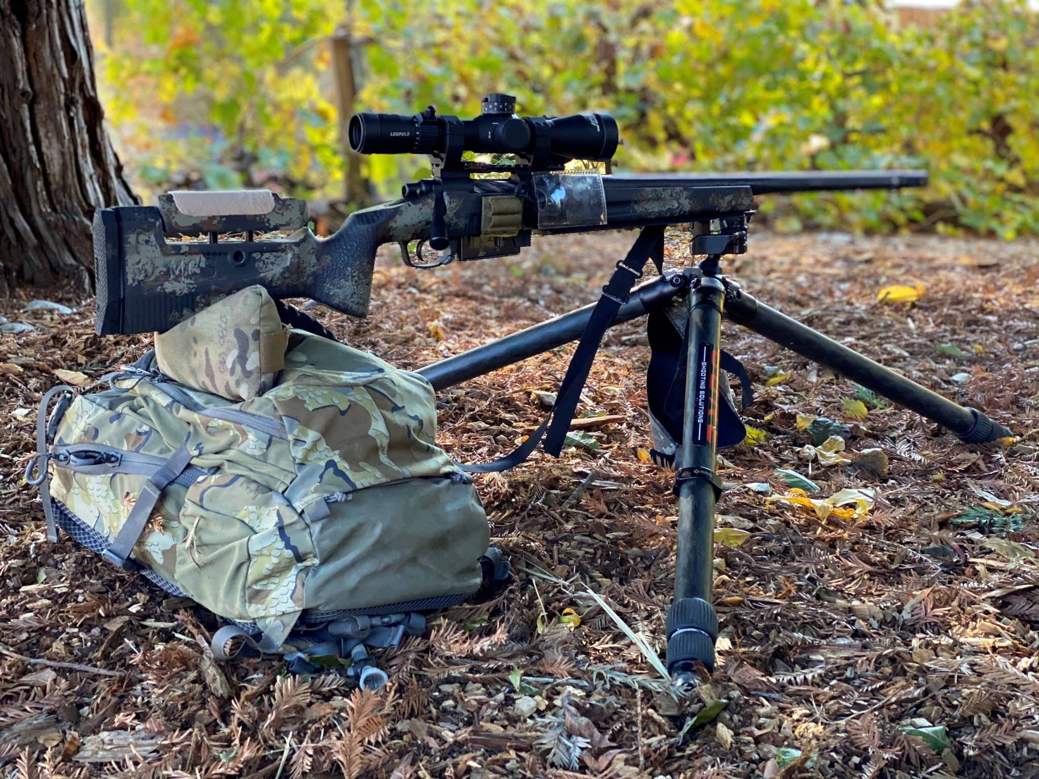

Yes, I use the same tripod for matches, but scouting and spotting in the West as well. The one thing match shooting has taught me is just how easy it is to miss. The last thing I want to do is miss place a shot on the animals, even pigs that I hunt the most as it is pig season year round.
Here is my typical hunting pack and it has at least that much weight on it. Without those 10oz walking sticks I would never have made it. The picture is back at the truck the following morning after hiking down from the snow covered peaks.
I use the larger RRS TV33 because it drastically increases the range and my accuracy potential. The Swaro glass is hunting, and in Wyoming and Colorado wind can be real issue. The same tripod is used to spot as is shown in the rifle setup on the very top snow patch of the valley on the right.
The magnum with CF barrel is about 1 lb heavier (the stock is heavier) than my Tikka Superlite with a fluted pencil barrel (base weight 5.8lbs), but my confidence is much higher.

View attachment 7326088View attachment 7326086
Just a repost of last years - Jabot and I applied for Wyoming (I have a house there) and have our fingers crossed. My son, can gust walk up and get an Elk tag. If this COVID crap settles a bit, I try to get both CO 4th rifle, Wyoming Archery and rifle, this season.. But there is always pig hunting, both long range and packing in..
Do I bring the whiskey or two tripods?
Anyway, just posting so yo know I am not pretending to carry that match rifle out in the field..

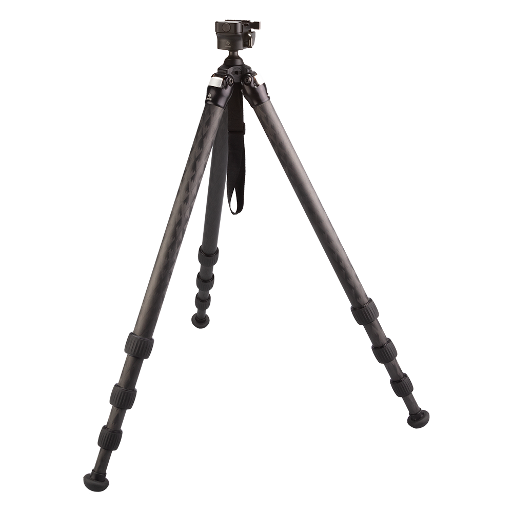

RRS had a prototype at Shot called the Ascend 14 that is supposed to hit in June. I can't remember the specs exactly but I believe the tripod and head were under 4lbs. It looked like the 24 with a slimmed down base and the head was a slimmed down anvil.
I just picked up an AS80C and D-Low 55 head. Not nearly as fancy as the RRS, but at under 1/3 the cost and for mostly spotter use, it should work out fine. Not sure if the box numbers are reliable, but they say it'll come in at ~4.5lbs with the head installed, maybe a bit under. I won't be able to play with it until after the holiday, but should have some opinions in the next couple weeks for the scope and an AR. Not sure how I'd attach the BLR to it, maybe just put some cloth on the head and use that as a rest? Might still end up with one of the higher end options if this doesn't meet my needs, but the majority of use I'm expecting is with a spotter/binos/camera when my ultralight tripod isn't up to snuff.
New from Gunwerks, looks similar to RRS legs...didn't catch a price.
If you use your imagination, can see in the video the lack of options short rails give the hunter on a hunting gun. I don't know what it is, but very few guys making how to shoot from a tripod, either seem like they really don't know or take the time to show setups that take tripods to the next level like a full ultra-light dovetail for hunting guns.
The image was talked for the Field Match tripod tips and tricks post. I do NOT carry the Gel-lite rear bag hunting. I just move my pack around to provide the support.
Whatcha think of it so far?
