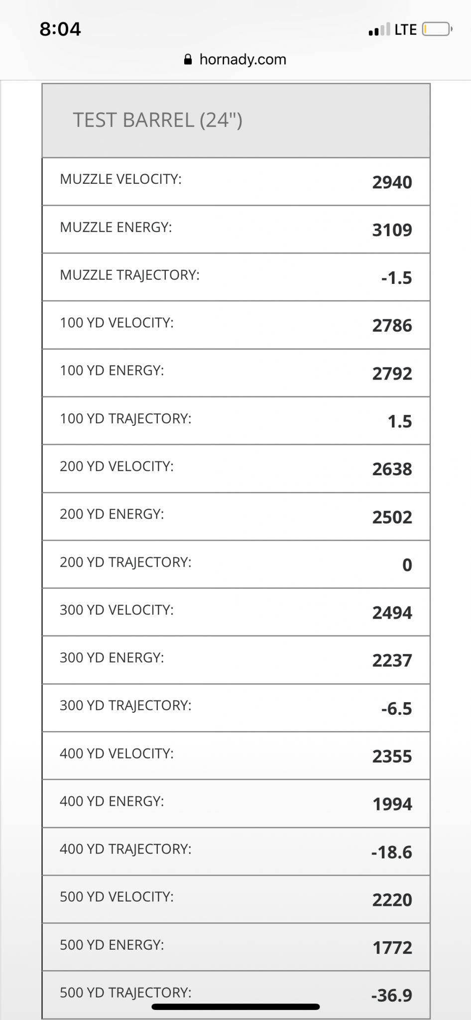

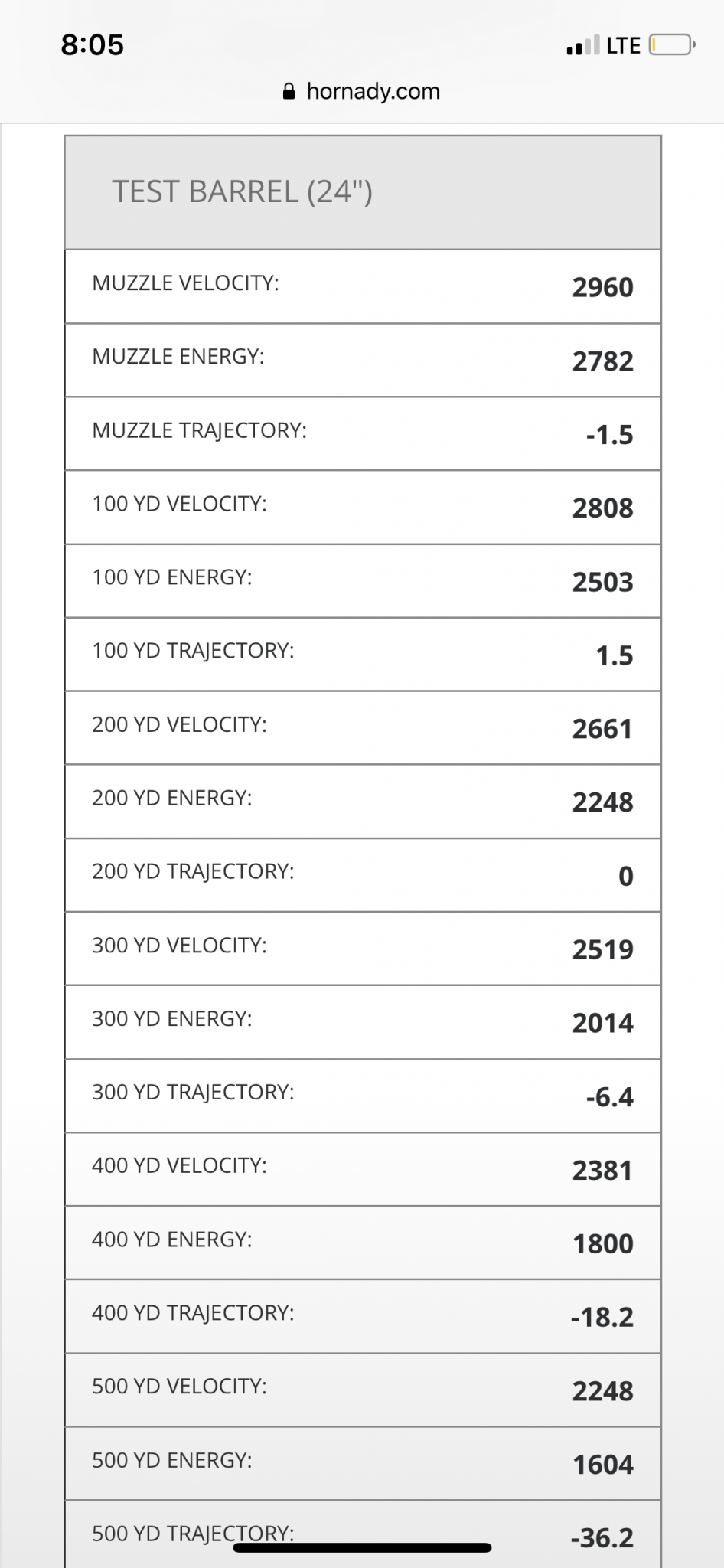

I’ve had really good luck with the 162 grain ELD-X Hornady factory ammo in 7RM. For something you’re not competing with, I personally don’t have any problem at all with a long action or running the long action mags.
Imo, it’s sort of splitting hairs between the 6.5 PRC and 7RM with factory Hornady eld-x ammo at least (143 vs 162 grain) but I don’t have moose or elk where I live ? and I’m a sucker for finding an excuse to buy a new gun in a new caliber ?‍♂️.

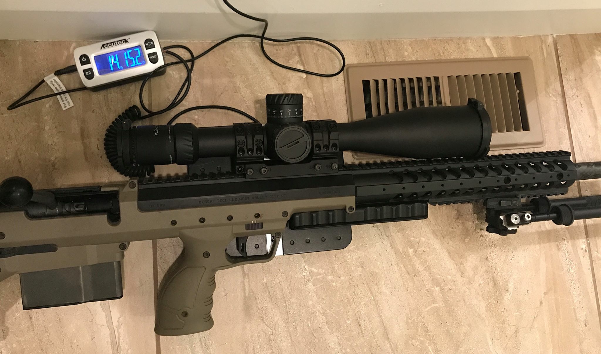

There's now way a DTA with a C.F. barrel is anywhere near 8 lbs .
Yea not a chance, my DTA with a heavy fluted 6.5 Saum barrel is about 14.5lbs. The heavy fluting is almost equal to what the CF barrel would weigh. You’ll be VERY lucky to get 13lbs. But you’ll probably still be around 14
Is that with a scope? I am talking rifle only.
According to their website the 22” .308 SRS with heavy contour barrel is right at 10 lbs or so.
Yea with scope, but I’m not running a 6lb scope. NF ATACR.
I can weight my covert chassis tonight for you. If you could get an SRS that light the CF barrels would be a lot more popular.
You really only save about 1lb going CF. Reason is, the giant shank that the barrel has to have to index to the chassis is still steel. No way around that and that’s the heaviest part.
Just weighed it real quick, Covert chassis with bolt only, weighs 6lbs 5.3 oz
16” 308 factory barrel alone is 3.97lbs
That’s 10.5lbs total. I’d venture to guess a 22” CF barrel is about the same as a 16” steel barrel.
