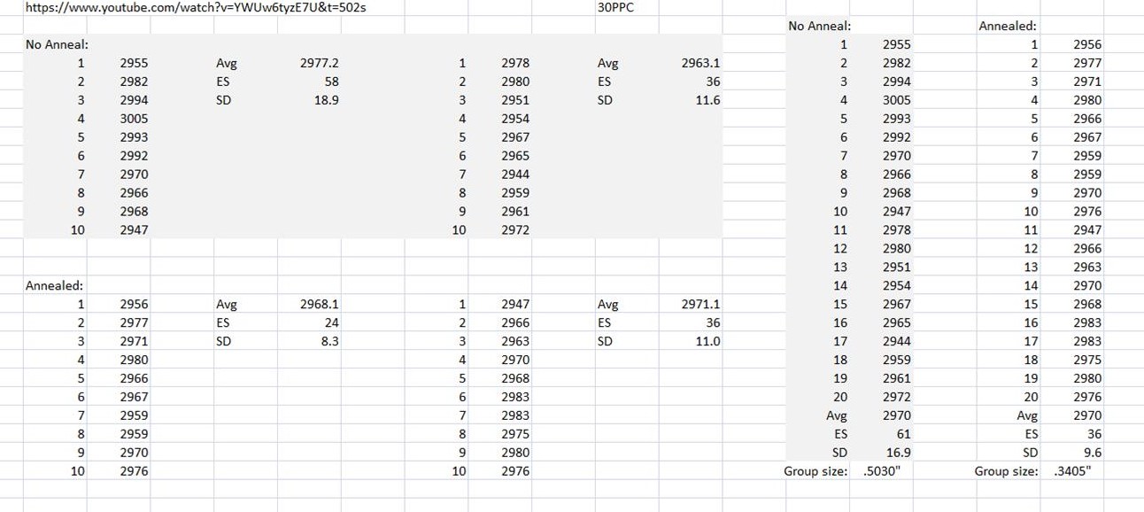

Can someone, anyone show me quantitative proof that annealing has any effect on accuracy or brass life or whatever reason your doing it?
I hear people speculate about these things, but I've never heard of any scientific testing to prove it's benefits. Does anyone know where I might look?
Amps website has articles with "science and shit".
But like ever annealing thread on SH, feel free to willfully choose to believe whatever you want.
I just looked through the stuff on the amp site. All I can find is "the case is more consistent post annealing by measuring with this method". I have no doubt that is true. My question is: has anyone ever simply loaded 200 cartridges and annealed 100 of them each firing and shoot through both groups looking for any changes in accurracy/ precision, or brass life?
Surely someone has put these ideas to a simple test?
There some good science on AMP's website. One needs to delve into the numbers to really understand the science there. ;) https://www.ampannealing.com/articles/58/annealing-under-the-microscope/
Annealing has definitely given me quantitative data on reducing my numbers of split necks on hot .223 loads. Scientifically, no, I have no proof that it was due to annealing alone. But my load (25.5gr Rl-15) was the same throughout.
However, I went 2 reloads on my '08 Lake City 5.56 brass, and split the neck on ~80% of them on the 3rd reload. I started annealing, and made it to 5 reloads before I had to replace that barrel... That was '07 Lake City 5.56 brass. I do not know how many more loads I would have got before primer pockets opened up etc... When I had that barreled action redone, I switched brass.
Regarding accuracy, I have no scientific data that says annealing has helped my accuracy. Again, however, I will absolutely attest to having a more uniform feeling of my brass over my expander mandrel when I anneal brass as my first step after firing. I would ASS-U-ME that the more uniformity in the interference fit/neck tension is giving me better ES/SD and consistent bullet release. Can I prove it with the targets that I've saved? Nope.

I think you've done the same thing everyone in this conversation does: an appeal to data. The problem is that the available data provides nothing but data. Seems like such a simple thing to prove.

Fascinating. Skepticism is a good thing and can lead to good science, but there are forms of it that just doesn't lead to progress. 🤷‍♂️
In the spreadsheet I posted, I took the values right off each of his chronograph readings as he fired them since they were not published anywhere. And the group sizes weren't affected by atmospherics since the shooting was done in a controlled environment. Yet, you apparently reject the test, perhaps as anecdotal??? What do you really want to convince you?
No, you misunderstand. Didn't disregard your data, and in fact, thank you for sharing it. It's just a very small sample size. That data may prove out over a thousand rounds, or ten-thousand, but you know 10 rounds isn't a large enough sample size to make any declarations. I've shot 10rd groups back to back with no changes and seen noticeable changes in group size and SD and the like. Thank you for your spreadsheet, and it does as much as anything I've seen as far as reasonable testing, just needs more. Ten groups of ten shots each way would probably be enough to tell the truth.

Individually, the improvements you make for adding or improving a specific step are pretty small. They are small enough that without a large sample size, critics will tell you that the improvement is within the margin of error. Then, when you do actually use a large enough sample, they'll say it's something else.
So, why is it that some people have reliably lower SDs than others? Because they do a number of things together that, in the aggregate, produce meaningful results.
This would be a pretty invalid test for what you're looking for. Here's why:
1) It would have no bearing on brass life. EDIT: for clarification, one firing would have no bearing
2) It would likely have little to no impact on precision either. Firing brass that's newly annealed vs. brass that was annealed last firing will show little difference. Harder cases will spring back more after sizing and using a mandrel, and will thus exhibit a higher effective neck tension on the bullet. If they're all the same, you will get progressively higher effective neck tension as you go up in the number of firings, which will ramp pressure progressively as well, but with proper prep, they should all maintain a consistent firing profile with respect to each other. Whether this pressure ramp impacts precision down range is entirely dependent on a vast array of other variables - some of which will change by the hour.
3) Even going to 3 or 4 firings, as long as you're firing the same group of brass (e.g. they all have the same number of firings), and you use other mitigating factors in your reloading process, you probably won't see much difference. This is provided you keep the brass separated by number of firings.
The most effective way to test would be to get a group of brass that you never anneal, let's say 40 pieces. Each firing you pull 5 out and put them aside. This will give you a group of brass ranging from 1 to 8 firings since annealing. Then fire them all together, measure the SDs and group size of that group vs. another group that's been freshly annealed.
I've done enough testing on other things. Perhaps I'll do that once I get my newly rebarreled 308 dialed in again. Would be a fun, if long, test to do.
Yeah, truthfully that test would not be much fun at all in my opinion, but I want to address how it's done. What I described above was two batches of brass, (100ea), one group is annealed before the first and after each firing, the control group is never annealed. Do identical brass prep on both sets, load them all an identical known load in a simple chambering that won't require cleaning a carbon ring before you can get through 200 rounds, and record precision on each group. After 8 rounds, let's see what the difference in the brass is. 10 rounds, 12 rounds, 20 rounds.
It will be expensive, boring and monotonous, but it will prove definitively what the tangible effects of the annealer are. If someone had a decent YouTube channel and hyped it correctly, it would probably get a million views in the first week..
I agree about 10 rounds given the statistics for that number. That's why I combined each of the 10 sets for 20 on my spreadsheet as 20 is a much better telling figure. There's an error factor for 20 too, but. . . but it's getting pretty small and I think, small enough to answer the question as to whether the theory(s) is valid . . . especially given the many testimonies from some pretty good sources. It just doesn't seem to me that something like a 1,000 round test is going to answer the question any better. After all, we're not trying to put a lander on Mars. ;)
Hmmmm??? I wonder if a Monte Carlo simulation software could answer the question well?
You're very welcome, about the spreadsheet. As I've collected my own data or the last 8 years, it's been interesting to me to see what works and what doesn't. When I initially started annealing, I saw a distinct improvement in my overall data. But, because I was (and still am) playing with various components, I think it would be too confusing for anyone to look at my data and draw any conclusion about annealing since I didn't actually record this aspect for annealing.

Generally you'd be comparing two sets of data on each day: annealed vs. x times fired without annealing
While the temps, etc. would change day to day, the comparison between the two sets would be valid - as would the final test, which would be fresh-annealed vs a mix of 1-8x fired.
Either way, 500+ rounds is a heavy tax to pay.
I once shot a 20-shot group with a single piece of brass. Fired, annealed (AMP), FL resized, wiped off, trimmed, loaded and fired. This was in our 200yd test tunnel from the fixture.
Group was pretty much indistinguishable from 20x virgin cases. The only notable difference was the first shot was slower than the rest. I've done some virgin vs 1x, 2x fired tests before, too and saw the same thing. First firing usually averages 10-15fps slower. Dispersion and velocity ES/SD data is pretty much indistinguishable.
In my opinion from what I've seen, annealing (if done properly) extends service life. That's about all it does. The only claim I think that can be reliably made about improving ES/SD/precision is if you compare annealed vs. 5-7x fired brass because eventually as the necks get hard you do often see a decline in those metrics.
This really where all my testing efforts are centered. I care about group size, obviously, but usually you can tune that in via seating depth and/or charge weight. ES/SD can only be made as good as the brass/prep will let it be.
