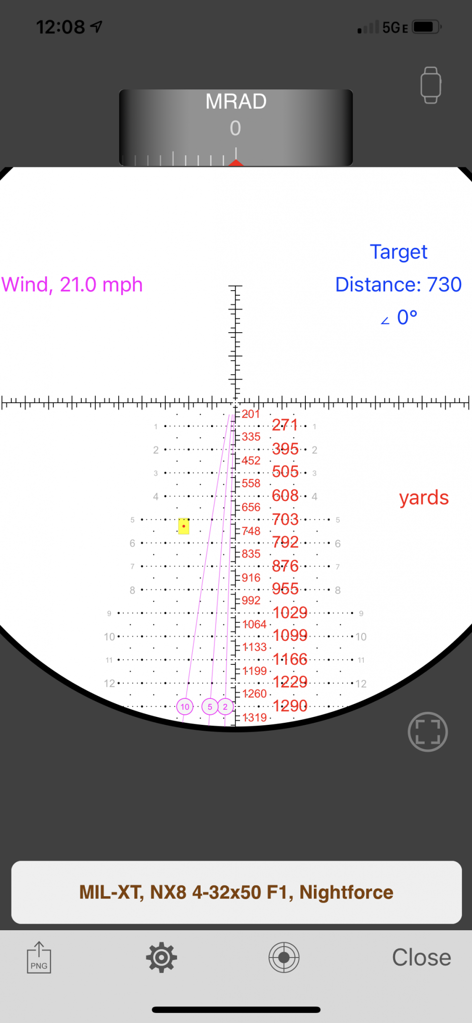

    I do need to dig into Strelok Pro for the target list function - that's new to me.
    PS. Just got the target list function - that's a big help!

    Comp Mode in BallisticsARC does the same thing. Plug target distances(plus direction and angle if desired) and then once they're all entered you can mess with the zero setting.
