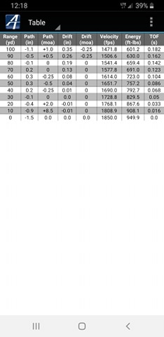

I don't mean to call you out here, but there is no 9mm ammo capable off what you are claiming.
Here is 357 mag lever gun shooting a 125gr hp at 1850 fps, zero at 33 yards, it will do what you claim.

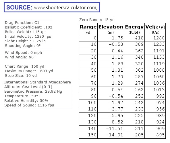

Based on the online calculator from ShooterCalculator, I will be switching my zero to the 15yard that you recommended. My Ruger PC Carbine set up with the red dot at 1.75" above the bore shouldn't be more than +/- 2inches high or low from POA at zero out to 100 yards.

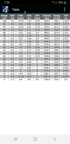

Let me apologize, that is pretty solid data for 1280 fps. I've ran calcs over 1400 fps with self defense ammo that does not look that good.

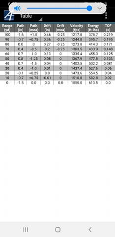

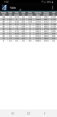

How close would those numbers be if you were running 9mm +P+ at 1550FPS? Just curious for my self education
One more time, 2.5" sight height, 33 yard zero, way gooder.
On barrel length, I used 14'5", but that does not matter, just speed, I am not an expert, but after a certain length, drag has to enter. Guy would have to get a long barrel and start lopping it off to get numbers, but then those numbers would only be for that load. We ran tests one aft, learned if you want pinpoint accuracy from a PCC, it comes with more expensive bullets. Buying more expensive bullets doesn't seem wise with magazine extensions holding up to 50 rds.
