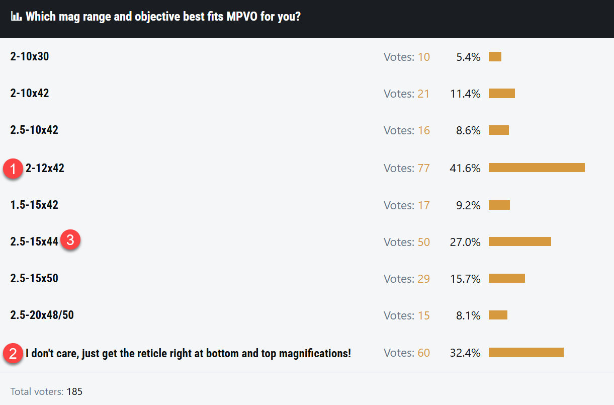

Which mag range and objective best fits MPVO for you?
  • Total voters
    246
Okay, we are just over two weeks into the poll and at 185 total votes; however, with 30 some more votes than last week, we went from 42.2% to 41.6%, so rounding shows we are staying at a steady 42% for the 2-12x42. Hopefully this gives manufacturers something meaningful to chew on and consider. The next higher percentage below is from the "I don't care" crowd who just want something with a better reticle in a FFP scope - something that works well at bottom magnification and at top and the third highest percentage is what I would call a hybrid between a crossover and an MPVO with the 2.5-15x44. Unfortunately, it takes at least a couple years to flush out a design, what we need is a good LOW 2-12x42 design that other manufacturers can OEM and put in their reticles (reticles designed for MPVO/crossover) and their turrets (lower profile).
But for my money, I’ll take a dual focal plane 3-18 with exposed locking turrets, a Christmas tree reticle, and 1/2 and 1/4 mil hashes because the human brain intuitively does halves and halves of halves better than decimals. And, give it an illuminated donut of death.

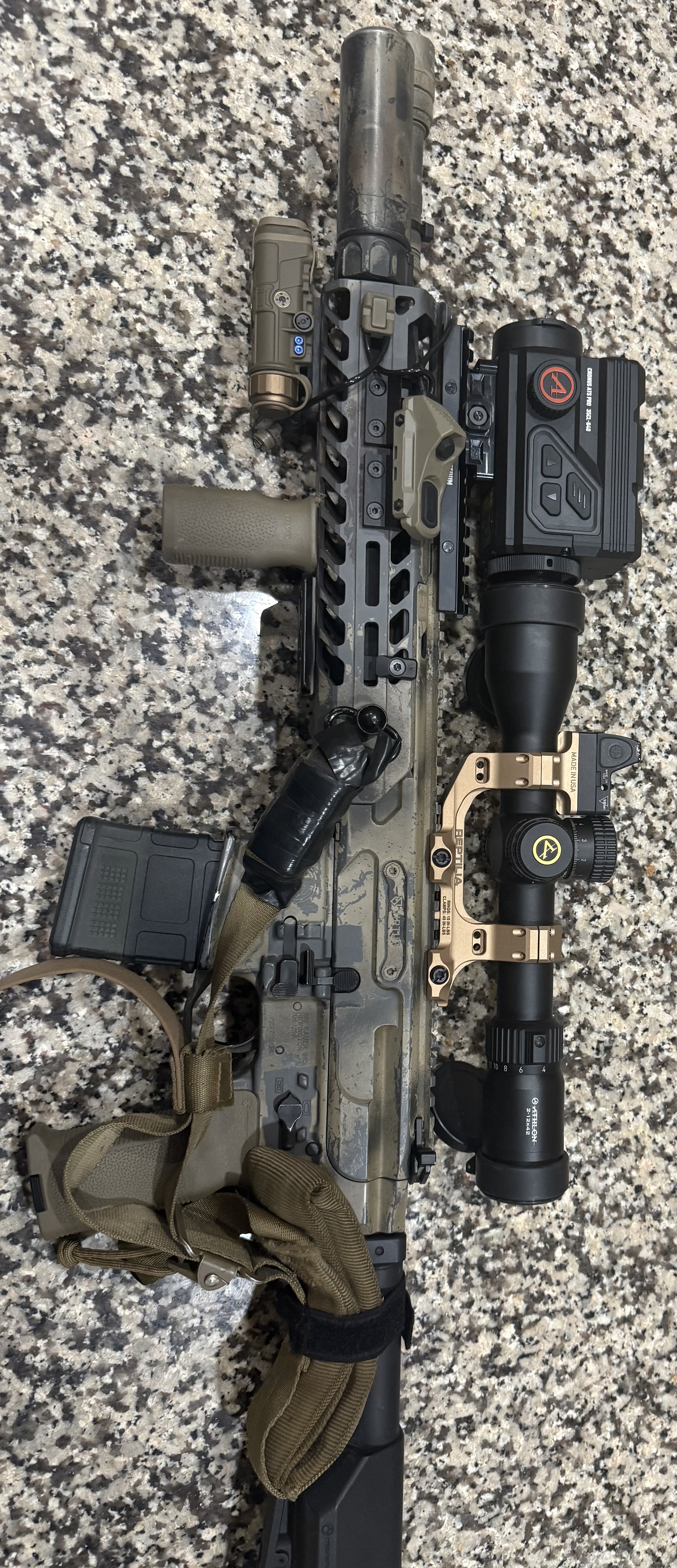

I'm a huge proponent of the MPVO for the types of shooting I do. When getting in to NV I put a dot on everything. After a lot of experimenting to get the ideal offset dot position, the dot came to eclipse the 1x on my LPVO. A red dot is far superior to the best 1X scope for a number of reasons:
-unlimited eye relief and basically unlimited eyebox are a massive benefit for dynamic shooting
-daylight bright battery life measured in years, not in weeks
-ergos for passive aiming become identical to daytime shooting, no new muscle memory to train
That led me to see what it would be like to just forego the LPVO and find an MPVO to replace it. That means the MPVO needed to not add significant weight over the LPVO (at least not enough to change the balance/handling of the weapon significantly), and needed to have a good fast reticle at lowest mag when I need to take offhand shots with more precision than an offset dot gives.
I went through a fair number of options, and by far the most successful has been the (unfortunately recently discontinued) PA GlX 2.5-10. The big ass chevron is the only thing that enables good times for quick offhand shots, every other reticle I've tried has been a let down in this area. The chevron sucks for long range work but to overcome that I simply use the tree and do not dial. If I need a precise aiming point for zeroing or shooting paper I dial 1mil down and use the -1mil line as my aiming point. What really makes this scope work is the light weight (22.5oz) and a reticle design that is truly usable at both 2.5x and 10x.
This scope is not all puppies and rainbows, the turret lock/zero design is dogshit and the 10x top end is still a bit limiting, and I have some minor gripes on the reticle. But overall it is the best I have tried.
One scope I had high hopes for but ended up getting rid of was the much praised Helos 2-12. The Helos just wasn't nearly as fast/precise on 2x as the GlX was on 2.5x. On top of that it weighed 4oz more, and those two things together made its admittedly better high end and turret design not worth the sacrifice compared to the GlX. At 26oz I would rather lug a couple more oz around and get a 3-18. I have the Meopta6 3-18 with Ilya's Mrad reticle, and that optic is at least as fast as the Helos while being massively more capable for real precision work... it has found a home on my .308 Revolution where I feel it is perfect.
All of that is to say that to me the mag range is really not that important. The reticle design and weight are massively more important. And given that a wider mag range tends to add weight, I would prefer to sacrifice that and stay with a 2.5-10 or 3-12, if I can get a durable lightweight scope with a great reticle on the low and high end.
Unfortunately the reticle is where virtually every company shits the bed here. The h6xi could be great... but the reticle is trash for anywhere near 2x. I also want to note that I don't care about the illumination on the reticle very much... my dot stays illuminated and I don't need to worry about battery life, I want a reticle that I can see in complex dark environments with no illumination.
The other area where companies shit the bed is by trying to add too many features and ending up with something that is a crossover or HPVO due to its weight, but totally disqualified as an MPVO. The new PA 2.5-20 is a great example of this. I had huge hopes when I heard the announcement, but when I saw that it is a 34mm tube and weights the same as my Meopta.... all my interest was lost. I would rather pay 1/2 as much and buy another Optika6. I'll have a less optically compromised optic with the 6x vs 8x erector, which will probably perform nearly as good at the top end while having a far better reticle for the low end, for the exact same wieght. My guess is they will find some way to shit up the next gen 2.5-10 as well.
And for those who say 'why not just use a 1-10 lpvo' sorry the performance is not there. The compromises to get a 10x mag range in a compact optic are just too much. Shooting my glx 2.5-10 next to my friends Vudu 1-10 for long range steel banging, the glx shits all over it. The eyebox is massively more forgiving and once parallax is adjusted it is significantly easier to resolve tough targets. And I have a proper elevation turret for dialing. I think its fair to say the Vudu is one of the better LPVO's for long range work on the market.
On top of that shooting drills with my glx at 2.5 vs the Vudu at 1x, I get about the same times and accuracy, since the GlX reticle is faster to pick up and the Vudu is not daylight bright. Both have way worse scores than when I use my offset dot on drills.

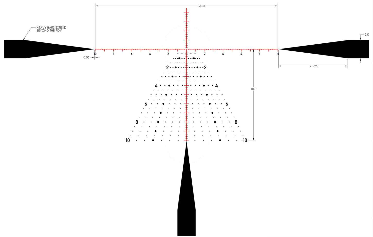

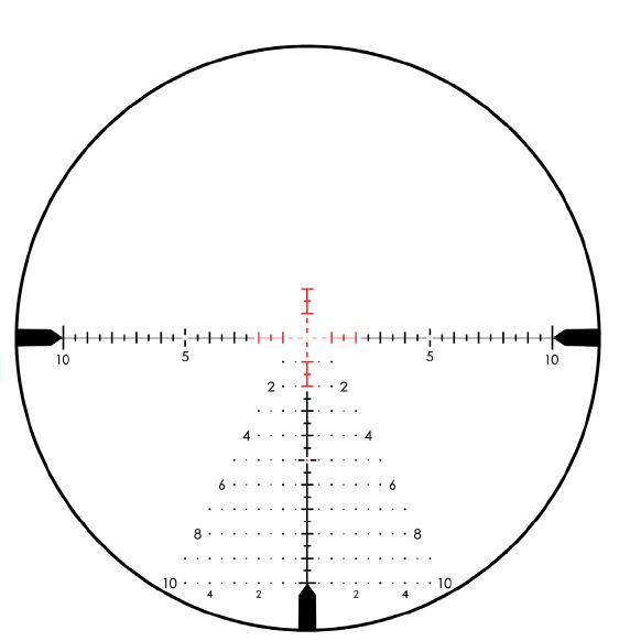

I know this thread is a bit old, but in my search for an MPVO for my SPR-ish build I came here looking for options. Saw nothing new, but YouTube shorts may have just helped out. Saw a review for the Vector Optics Continental 2-12x44.
27oz, 34mm tube, tree reticle with clear design intent to be used at both 2 and 12, .15 mil (.52 MOA) floating dot with tree and circle plus 65 Mil (224 MOA) outer ring that disappears as you increase mag (similar to the VCOG). Two slightly different reticles, but both look very much like what most people seem to be looking for in an AR MPVO setup. Also, the price isn't bad to just try out. Wouldn't expect Alpha glass, but looks like the closest win we have right now next to the Athlon Helios. If someone gets to try it, report back. Would love to get one, but have a could other life experiences that came up recently... Damn hail and blown out truck strut.
I would have bought one to try but the damn 34mm tube and no weight savings over my Viper 2-10 gen 2 already. Plus the cost of a new mount since I can't use the old one. Have been watching for a 2-10/12 with good field of view, lower profile locking turrets, and decent weight savings for a while with not much luck. Closest I got was a GPO 1.5-9x44 since it is the only option they have with a simple MIL reticle.

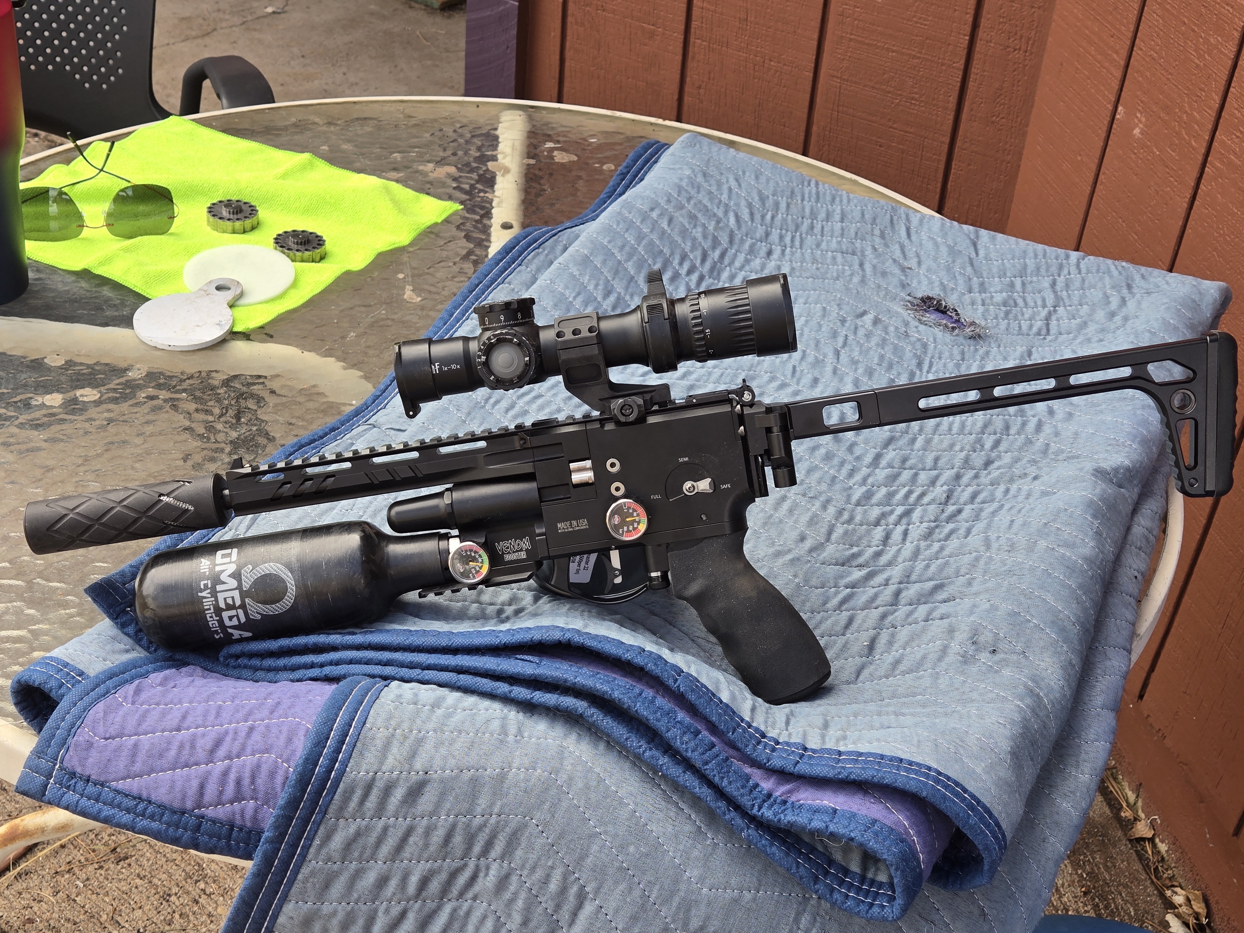

I bought one of these for my son since he's still learning how to take care of his things and with a coupon code it was only $400 and some change. I hate to say this because it makes me feel like a hypocrite, but at first blush I really can't find much wrong with this thing. It hasn't been subjected to a big caliber or an aggressive firing schedule, but it has been knocked around by a 10 year old on the back of an ATV for what that's worth. It seems to be mechanically stout, the turrets obviously aren't TT quality but they aren't any worse than some of my leupolds. Tracking seems to be holding true so far but he's learning to shoot with holdovers so it hasn't been dialed a ton, and I don't know if we just got a great example and their QC lets out an equal or greater number of stinkers, but *based on my limited experience so far* if someone slapped a steiner label on this and charged $1500 I wouldn't have been the wiser. I'm genuinely curious to see how it holds up in the long term but initial impressions are wildly better than what I anticipated.

That's good to hear, and seems to be reflective of what little I've found from other reviews on it. Hopefully I'll be able to snag one soon and try it out before it starts to get more expensive.

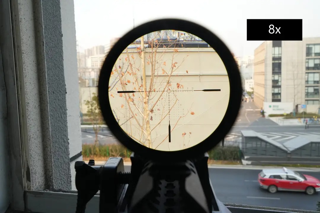

Another option for a MPVO with a useable reticle at minimum power is the Riton Conqueror 7 3-18x50 with the T3 reticle. It has a fairly large center dot and reticle stadia lines that subtend 0.2 mils. The scope has a lot going for it. Crisp turrets with a hard zero stop at 0 (no dialing under 0), very bright (perhaps nuclear bright) illumination, nice IQ, 1/4 mils hash marks on the vertical and horizontal stadia lines, and smooth and solid controls. However it’s got some edge distortion at 3x that disappears around 4.5x, has non-locking turrets, and it’s not lightweight. A locking windage would be ideal for my uses.
I have one in my safe for that I swap out a 5-25 ZP5 with on my crossover rifle to use in the late fall and winter when hunting. It’s about perfect in the 0-400 yards visibility areas I hunt due to the bold reticle.
