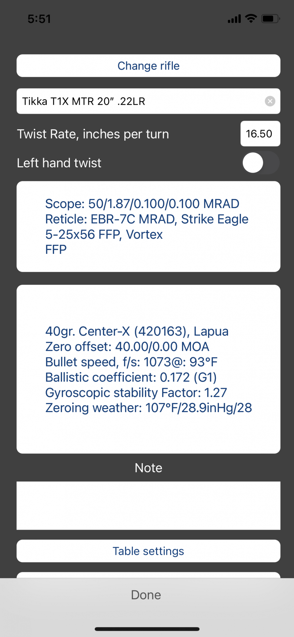

So I have Strelock Pro, but what’s next? I’ve got all of my specifications, does this look correct based on what I have?
Gun Setup:
Tikka T1X MTR .22LR 1/16.5 Twist Rate 20” barrel
Vortex Strike Eagle 5-25x56 MRAD
Vortex PMR Medium Plus Height
Evolution Gun Works 40MOA Pic Rail
BTW, what is the moa offset in Strelock? Is that my rail? I do not understand that, and no one explains it in any video.
Things I need:
Chronograph
Kestrel
I know that I need those items to get accurate D.O.P.E. But trying to make due with what I have while still upgrading my rifle at the same time.
doesn’t the 40MOA base effect the overall travel in my scope though? I guess that’s where I’m confused. Because after zeroing, I have roughly 18.5 Mils of travel available left in my reticle
It will effect that travel but the the “solver” doesn’t really know or care to know what you’ve got for travel. I will admit it would be cool if it somehow integrated the scope travel into the app
You also don’t have to have a chronograph if you want to get rolling now and can play with one once you get it. Just set your muzzle velocity at 1,073 in StrelokPro. Zero rifle at your zero distance. I suggest 50yd then go out to known distance like 100yd, 125yd, 150yd, and see how it matches up to your point of impact. If your a little high on all drop your velocity a tiny bit and if your low bump it up a little till things match up. This will get you basically there pretty easily without chronograph. Your zero is your zero and corrections in the app are the corrections from there, that’s basically why your moa rail doesn’t apply.
