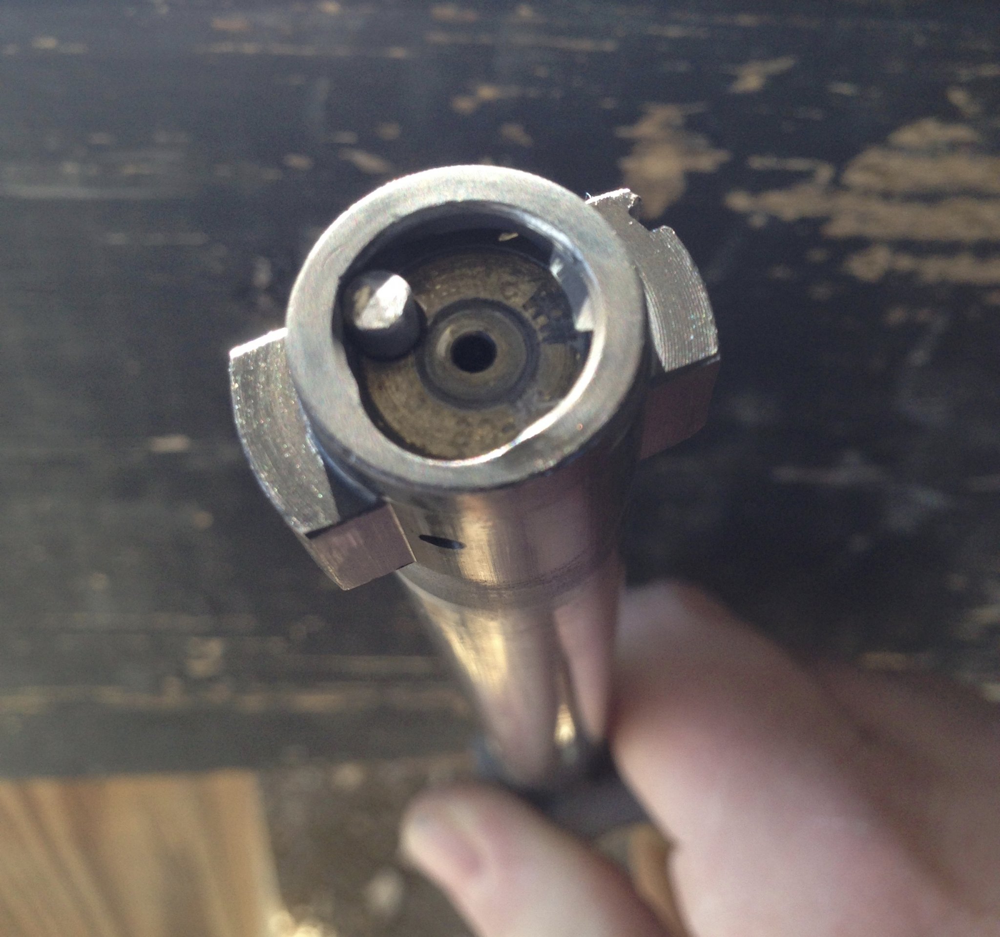

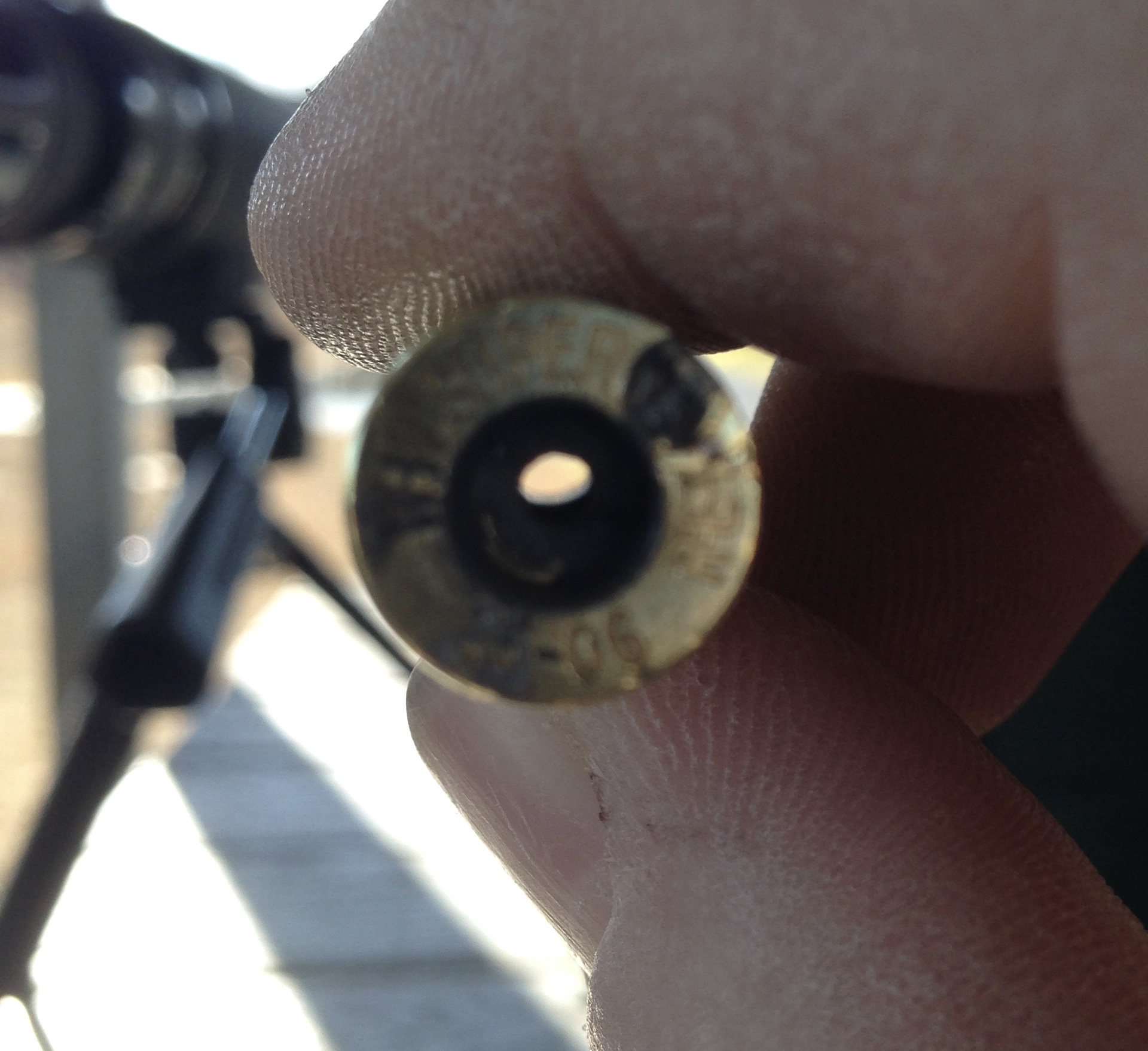

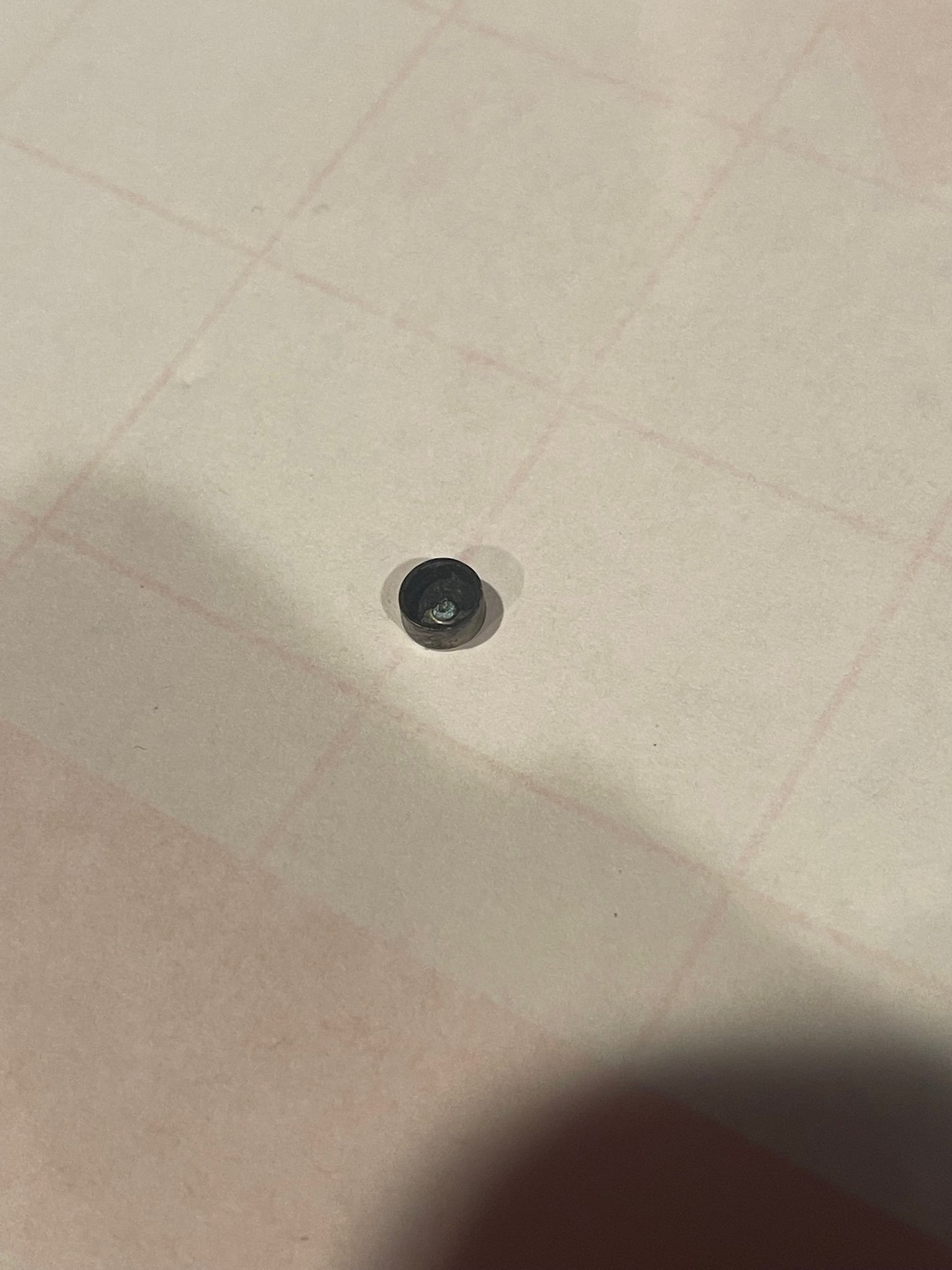

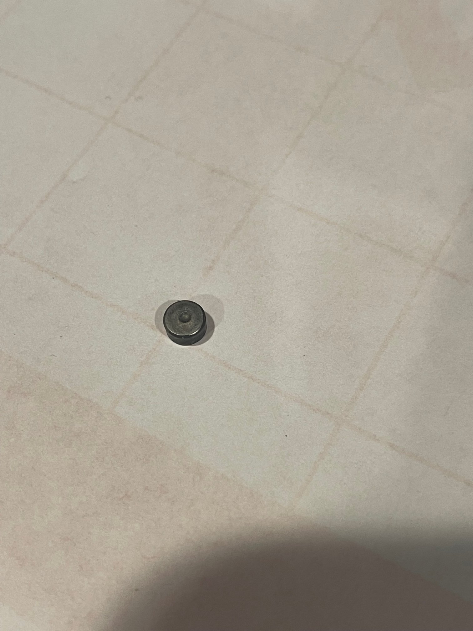

    I was out firing my 22 creedmore today getting some practice in and after I fired a round the following round only feed half way into the chamber and caused a jam.
    I thought for a second that I had a case head rip off and the top of the case was in my chamber. Turns out the primer got popped out of the case and then managed to go into the chamber and wedge itself there all before the following round was able to chamber.
    The primer did not get punched by the firing pin like you normally see from pressure issues but the interior core of the primer was blown out.
    This is new perterson brass with federal LRP and 85.5 Bergers.
    I'm using a JP high pressure BCG
    For reference these rounds are not loaded real hot. At least compared to how hot I can load them. Only signs of high pressure I get is the ejector marks but I cant stop that no matter how low I charge them.
    Just crazy the thing managed to go down the barrel and get stuck. Luckily it was to big to go down any farther so it just caused a jam.

    That is a smoking hot round look at that primer flow is your ejector still there?
    Nothing was damaged. Prior to switching to the JP high pressure bolt I would get primer punctures from the firing pin about 1/10 shots while not running a car. Since then I put a few hundred though it while also adding a TBAC 9 on it I have not had 1 puncture or any other issue other then this single primer popping out.
    Round also still came out like normal and hit the 550 yard prairie dog steel silhouette. So for what it was the velocity was at least enough close enough to what its dialed for that it hit a 4" wide x 12" Prairie dog at decent range.
    That primer is heavily cratered. Are all your others like this? Your loads are far too hot, your bolt is unlocking far too early, or both. What is your barrel length, gas port location, buffer weight, and do you have an adjustable gas block.
    that primer is heavily cratered. Are all your others like this? Your loade are far too hot, your bolt is unlocking far too early, or both. What is your barrel length, gas port location, buffer weight, and do you have an adjustable gas block.
    This one is a +3 gas block 26" barrel by Craddrock.
    Its a 85.5 Berger loaded with 40.5gr of H4350. A hot load would be something in the 42-43gr range.
    None of the other primers other then this one are cratered.
    Yes, adjustable gas block, I called JP and discussed parts with them and they recommend their HP BCG and an adjustable weighted silent capture spring to use with it. The bolt does not hit the back of the receiver while cycling if thats what you were wondering.
    I also took it to a qualified gun smith to have them function test it all afterwords.
    I did my due diligence on this one because I already knew it could be a problem if not done right.
    I suppose I should also add that Unknown Munitions loaded the ammo and not me. Frankly I was not in the mood to load 600 rounds of 22 creed at the time. I'll do it the second time once I have all the fireformed brass.
    At least that one specific round was very hot. The primer doesn't look THAT bad, but the case rim shows severe signs.
    Set that piece of brass with the rest and take a side view photo. Compare how dirty they are. That one case looked covered in carbon.
    On second look, what's down the barrel is the brass "web" that holds the primer.

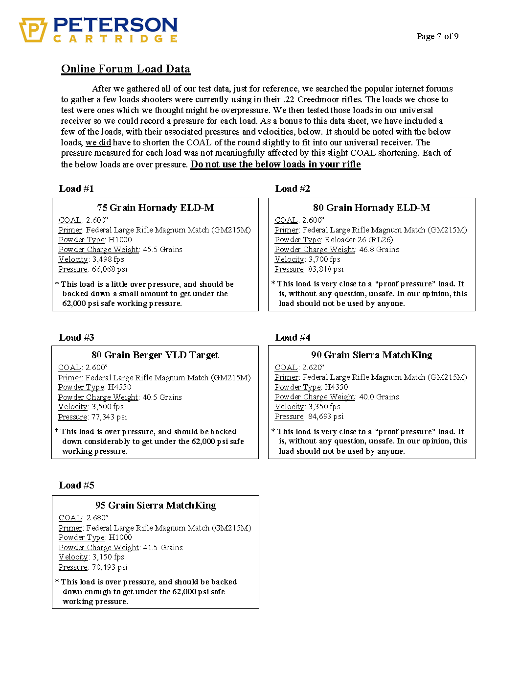

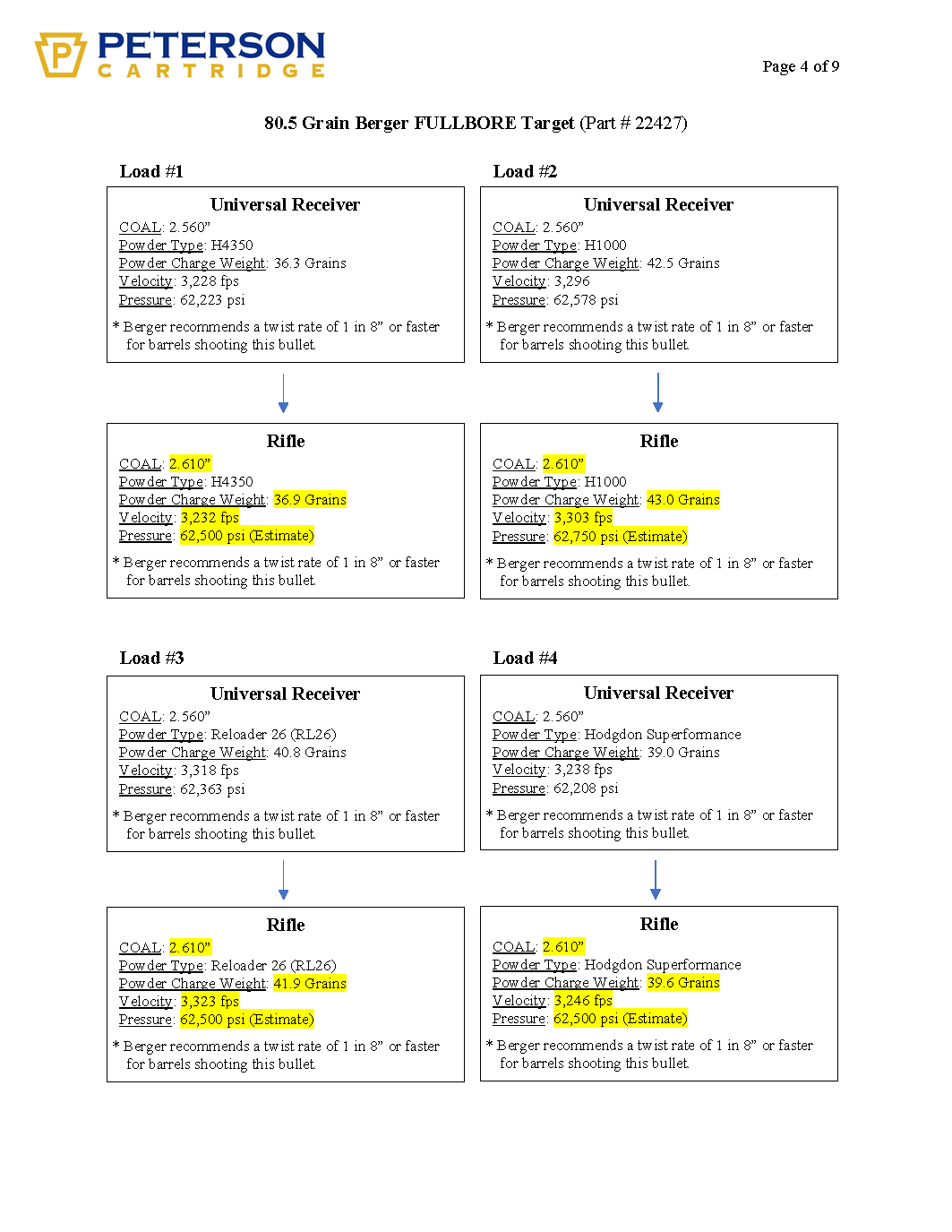

    Uhm, Peterson’s load data and pressure testing disagrees with your assertion that your load isn’t hot. This is comparing their load data with an 80.5 Berger…..
    COAL: 2.560"
    Powder Type: H4350
    Powder Charge Weight: 36.3 Grains
    Velocity: 3,228 fps
    Pressure: 62,223 psi
    COAL: 2.560"
    Powder Type: H4350
    Velocity: 3,228 fps
