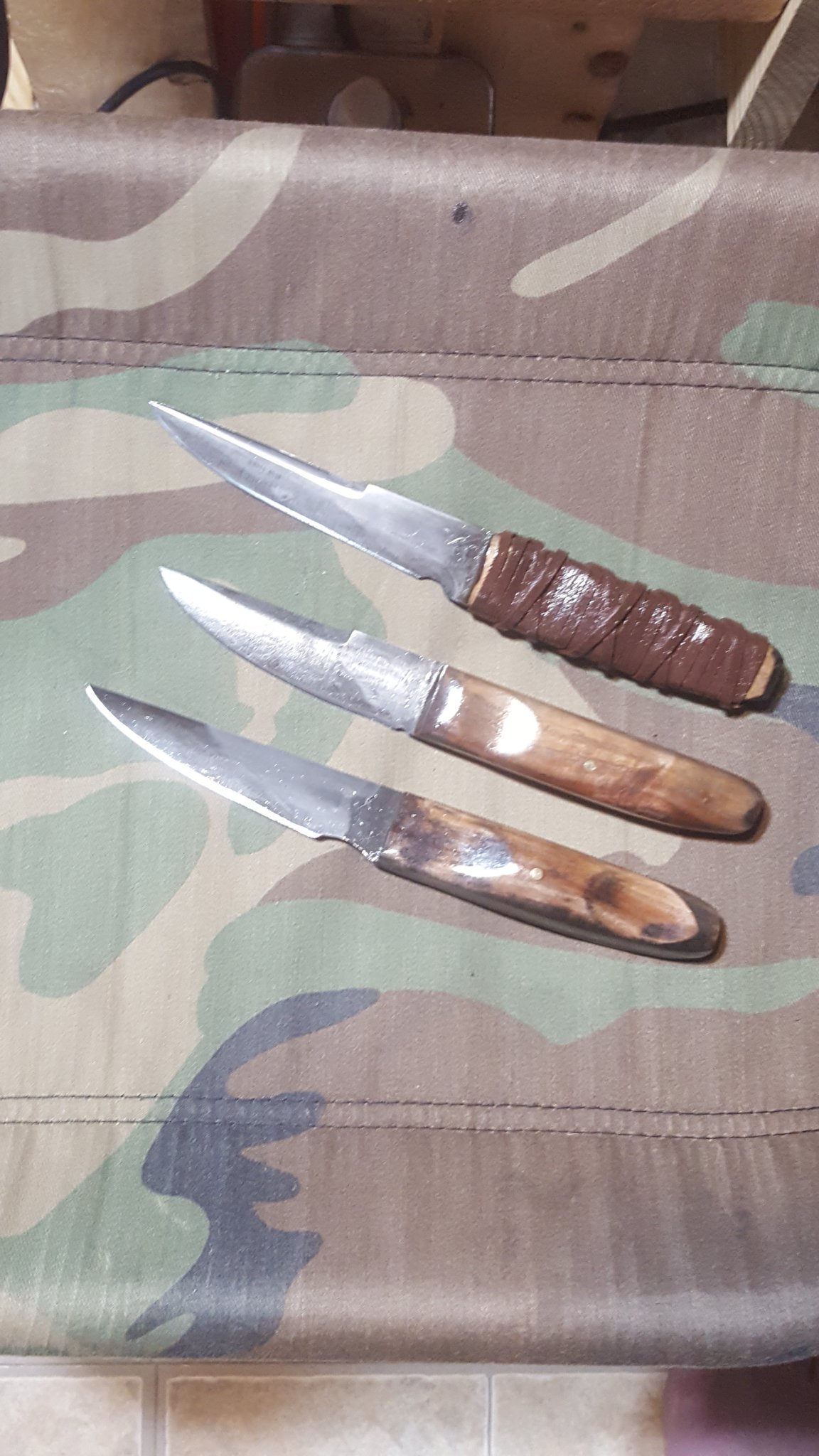

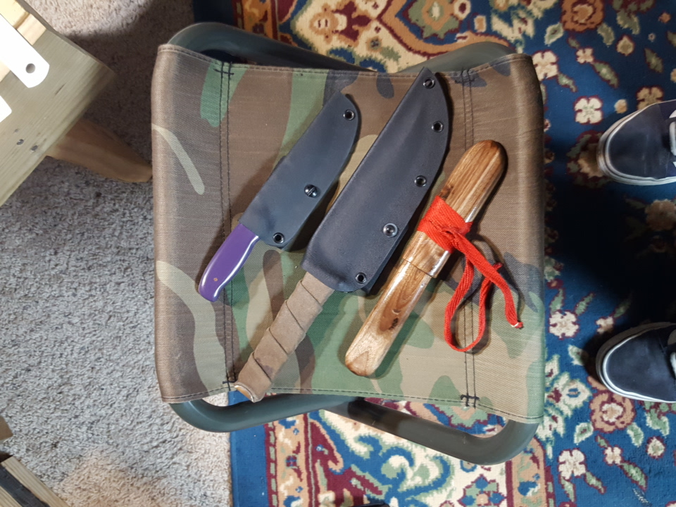

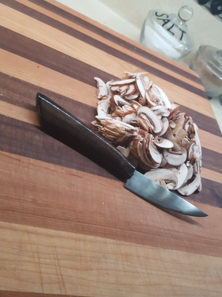

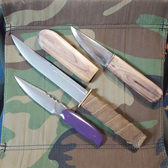

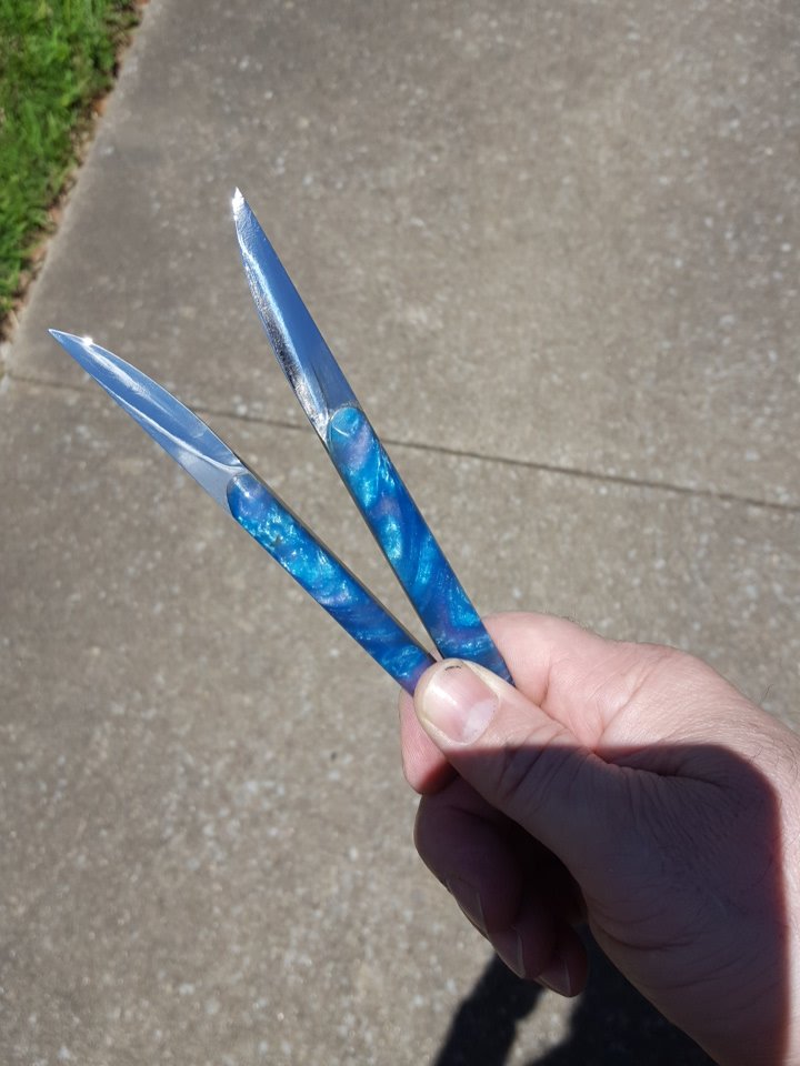

As to my suck photos, here's what he is talking about. Just your basic cell phone, here it is pictures. I should take Super Street, Playboy, Blade time to set up shots, but that is time away from making things, designing things, and playing at making knives ;)

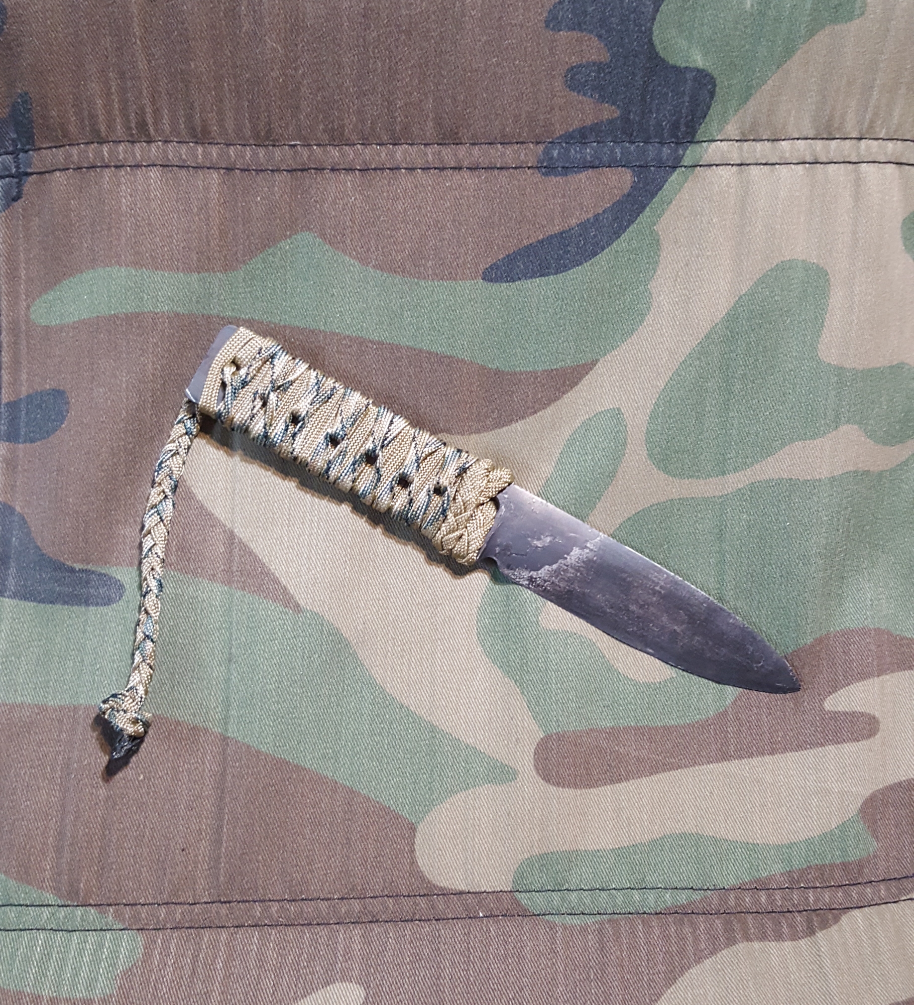

Drive home... grab a knife and open up the package and inside is this....

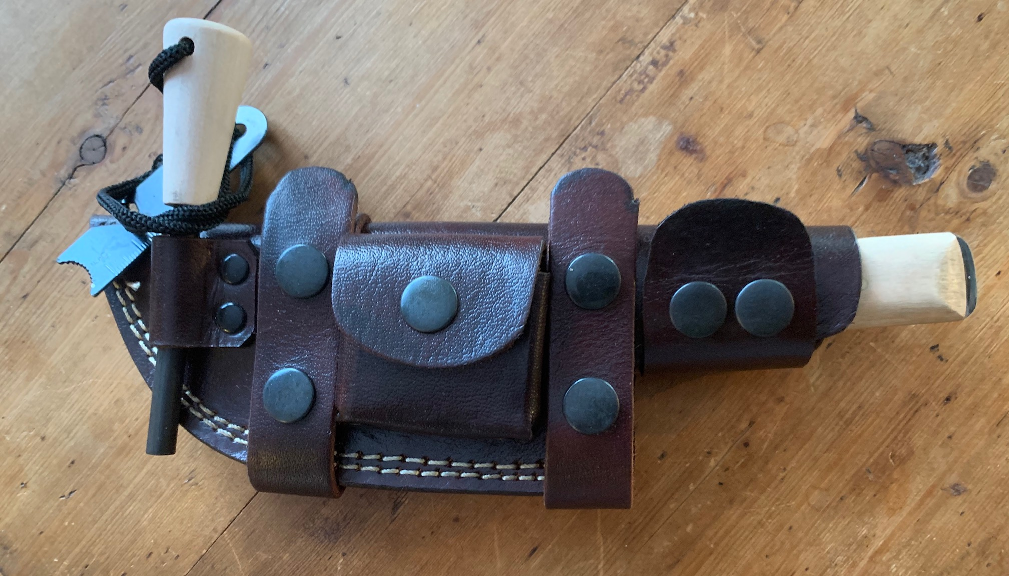

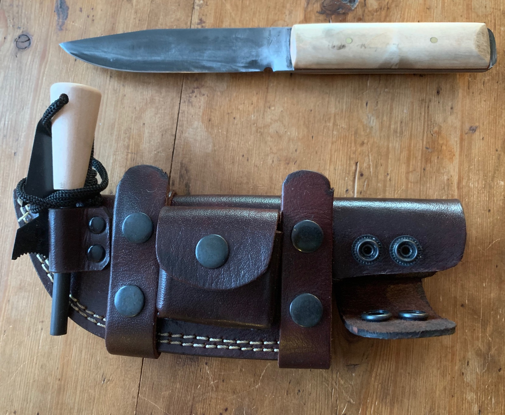

1084 Temp cycled high-carbon... 5" drop point with scissor edge with a ferric acid finish. The scales are stunning in their simplicity.... a hard pine polished to a high-shine and sealed with beeswax. Razor sharp. The sheath is really cool with a stone and a steel built on. Very positive retention and beautifully-executed. I know exactly where this is going... and it's getting strapped to my possibles bag for my next muzzle-loading hunt(s).
The whole package is beautifully executed! More importantly, it is aesthetically beautiful. I have a thing for the Green River pattern knives and the old 'trapper' knives of the mountain men. Probably from watching Jeremiah Johnson too many times. The original survival/combat/utility knives that men like Jim Bridger and the Lewis and Clark adventurers carried when they really made the American frontier... into America. It's a lot like the knife I made myself when I was 15 or so... the difference is that it was made by someone who knew what they were doing.
How Switchblade got into my head, I don't know. But he did! And made me a spectacular piece that I already treasure. Not only because it's beautifully done, but because it's another great example of 'Hide folks pulling together to support one of their own. Because I was not the only one bidding on the Seax to help out 'Switch. Lots of folks were (and are) there for our friend!
So, Switch, thank you! You hit it out of the park, buddy! And I hope that some other folks here will want to take the plunge and order one of Switchblade's early efforts. Because you will love it. And one of these days he'es going to get famous and we won't be able to afford his knives!

I wanted this knife to be kinda like the seax, simple, but very light in hand, sharp, and simple scales that in the sun, show a seriously nice chatoyance.
The scissor edge is for that FIRE STICK. It is not a sharpening stone, but a tool to make fire with. The scissor edge is ground at teh perfect angle to engage knife right hand, fire stick in left and blade drop point at 90* to the stick.
I am currently awaiting more belts for the grinder. I have 1/4" mosaic pins and am ready to make my second forged blade for a GI in Ft Stewart who heard from a guy I make great knives. I'm blown away a guy in Georgia heard good words about what I make. That is awesome.
PS: The issue with the seax was I wanted to make it darker. My chemistry stoichiometry wasn't right. My molar strength was higher and it pitted the back of the blade and took out the base of the edge. A simple, but costly mistake. After a call with my old Chem Professer, she squared me away and I fixed my acid and times to dip.

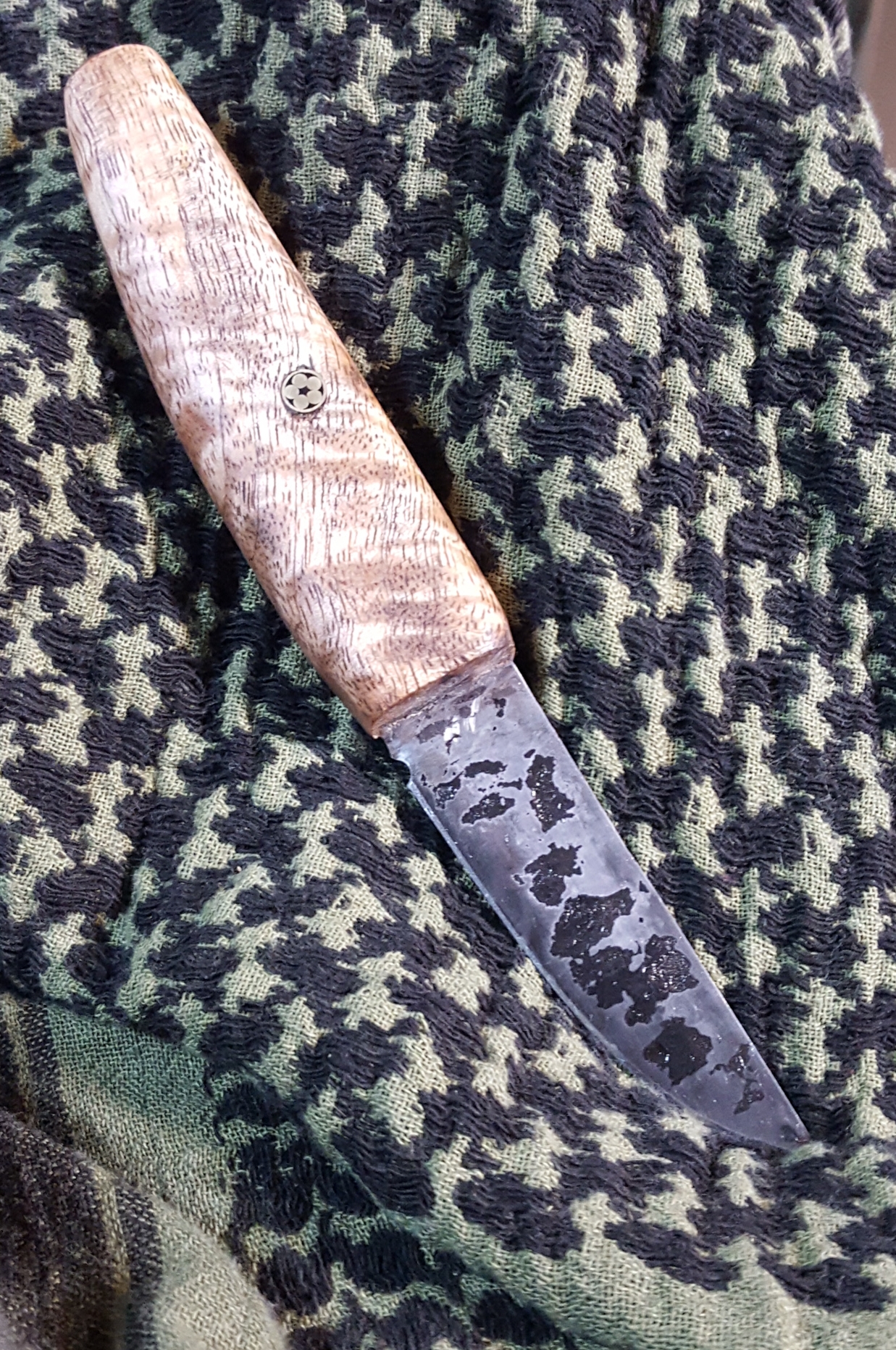

Well, after having the customer say he wanted a Harpy, but with more forge scale and dark blade work, we have finally finished the knife. The customer is elated and loves how it looks.
Me, my photo skills are still trash, so here it is anyway.
Forged to shape D2 Steel, differential heat treated. Before handles were applied and final sanding, this blade was stabbed and chopped into bricks with zero distortion or breakage. It shaves.
Scales: Big Island Hawaiian Mango from @hawiaaiantropicalhardwoods, BLO/Beeswax and buffed
Mosaic Cherry Blossom pin. Once I find the 12" tubes, and tiny pin stock, it's black epoxy and that cherry blossom gets a center rod
