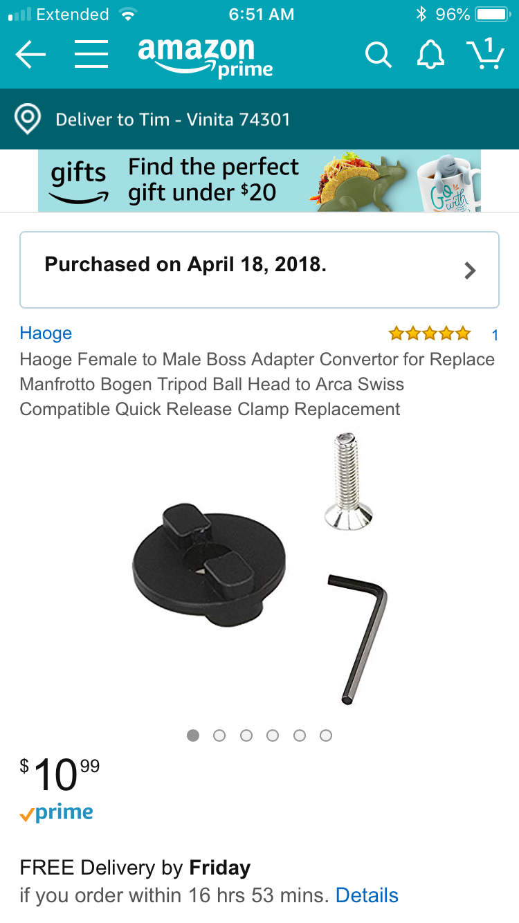

I’m not sure what the grip ball head is like, but I had to buy this for my Manfrotto ball head to make the conversion.
I am not a huge fan of this option, but I get asked about it a good bit and it does work.......

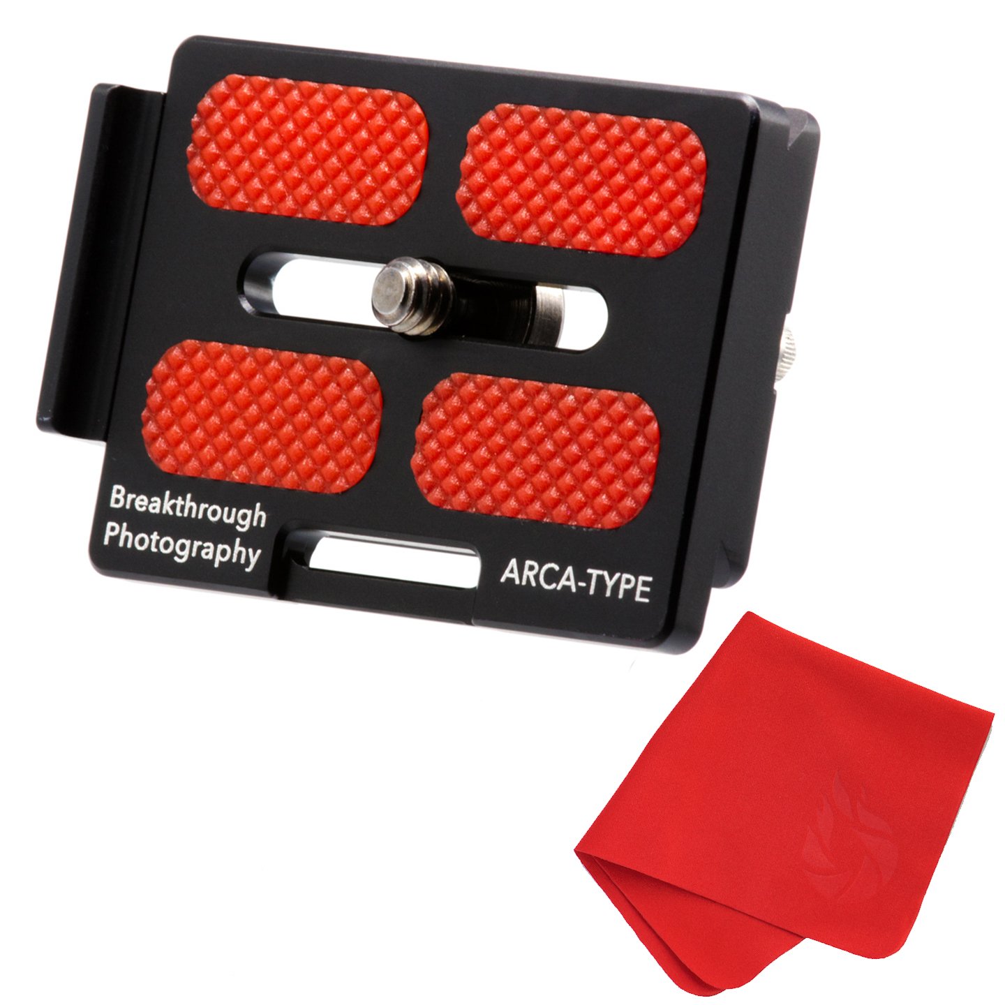

Just thread one of your RC2 plates to the bottom of one of our threaded clamps. Nothing is permanent, easily removable, and you gain what your looking for. Down side is it is not anti-twist.
Here is the link if you want it, Link for Clamp
